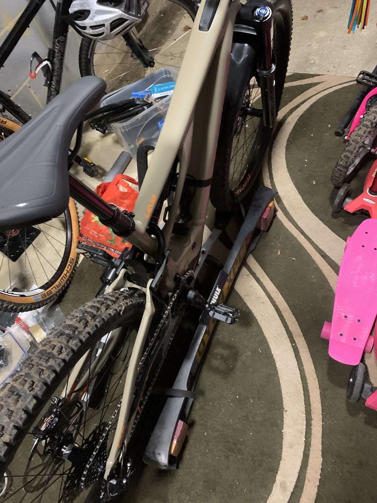

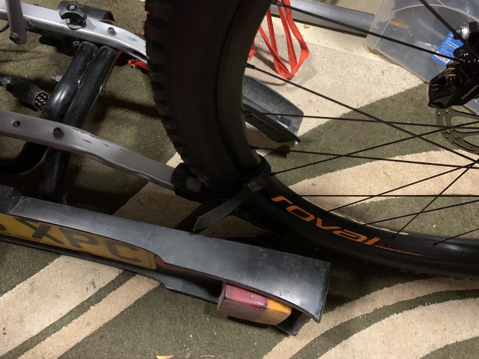

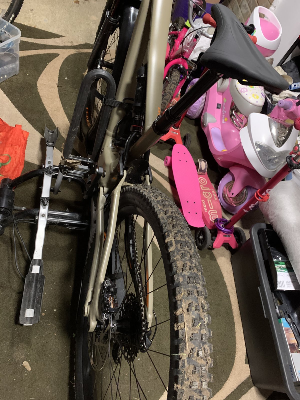

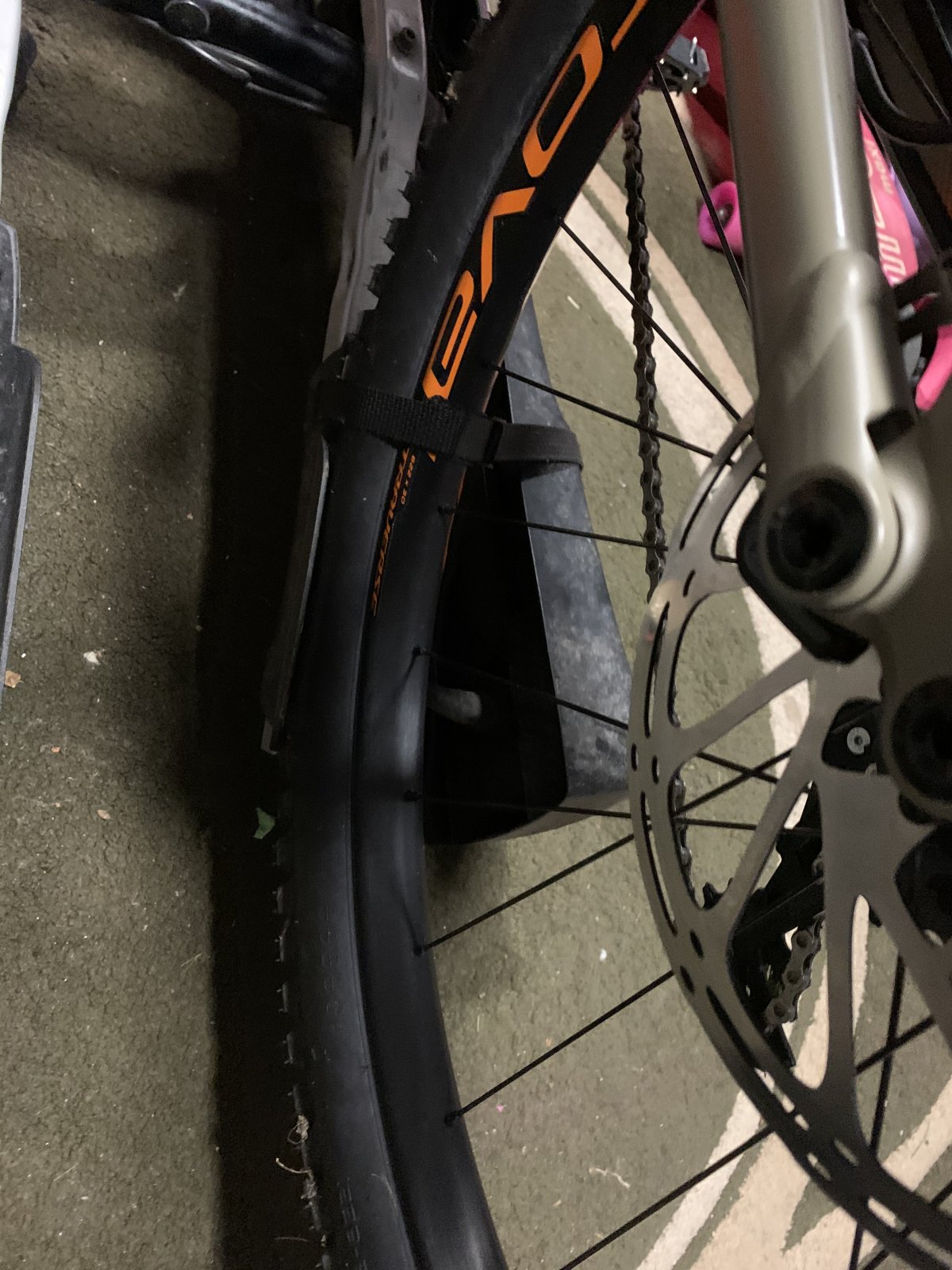

Hey all
What tow ball bike racks have people got?
I’ve got the one in the photos but it’s pretty old and the frame of the Levo is a bit big so leaning the bike over. The tyres are also a bit fat for the tyres slots so am looking for something more suitable.
I was interested in a verticals mount scorpion rack but the weight limit limits me to only one bike and I’d need to replace my tow ball.
Any ideas welcome.
cheers.

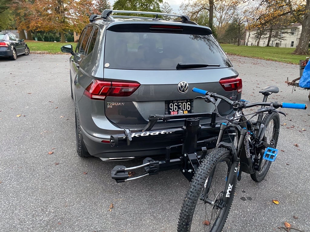

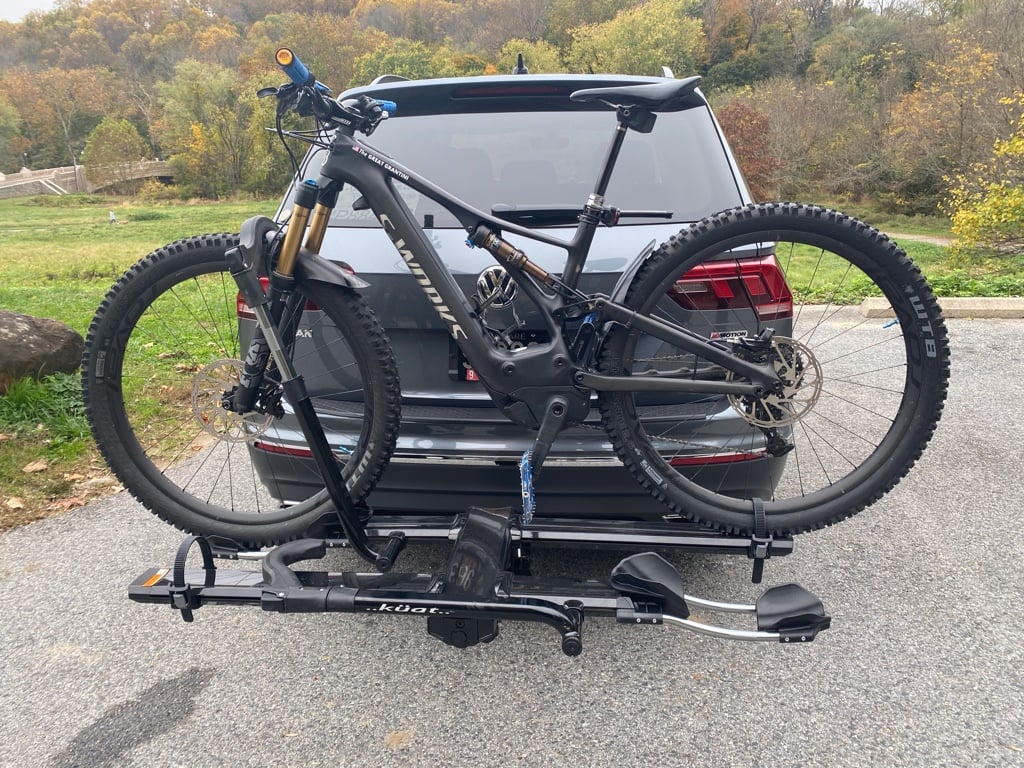

In my honest opinion, anything except a 1-up or a Kuat NV is a joke. Why would I put 20k worth of bikes on anything but the best possible rack? I just replaced my eight year old Kuat NV Core with a new NV 2. Multiple repairs over the years with excellent customer service from Kuat.

Must admit I have the same one as the OP (Thule rideon) your right about the tyres being a snug fit but I like that as it feels secure when you push the tyres into the holders, just one bit of advice is not to push them too far in as the holders eventually split ?
kaj0103
Oct 23, 2020
63
9
Maidstone
Yep, I feel the same. Just seems like they will crack if I push too hard. Plus it’s about 10-12 years old. Plastic probably brittle now as well! ?

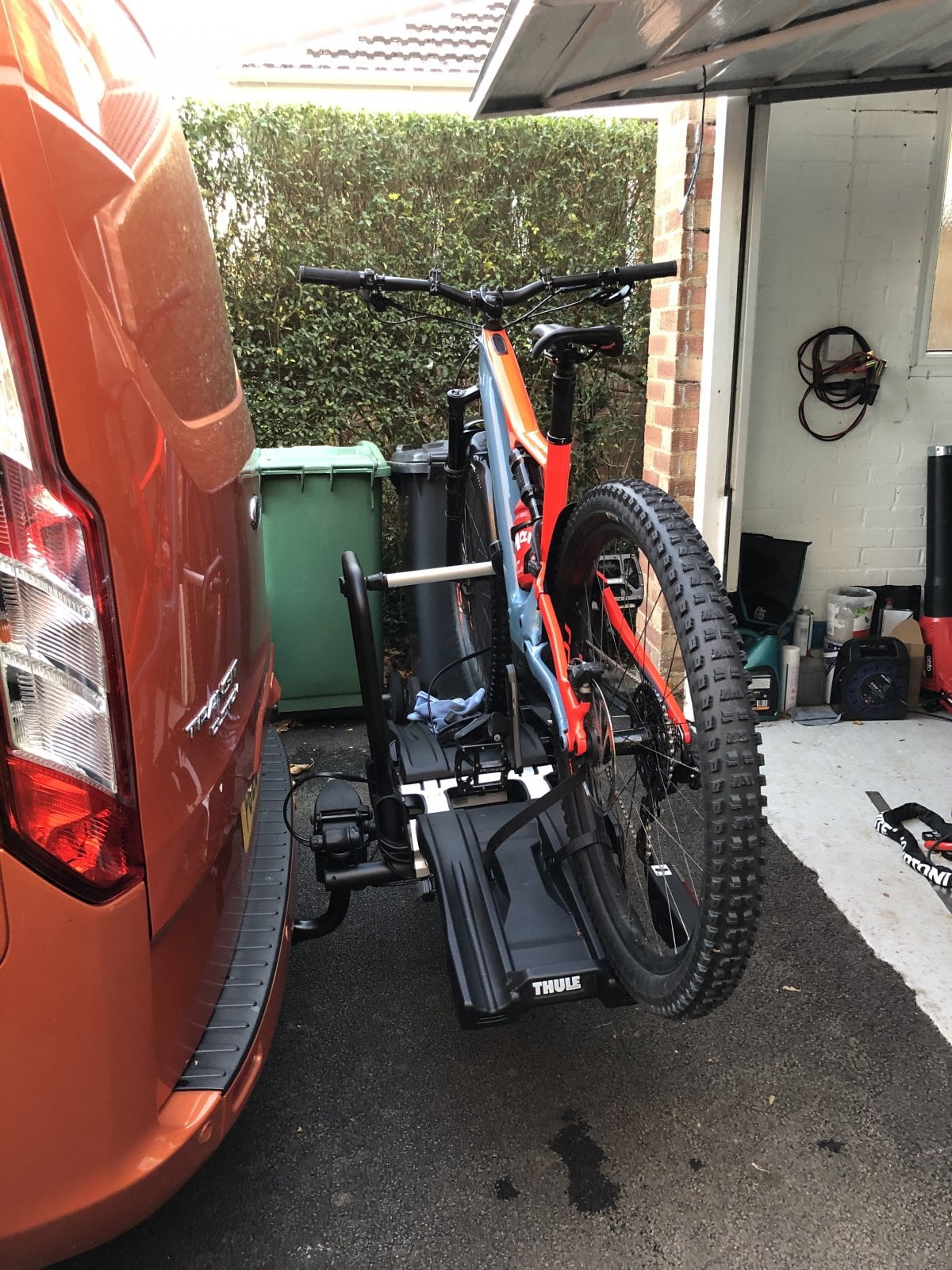

I went for the Thule Easyfold XT2 to put my Spesh Levo on. Really nice bit of kit which ticks some of the boxes like it folds down into a compact shape to lob into the back of the motor.
Unfortunately there seems to be a gap in the market for a tow ball bike carrier that can do the following;
1. Compacts down
2. Has the capacity to carry heavier eBikes
3. Has the distance between bikes
4. Has the wheel base for 135cm +
5. Has tilt to allow a tail gate to open
6. The hitch high that doesn’t foul the tailgate (Ford Transit Custom)
7. Has the distance away from a vertical tailgate so handle bars don’t touch/rub against paintwork
8. Can clamp awkward shaped bikes i.e thicker down tubes or ones that aren’t vertical or horizontal
The Thule struggles with 4, 5, 6, 7 (on the first bike slot) and 8 (managed it but wouldn’t trust) On a Ford Custom.
A mate of mine who has the same van is trying out the Atera Strada DL3 but it’s not for eBikes although if you were to load just 2 bikes you’d be on the cusp of designed spec.
Anyhow, it’s a mine field!

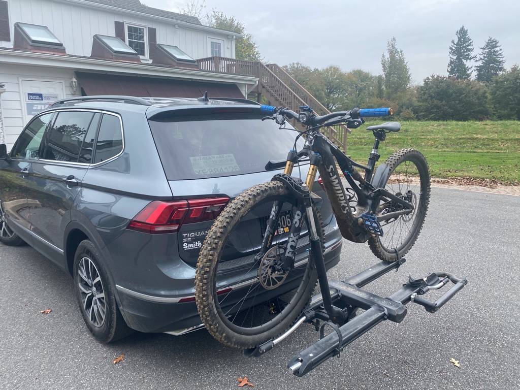

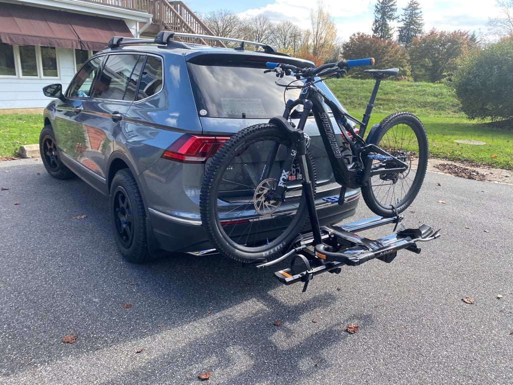

Pretty happy with the Yakima foldclick 2. Tow ball mount easy on/off. Up to 58 kg load. Only issue is that it can be difficult using the arms to mount a second bike.
