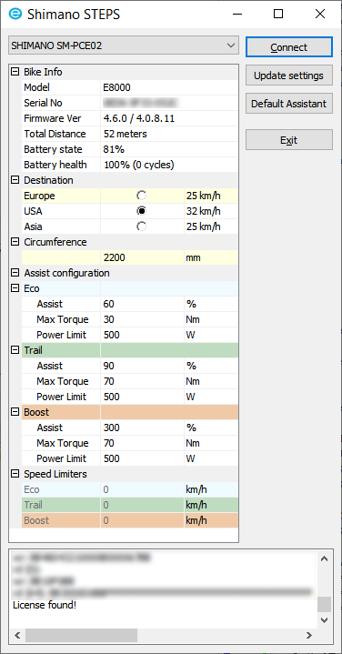

Hello from the US. I am going to pay for the app later on today on the advice of a fellow emtber. I just bought a 2020 Commencal Meta Power Ride and I think it is set to the Euro mode because it is limited to 15mph/25kmh. Can you tell me what else I have to do or buy just to set it to the USA mode? Thanks and have a great day.

Waiting for the sm-pce02 to arrive, does the bike have to be connected to purchase the licence? Sorry, total newbie question
The license requires the serial number of your bike, so yes, you have to connect the App/Software with the bike to get the serial number.
Thanks for the quick reply, will the pc version recognise the serial number? I want to change to us region as the 25kmph is laughable and almost exactly at cruising speed

Hi again, can i use the app on my ipad and pc simultaneously or will that require two licences? belt and braces in case i accidentally brick the bike diue to bluetooth drop out
Premium license is for the motor. You can use it on any device.

Hi, my sm- pce02 is due to arrive today so hopefully I’ll be purchasing the licence later 😁 25kph sucks on roads travelled to get to trails
