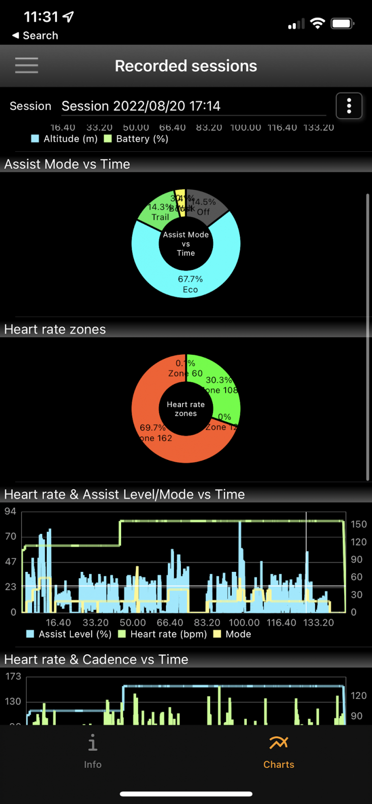

@vadII I have now used the ST Ride twice, on iPhone + Apple Watch to record a ride, it seems to work great, thanks for all the work! I did have to restart the App on Apple Watch in order to get it to connect more than once, not a major issue. One thing I've noticed with the heart rate measurements from the Apple Watch, they are displayed on the iPhone app as part of my recorded rides, but they somehow don't seem to transfer over to Strava when I import or share my session.
Is there some setting I'm missing? Thanks!

Bummer. Any idea how Garmin and Wahoo do this? I see friends that use these devices and still get heart rate data in Strava.
Sorry, my fault. Strava imports heart rate and STRide exports it into GPX files which uploads to Strava. It looks like something wrong with your ride session, which does not have recorded HR.
Here is info
jayv
Aug 19, 2022
SF Bay Area
Here is info
In the ST Ride app I see heart rate data from my session, I'll see to export the file to take a look later:
jayv
Aug 19, 2022
SF Bay Area
Here is info
My exported .gpx file indeed does not have either of the fields from the garmin or cluetrust gpx extension's defined in their xsd however in exported ST Ride file I do see data, what also is strange is my candence reported as 0.0 while it has some value:
GPX
XML:
            <trkpt lat="37.99334419418411" lon="-122.60433452945517">
                <ele>109.1</ele>
                <time>2022-08-21T00:25:00Z</time>
                <extensions>
                    <gpxtpx:TrackPointExtension>
                        <gpxtpx:cad>0.0</gpxtpx:cad>
                    </gpxtpx:TrackPointExtension>
                    <gpx:altitude>109.1</gpx:altitude>
                    <gpx:speed>21.945</gpx:speed>
                    <gpx:distance>2233.165</gpx:distance>
                    <gpx:cadence>0.0</gpx:cadence>
                </extensions>
            </trkpt>
STR
XML:
<pt acc="1" assist_level="22" assist_level_avg="22" assist_mode="3" batt_consumption="5" batt_level="95" cadence="220" cadence_avg="454" climb_total="692" descent_total="54" di2_fr="0" di2_rr="0" gps_alt="1090" gps_bearing="2314" gps_lat="37.993344976766785" gps_long="-122.60479826837734" gps_speed="20" gps_speed_avg="114" gps_speed_max="320" heart_rate="115" heart_rate_avg="111" hrm_batt="-32766" id="651" kcal="150" mode_boost="224" mode_eco="265" mode_trail="297" ms="625065" phone_batt="100" range_boost="280" range_eco="850" range_trail="420" s_traveling_distance="2094" s_traveling_time="8" sens_alt="612" slope="44" speed="41" speed_avg="129" speed_max="337" total_distance="40838" traveling_distance="40838" traveling_time="130" />
That said, the data looks kinda whack tho, only 6 different HR data points
Code:
 ~  zcat Downloads/Session\ 20220820-171424.stridegz | yq -p=xml '.session.pt[].+heart_rate' | grep -v null | sort | uniq -c
      6 107
      7 108
      6 114
   2925 115
      2 126
   5888 157

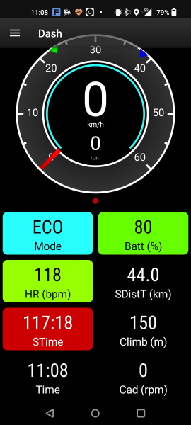

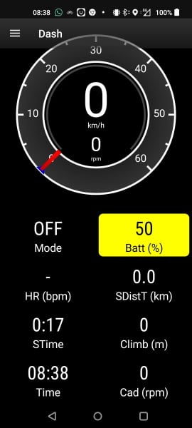

Dear Vadll,
I bought your App and I really appreciate it.
For the dash I downloaded the Online schemes list and I use the d_22_1 version that shows all the data that interests me.
I would like to ask you if there is the possibility of enlarging the characters.
I'll give you an example below of how the display is at the moment and how I would like it.
Let me know if it is possible and if I can do it by myself, thank you for your work and for your support.
Hello
vadII
Feb 19, 2019
768
567
Earth
add attribute for main XML node (for 30% increase of text size):
Code:
<dash_scheme ... size_mul="130"...>
Code:
Dear vadll,
if I understood correctly I have to add only the parameter you indicated in the d_22_1.xml?
<dash_scheme cols="2" aspect_ratio="2" size="30" size_land="50" size_mul="130" name="Var #2: 2 cols x2" desc="Mode/Batt/HR/Dist/Time/Climb/Clock/Cad">
Correct?
Thank you for your support

OK, thanks I did not make myself understood. On Stride there is a number displayed which represents the percentage of assistance. What I will be interested in is whether it is in the form of a bargraph on the same model of the bargraph of remaining battery capacity.
You can configure any parameter as bargraph (vertical or horizontal) in XML file

Dear vadll,
Correct?
Dear vadll,
I tried to follow your directions but it doesn't seem to work see img below.
BEFORE AFTER
This is the modified d_22_1.xlm:
<dash_scheme cols="2" aspect_ratio="2" size="30" size_land="50" size_mul="190" name="Var #2: 2 cols x2" desc="Mode/Batt/HR/Dist/Time/Climb/Clock/Cad">
<text ids="Mode"/>
<text ids="Batt"/>
<text ids="HR"/>
<text ids="SDistT"/>
<text ids="STime"/>
<text ids="Climb"/>
<text ids="Time"/>
<text ids="Cad"/>
</dash_scheme>
Please let me know if I did something wrong.
thanks bye
