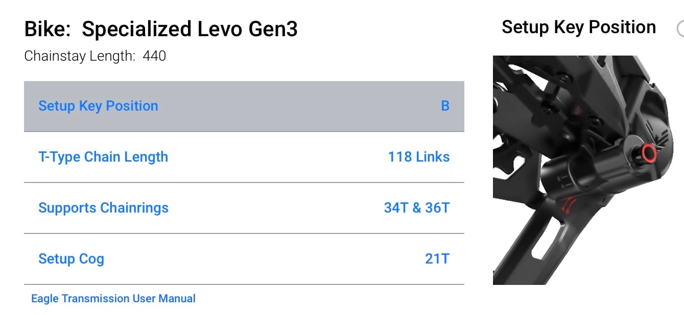

Do you have a Gen3 Levo? What length is your chain? SRAM guide recommend 118 but it’s too short. I have a Gen3 Levo in S4 size.
Mystery solved! T-Type GX Chain came with 120 links total, instead of 126 as advertised. I never expected a new box of chain would be missing links. Lets see what World Wide Cyclery will do about it.
So lessons learned: when adjusting chain length to setup for SRAM recommended T-type transmission chain link count for your bike, count from link 1 up to total # of links needed. DO NOT count down from 126 and deduct/remove the number of links to get to desired count of links as the new chain may be missing links.

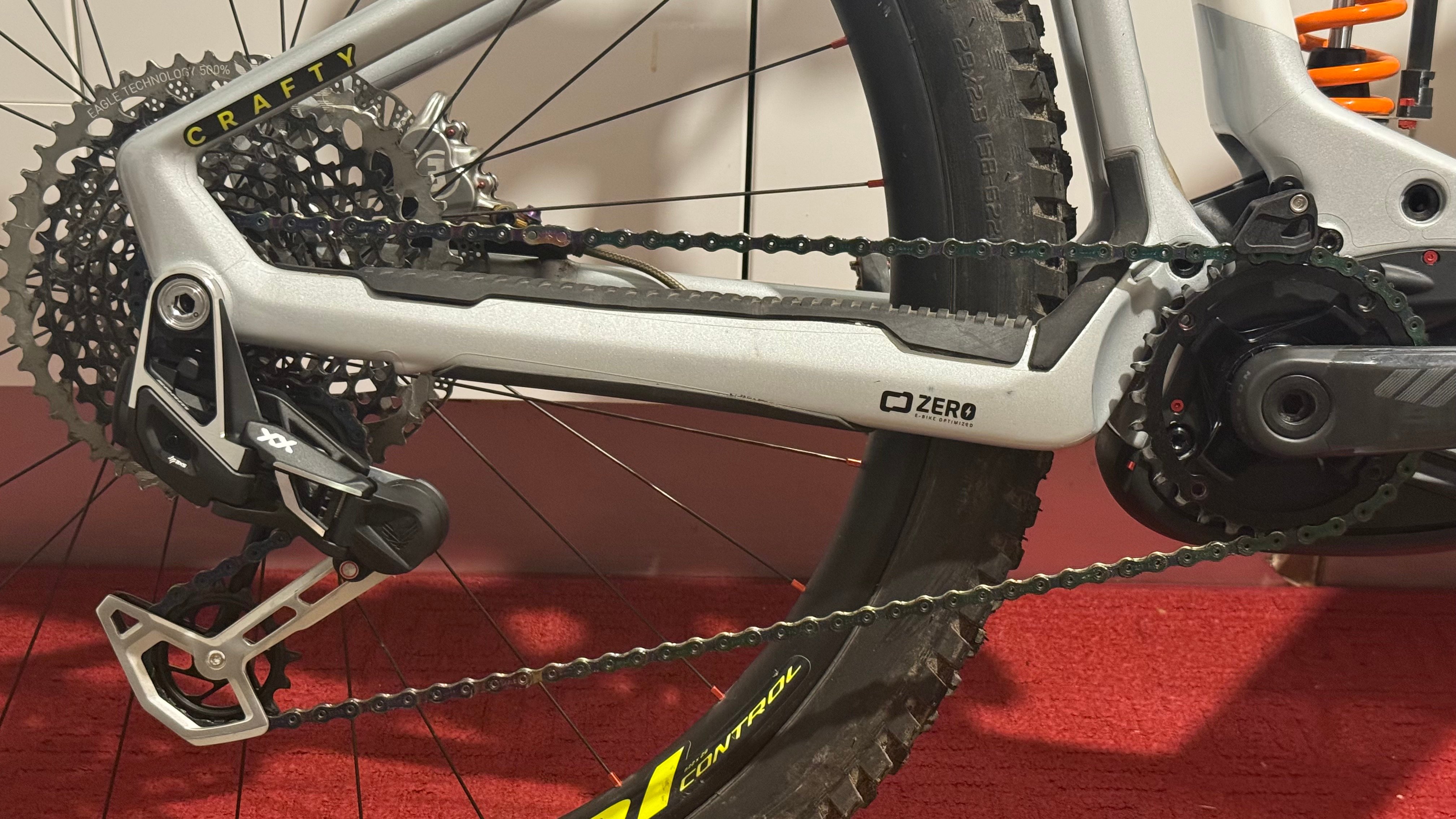

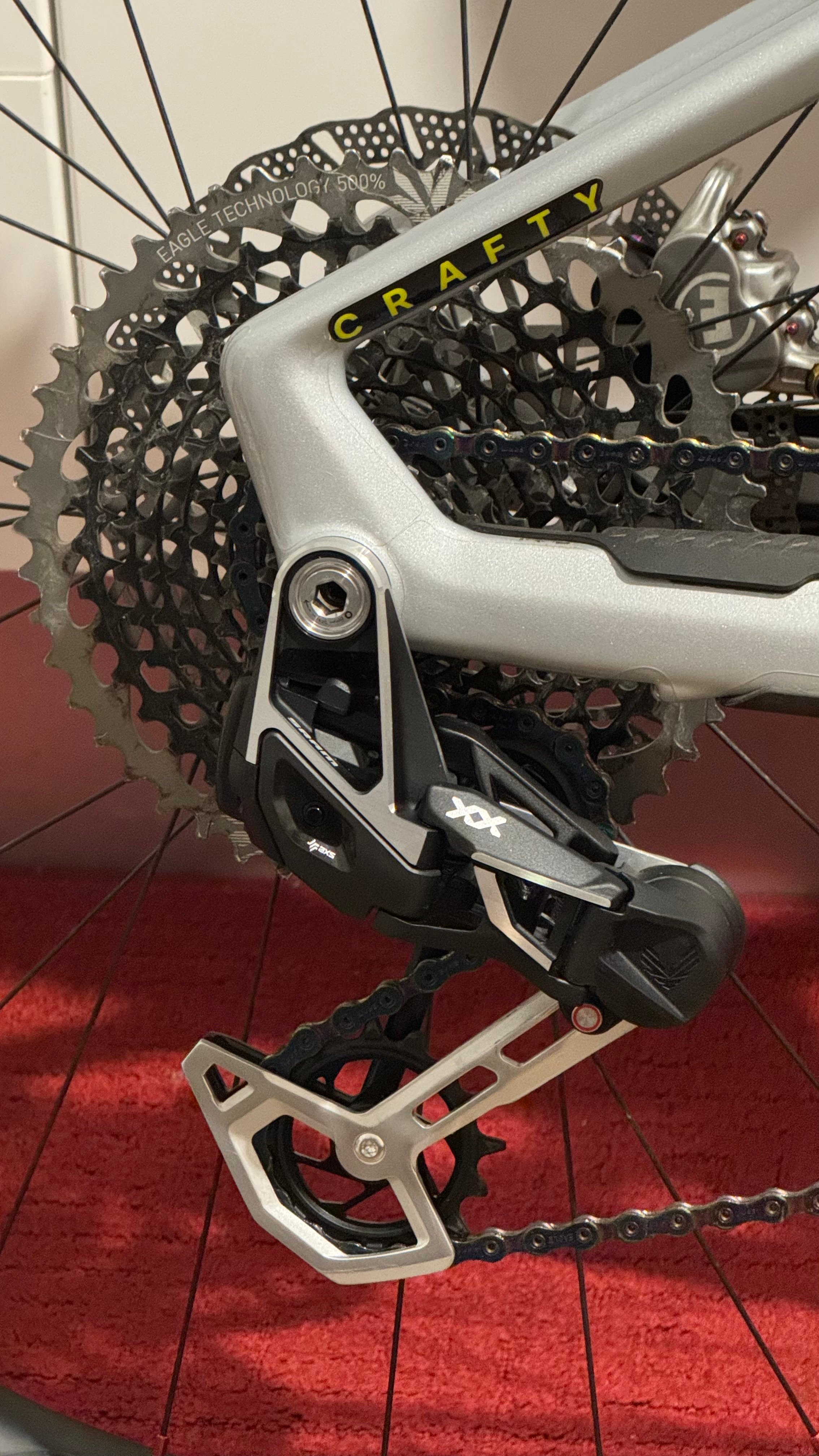

For everyone wondering if the T-type works with the old eagle the answer is yes. I wanted to mount the XX derailleur but I had just changed the cassette and chain and I didn't want to replace them and so I only replaced the gear mech. I have followed the same procedure for the standard setup but I’ve used a 10-50 cassette so I’ve had to shorten the suggest chain length by two links. Also, I’ve used a 2,5mm spacer between the cassette and the freehub body cause I was out of the range of microadjust.
whitedlite
Jul 12, 2022
11
View attachment 130331 View attachment 130332
If it works great go for it. Those X01 Cassettes can be found very cheaply every now and then.

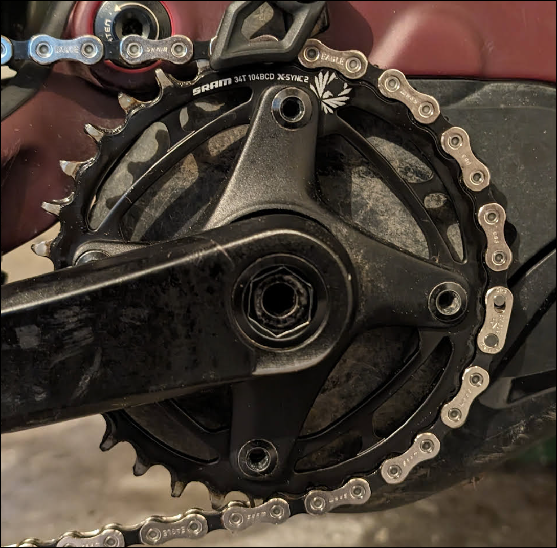

I have a Turbo Levo Expert Gen 3 and contacted SRAM regarding the GX T-Type. My question was:
I've spent a few hours trying to get the answer to this, but it's far from clear. I have a Specialized Turbo Levo Expert S4 (96421-3304) which is the 2022 model. I want to buy the GX Eagle T-Type Transmission as an upgrade. The issue is the chainring, and attached is what I currently have.
I would like to keep a 34t chainring, so can you please tell me the SKU/part numbers of ALL the SRAM components I would need to buy?
Also, can I just keep my existing chainring? However, if I need to upgrade, what SRAM part number chainring (34t) do I need?
Their excellent reply is shown below. Hope this helps.
Cheers, Paul
I'd be happy to help you out with this. I'm sorry you've had difficulty finding a concise answer to this. Thank you for providing me with the details about your bike and an image of your current chainring.
For owners of the Turbo Levo, we have been suggesting our T-Type 104BCD Groupsets (GX - 00.7918.282.002). These include a 104BCD T-Type chainring to mount on your existing spider. This group does not include cranks, however. The chainring that comes with the 104BCD groupset is a 34T, though we are now offering a 32T 104BCD as well (11.6218.066.000). The 2022 Levo is compatible with chainrings from 32-34T. Your existing Eagle X-Sync II chainring cannot be used due to differences in tooth profile and chain design between Eagle Drivetrain and Eagle Transmission.
The reason we advise this specific groupset variant for the Turbo Levo is that our direct-mount T-Type chainrings are incompatible with the Levo. The Brose motor in the Levo is offset towards the drive side of the bike, pushing the chainline too far outboard when our Brose direct-mount chainring is used. That said, you can still install SRAM's T-Type e-mtb cranks, they can be purchased separately, though they are not necessary.

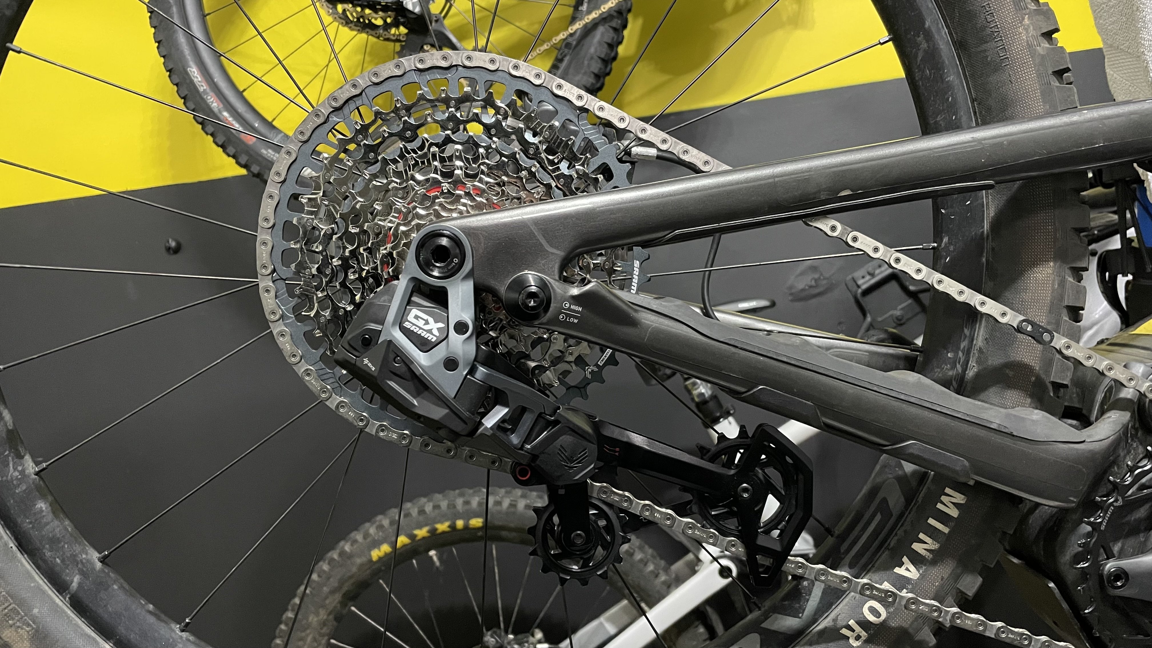

What chain size did you use for it? I installed it this morning using the info from the AXS application for 34T chainring. The app gave me A-gap setup, 118 link chain and 21T chainring as setup ring. Everything shifts well, but it contacts the frame on the smallest cog. Wondering if you're having the same issue or if you set yours up differently?
EDIT: Just realized my error...when I was taking up the chain slack, I didn't have the cage lock set to position 1. Working perfectly now :)
