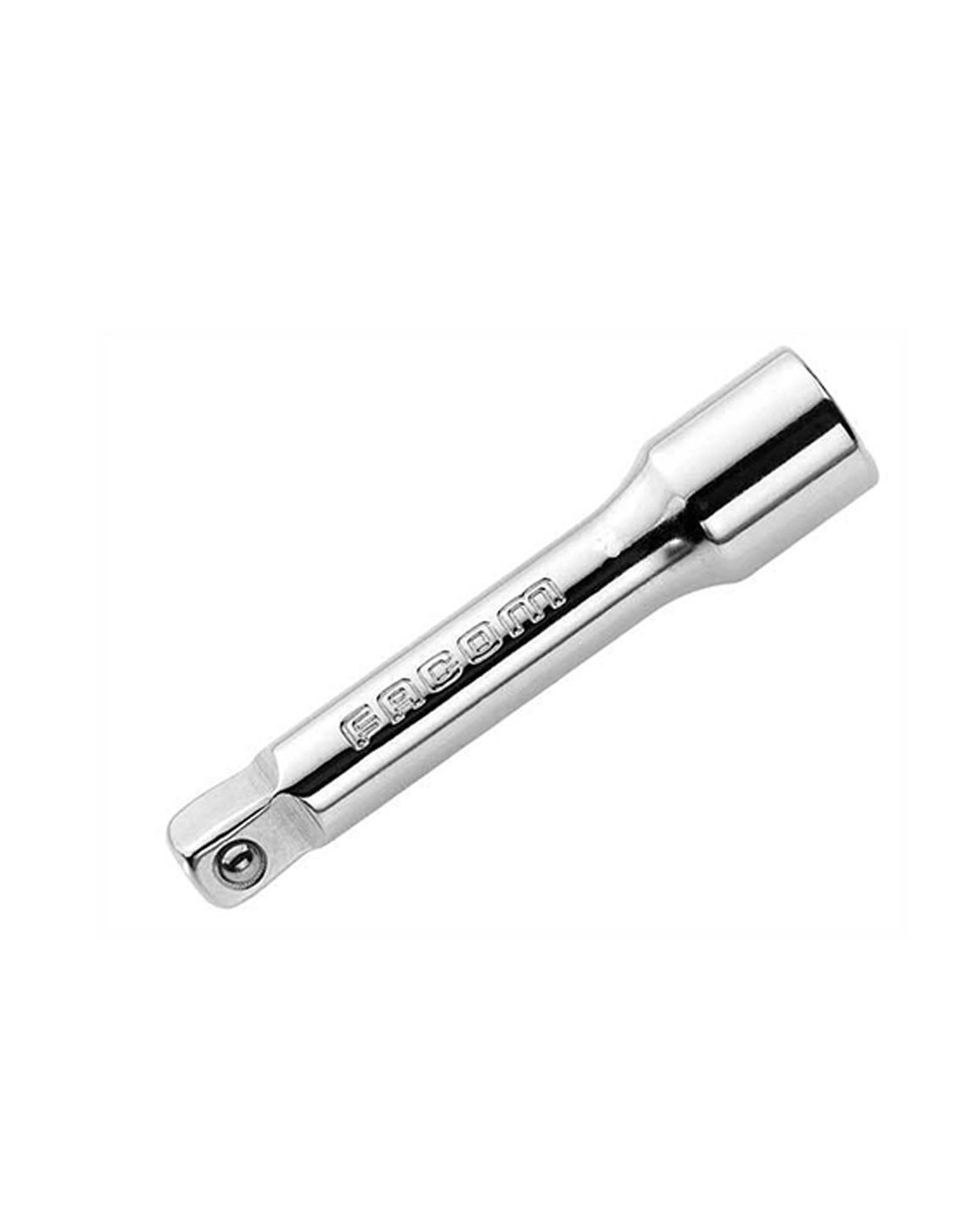

Just out of interest how do you guys managed to get a torque wrench on the inside bolt nearest the chain ring ?
I have found this impossible and can only get a standard angled hex on this inside bolt
Spiff
Feb 27, 2019
414
240
Earth
I use an extender, increases the length from wrench to screw. It is an standard accesory for wrench tools
