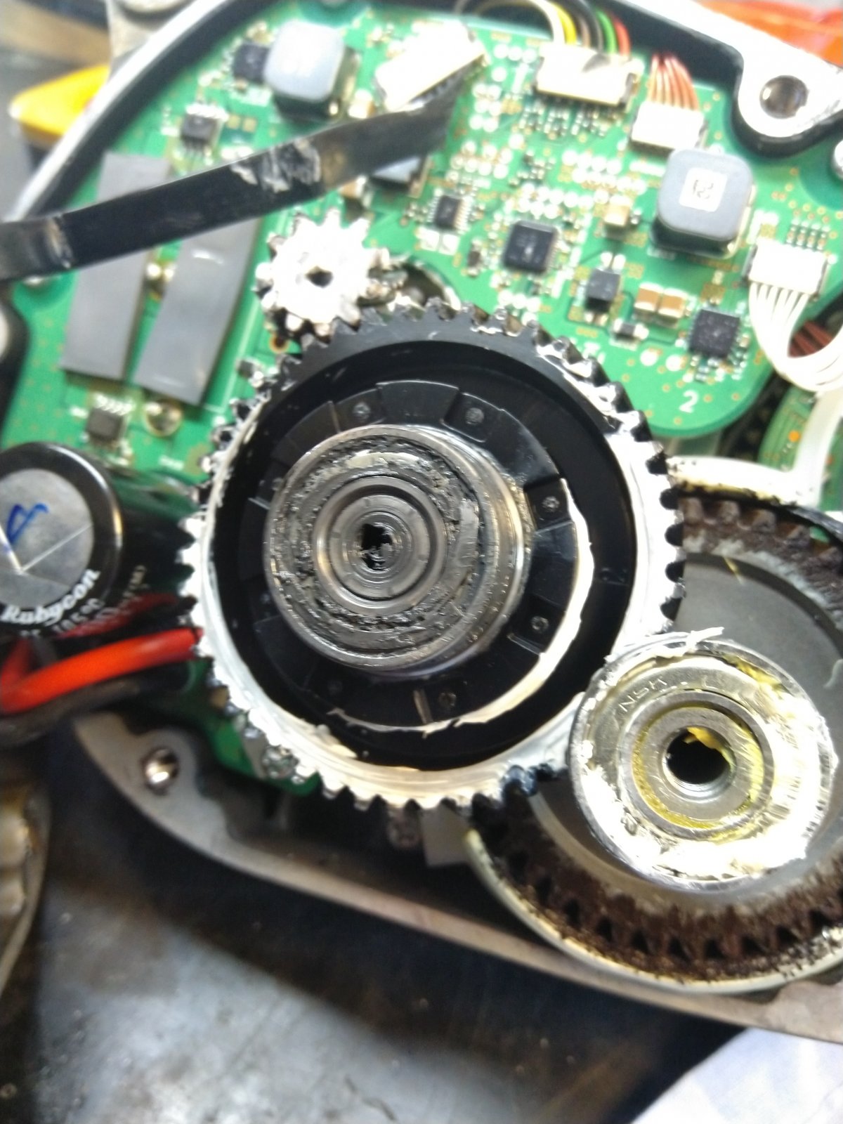

@Messy Shimano advise that their motor is not designed to be repairable, not surprisingly they don't list any spares or details of any kind.
If someone has dismantled a motor, they will have determined for themselves what size bearings are required. You have the opportunity to copy them and/or substitute a higher quality bearing.
If that is your motor in the photo, you could also measure the bearings for yourself.

ps. the pic attached is just for attention, as it's just a random one from net :geek:

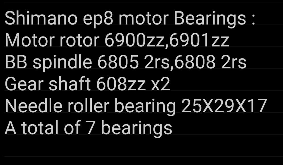

Shimano uses KOYO bearings in their ep8 motors. I couldn't find them for sale in my country, so I installed NTN bearings.
