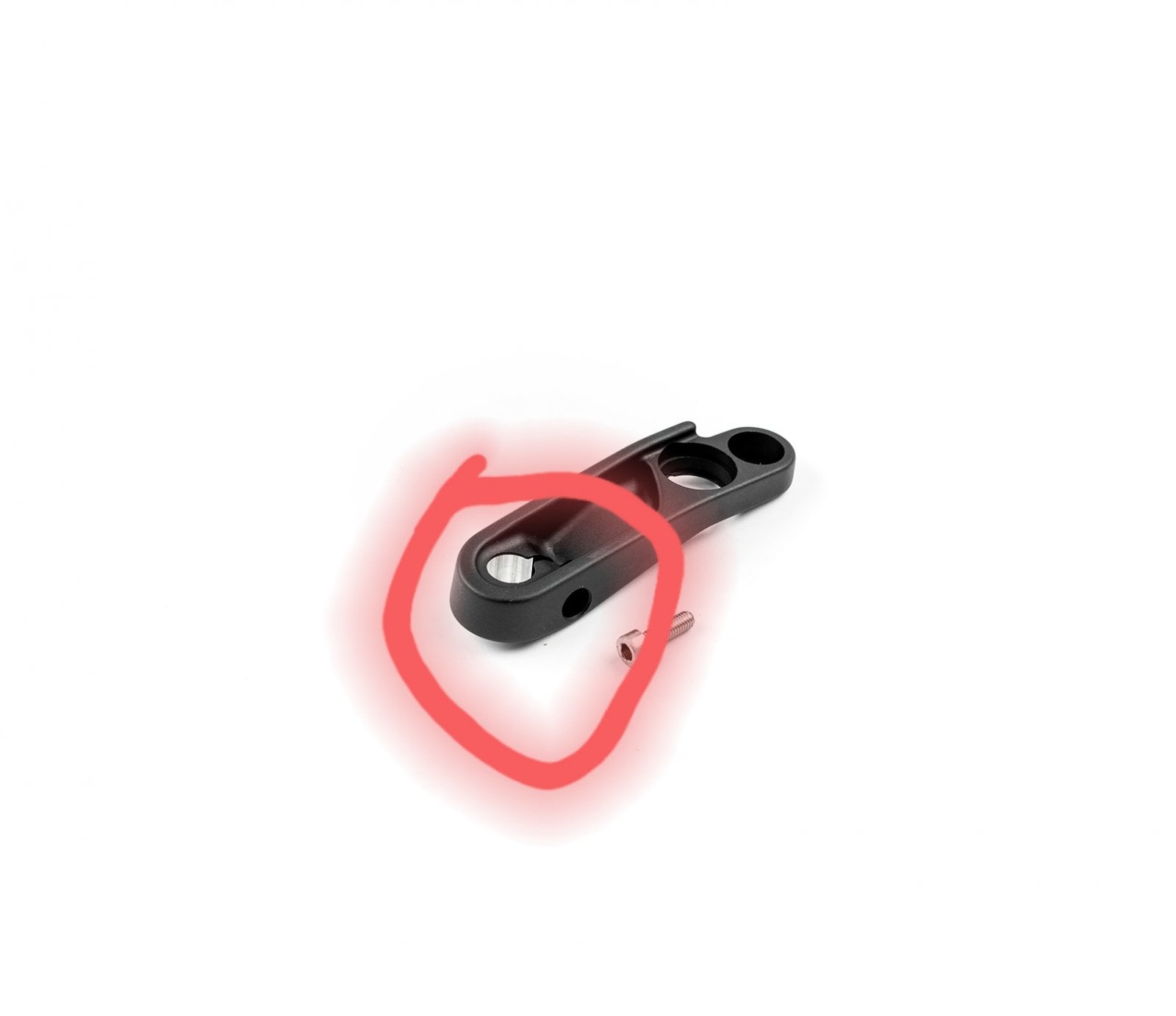

Mine also creaks, its left or right linkage u have to takenit apart, clean it...and use loctite 648...and retightened bolts ...i took all bike apart until i discovered that.
Which spot? Could you post a picture? Thanks!

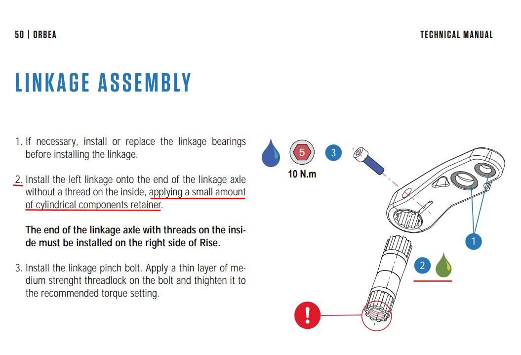

The Rise Blue Paper manual calls for a cylindrical retaining compound (Loctite 638) to be used on the splined interface between the upper pivot axle and linkage arms. However, Rises are coming from the factory without the cylindrical retaining compound having been applied. This lack of retaining compound is causing the linkage arms to loosen up on the splined upper axle and thus rear frame play develops. Also, the Rise Blue Paper manual calls for the threaded portion of the upper pivot axle to face to the right, drive side of the bike. However, Rises are coming from the factory with the threaded portion of the upper pivot axle facing to the left, non drive side. All of these issues can be easily fixed.
The Rise Blue Paper calls for cylindrical retaining compound to be used on the upper pivot axle and linkage arm interface. The Rise manual does not specify which cylindrical retaining compound to be used. Refer to the Occam Blue Paper manual. The Occam shares the same suspension design as the Rise. The Occam Blue Paper calls for Loctite 638 to be used.

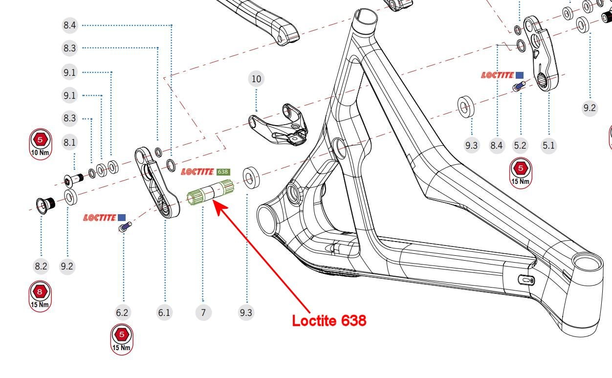

The Orbea Occam shares the same linkage design as the Rise and calls for Loctite 638 to be used on the splined upper pivot axle and linkage arm interface.
