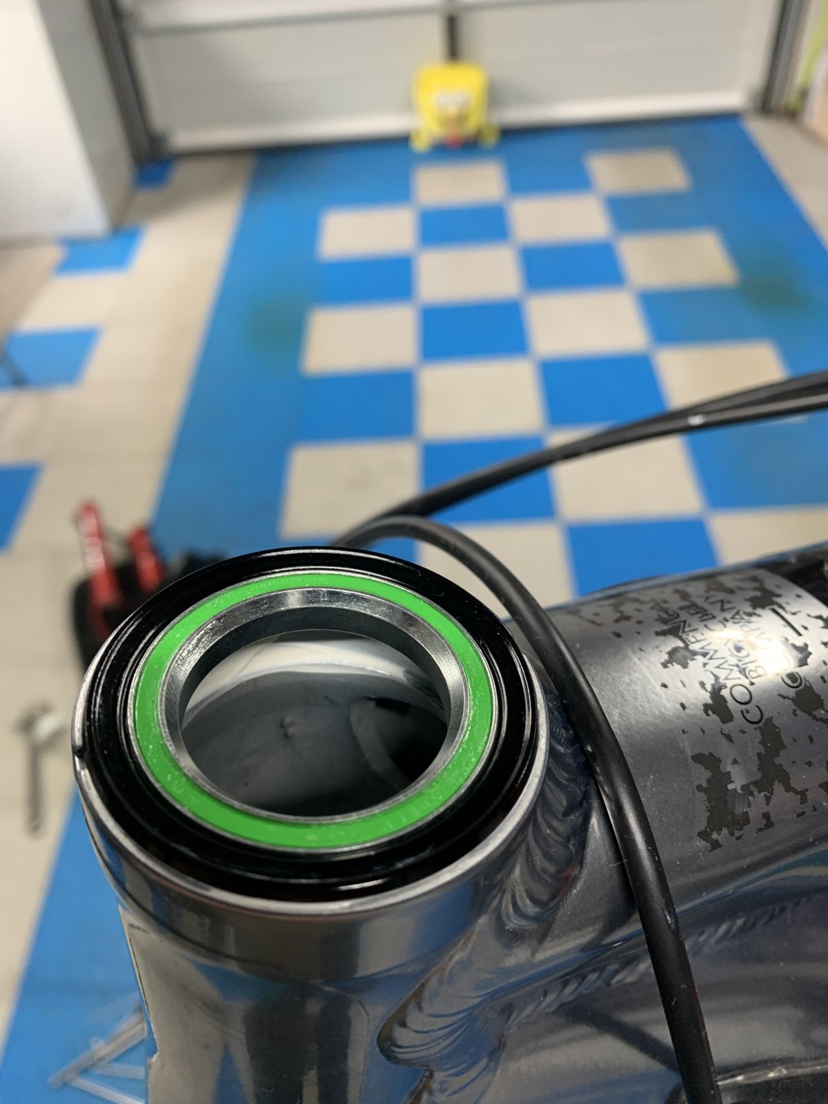

Removed acros lock block and fitted cane creek and 2021 debonair
Trickz
Sep 2, 2019
265
253
Burton upon Trent
All went well apart from not having anything substantial to press the rather heavy duty cane creek 3.5mm thick solid steel crown race(never needed anything before as normally split or thin)so when the plastic pipe split I ended up using the bearing extractor in reverse,the acros lockblock needed a bearing extractor as it made a right mess of the steerer tube as in the picture it has hard steel pins too dig into the tube,after fitting the new bearing cups the new cane creek bearings just fall into cups now which is far away from the acros shite.
A bit more stack height
Trickz
Sep 2, 2019
265
253
Burton upon Trent
Been out today and feels so much better not to have a steering block,I know if the bars twisted round once it would probably either pull the cable out of the display unit or snap it but I can twist the bars round 180 and it’s putting no pressure on the cables and the brake hose kind of stops it going any further,after seeing how shite the acros bearings are inside,too find broken balls already I’m glad I did have an annoying rattle that started me on this path?

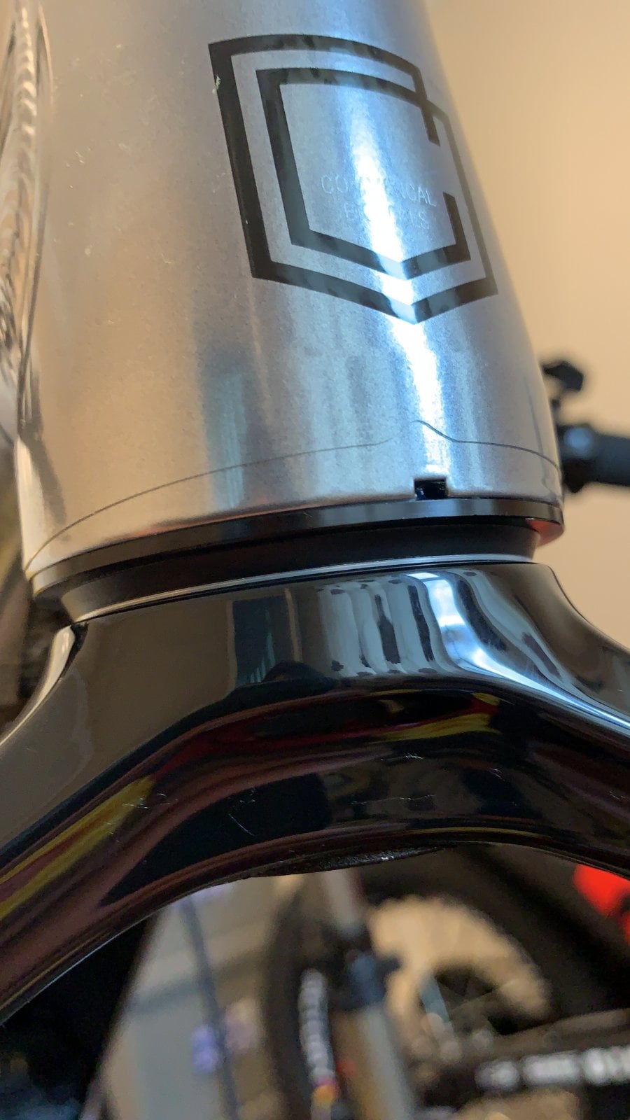

Just an FYI for anyone that's watching this thread, that if you have clearance issues b/n your fork and frame, you can get a taller crown race that may resolve it. Of course it will slightly tweak the geometry, but anything to get rid of that asinine lock block approach is good.
