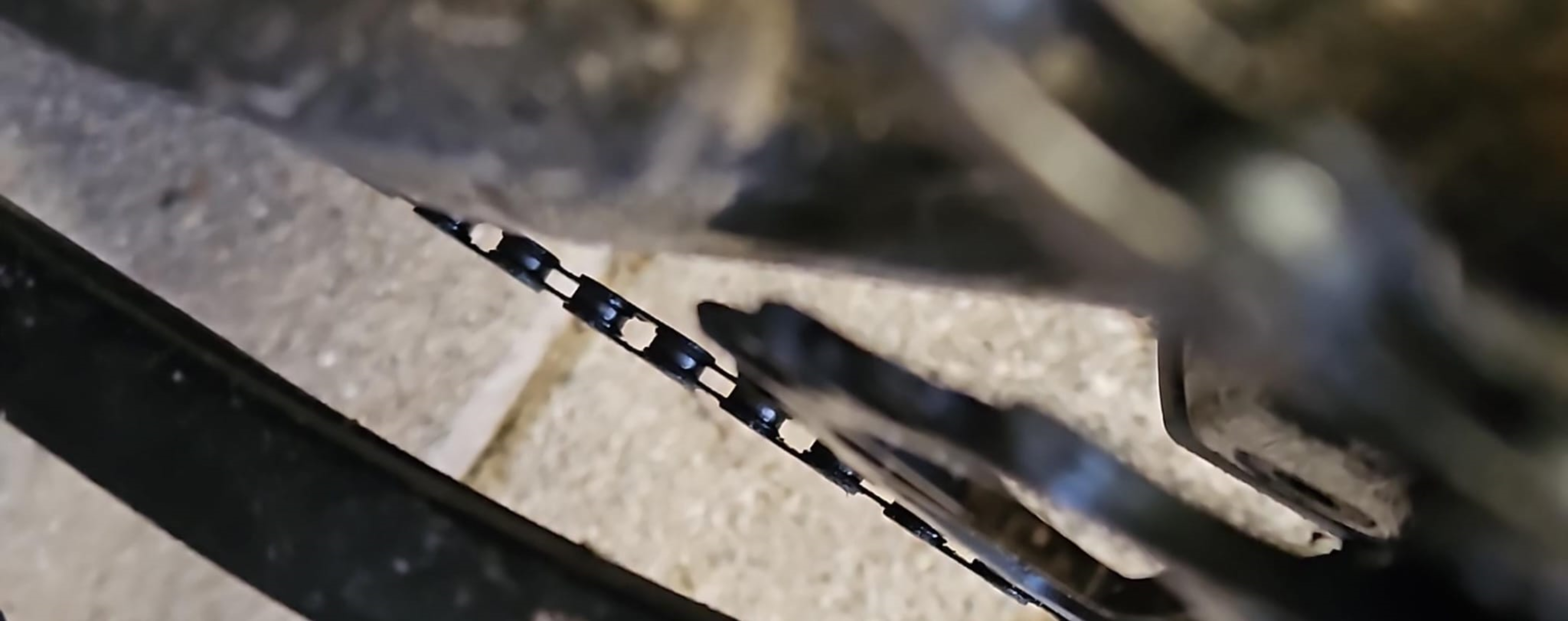

I posted a few photos in this related thread:
I've got over 500 miles on it and no issues. Great mod for the price.

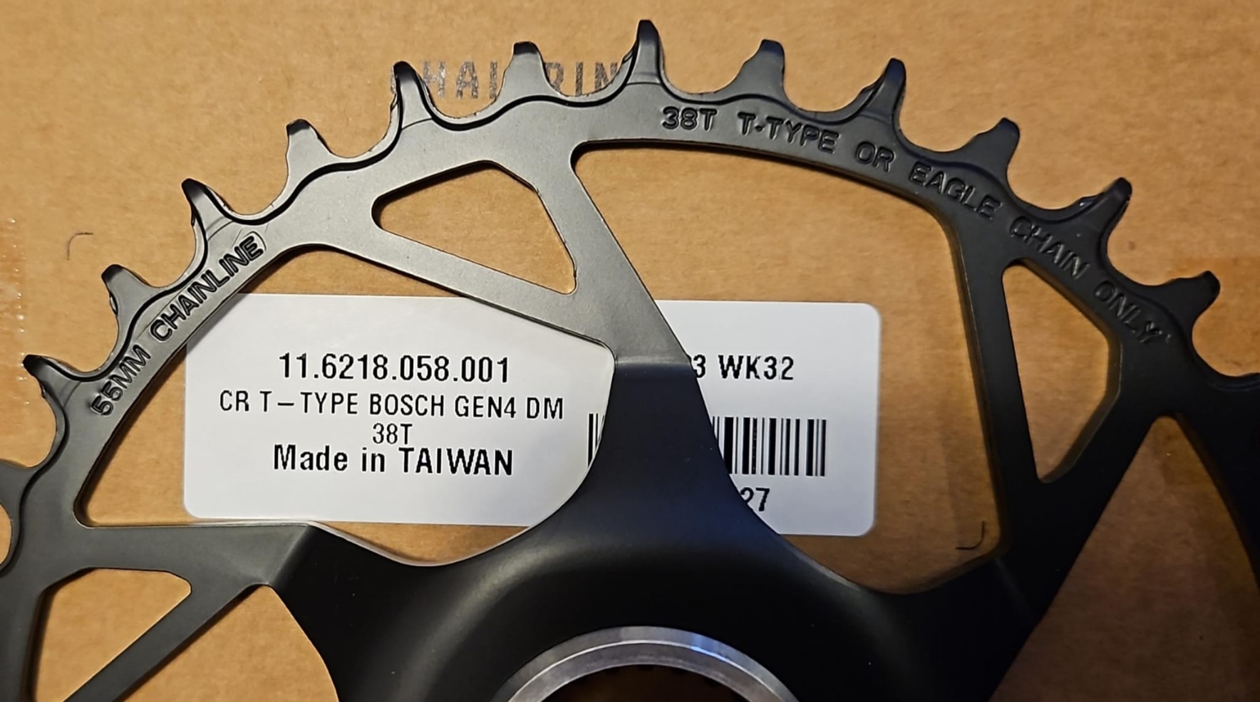

I also wanted to replace my original 34T chainring by a 38T on my Trek Rail 9.7 NX 2021. With help from this thread i found the Sram 38T 55mm chainline chainring: 11.6218.058.001
the gap is fine:
the gap is fine:

Does the chain roll off the chainring from the bottom when wheeling the bike backwards? Annoys the crap out of me having to loosen the chain guide to refit the chain...
Also no problem there, the only thing is that in first gear the chain is not really in a straight line, but i do not use the first gear a lot so i am happy. by the way, since i use narrow wide chainrings on all of my 1x bikes i never had to refit the chain
