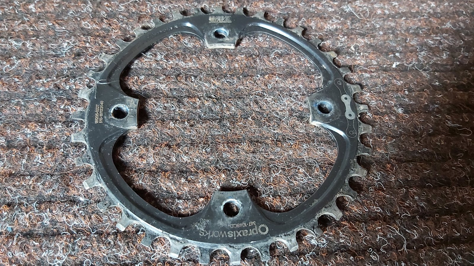

I ordered a replacement but as you can see in the pictures the mount holes on the replacement are not flat. They have a lip. This will not sit flat on the spider. Can anyone recommend a replacement for this bike?
Cheers.

Looks like the bike uses the standard Praxis Works MTN Wave 1x 104 BCD chainring not the Ebike version. :cautious:

Could be. It's the same weight as the one I ordered so must be steel.
I might just grind down the lip on the new one so it sits flat on the spider. Don't really know what else to do.

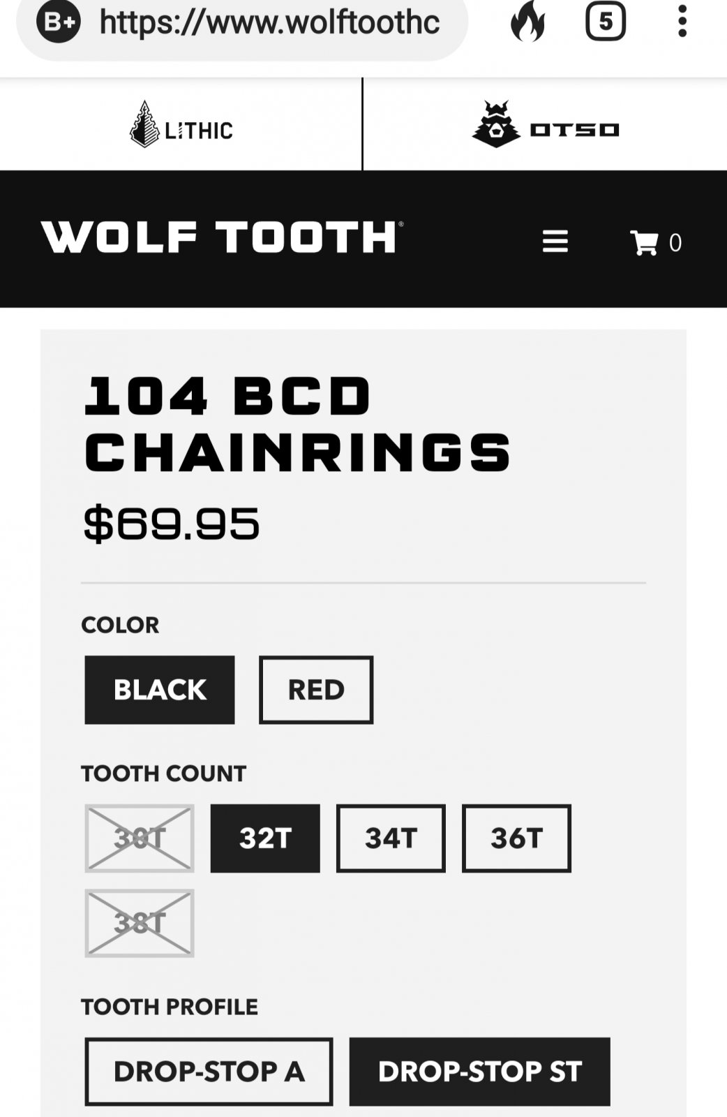

I think it was a wolftooth dropstop for the shimano 12 speed. I'll verify this when i get a chance.
Edit. It was this one and it Needed to be "popped." It's not gonna slide over easy, but It wasnt too bad.

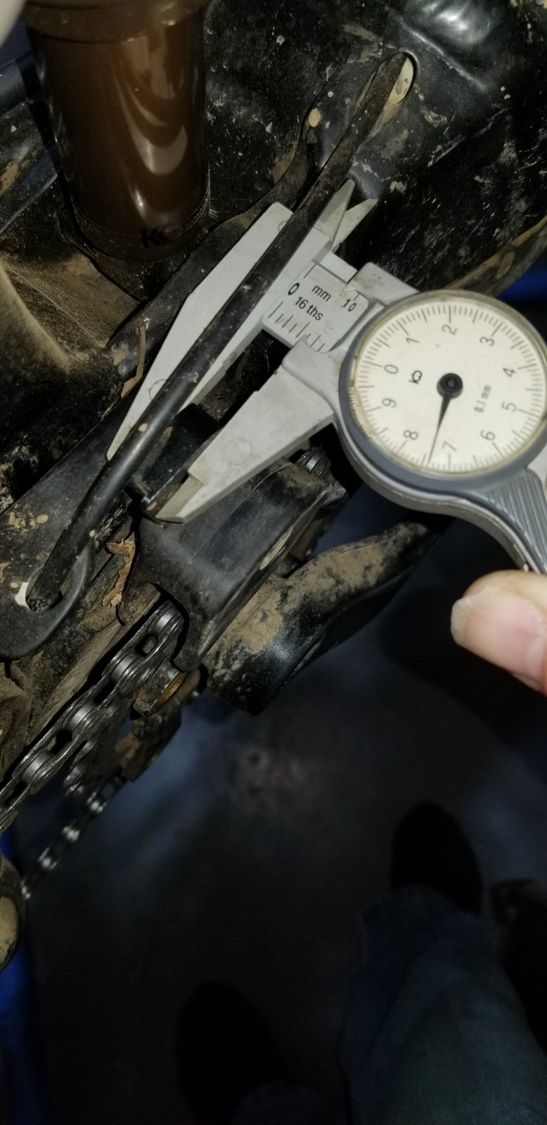

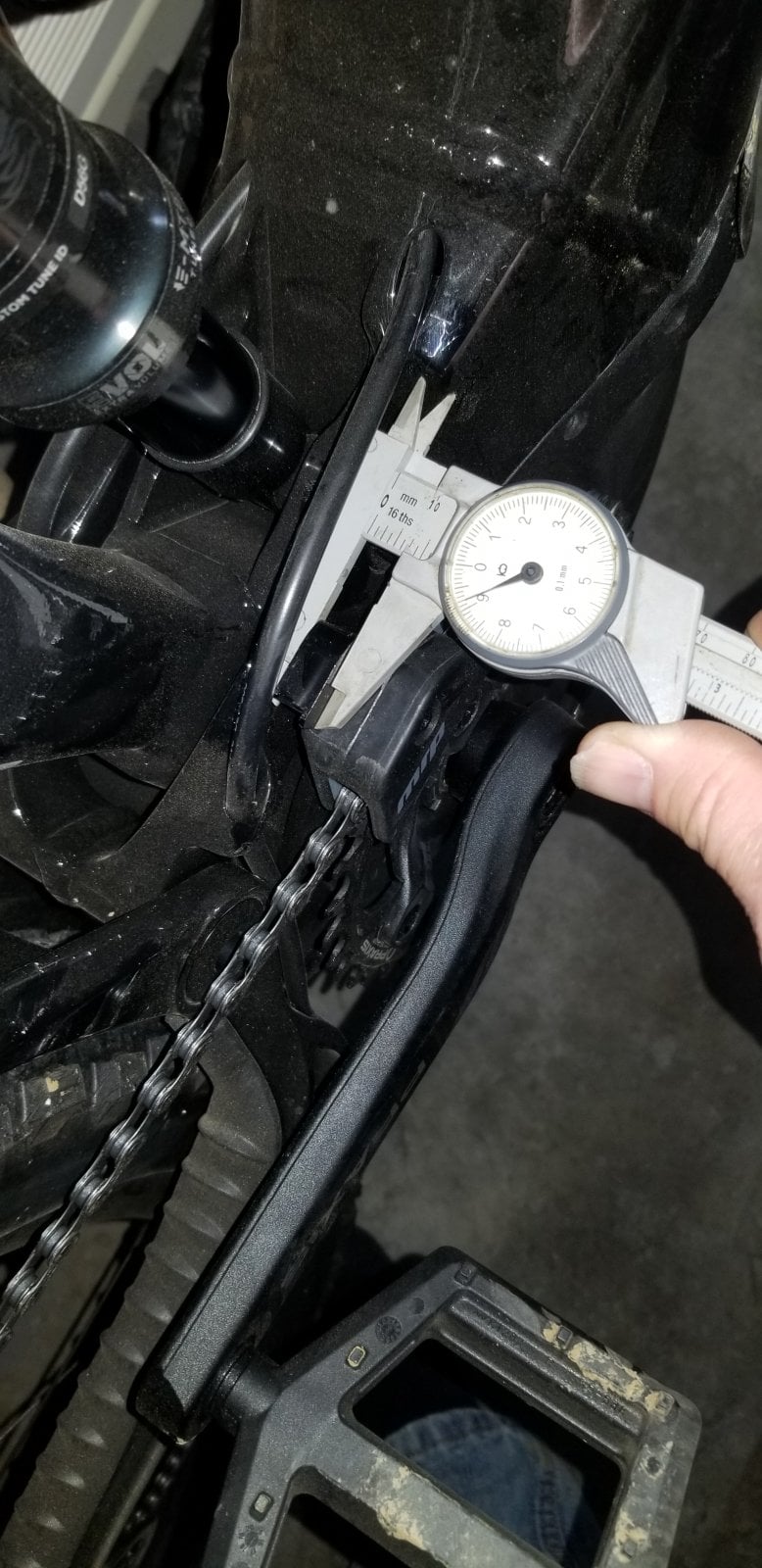

This is why you should never trust a gen-X-er. We are getting old and forgetful. Apparently I kept a 2019 chain guide from my first Trance e+ and installed it on the 2021 Trance X, as it fits better with the offset 32T CR.
Here is the OEM guide from my 2019 Trance installed on my 2021 Trance. Note the width of the bracket.
And here is the 2021 bracket on my wife's Trance X which is completely original equipment. The bracket is 2mm wider, thus positioning the guide further away.
