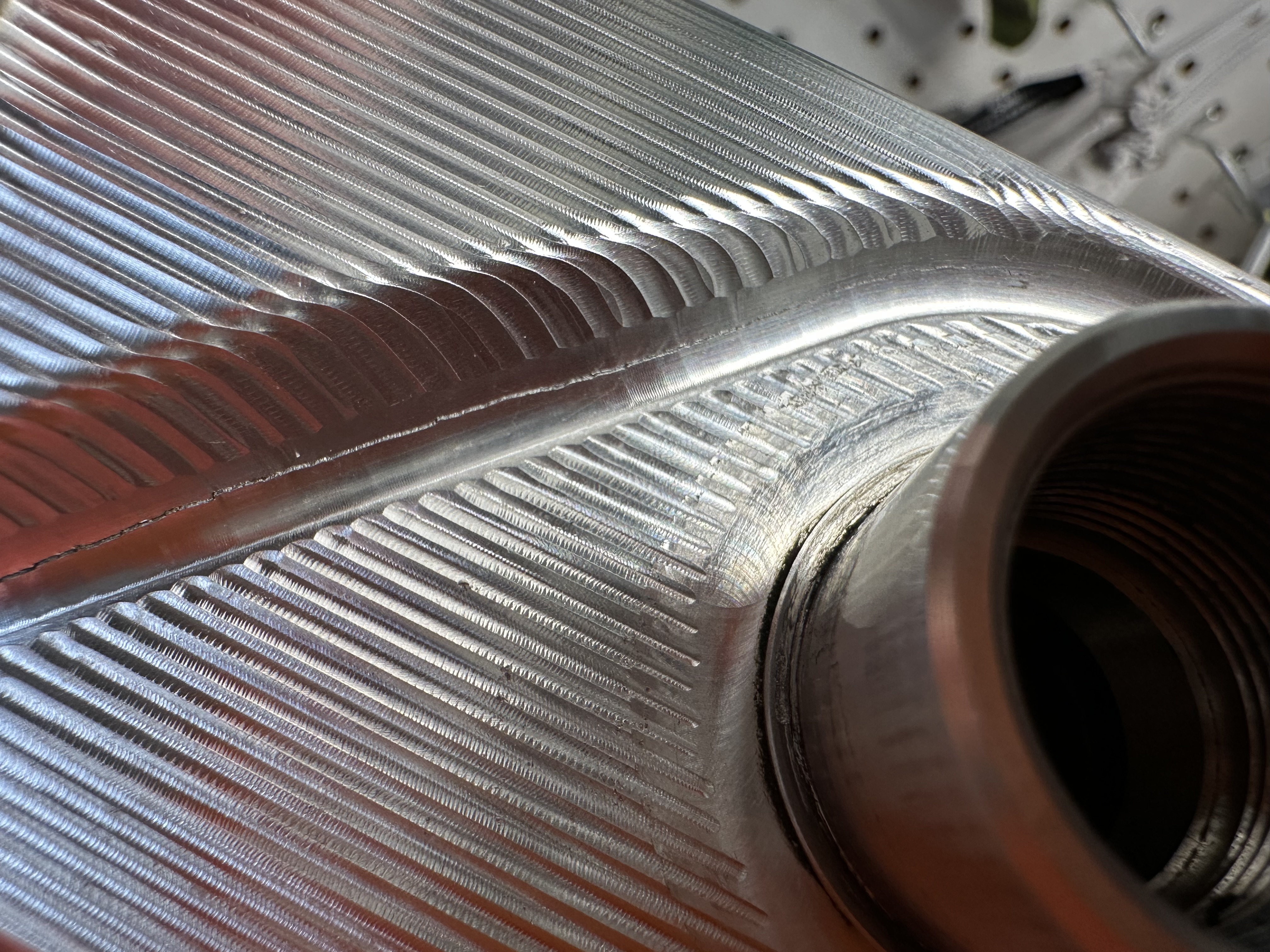

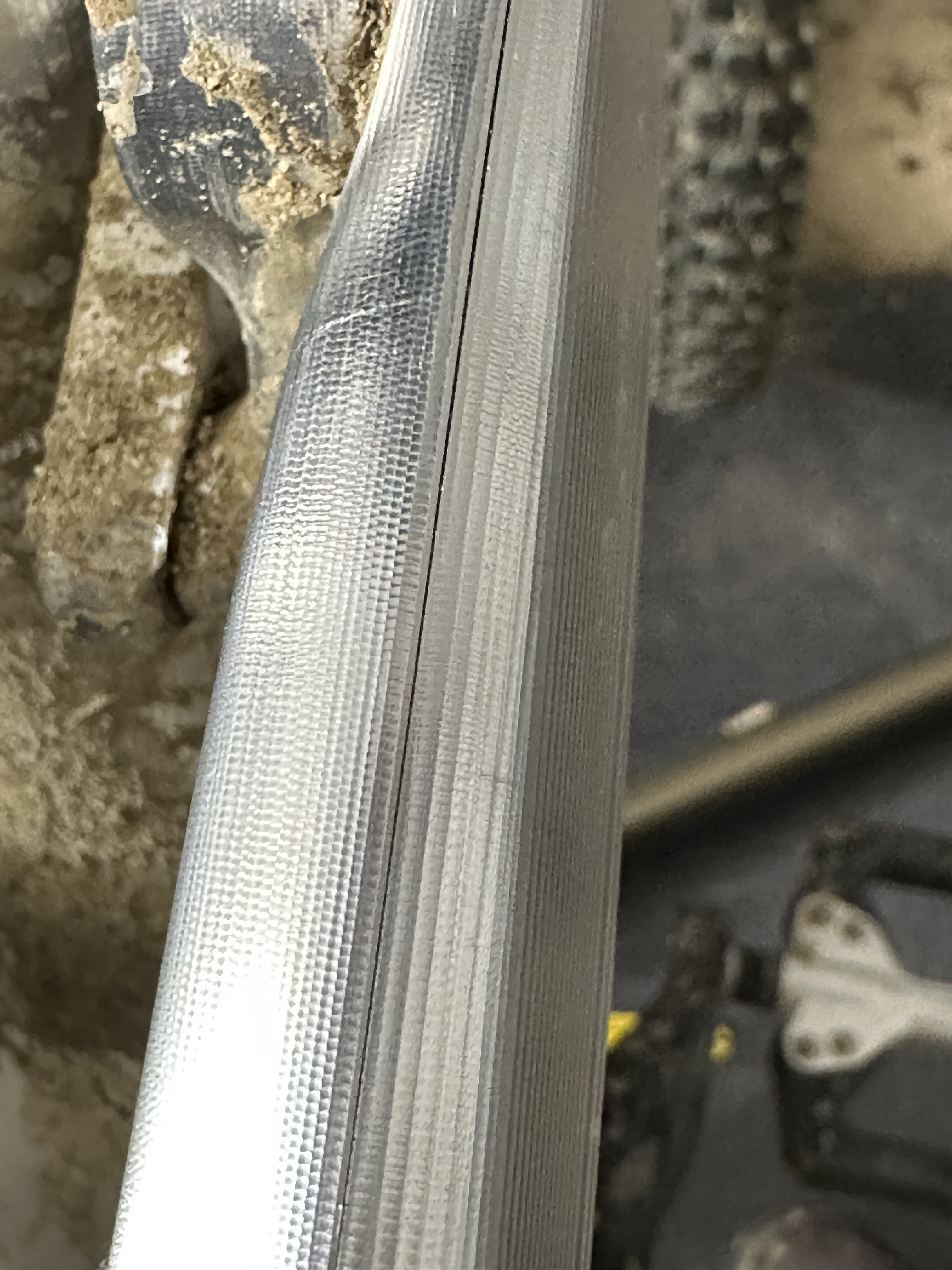

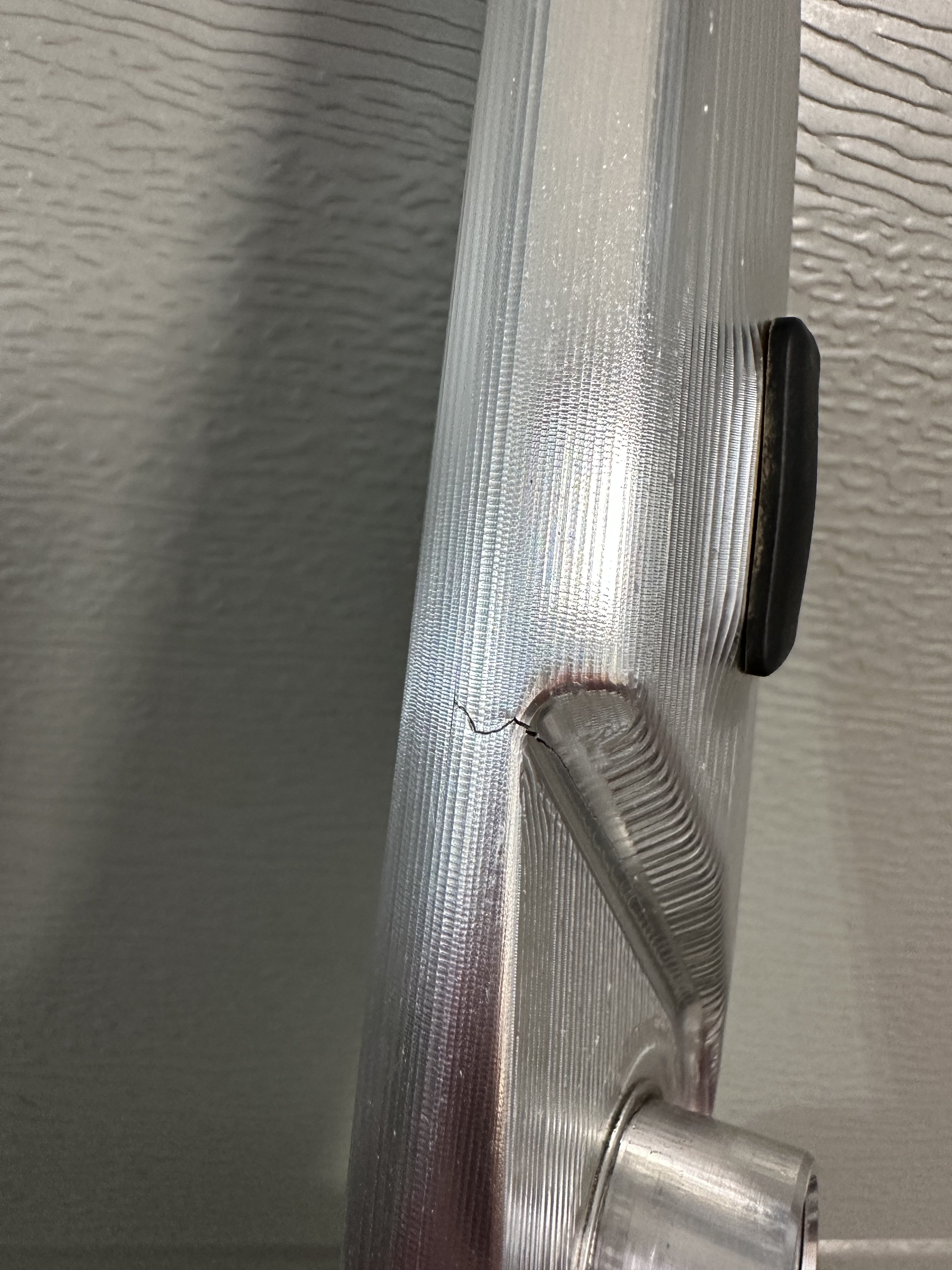

This is my right swing arm from my less than 6 month old Voima!! Noticed the arm was beginning to separate in the upper seam and crack at the rear link after my last ride. Pole wants to inspect the arm before they will replace 🤷‍♂️ will keep you all updated.

Hello everyone! It appears that the swingarm failure occurred at the pit designed for lower link clearance. Following the material failure, the bonding separates as the interface begins to bear most of the load. In some instances, even the link bonding may fail due to the uneven distribution of the swingarm load.
We've updated the swingarms on our Vikkelä bikes but haven't addressed this specific area yet. Receiving the broken parts is crucial for identifying the issue's root cause. The 7075-T6 production method sometimes results in quality inconsistencies, which could be the source of the problem.
As a high-end manufacturer, we're committed to providing reliable, top-quality products and ensuring customer satisfaction. Our 5-year warranty reflects this commitment and our goal to become a trusted name in the high-end mountain bike industry.
Our frames undergo rigorous testing, and while we didn't encounter this issue during testing, we recognize that our best-selling Voima model may still offer valuable learning experiences.

Hi guys. Looks like the swingarm has failed at the pit that makes clearance for the lower link. The bonding starts to separate after the material failure because the interface starts to carry the most load. In some cases even the link bonding fails when the swingarm load starts to be distributed unevenly.
