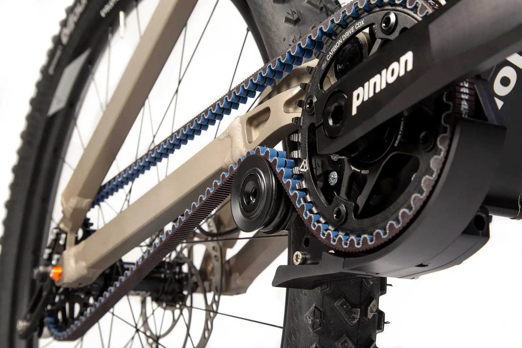

Update: Above image says it all. Taken without permission from V86.
A number of people in this forum are expressing interest in some form of internal geared transmission system integrated with Pole EMTBs, whether it be new-fangled motor/gear units (MGU) or hub-based integration with a secondary objective of eschewing chains in favor of a kevlar-based belt drive. There have been a number of posts on this topic that I felt it the need for a separate thread to discuss this rather than clog up the other threads.
From a product perspective, it is clear that having a combined internally geared transmission system with e-bike motor in a single mechanism (i.e. MGU) is the best synergistic confluence of bike technologies for full-power EMTB. Combining these two technologies affords an unsprung, automatic transmission, sealed mechanism, low-maintenance drivetrain solution and can open up the option to use belt drive instead of chain linkages and dangling derailleurs. Additionally, the downsides of internal-gear solutions, such as added weight and reduced efficiency, don't rear their heads as much with full-power, enduro-sized e-bikes, as they are already heavy and power-assisted to begin with.
But... we have to wait for this technology to develop, mature, and become reliable, and without the big players entering the market (SRAM, Shimano, Bosch) placing bets on a particular solution for a boutique bike manufacture may be too much to currently entertain. Poles' EMTB product space is arguably too crowded already with quite a bit of marketing effort put forth to distinguish the brand new Sonni from the still relatively new Voima. Pole currently has no internal gear offerings and it’s not clear if Pole would create a new EMTB model or graft a solution onto its existing offerings at some in the future. Of course, we could abandon Pole and jump to the likes of Bulls Bikes (or maybe Orange when gets is prototype out the door) to get an MGU fix, but we'd also be abandoning the affinity to Pole's geometry, design, performance and manufacturing prowess.

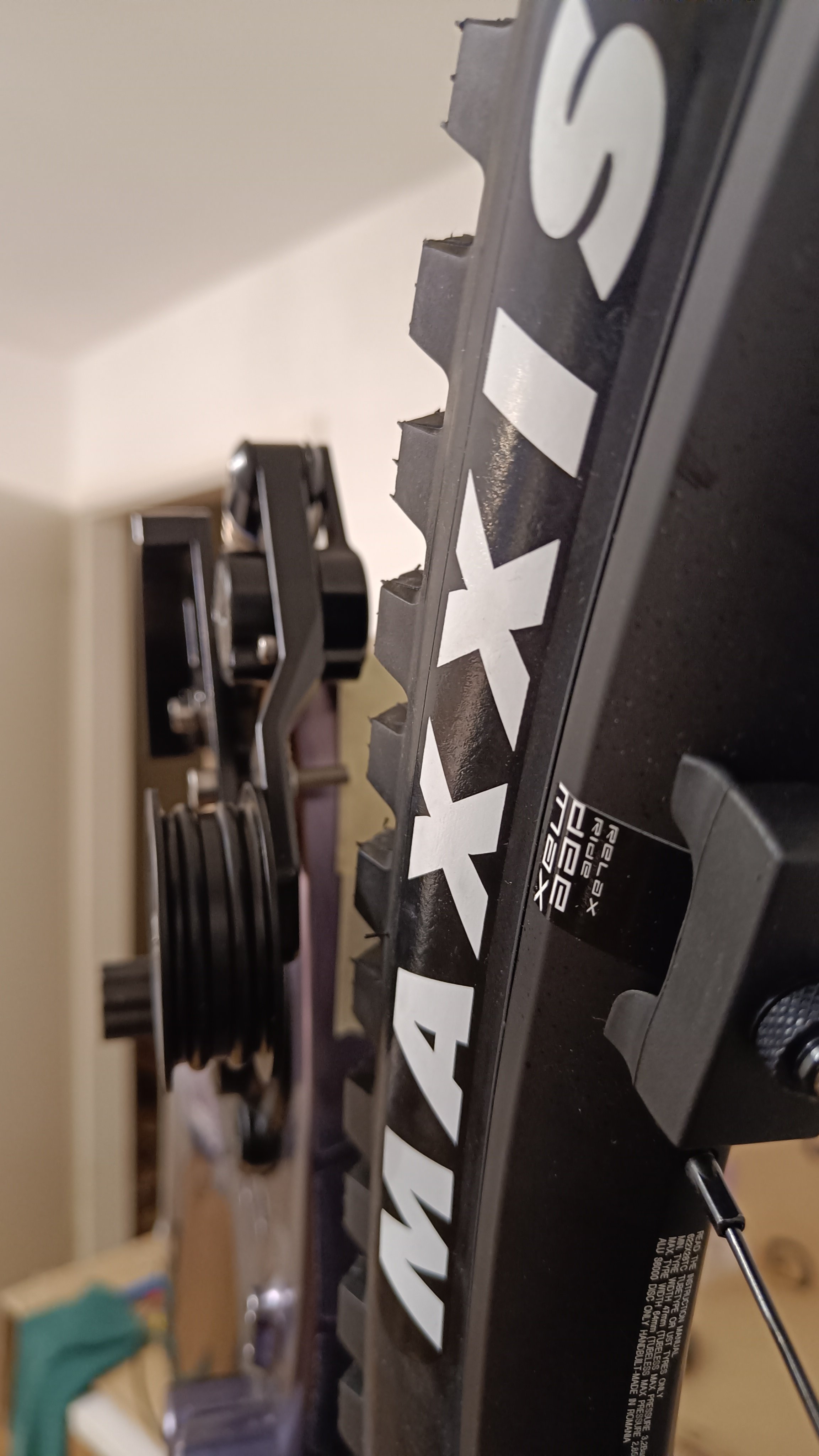

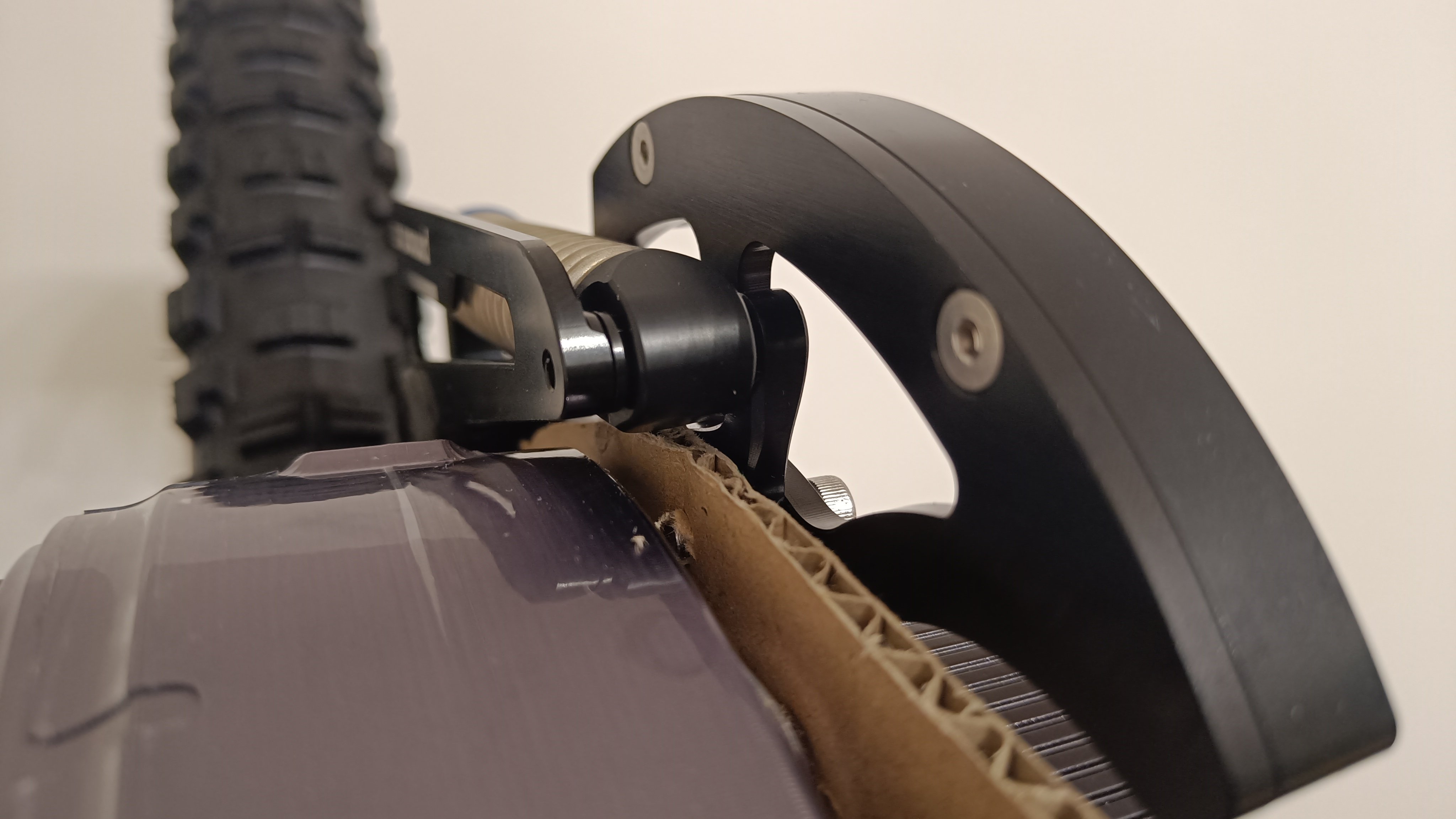

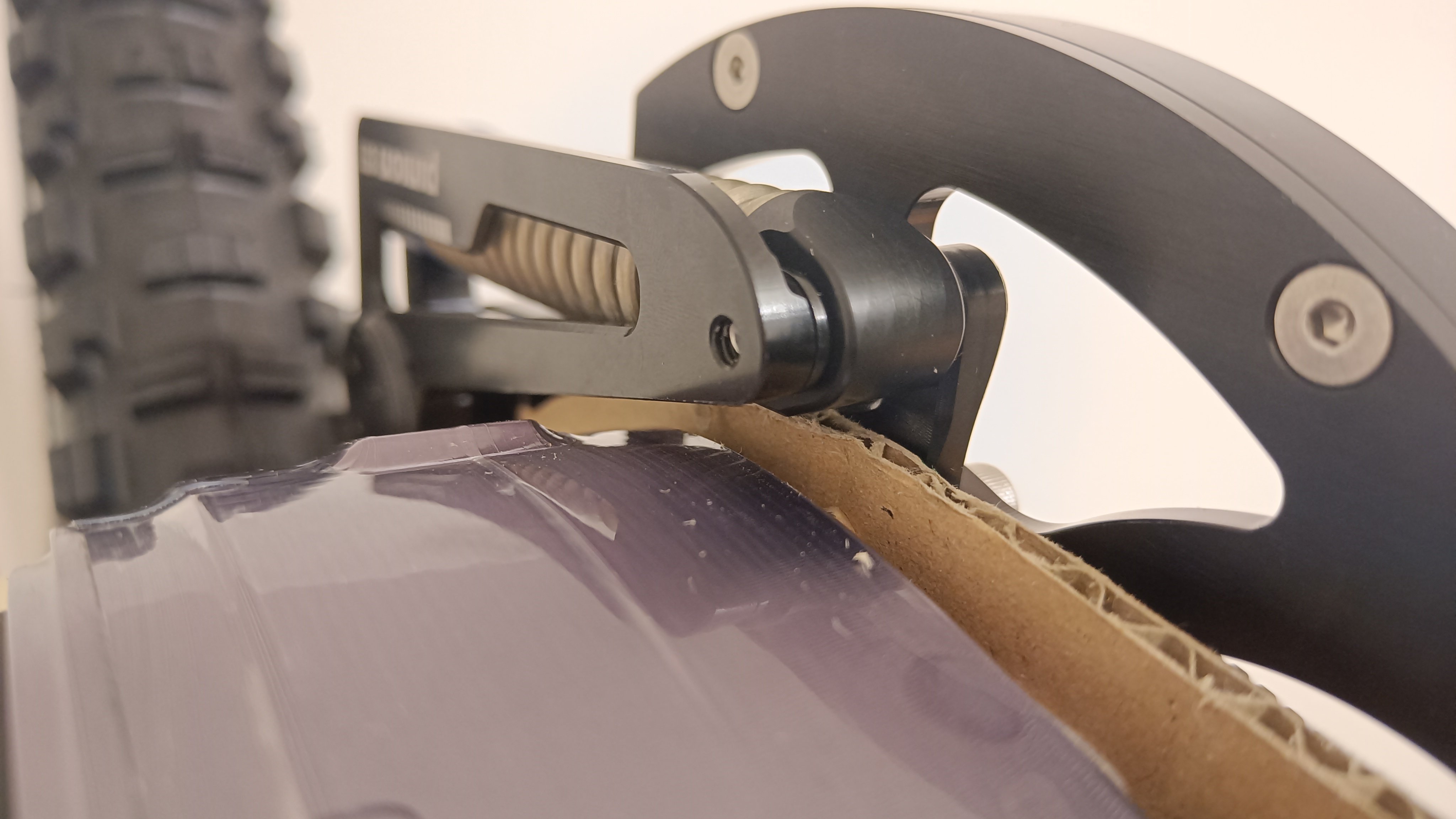

In meantime, I'm exploring getting close to nearly 90% of the MGU benefit by incorporating an internal geared hub (IGH) and integrating it with the Bosch motor via a Gates CTX belt-drive. The target bike is a Sonni K1, which I have on order, and it will probably be sometime in November before it arrives. For the IGH, I'm strongly in favor of using the Rohloff Speedhub, for a number of reasons, namely that I’ve been using a Speedhub for about 8 years on my acoustic dual suspension MTB (see below) with flawless performance and near-zero maintenance.
I would like to hear how others feel about alternatives such as Nuvinci, Nine 3x3, Kindernay, etc. I’ll also be exploring electronic shifting as part of the solution, as this would be implied with an MGU setup, not to mention that a lot of folks are choosing AXS/DI2 electronic shifting on their current rigs. My intention is to add to this thread with my findings and welcome feedback.

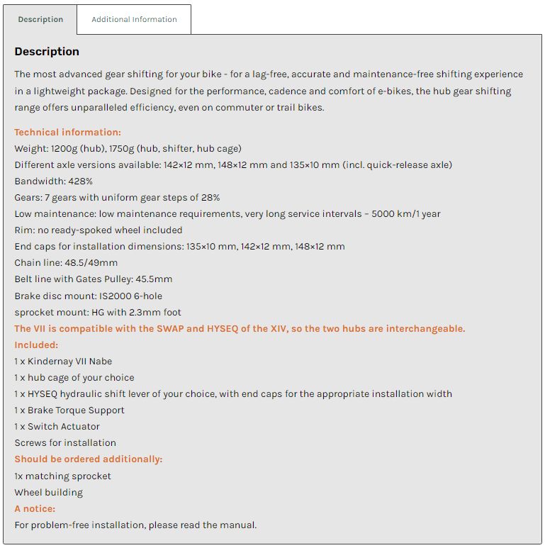

I have done some digging on Kinderlay Hub. There are two options: 14 gear version with a range of 548%, and 7 gear version with a range of 438%. Other than the number of gears, range, weight and price, there is one crucial difference: the KInderlay VII used a normal 6-bolt disc brake rotor whereas the Kinderlay IV uses a proprietary 7 bolt system.
The shifting is hydrolic so some bleeding is involved if routing the two necessary cables through the frame. I have found no mention regarding electonic shifting.
Some interesting info could be found on the German distributor's website: Kindernay VII – trail.camp

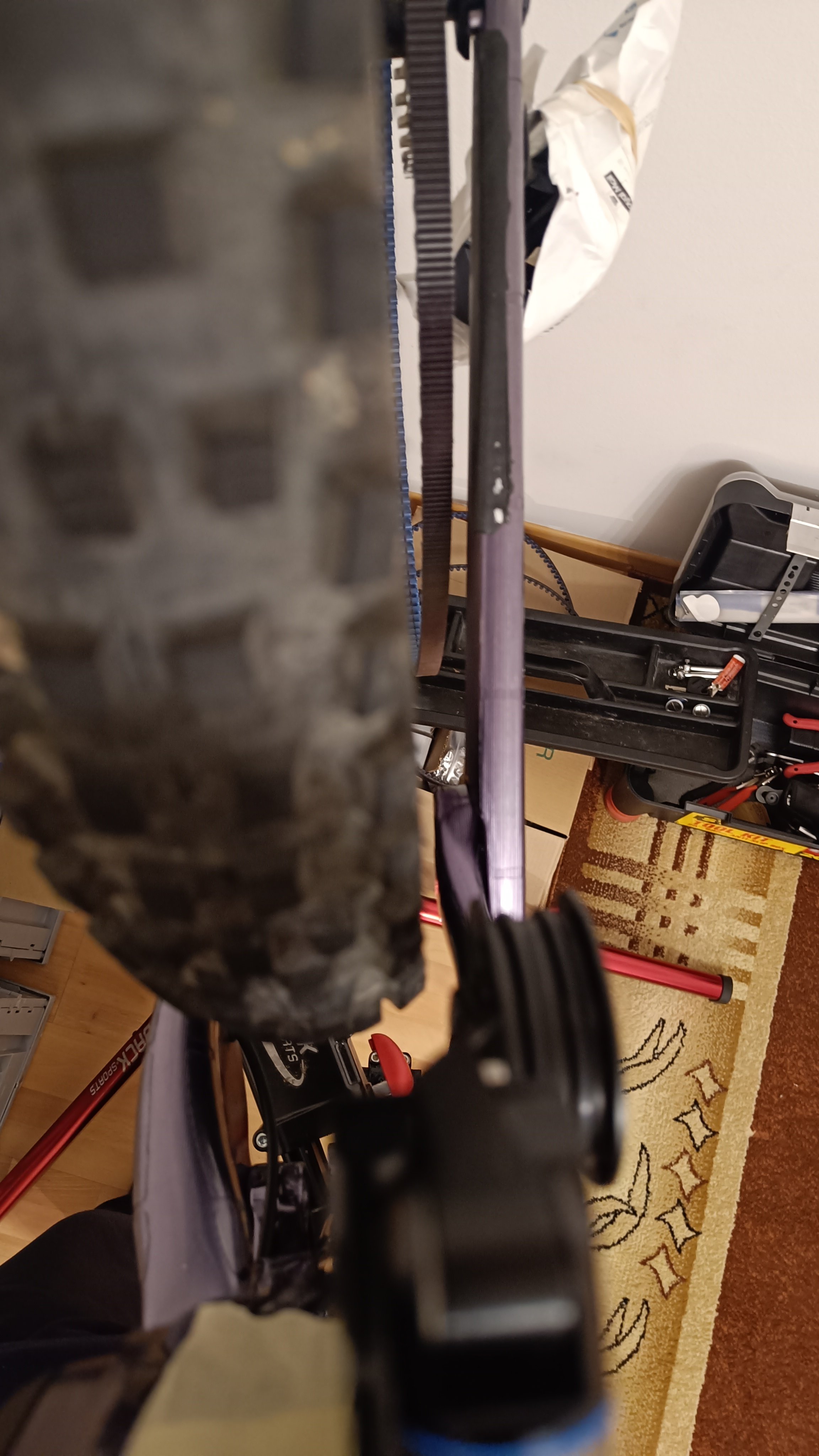

One thing that worries me is that the chainline for Gates Belt is 45.5mm. I am not sure what's the achievable chainline on Voima or Sonni but from my own experience with Gates belt, the chainline needs to be perfect. Perhaps there is some room for adjustability, I am not sure myself.

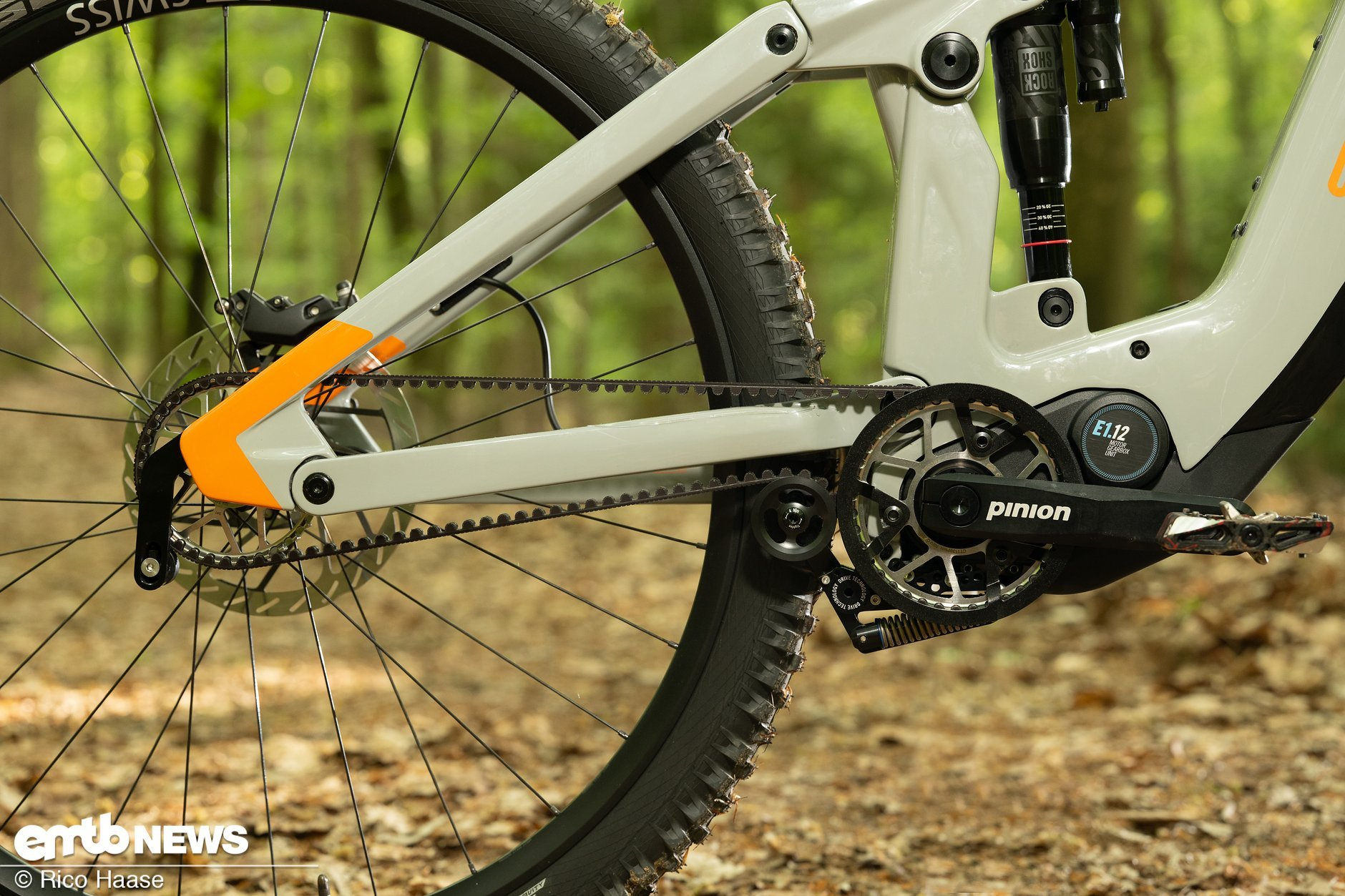

Too bad neither the Rohloff or Kindernay didn’t use a belt drive on the examples shown.
tooFATtoRIDE
Sep 18, 2023
63
54
North by Northwest

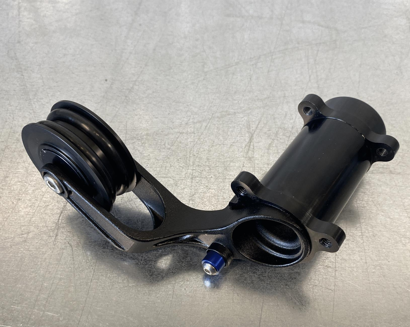

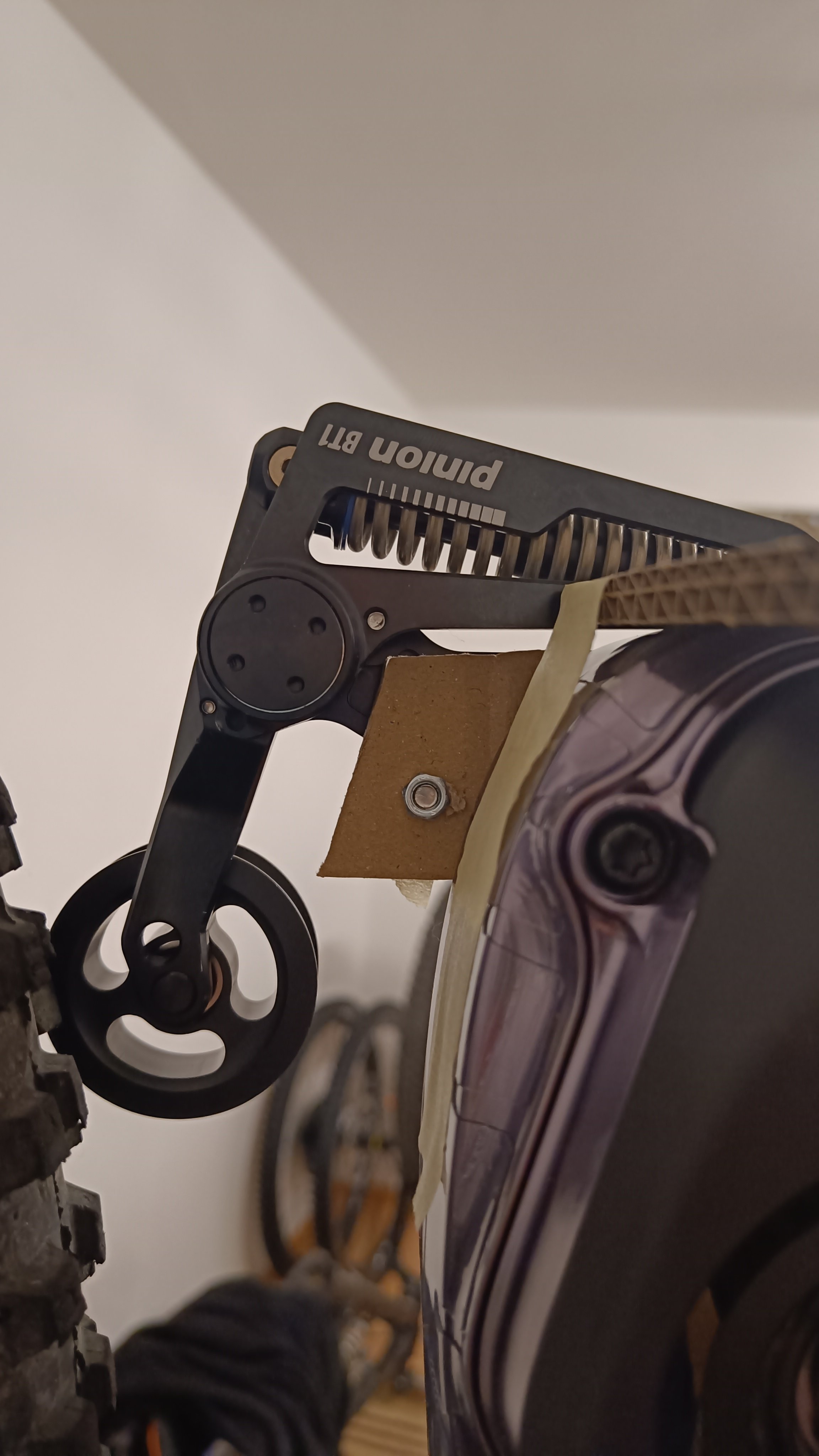

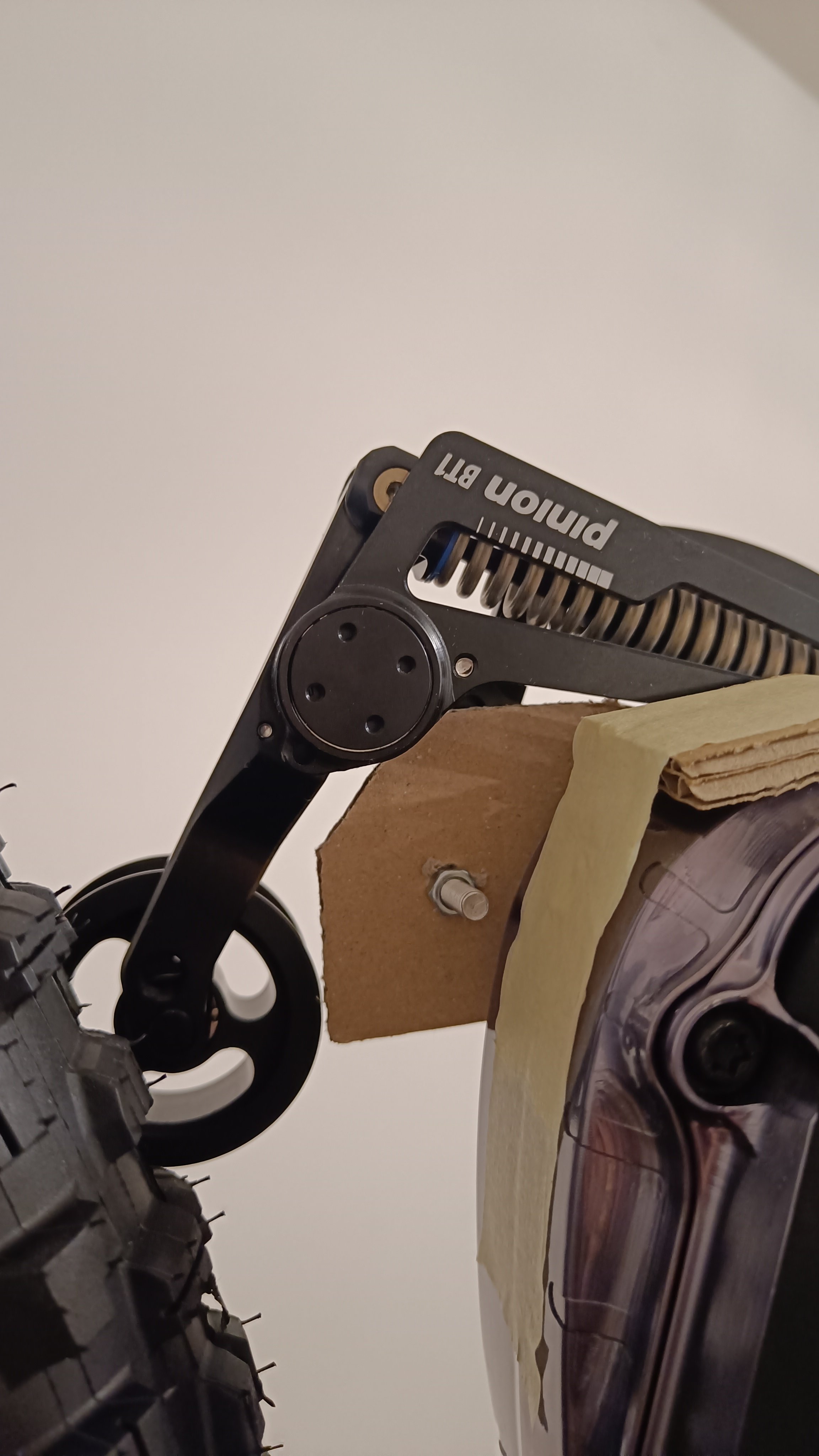

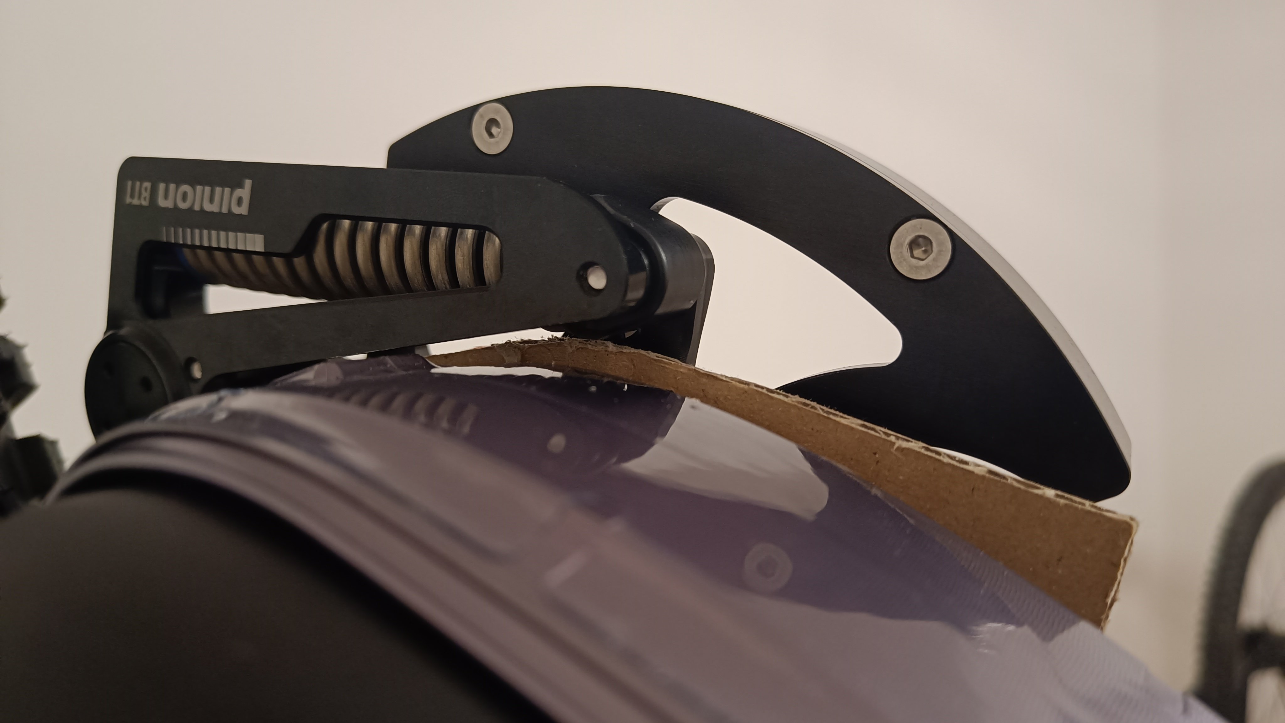

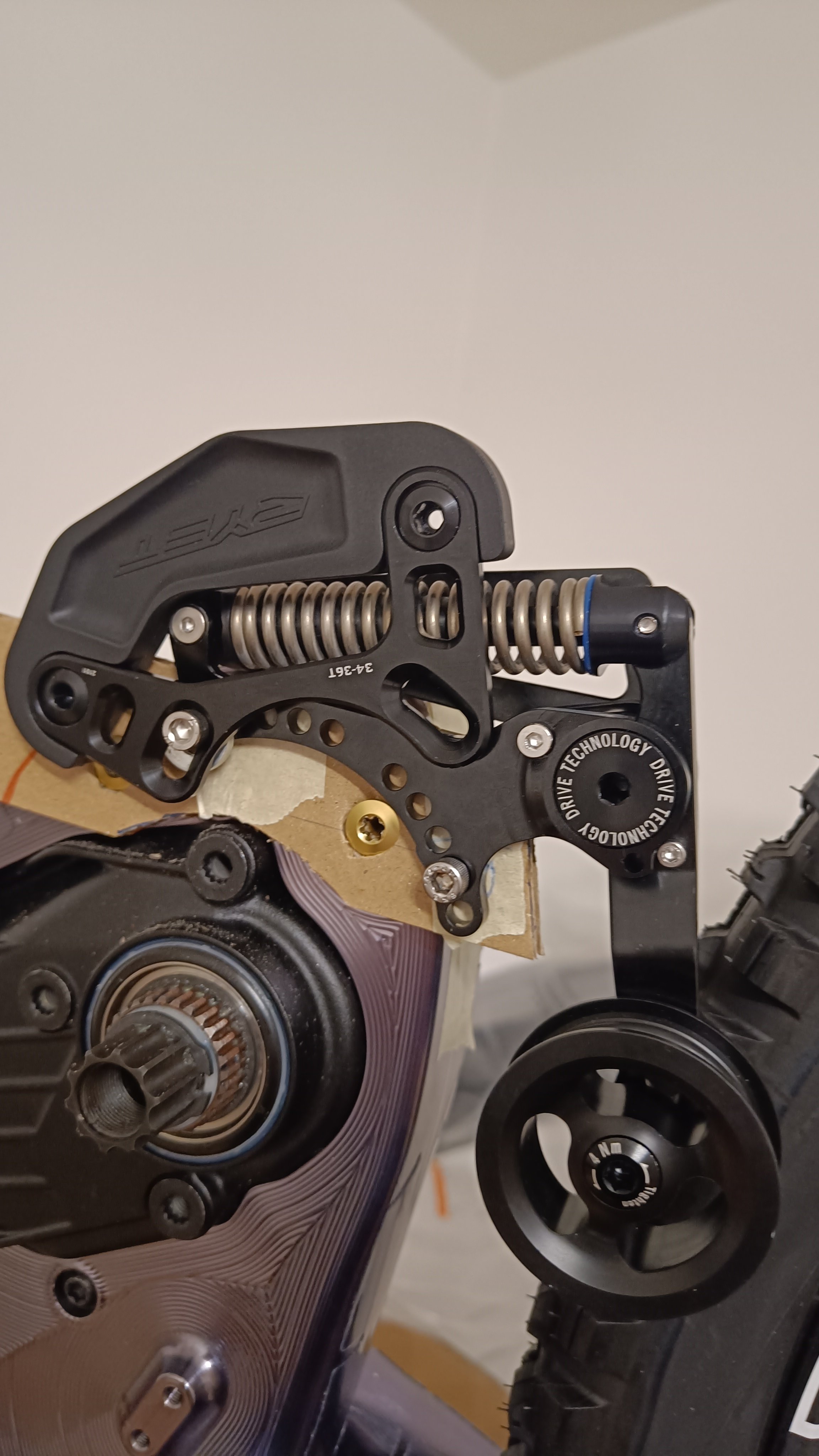

I think the key issue here is finding a suitable belt tensioner.
I think the reason for it is a lock of options for belt tensioner. There is one for Pinion (PINION Riemenspanner BT1 Gates CDX Art.Nr. P8555) but I am not sure if the mounting hardware would be a straight fit for the two bashguard mounting points on Voima. For Sonni, my knowledge is non-existant so I cannot comment.
Even if the mounting hardware was a straight fit, the position would not be optimal. Probably the best current execution of this tensioner could be seen here:
It is not as exposed as noted in other Pinion equipped bikes but still in the way of potential rock or root strikes.

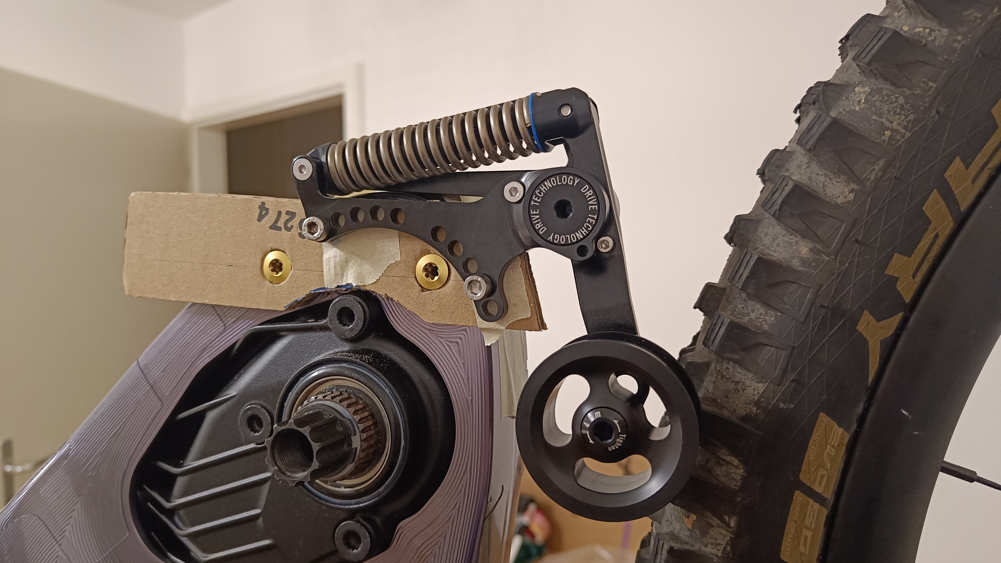

I have found this on our forum but I do not think this type of tensioner would be of any use for Pole bike owners.

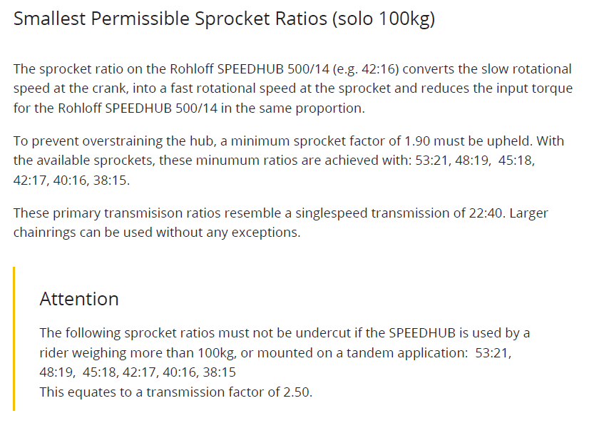

For those interested in Rohloff, it is worth mentioning limitations to the sprocket ratios:
I mentioned this as with a large front sprocket one might have its edge extending beyond either the frame (Voima) or the engine (Sonni). No big deal, just need to keep in mind that a bashguard could be useful.
If someone one here has any good connections with the Nicolai Bicycles team in Germany, it is worth inquiring whether the would sell their GBT3 belt tensioner for non-Nicolai users. The benefit of that particular tensioner, if you are ok with having 39t the max size of your sprocket, is already integrated bashguard. Obviously the question remains if it would fit.

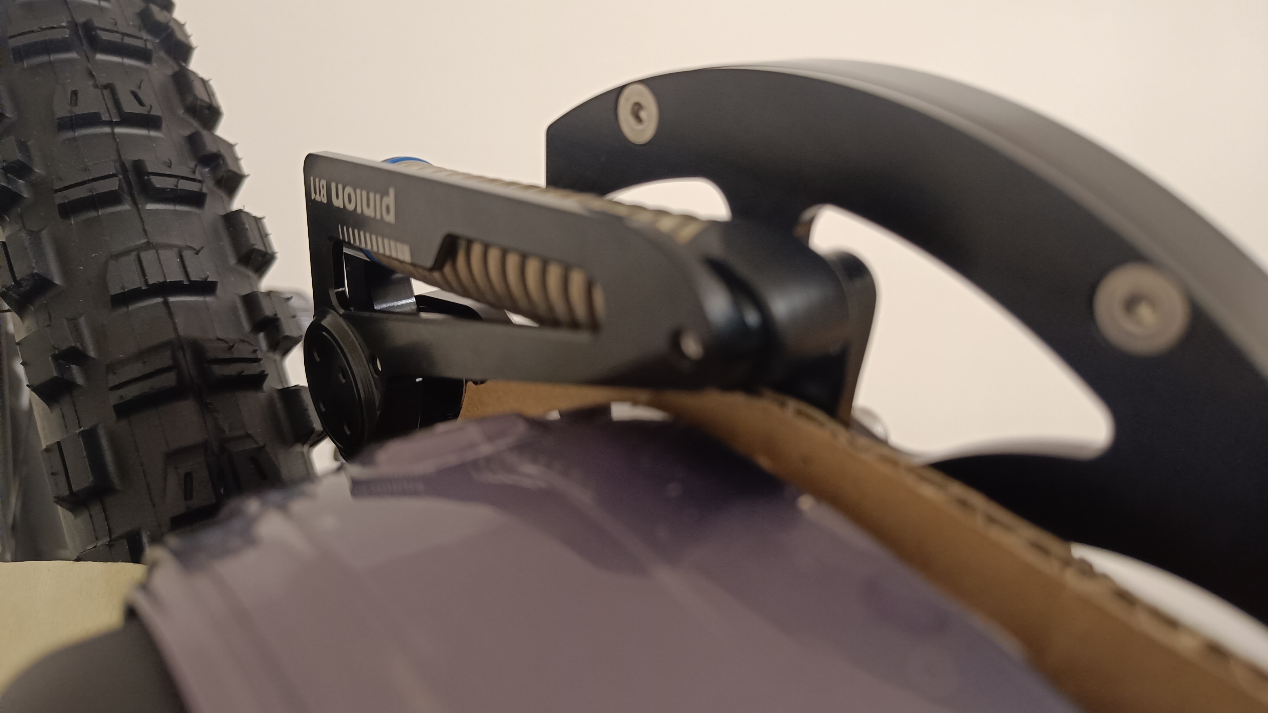

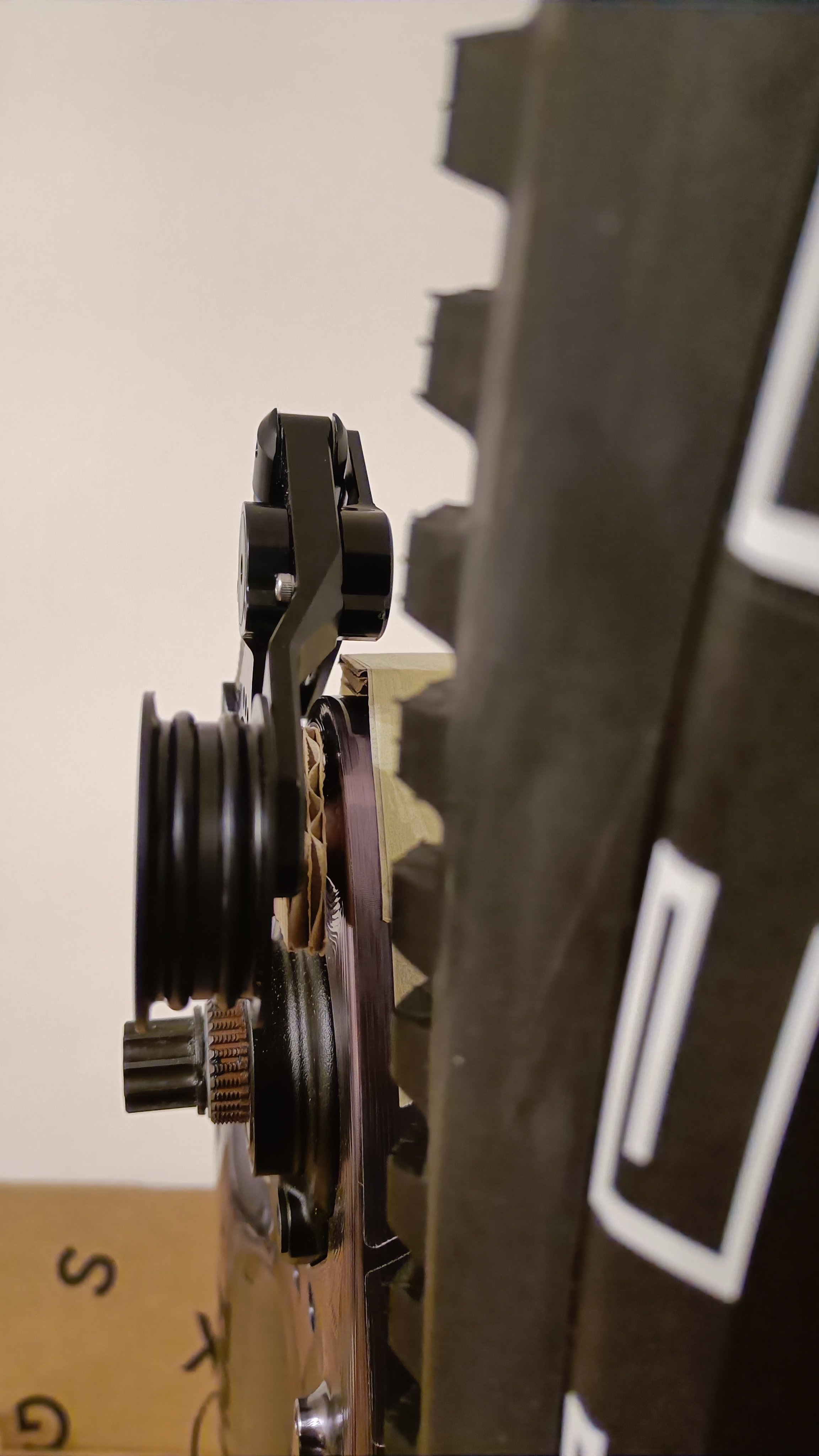

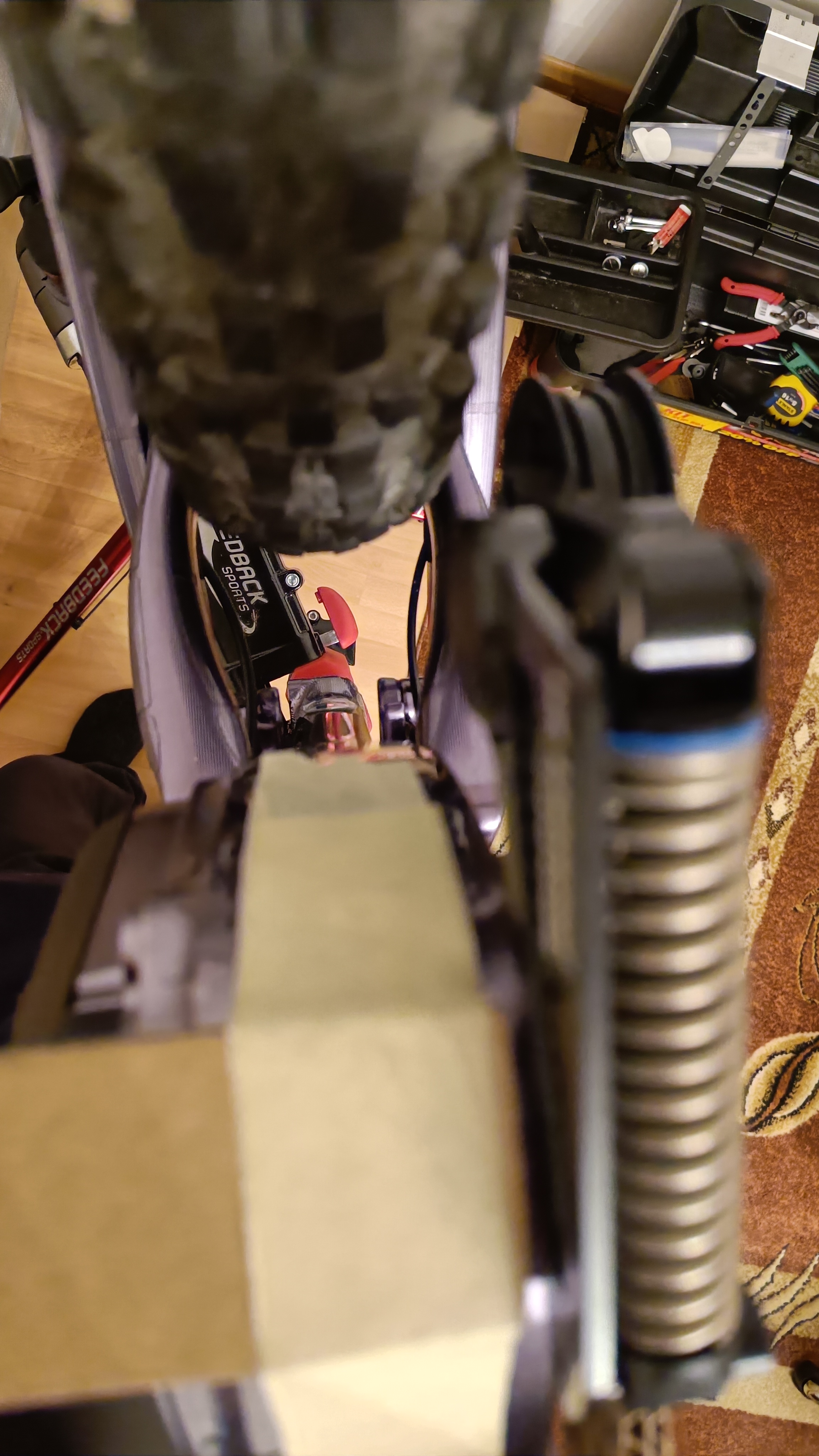

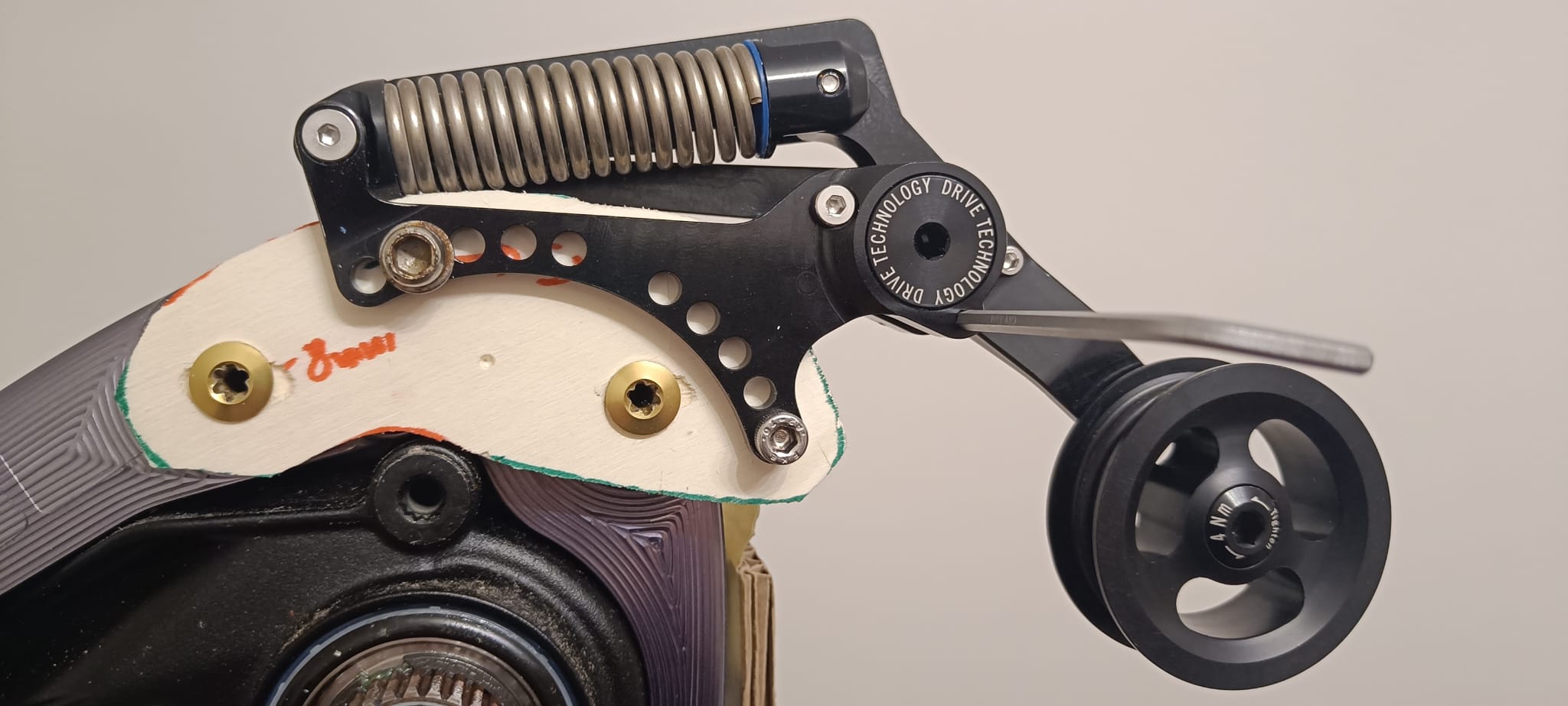

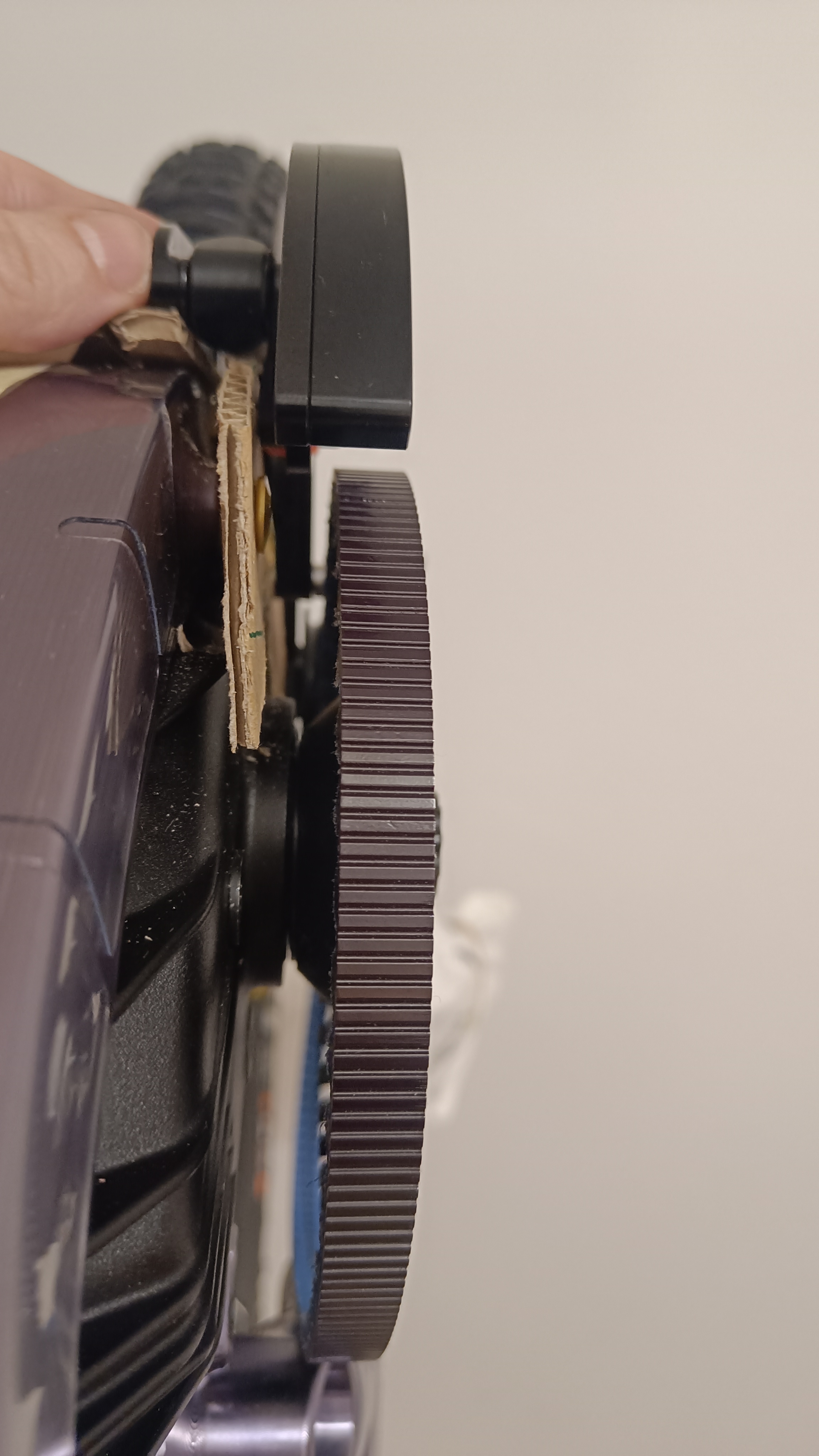

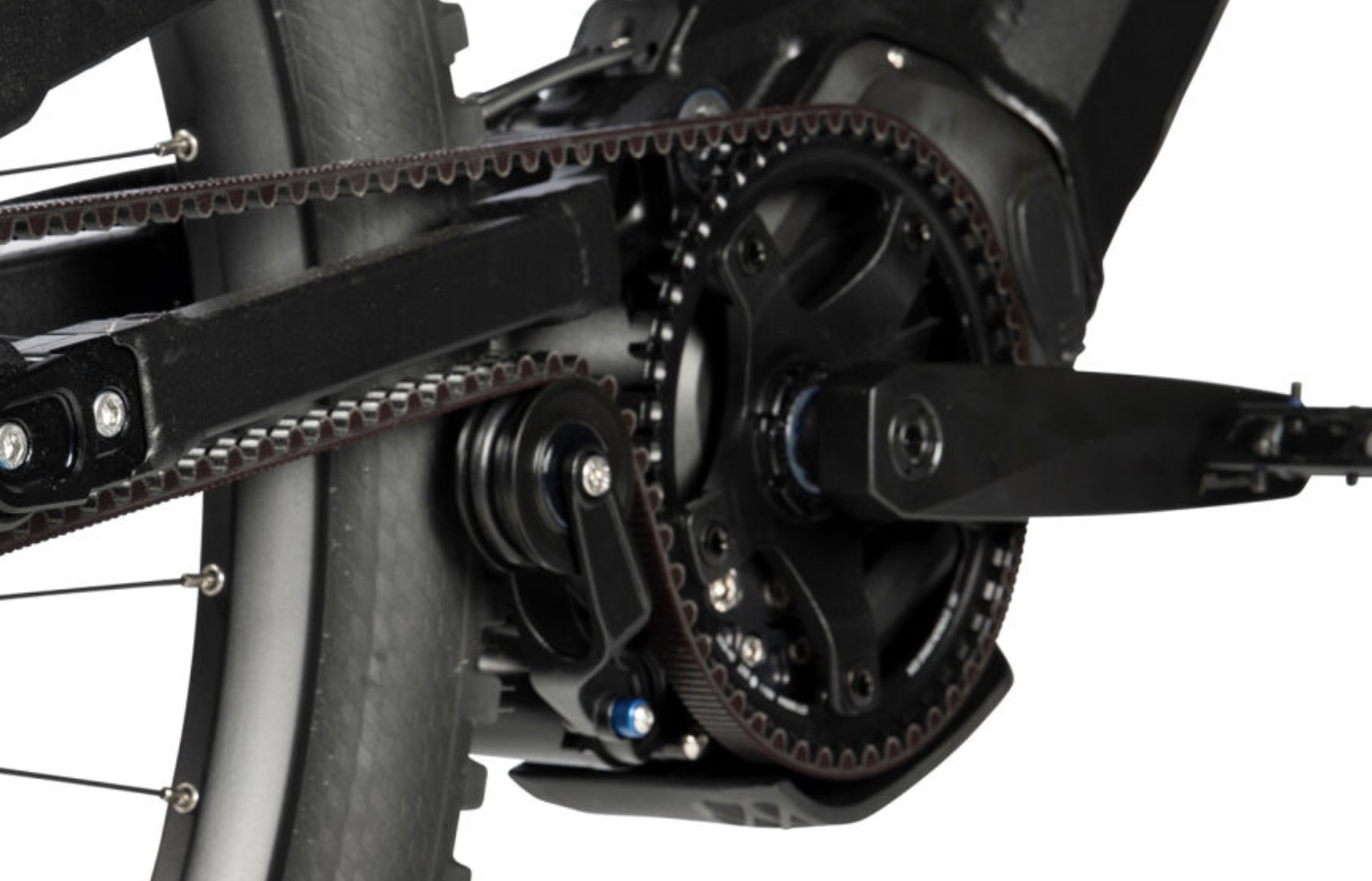

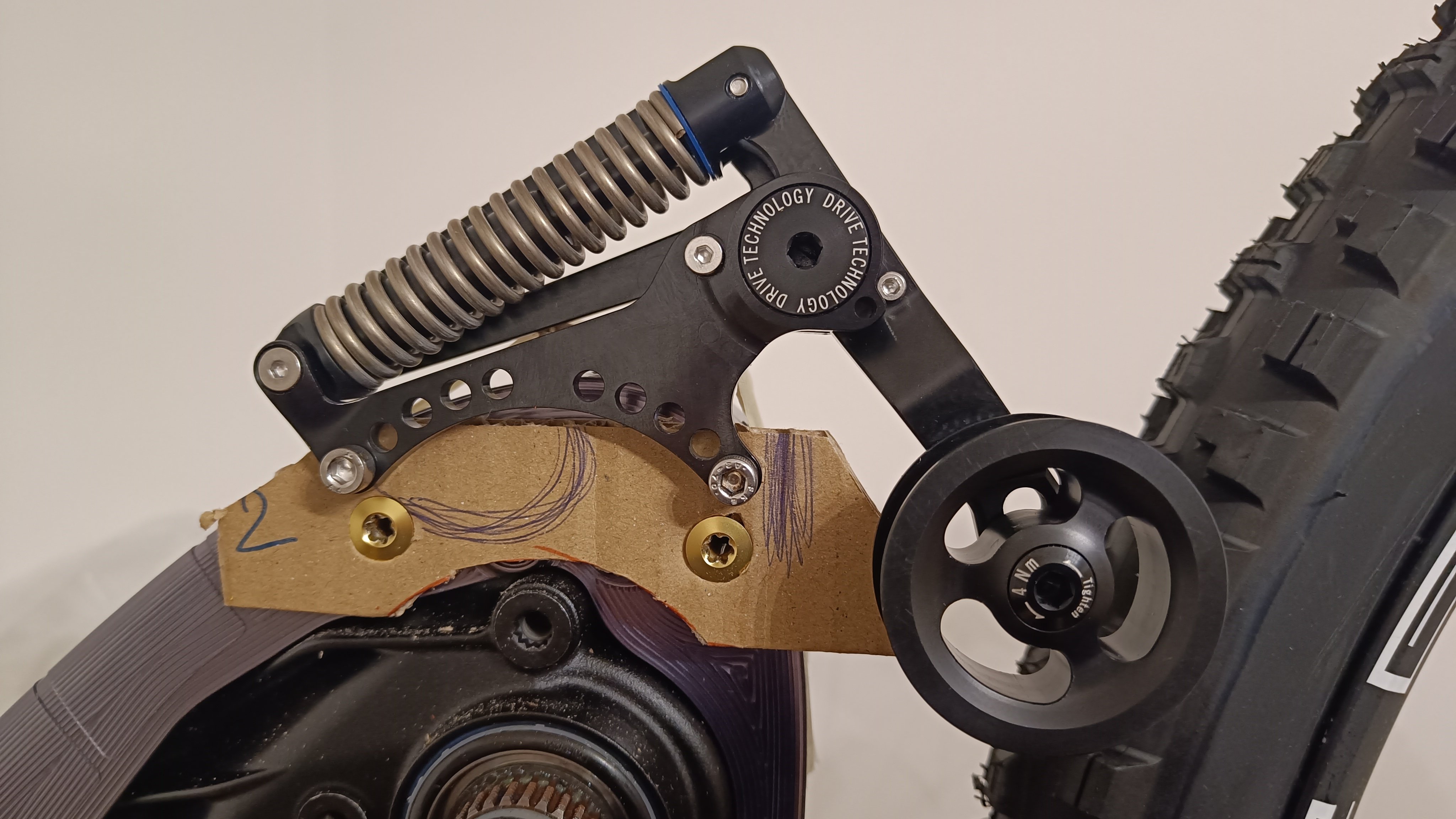

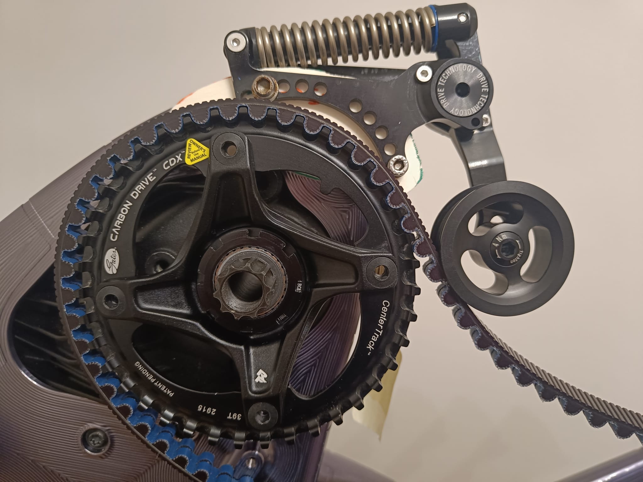

Yes, the belt tensioner is the the most difficult part of the solution to overcome, IMHO. And not all the solutions out there appear that elegant - as witnessed by the tensioner for the Pinion MGU, which is in a positively dreadful spot.
As mentioned, Nicolai would appear to solve the bike tensioner puzzle, especially their newer version, which appears to have these benefits:
  1. Works with the Bosch motor.
  2. Looks to be bolted onto the same mounting points of the motor itself rather than on the frame, which is critical for it to work on a Pole.
  3. The design seems to have improved, where the spring mechanism in now tucked transversely and safely behind the motor rather than under the motor where there is a high risk of strikes. One hopes that there is enough space between the motor and rear tire for clearance. A mullet configuration may help in this regard.

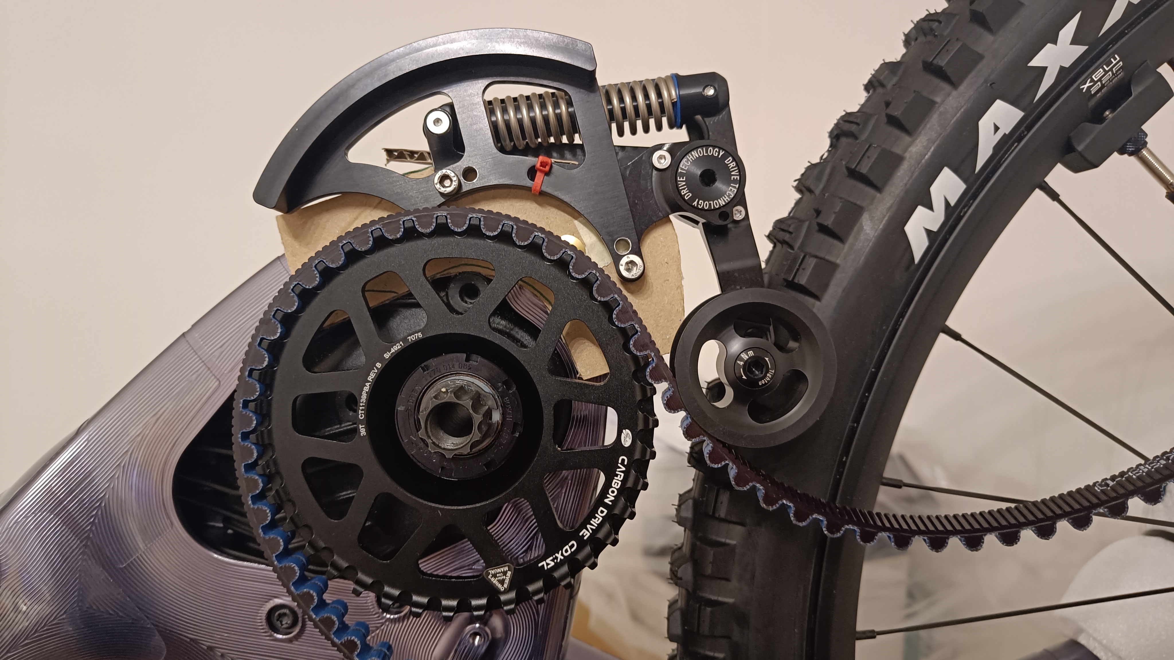

  4. Because of the transverse mounting, the tensioner appears is also bolted on the opposite side of the the motor as well - An impressive and aesthetic design stroke to say the least. OTOH, it might prove more challenging to install on a Voima or "jock-strapped" Sonni, not to mention possibly limiting belt alignment tuning.
I've looked a a number of tensioner systems, but pretty much all them have been disqualified because of not complying with 1 and 2 above. Except Nicolai (do share if there are others out there that could work). I'm not sure but I believe the tensioner is made by Universal Transmissions, which looks to be German Gates distributor as well. I've reached out to them but their relationship is tight with Nicolai, so they suggested I reach out to Nicolai, which I've yet to do. It's a bit a of delicate play to ask for a company's custom bike part without owning their bike.
Of course all this nastiness could be avoided by just going with chains for internal gear solution, of which there are a number tensioners to choose from, but I feel belt drive to be an essential motivation to pursue this effort to begin with.

The Kindernay play is interesting and thanks for providing some more detail here. Looks like the product has advanced a bit in the last 3 years, especially the VII hub which seems to be well suited for EMTBs. I like that it's a much lighter hub, which would help in the unsprung weight department. The VII is markedly less expense and I like the hub cage concept a lot. But there are other issues looming:
  1. The hydraulic setup and shifter seems to add a chunk of weight back into the solution. The design uses 2 hoses for shifting up and down, which IMO, could have been designed with only one hose (I get 2 cables, since you can only pull pull on cables, but hydraulics work in both directions, at least closed systems).
  2. the hydraulic actuator is on the drive side where the sprocket is located, instead of the non-drive side (like with the Rohloff). This limits belt line flexibility and keeps the belt line too far inward, which could limit tire width, not to mention belt line adjustment challenges on the front sprocket and belt tensioner.
  3. No current electronic shifting solution
  4. Very few examples of belt drive solutions out in the wild. At least, however, it appears possible.
  5. I've yet to actually audition one on a bike, and doing so is proving difficult in the U.S. While I would expect the shifting to be crisp, I really would need to feel how the shifting works under load, especially since there is no current electronic shift solution what could better time the gear shifts when the pedal stroke is unweighted.

OK, it's been awhile, but it's worth providing and update on the belt tensioner search. With some help from tooFattoRIDE, we were able to zero in on the OEM maker and version of the tensioner that they can provide for this project:
As it stands, it works with Bosch CX motor, but as seen in the wild could also be adapted to other motor setups. The transverse design really works to keep the tensioner out of the underside of the bike/motor where it would otherwise be more susceptible to damage, and the longer chainstay. Also, the mud clearance of the Sonni/Voima should easily accommodate this design, especially with the Sonni in it's naked motor configuration.
Problem is at the moment, this a an OEM B2B part and is not sold directly to consumers , and with a MOQ of 250. Social engineering would be required with Nicolai or one of it's retailers to get one ordered as a replacement part. It would be a lot easier of Pole, itself, could jump on board configuration, whether it be for an IGH with this project, or for and actual MGU.

Welcome everyone and a Happy New Year 2024!
Indeed I have been on the case to somehow buy these.
For Voima, it would not be a straight fit. An adapter would have to be made. Since I do not have access to 3D printing or a professional machine shop, I guess the process would consist of (1) CAD (cardboard aided design) prototyping; (2) plywood or hard piece of plastic testing; (3) aluminium plate hand cutting, shaping and fit testing; and perhaps (4) designing something in some sort of CAD software. The final stage would be getting this laser cut.
However, since I do not have access to a professional shop, I am likely to stop at step 3. Good enough for me, though. One tiny issue here, I would need to have the tensioner in my hands, which proves to be a massive problem right now.

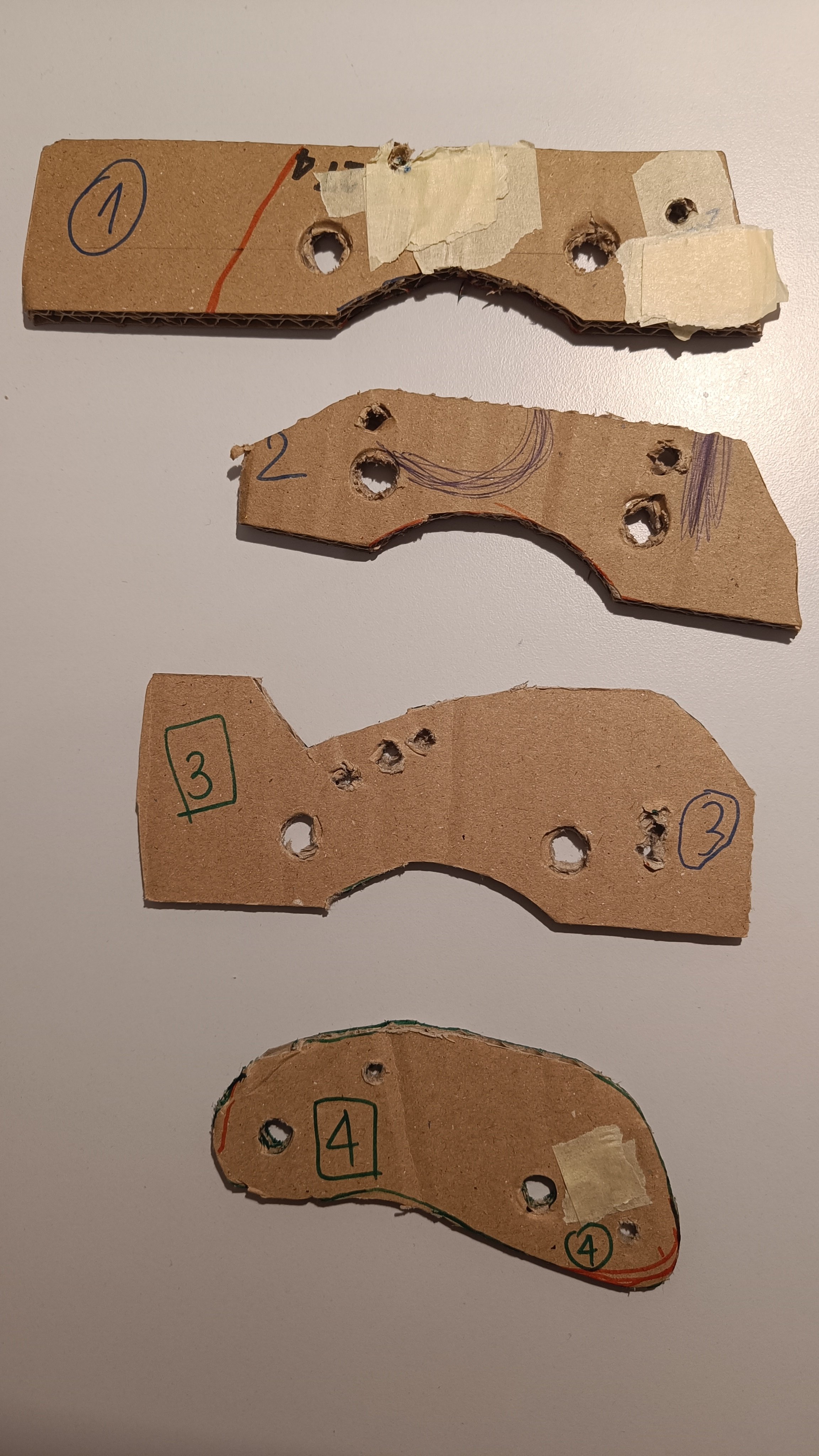

For your entertainment see below pictures of the stage 1 (CAD prototyping) of the Pinion belt tensioner in action (this would might end up being fitted to my belt driven Nicolai bike):
So far four prototypes :)
The Gates belt tensioner would be a more elegant solution but that is not happening for obvious reasons. Above all, it would be better protected between the frame and the wheel.
Any constructive feedback is welcomed.
IMG20240106191554.jpg IMG20240106191618.jpg IMG20240106191639.jpg IMG20240106191641.jpg IMG20240106194441.jpg IMG20240106194447.jpg IMG20240106195205.jpg IMG20240106202653.jpg IMG20240106202657.jpg IMG20240106202704.jpg IMG20240106202716.jpg IMG20240106211523.jpg IMG20240106211630.jpg IMG20240106211634.jpg IMG20240106211708.jpg IMG20240106211717.jpg IMG20240106211727.jpg IMG20240106211735.jpg IMG20240106230042.jpg

View attachment 132007 View attachment 132017
Kudos tooFat. Excellent progress which begs the following:
  1. BT1 is an available tensioner that can be purchased now, unlike the Nicolai tensioner at the moment.
  2. Arguably this tensioner might be better for the Voima than the Sonni, simply because it is not transverse mounted like the Nicolai, which, in my self-serving need to support the Sonni, has been what I've been pushing for thus far.
  3. To me the biggest BT1 design flaw is it's undercarriage exposure, but that huge bash guard would definitely help!
  4. So is #4 design that latest iteration of what is needed? That is only a single plate adapter is required?
  5. The material you end up using might be dependent on getting your chainline aligned. Fo example hi-impact plastic could be used if it needs to be thick to counter a larger chainline difference. Or steel if the opposite is the case. Or aluminum if in between.
Keep dem updates coming.

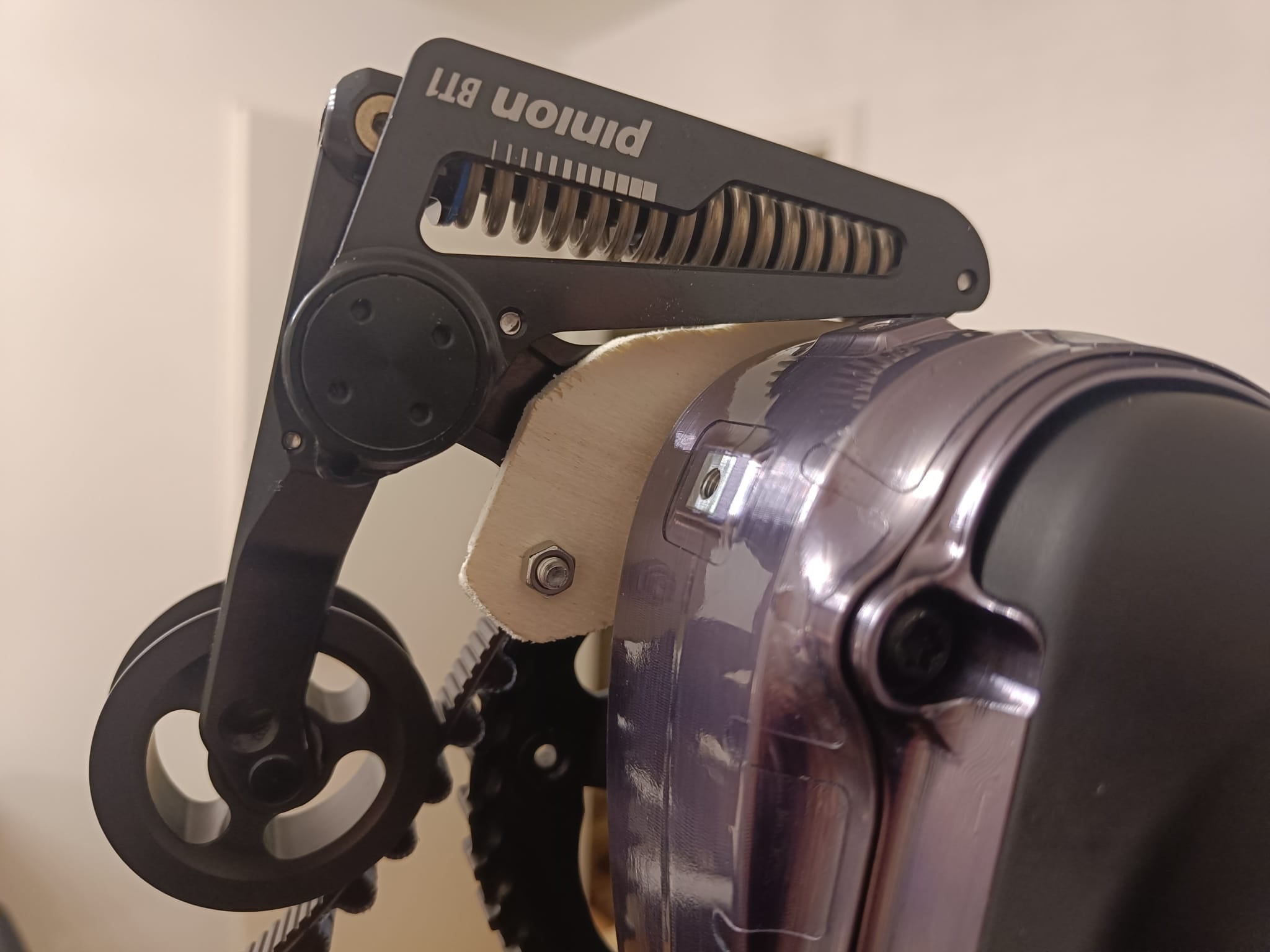

Re 1: Indeed, this is why I could start prototyping. I have the tensioner and a bashguard in hand. Even from the stage when I was just visualising, having it in hand made some realisations. For example, I would have wanted it to sit closer to the engine axle but there is not room.
Re 2: The Gates tensioner would most likely be a better solution. If the adapter is well designed, it could be positioned right behind the frame, in front of the rear wheel. The exact coyld be achieved with the grass-roots type of engineering involving pieces of cardboard and plywood but it takes time as it is my first foray into this high-tech area :)
Re 3: In my view the tenstioner without the bashguard would end up smashed in no time, although I am rather careful with my riding in a rocky environment.
Re 4: Design No 4 is the latest based on cardboard. The next stage will be with a 5mm plywwod. The cardboard stage was just to have a basic shape. Unfortunately it lacks ridigity even though it is a thick piece of cardboard. Plywood should provide ridigity so that I could check what thickness would be required. I have three thicknesses available to me: 5, 7 and 10mm. This should help me with the alignment.
Re 5: The cheapest and easiest to work on without access to 3D printing is an aluminium sheet. These are available in a variety of thicknesses so it should help minimalise the use of shims to align the entire setup.
Once I have the template ready and the adapter cut-out, the first weeks/months the bike will be run as a single speed as this is how I could test it. The rear wheel hub things takes forever to organise so at least I will be able to test the belt length (have three belt option ready and waiting) and its tension, which appears to be crucial for longevity and performance of Gates belts.
I hope to start prototyping with plywood this weekend. Let's see how this goes.

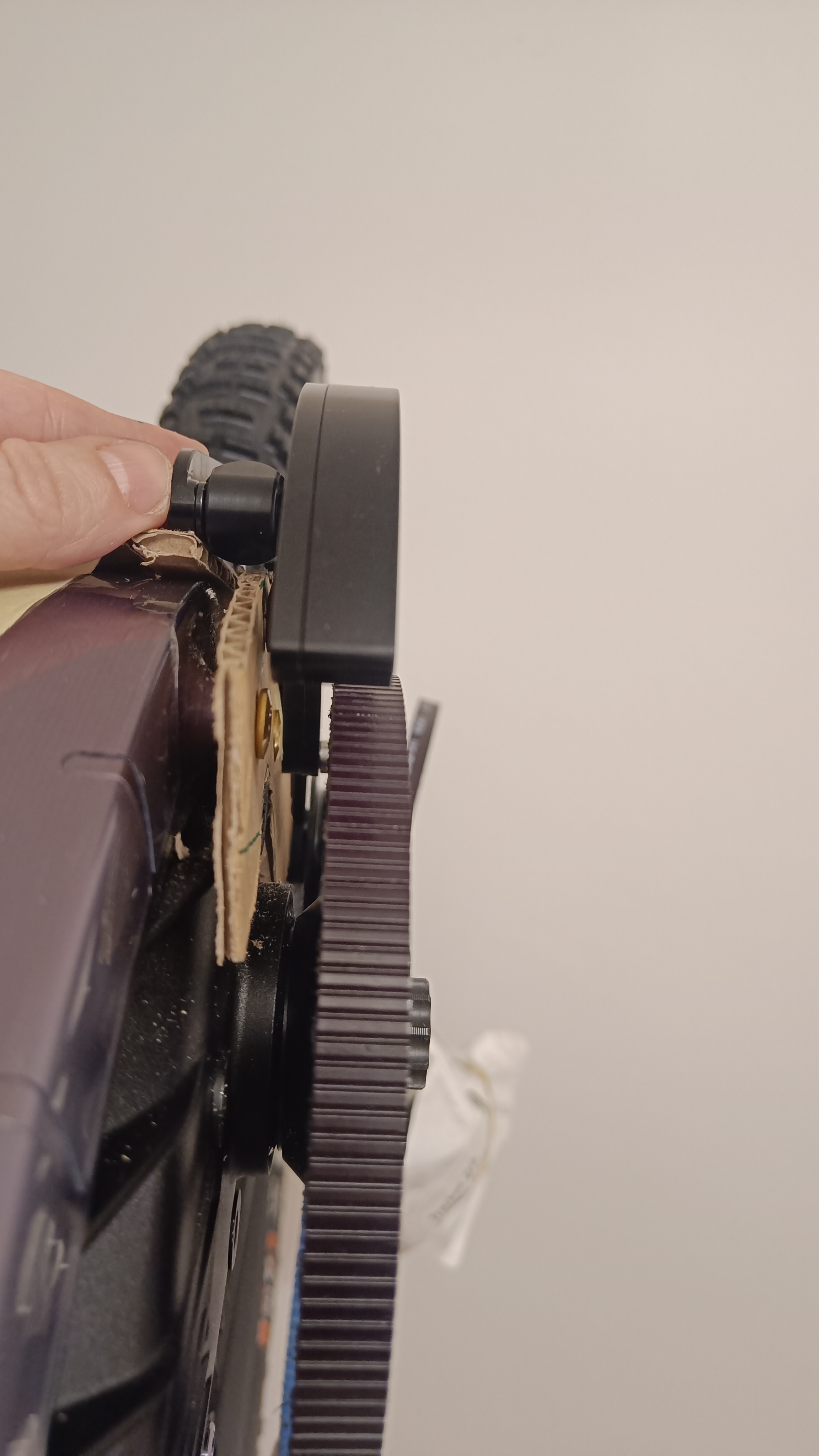

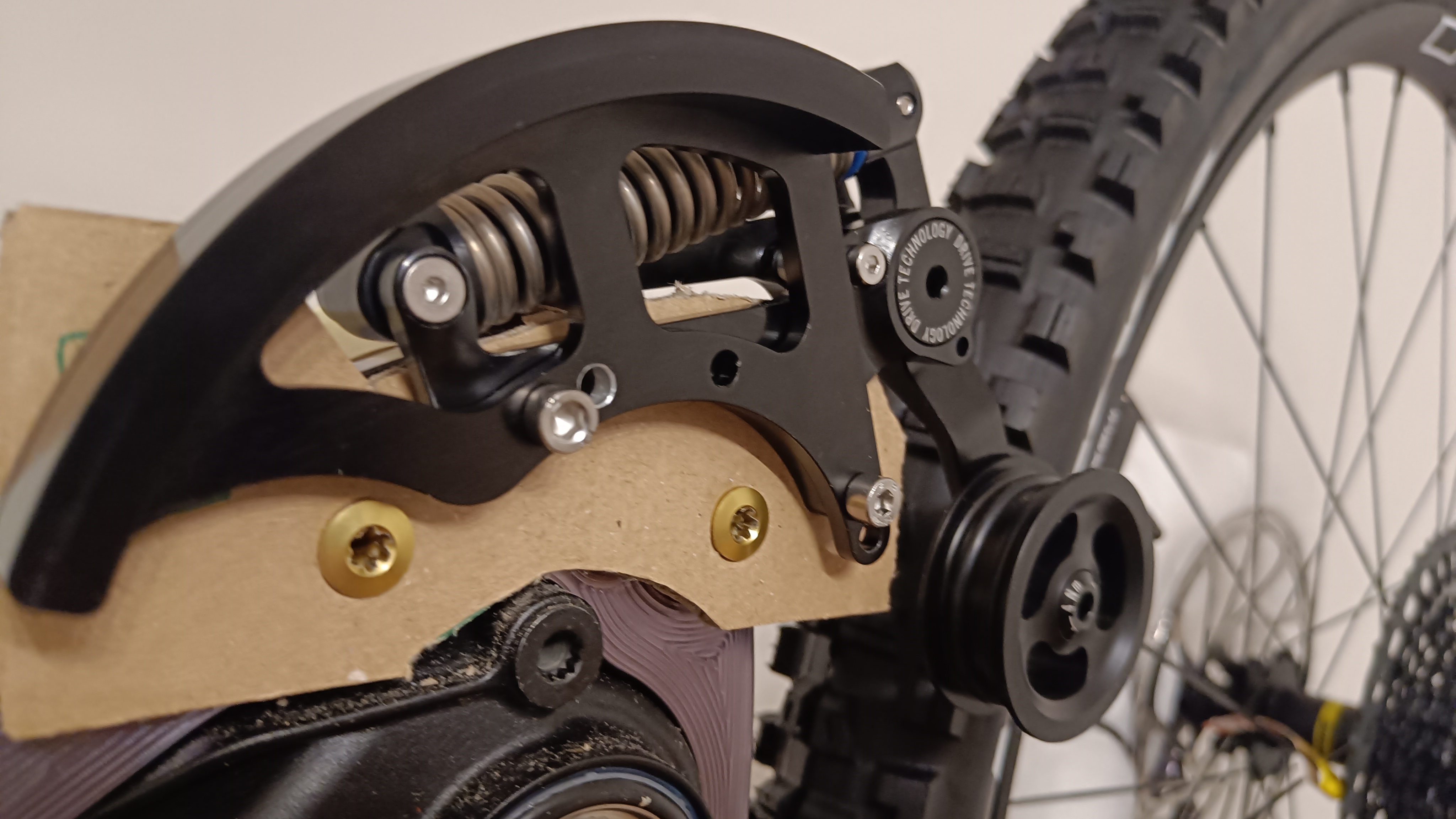

Prototyping continues. Not pretty or fancy, but should do at this stage.
Excellent progress. So how's the chainline looking with this piece of plywood?
BTW, what an cool idea to go single speed to get the tensioner mechanics worked out before committing to a internal gear hub setup. Even better, you could get a sense of what a single speed Voima would be like to ride. Or a 2-speed setup with something like Powershift if they had a single speed adapter available.

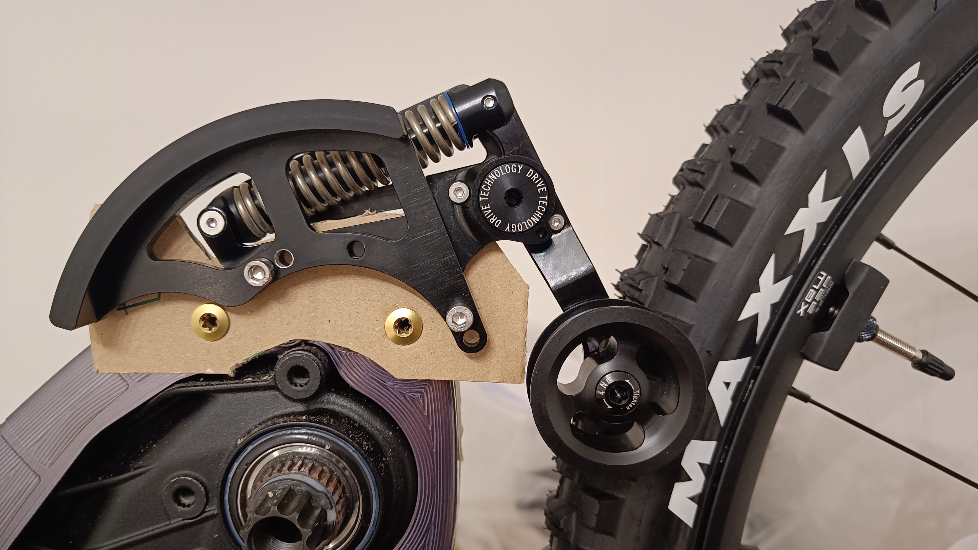

Houston, we have a problem.
Today I have received the 122T belt. So far I have the following belts: 120T, 122T and 125T.
The problem I discovered is the chain growth:
  • The 120T belt is too short. Nothing to add here.
  • The 122T belt is slightly too long when the bike is unweighted. Yet it is too short when and no full wheel travel could be achieved.
  • The 125T belt is too long when the bike is unweighted. It allows, however, the full wheel travel.
I suspect the chain growth is too great for the existing setup (Pinion BT1 chain tensioner, 39T front sprocket, 34T rear sprocket).
So far this is a bike stand-testing. Next week I will have my forks ready so once they are fitted, I will test the system with my own weight. I do not expect different results but I want to confirm it.
So, it is time for the collective brainstorming. What to do here? Any thought and/or suggestions?
tooFATtoRIDE
Sep 18, 2023
63
54
North by Northwest
Potential solutions:
In both videos a full wheel travel was tested to see if (1) the belt's teeth do not touch at zero wheel travel; (2) the belt tensioner was still able to extend (squeeze the spring) at a full wheel travel; and (3) the belt was long enough at a full wheel travel.
Prototype 6 was ok-ish at test 1, and passed tests 2 and 3.
Prototype 7 passed all three tests.
I still need to test the belt tension with the Gates app.
Still nowhere near a working solution but that's just the nature of prototyping. The true difficulty will start when the shape and length of the tensioner arm established. At present time I have no idea on how to incorporate it into the existing belt tensioner.
