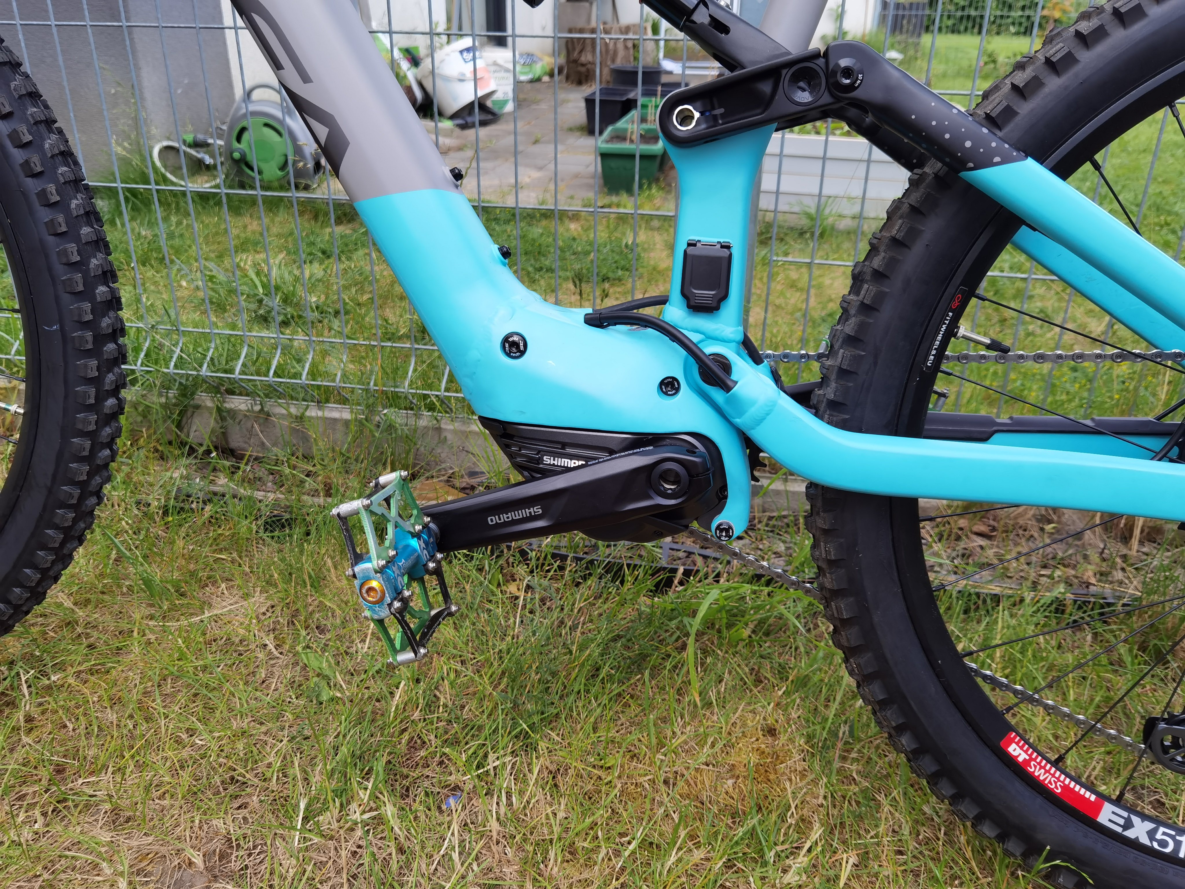

Got new 2022 H30 XL last week and it was delivered with e*13 crank set 170. I did not test them just took them off and place Shimano EM600 165. But on other bike 2023 Focus Jam2 7.8 I have Samox 165 crank set and left side started falling off once and there was no blue Loctite applied on. Now with EM600 there is no need to put Loctite and I will be able to see if it will fall off or not. One more thing in EM600 instruction Shimano advise to check crank set once every month.

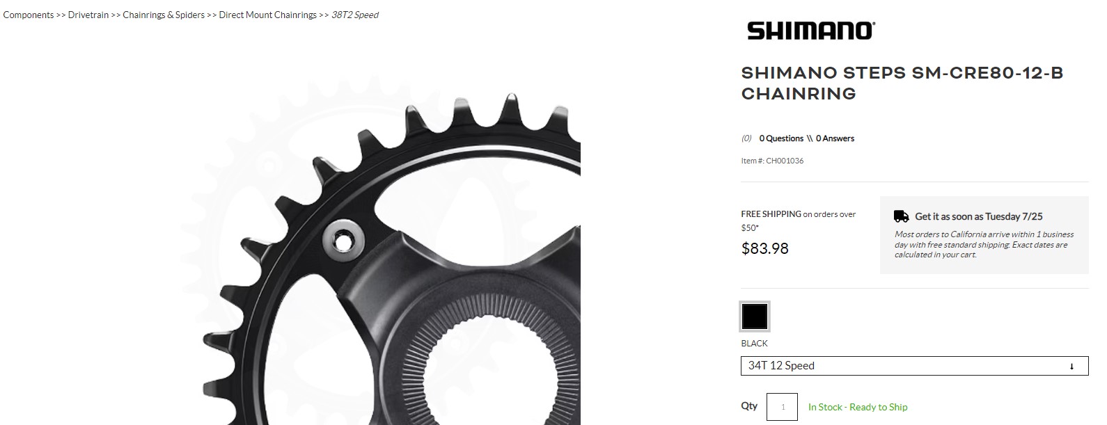

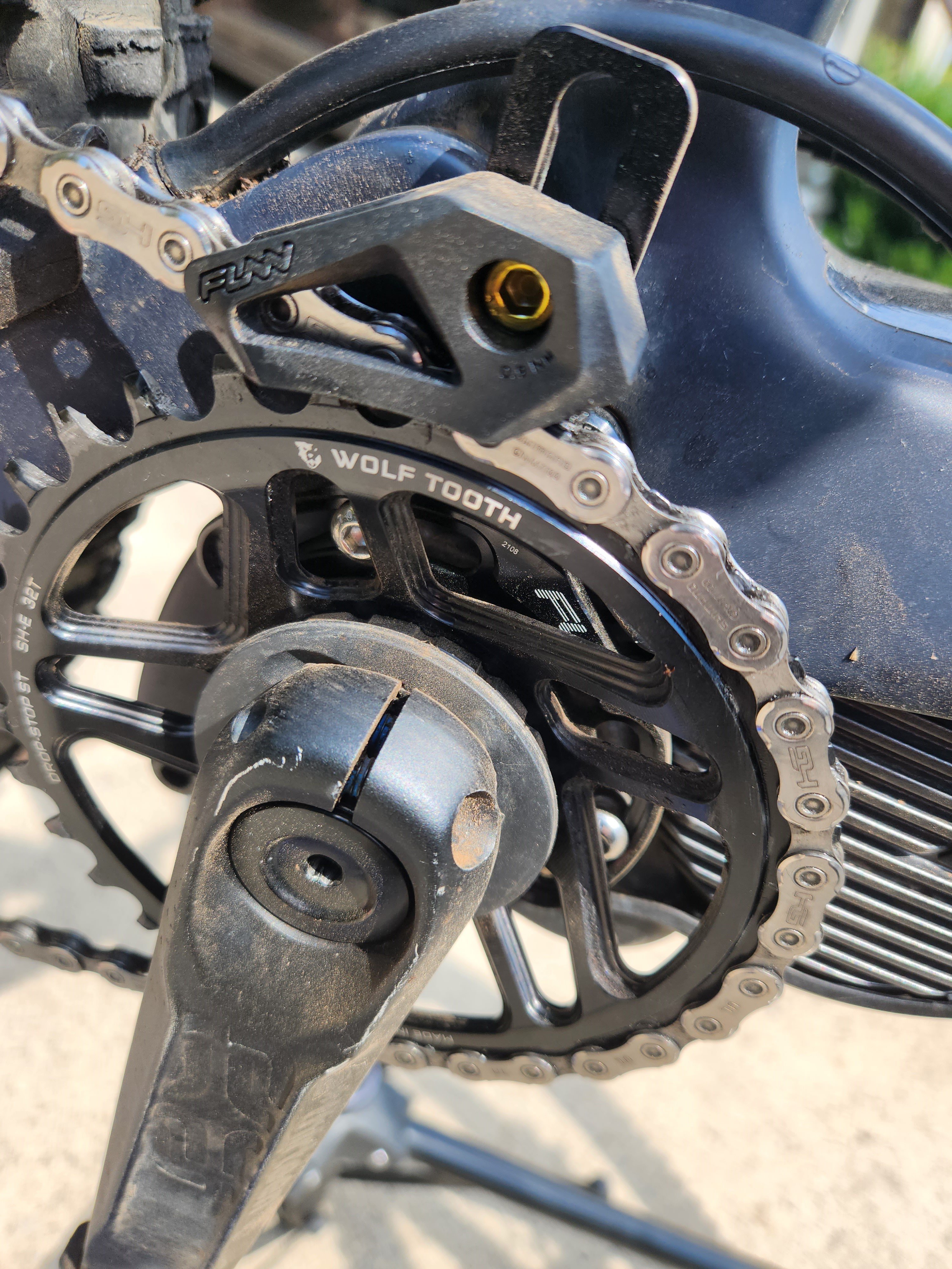

Not sure why people are making this too complicated, the FSA (53mm chainline) spider is available, just pair it up with a 104 BCD chainring that's compatible with 12 speed Shimano chains.
The SHIMANO "STEPS SM-CRE80-12-B CHAINRING" is also fairly easy to get as well, and is available with 34T. Sells for about 84$ from online bike shops here in the US (e.q. Jenson USA). It's the spider w/ chainring made for a 53mm chainline
As for the the chain guide, the Funn Zippa Lite ES Chain Guide works great.

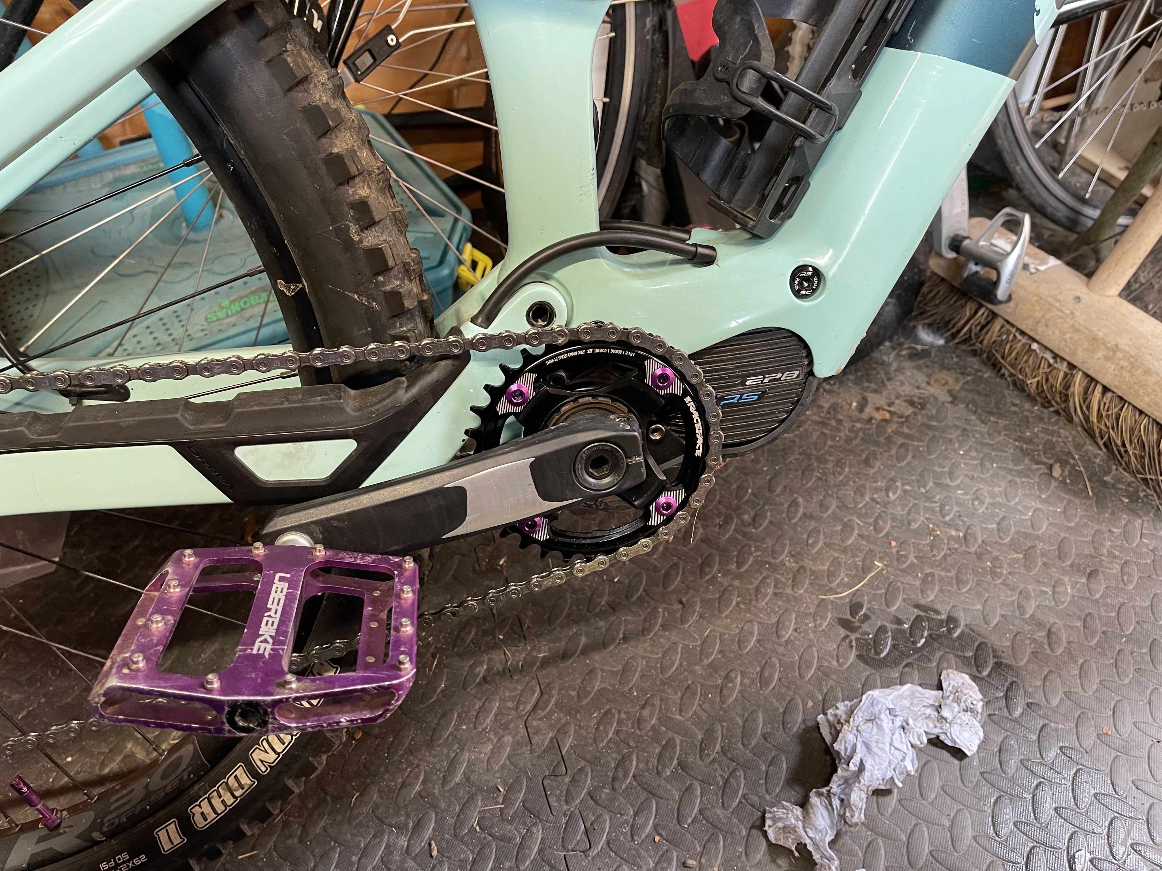

Finally assembled all the parts to replace the chain ring. Shimano spider, Race Face ā€˜Shimanoā€™ chain ring. Purple (special request by SWMBO) chain ring bolts, with the bolt filed down a few mm so they would fit and screw tight. Special purchase of yet another tool (Parktool LRT2). When her arm is fully repaired from the break, weā€™ll be trying it out. 20g heavier than the stock e*thirteen. And weā€™ll see how things go without the chain guide.
Was also able to make sure all the motor bolts were torqued correctly, to find the middle on the drivetrain side was loose.
