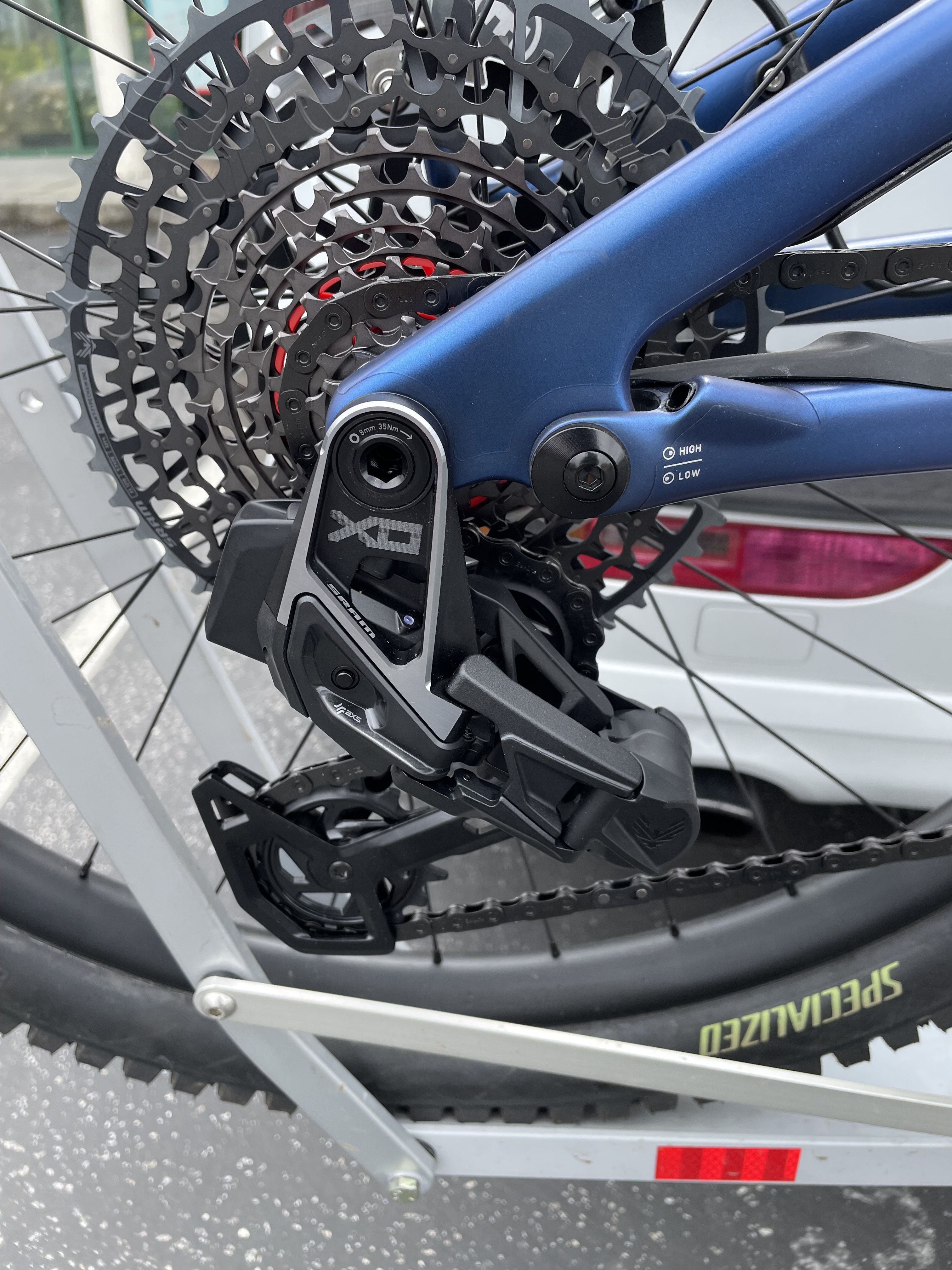

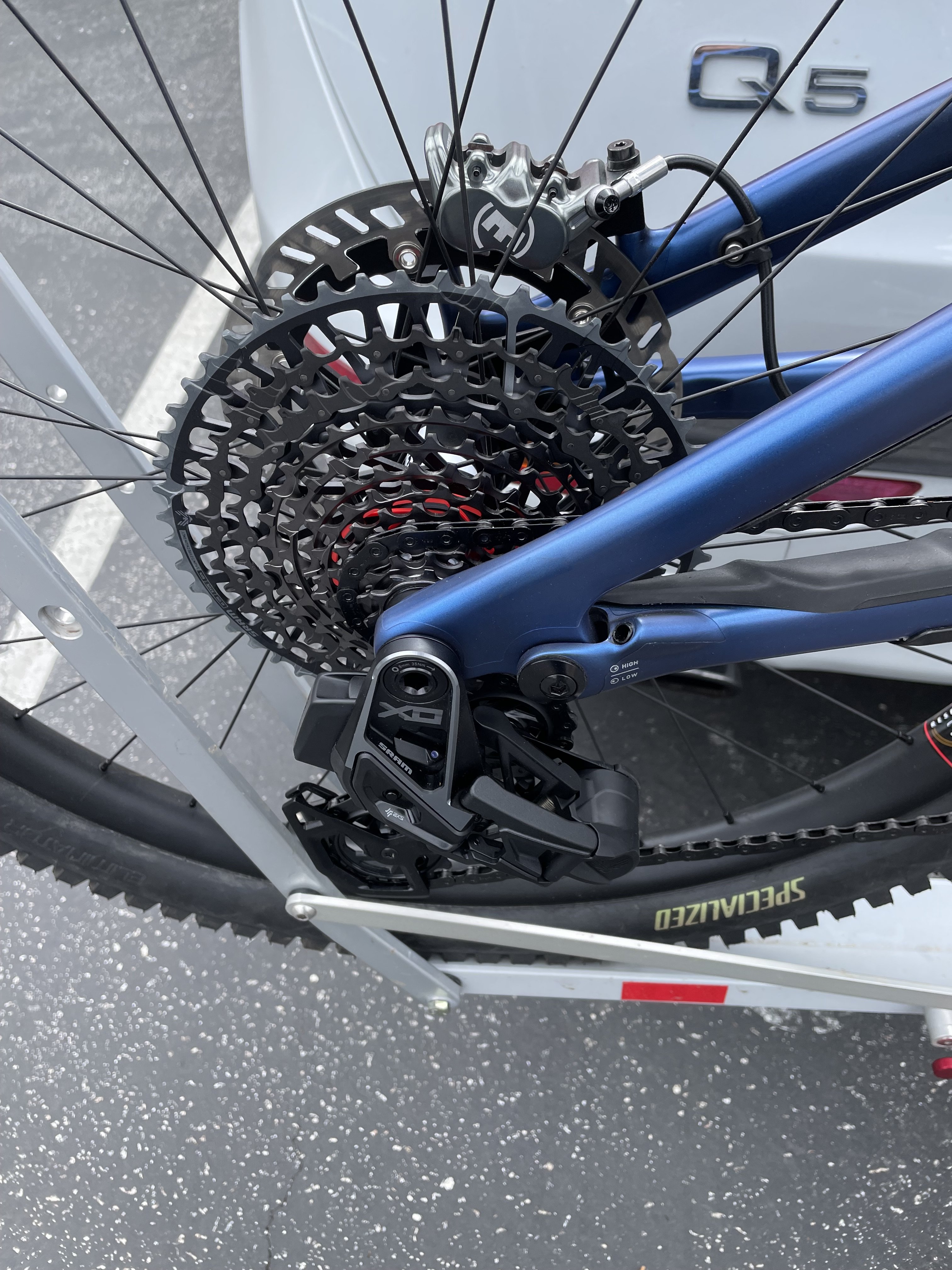

Put the new Transmission on my Levo. Can't tell you how nice it is. Ok Orbea, what's not to like? Seriously, it's really nice and super quiet. Biggest thing I notice is the solid shifting, and if it holds true that the hardware will hold up to abuse, then why would anyone not go with this set up when buying a new bike? That is if you are going wireless and spending the money. Not for everyone, but in CA we can ride year round. Not sure if this would hold true for the 6 month rider in snow climates.

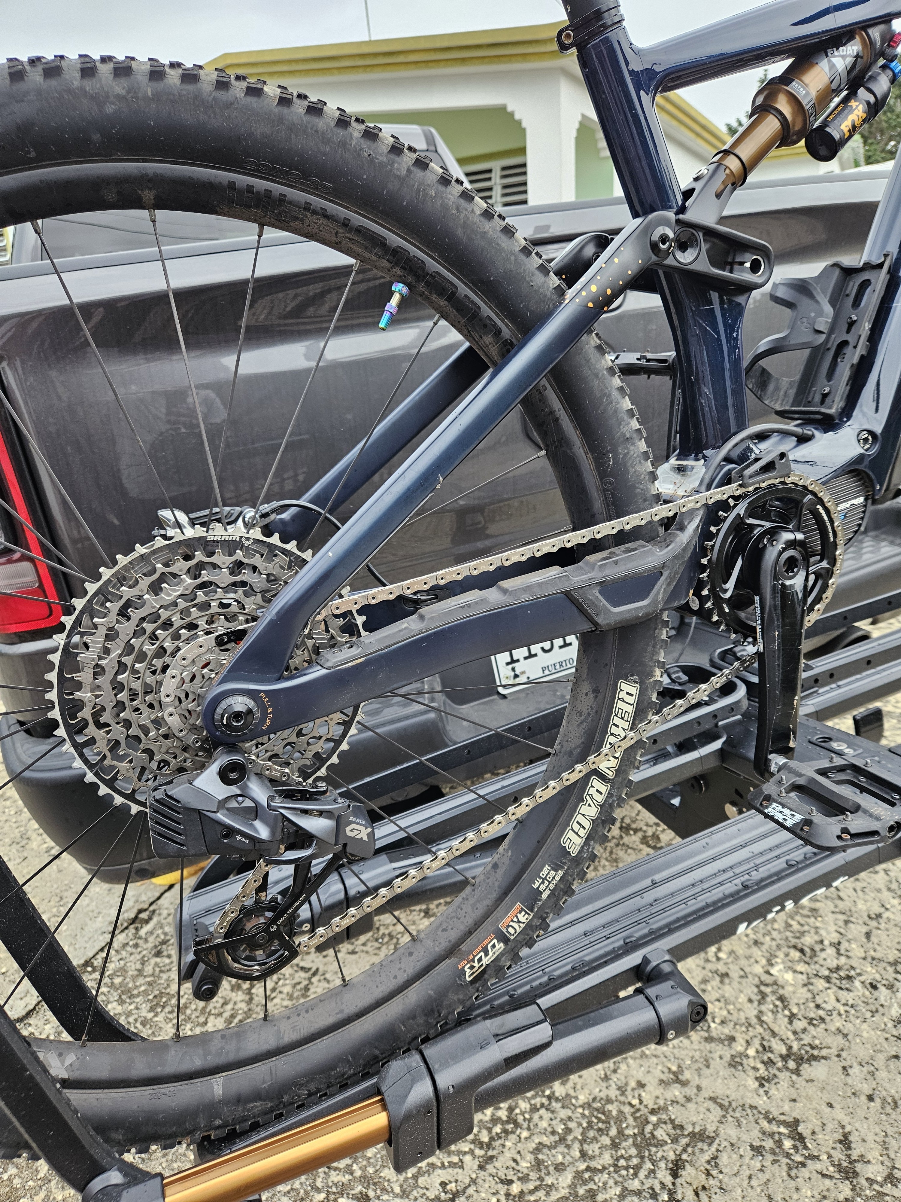

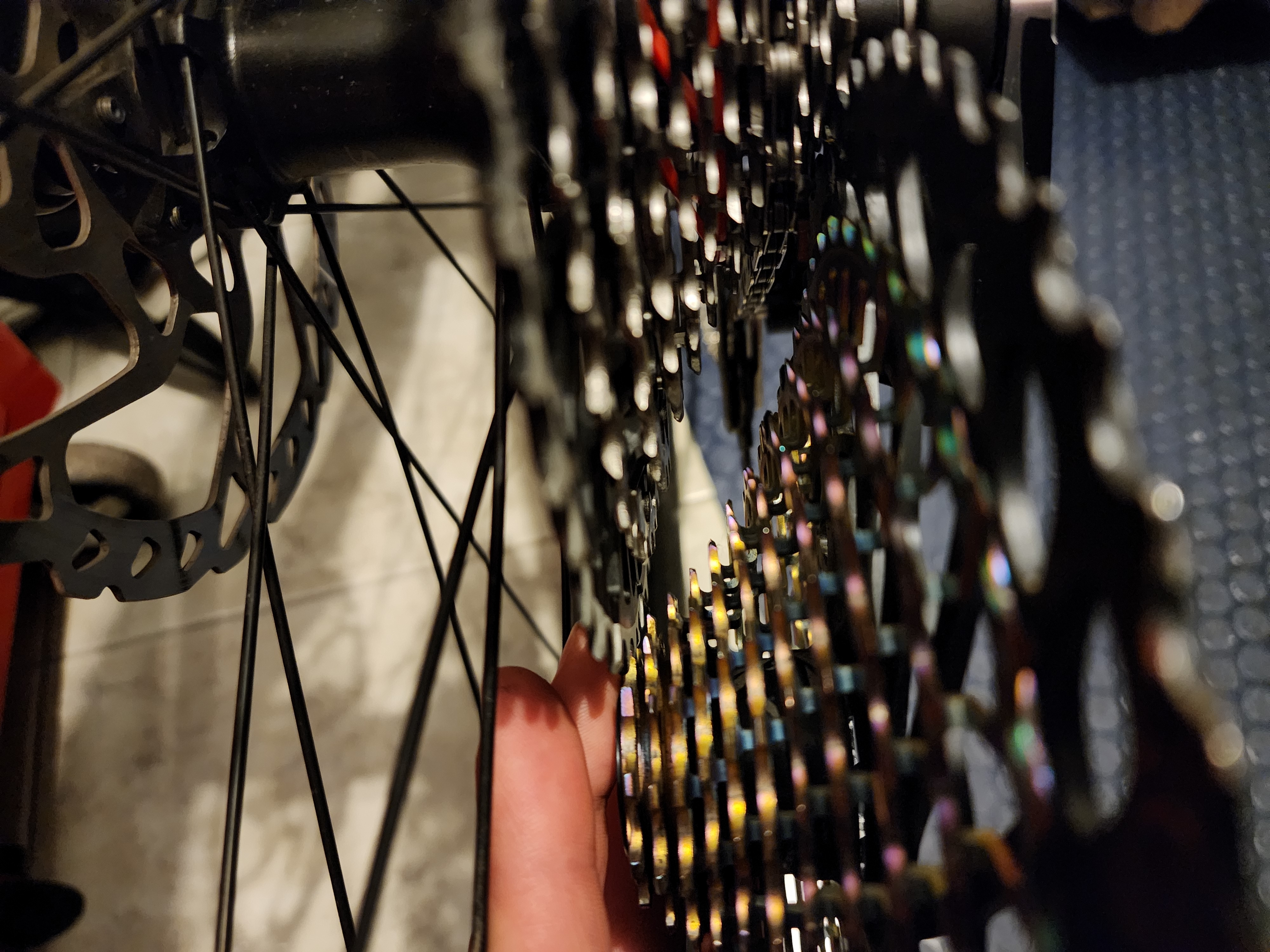

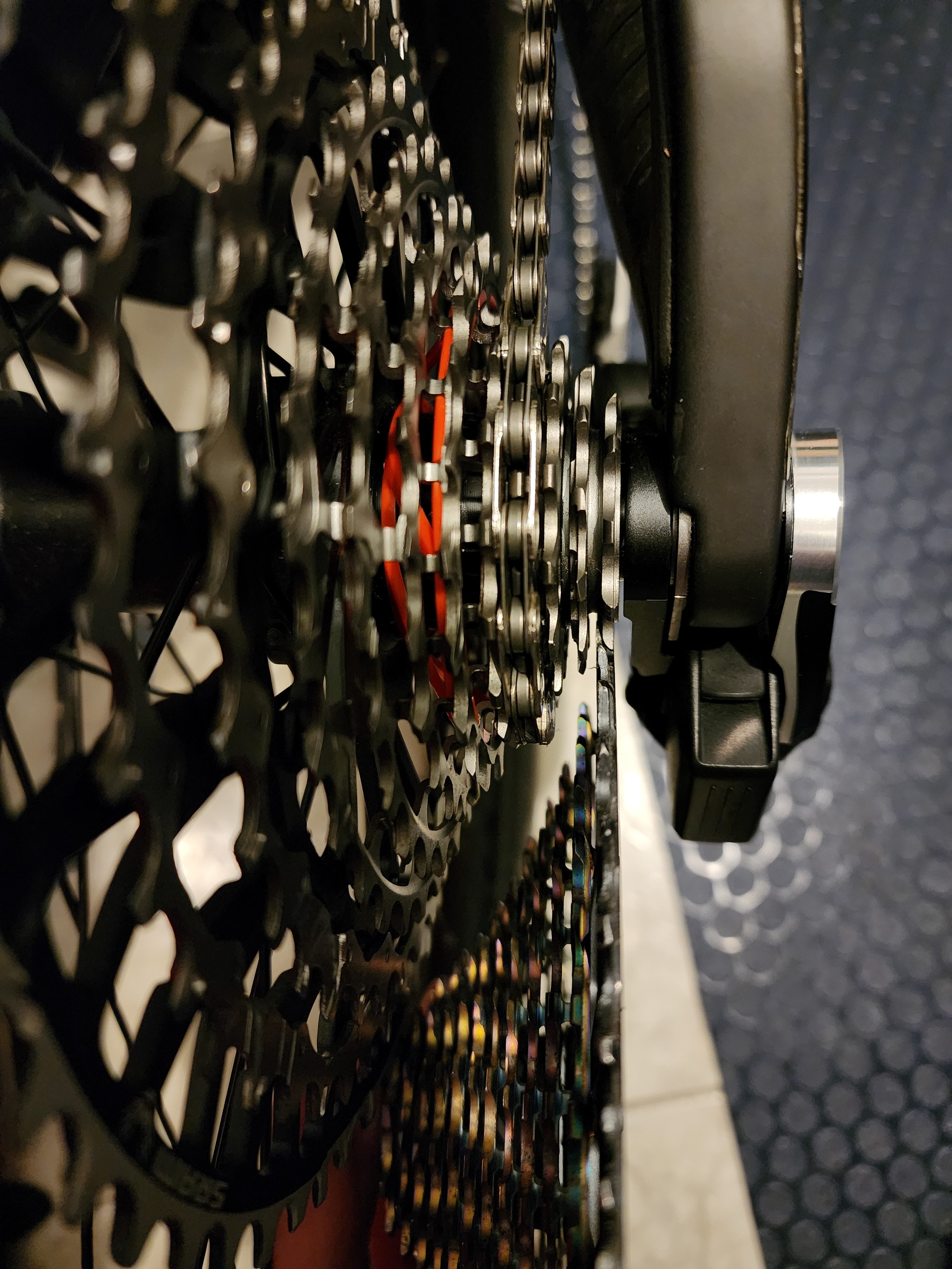

I will be doing som tests with the XX cassette with T Type chain and GX AXS derailleur. Altough the new XX derailleur cant be mounted on the Rise the Cassette and T Type chain can. The chain is backwards compatible with the eagle systems. The cassette however can only be used with new T Type chain. The feature of shifting under load is not in the derailleur it is actually in the cassette. Its made in a way that the chain only derails on a specific point. So although we cant get the new derailleur installed Im going to test the cassette, T Type chain and GX AXS derailleur and post results. I already checked and the chain runs perfectly on the E thirteen chainring.

Yes, cable shifter would work as well. The e thirteen chain ring works with the T Type chain so all you would need should be the new cassette and chain. Im waiting untill wednesday that my new bike arrives and will do the test with it, as I will be converting it to AXS anyway.

I thought the width of the shifts was slightly different on the new Transmission. Maybe not enough that you can still use the old derailleur?
Markitos
Apr 3, 2023
7
Puerto Rico

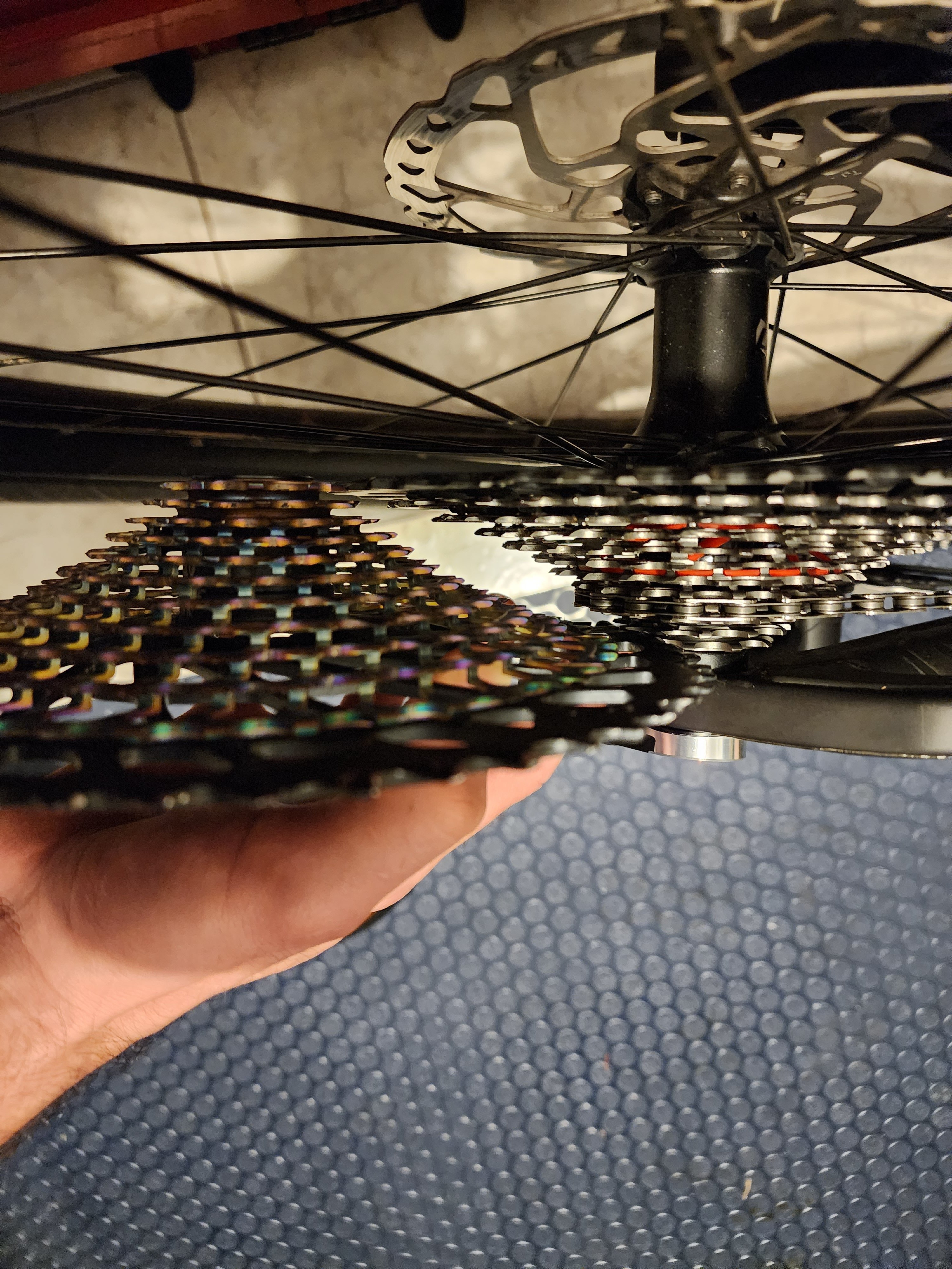

At a simple glance they look very similar. I know the pictures are not very clear but they seem very close in the spacing between each ring.
I believe you just need to space the derailleur off the hanger 2mm to account for the 2mm shift in the cassette spacing with the t-type.

Yes the old AXS Systems work, GX non T-type, X01 and XX1. The doubt here was if the new T-type Cassette and chain could be fitted to the rise to have the shifting under load advantage. In short yes it can be done and works using the old derailleur.
