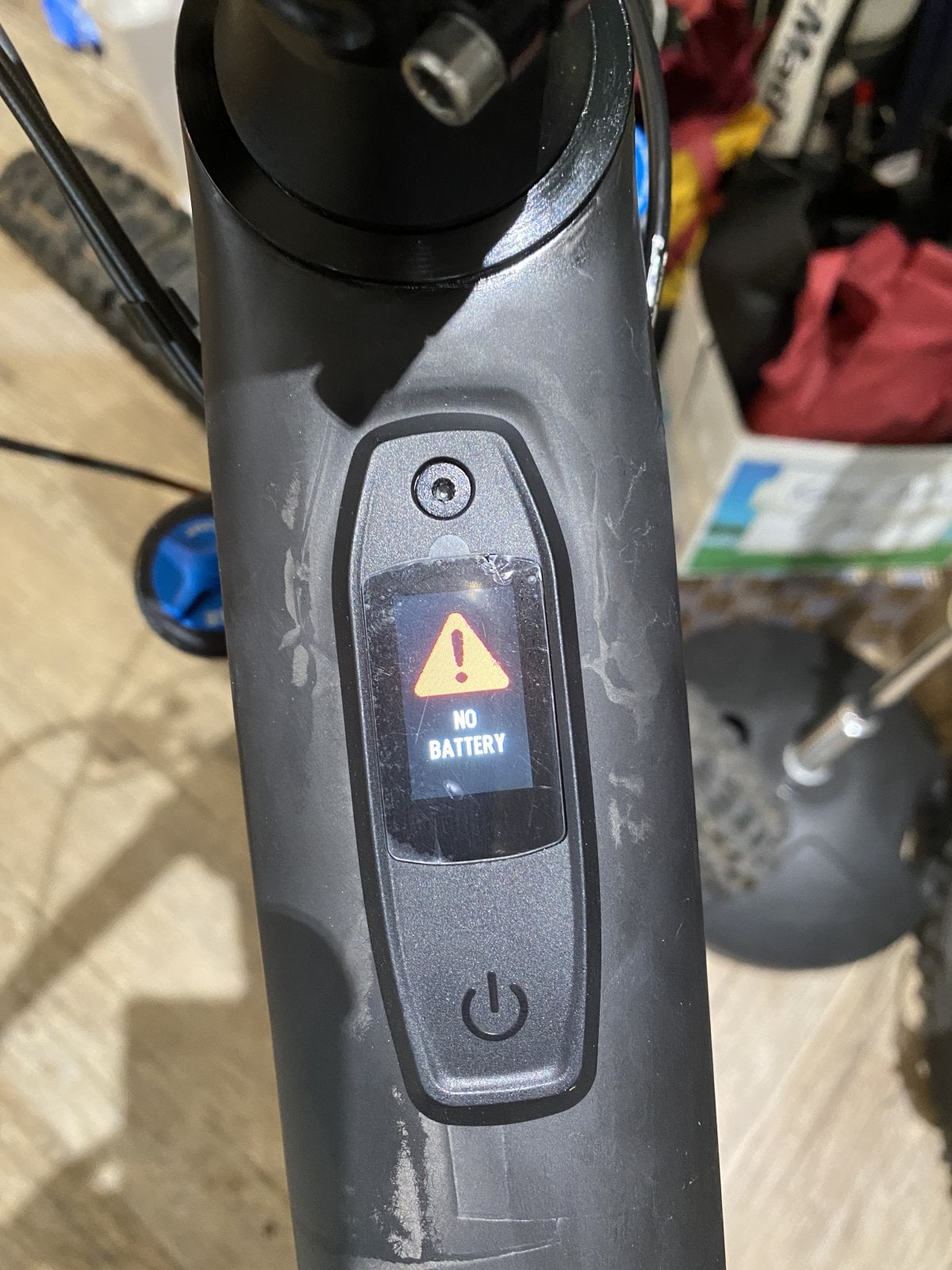

Hi all I’m new to EMTB and mountain biking in general.
I’ve recently purchased a Levo SL Expert and a Turbo Levo Pro 2022
After charging on the Pro I’m getting a no battery Error on the display when starting afterwards.
Checking connection and wiggling cable or pressing up button gets it to work most of the time after a few minutes. Not what you’d expect on a £11,000.00 bike
Spoken and uploaded diagnostics to store no fault found anyone else had this issue.

I’m getting the same error - bike also shuts off randomly on rides !!! I just bought a week ago!! It’s a $12k bike … I’m so bummed ….. this has been a terrible experience with such an expensive bike.. hopefully I can get it fixed fast

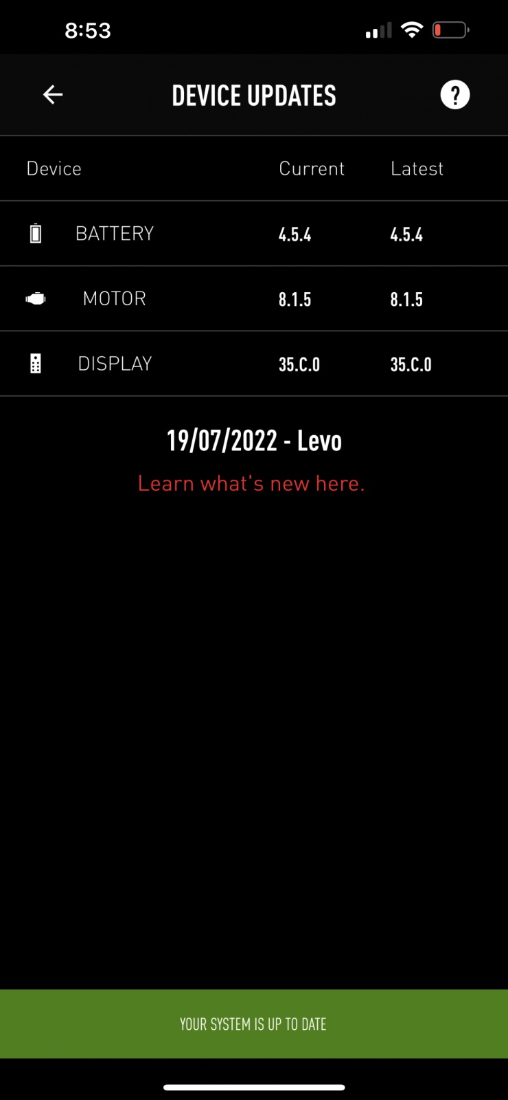

hello,
Last firmware update totally resolved the error pop-ups.
Till next time ?

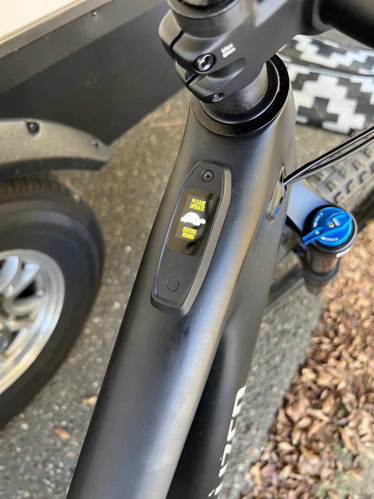

I’m now getting a “please update” on the TCU with a turtle symbol. What is the current firmware? I connect to the Mission Control app but it doesn’t say that it is in need of an update. Has anyone else has this issue?
51831363-4A7E-45E2-A77C-5C42929C05D3.png 772C2365-4A39-4DCF-8C9D-BE7E0B4CEE66.jpeg

Hello,
Have a look here:
It seems it requires Local Shop intervention.

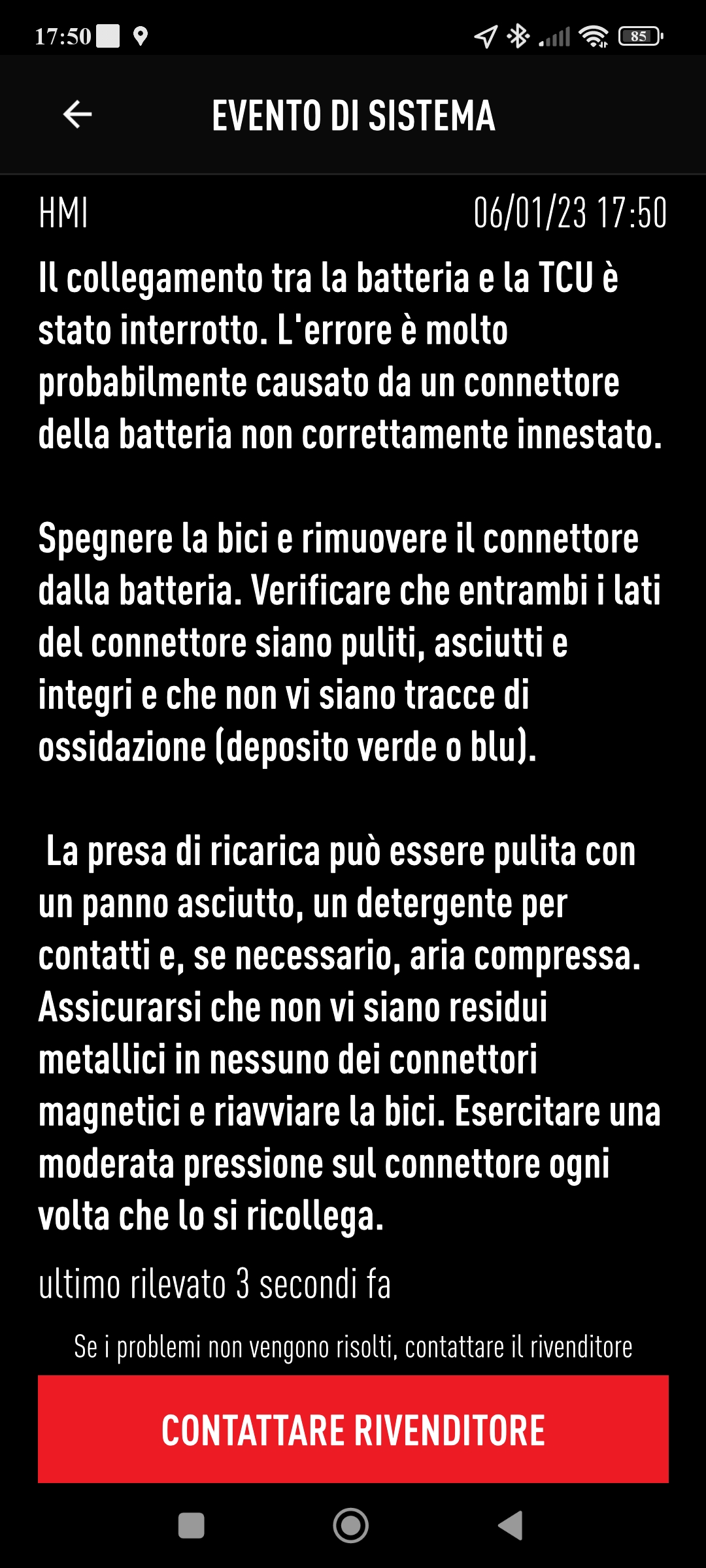

Hi All,
I have same problem "No battery" with my brand new S-work turbo levo 2022, I even can't turn on once. What can I do ? Battery charging is normal, I tried to un-plug and plug all the TCU cable and battery cable but doesn't work
same issue here with turbo levo comp alloy NO battery error. Sometimes I tried to start it over and over for so many times that almost half an hour passed and the battery start working with no other issue till the next start.

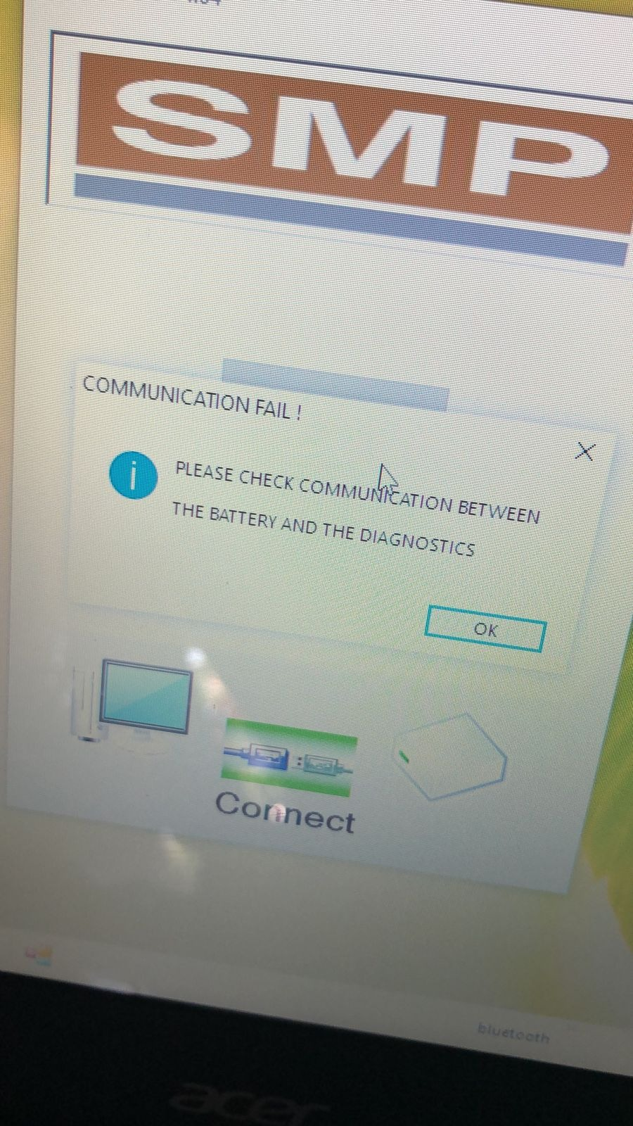

No battery error it turn worst day by day till I was forced to leave the bike to my personal retailer sportissimo in modena italy.
Now I am waiting for a response but the very experienced mechanic seems to be less optimistic than usual for this particular problem. Maybe specialized will replace the motor after his checkup ..stay tuned. I will update the quest.
UPDATE: faulty TCU : Specialized replace with a new one TCU shipping it to the retailer mechanic sportissimo , now turbo levo 2022 works again
