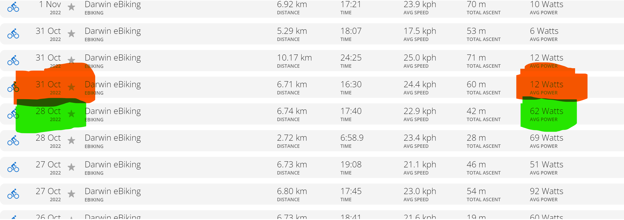

Same experience with 2022 Explore E+1
Smart Gateway version: 20221017000 << same version as OP
RideControl Ergo version: 20211130000
Syncdrive version: 20210131A
Looking at the firmware dates it's only the Smart Gateway with a recent update. I was getting proper power readings in Garmin Connect up until a couple of months ago. Just had a look back at my Bike Activities and see the Power readings dropped at the end of October. So would imagine it was the 20221017000 firmware update or earlier that borked it.
EDIT: Just scrolled back through my screenshots. I did one after the previous update on 12 October.
Smart Gateway version: 20220505000
So for me that was the last good firmware.
I get Power on the Ride Dash Evo display but 0 Average Power.
