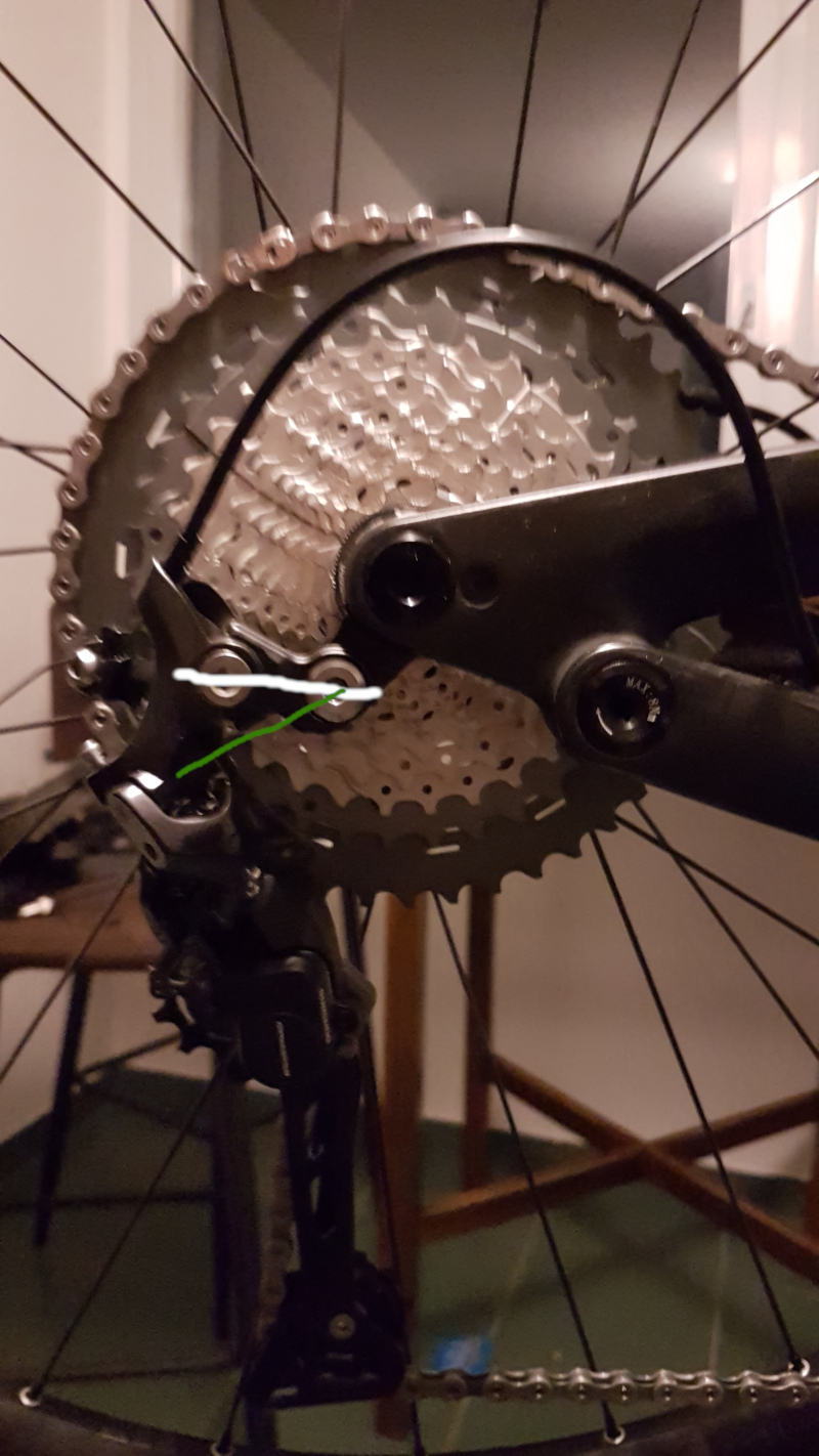

I have another question now.
I have mounted the derailleur but I feel it is too much on the rear. To my mind, the problem is due to the stopper on the black metal leg on which the derailleur is mounted, the stopper makes the deraillleur leg go too high (in white on the picture). I would like it to be in the green direction I draw on the picture. And idea if we can order a different leg for the E10 ?

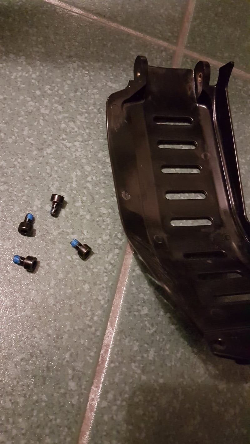

And yet another question, while trying to mount the lower crankcase, the only screws I have left are the four ones on the picture; but they don't fit. Where is my mistake ?
