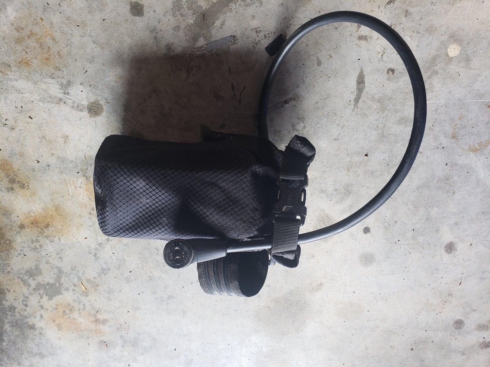

I keep mine covered at all times when not in use bit some 7/8" plastic/rubber caps. They still look nice and shiny. But your comment about weight is probably spot on. Too much momentum with a hard hit if it's too heavy. The magnets are very strong but not if the cable is bulky and heavy. My cable run is pretty short but I do have some very light 12 gage silicone ones I might try some day if I start having too many disconnects. They two wires, red and black sort of formed together, very flexible and not extra weight. But soldering them to the plug might add a bunch of shrink tubing and weight right where you don't want it, lol.
Maybe some contact cleaner and a toothpick or wooden dowel would clean it up.

Regarding your point with lighter cable - definitely a good idea. I might try to put some velcro over connection as well - just for peace of mind. Even though I'm not riding very aggressively with the new battery due to the concerns about the weight limit of the fidlock mount. They guarantee 1 kg, and with the older 1.3 kg battery I rode it any way I wanted - jumps, drops etc. This one at 1.9 kg though... a bit scared :) So now this is rather a transport battery to get to / from a spot, or for leasure trailing
