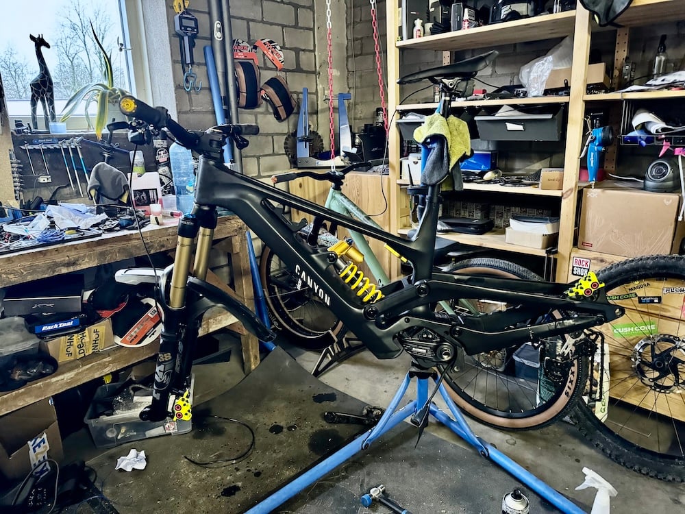

It took me a few shots of bleeding to get them right. They felt great in the workstand, and then went soft on the trail. The bumpy terrain must've helped all the bubbles come loose! On my previous bike, they were rock solid for over 3 years and never needed touched again. I've had them on my current bike for about 10 months now, and haven't needed to bleed them again since the first week or 2.
Just make sure you take the caliper off to bleed it - so you can have the caliper higher than the lever... this may involve having your bike in the workstand in a crazy position (front wheel on the ground and rear pointing right up!!) and gently tap the caliper lots to loosen the bubbles.

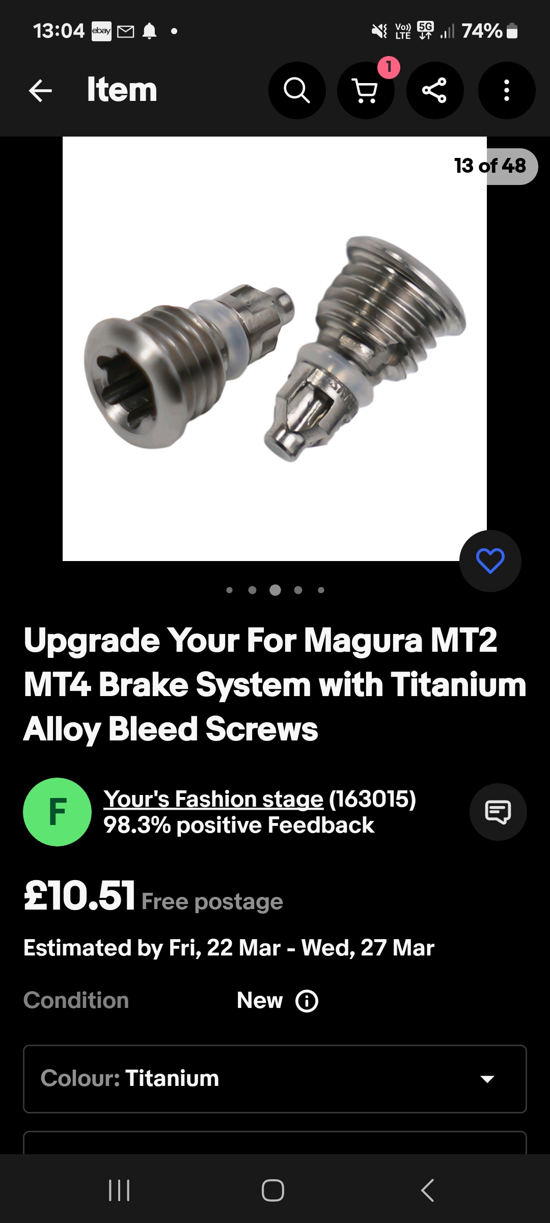

If I accidentally over tightened the bleed screw on my MT7’s, I would rather the plastic bleed screw threads fail or strip before the female port in the master cylinder. A metal bleed screw may not be necessary on MT7’s master cylinders. They look nice though 👍🏻.
That’s exactly what I meant with “hard bleeding” :)
The more things you have to do (i.e. remove the caliper, change the bike position in the stand, hit the cable, etc.) the more I consider the bleeding complicated. I think that MT7 are designed in a way that makes the complete elimination of air from the system harder than other brakes.
