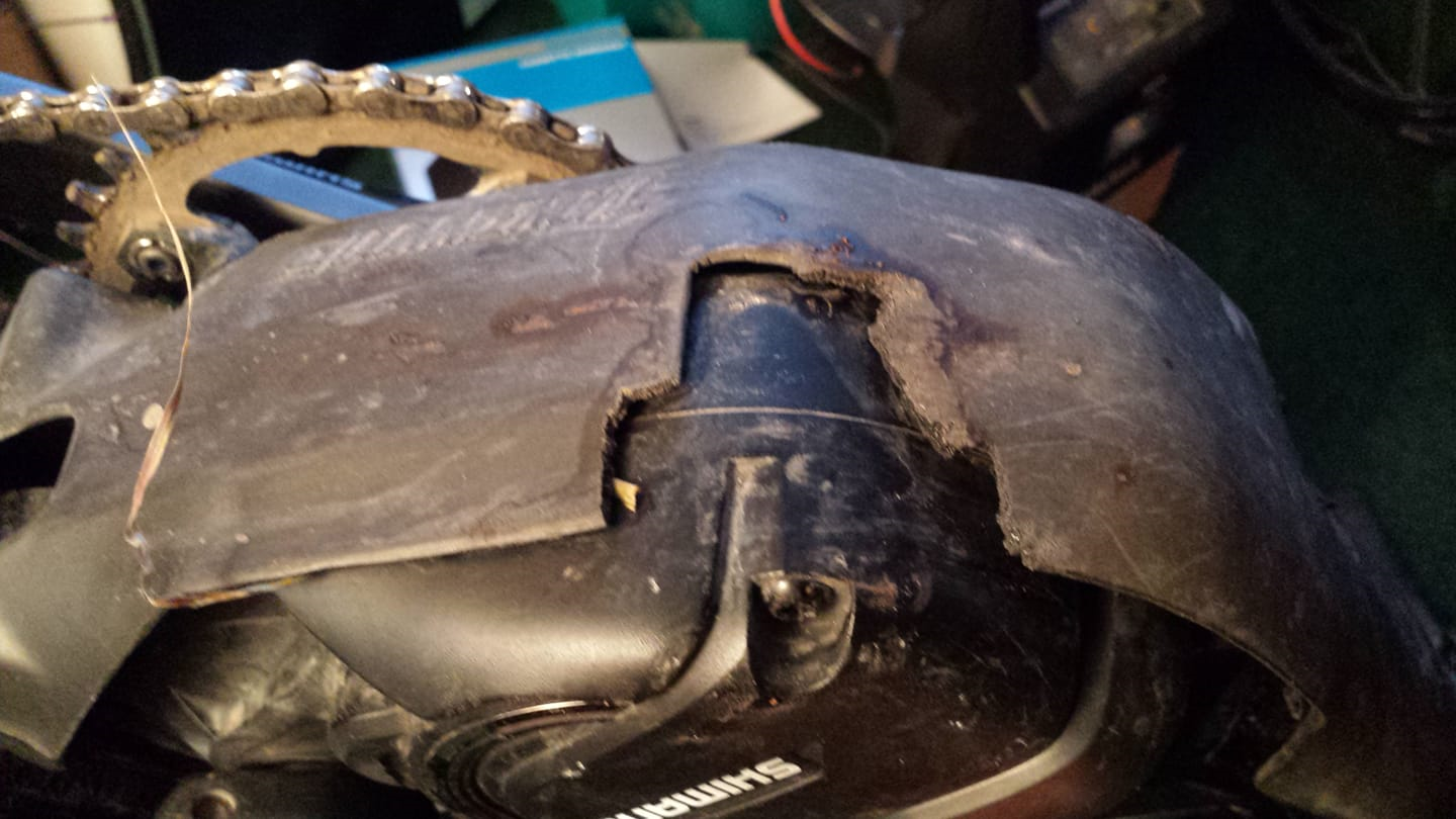

Has anyone found a solution for a replacement bash guard to replace the flimsy one that comes with the bike. I am on my second one, which is starting to suffer the same fate as the first. Don't want to pay $40 for the same flimsy one. Don't mind paying, but need something better. Any DIY ones. Thanks.

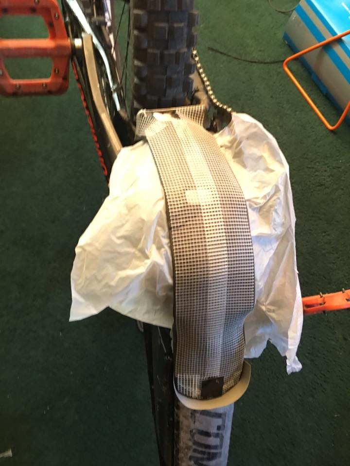

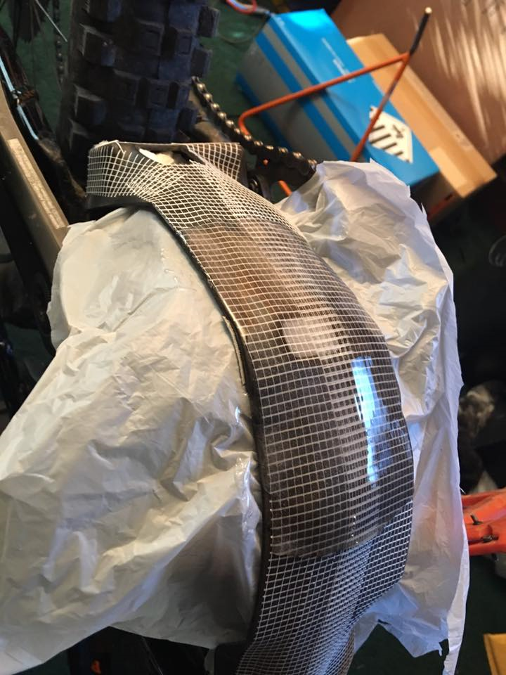

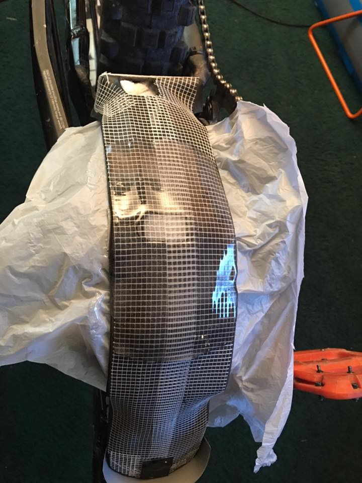

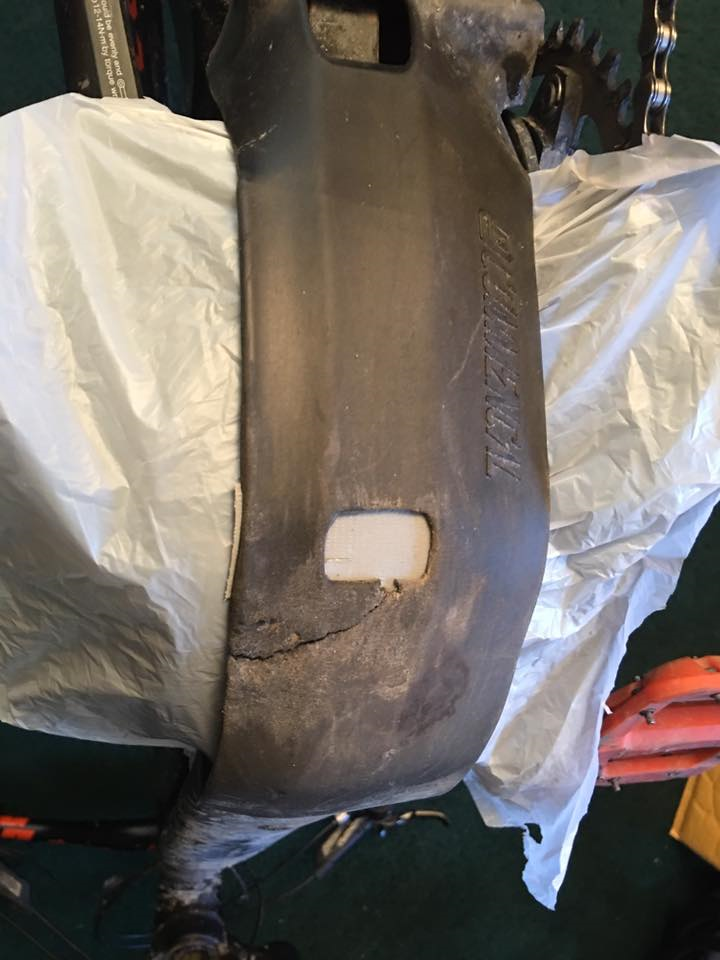

My 2nd engine guard was starting to tear. Temporary solution. Sloppy because I didn't expect it to work. Use self adhesive fiberglass drywall tape and resin from my wife's craft room. Was going to do the whole guard, but wife said might crack, so ended up just doing the center section where the tear was. Didn't think it was going to adhere to the plastic. But with the fiberglass tape it stuck like glue and the resin is as hard as a rock. Peeled off the unused portion of the tape.

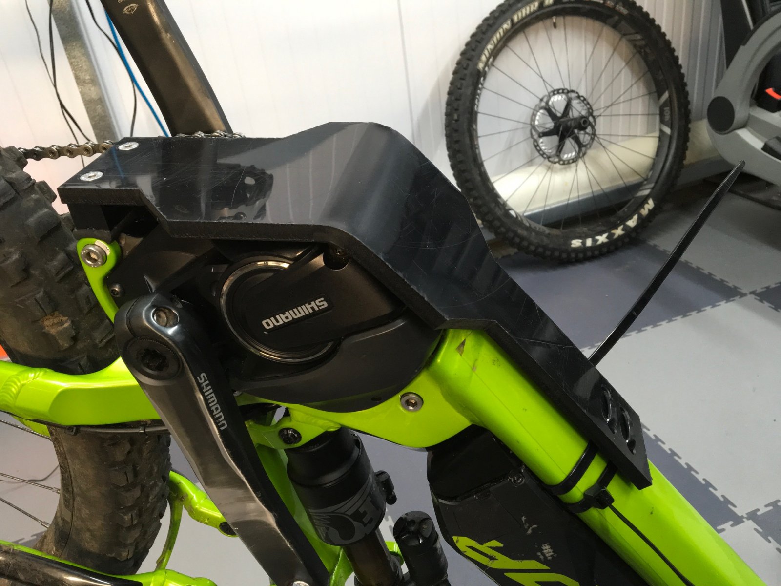

Rallysaloon
Oct 6, 2018
102
99
Uk
Anyone near Derbyshire UK with one of these Meta bikes who can bring it to me or I can meet somewhere so I can measure up for a proper bash guard? I don't know anyone with one. They look a very similar fitment to the Merida E bikes I currently make for.
