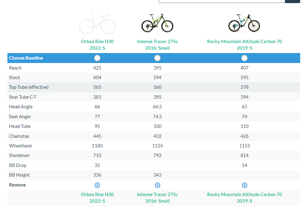

Thx. What size and model Orbea? The problem I'm having is no-one has them in stock to test out. Everything has to be ordered. I'm torn between an XS (they all seem to have 27.5 wheels) or an S (29 wheels). I'm afraid of getting a small and struggling to be able to stay on the seat and touch my feet on the ground.
Here's my daughter, wifes and boys bikes geo stats. They are all similar height to you. My wife is 5'1 so she is the shortest and on the intense tracer (not an ebike).
The key geometry measurements to look at are
Reach = Standing cockpit (standup up riding down hill). Between 395 and 425 will be suitable.
Top tube = Seated cockpit (sitting down pedalling up). 560 or less will be good.
Seat tube. = how low you can put the seat down. The lower the better. 380 or less
Standover height = standing in front of the seat.
If you want to compare bikes geometries the check this web site out.
You can't really just go and by a size small or extra small because there is such a wild range of sizing out there you sould end up a bike thats way too big,
As far as wheel size is concerned. If you are doing any technical riding then buy either a mullet or full 27.5. If you mainly ride easy tracks then a full 29er will be fine.
