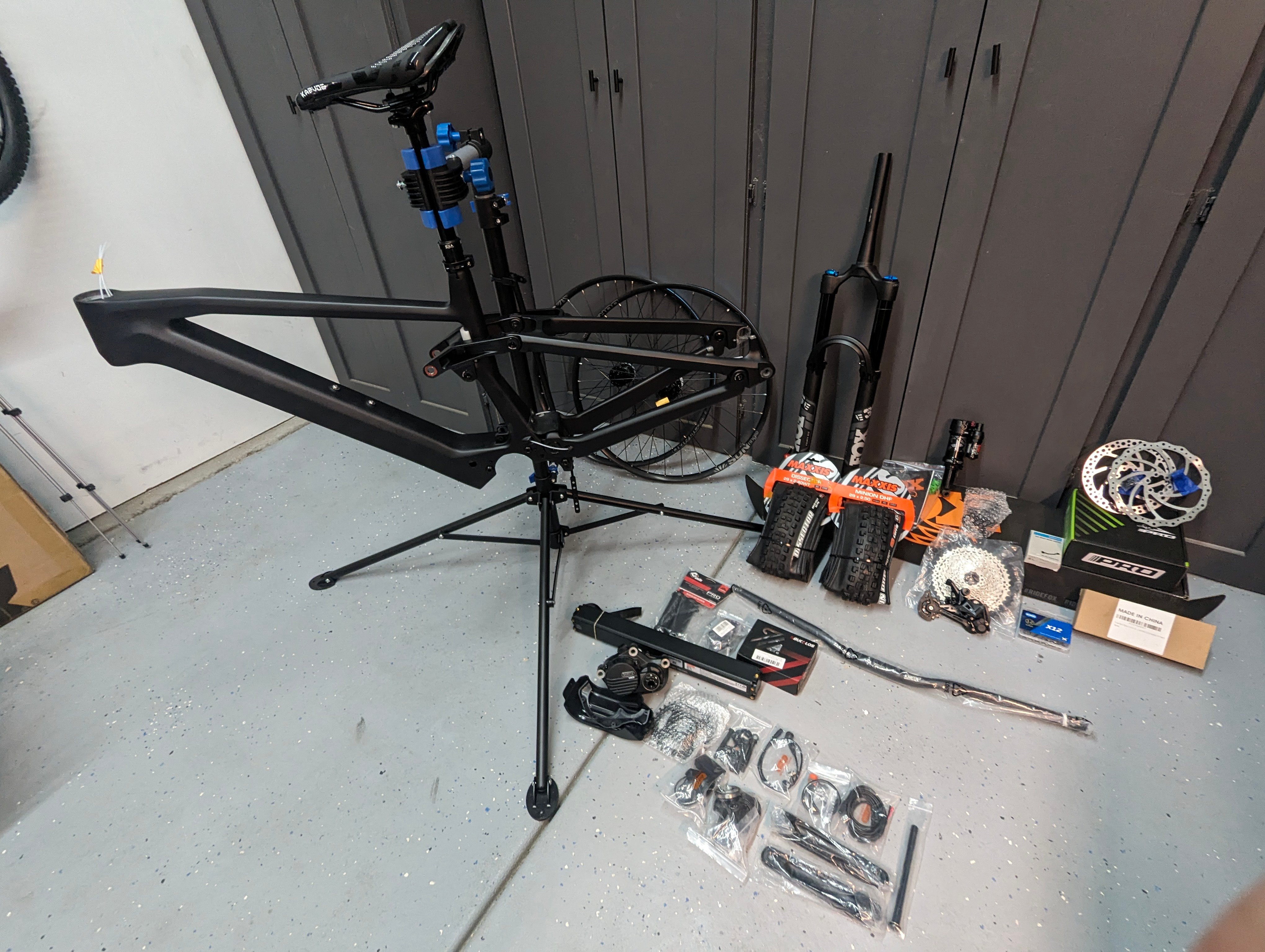

My LCE930 Build is underway!
Thanks to Lightcarbon for providing such a well built frame! It looked flawless on the inside and outside.
The Components:
The total build cost is 3117.89 USD including shipping, taxes, etc.. The anticipated weight is 19.47kg -> Actual weight is 19.77kg.

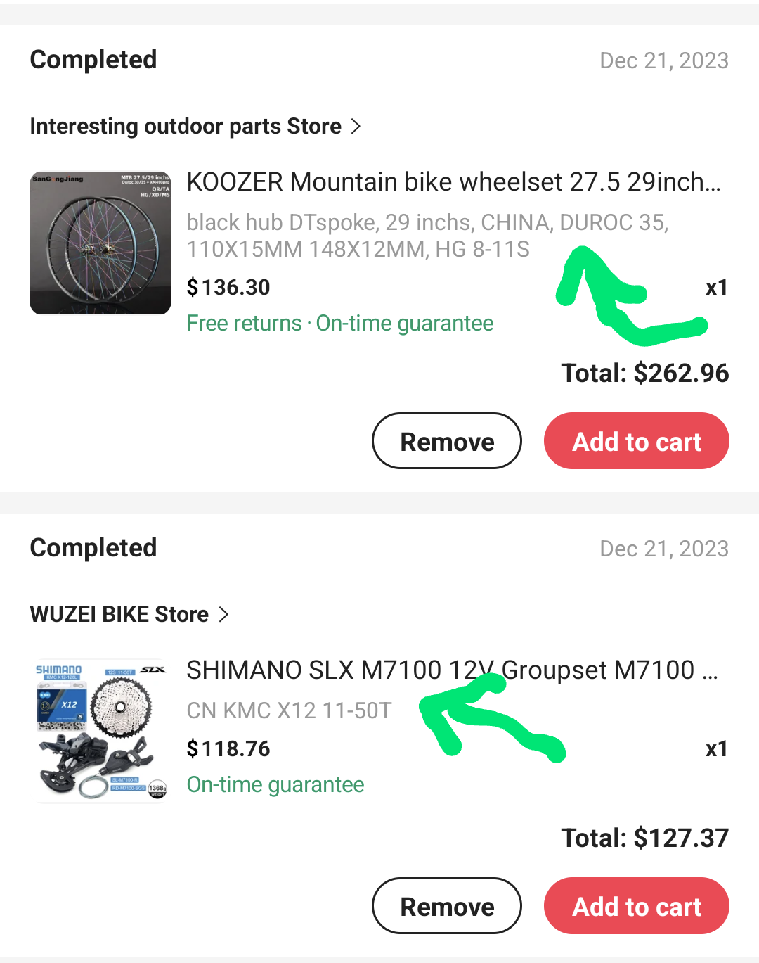

#2: the wheels are with the old quick release axles and not thru axle?
I hadn't heard anything from that hub or brake brand. Reviews are also hard to find. Did you have prior experience with these brands? Now that you have them on the bike do you think the brakes are good quality brakes?
Through axles front and rear to match the fork you buy and frame spec respectively.
The listing is a bit confusing, my selections can be seen in the image below.
The cassette spline pattern of the hub you choose has to match the cassette you buy. I chose HG (Hyper Glide), the cassette in the above groupset is also HG.
I hadn't heard about the hubs or brakes either but I found several very positive reviews on the brakes on YouTube and the internet.
The brakes and hubs/wheels look and feel like great quality.

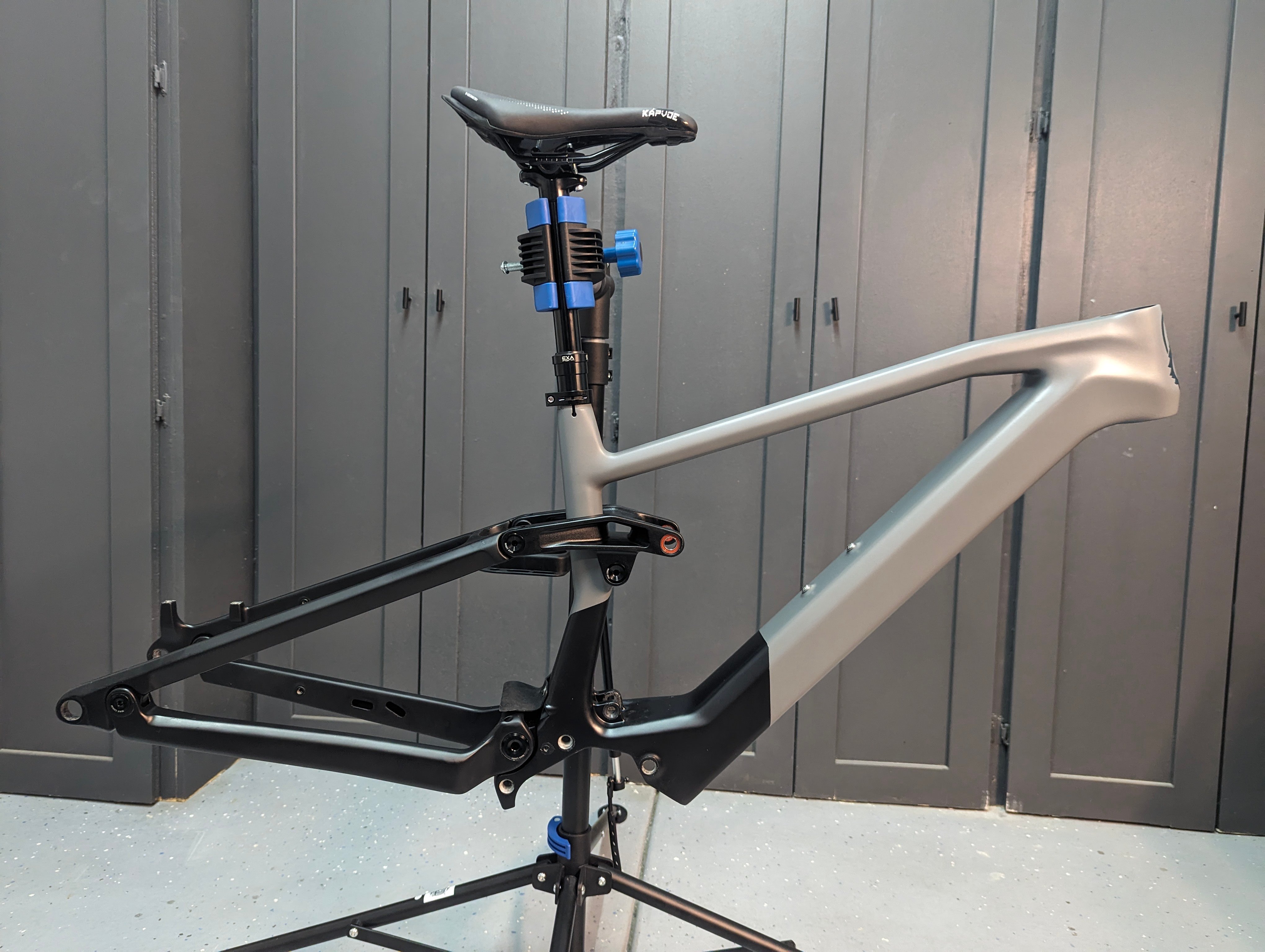

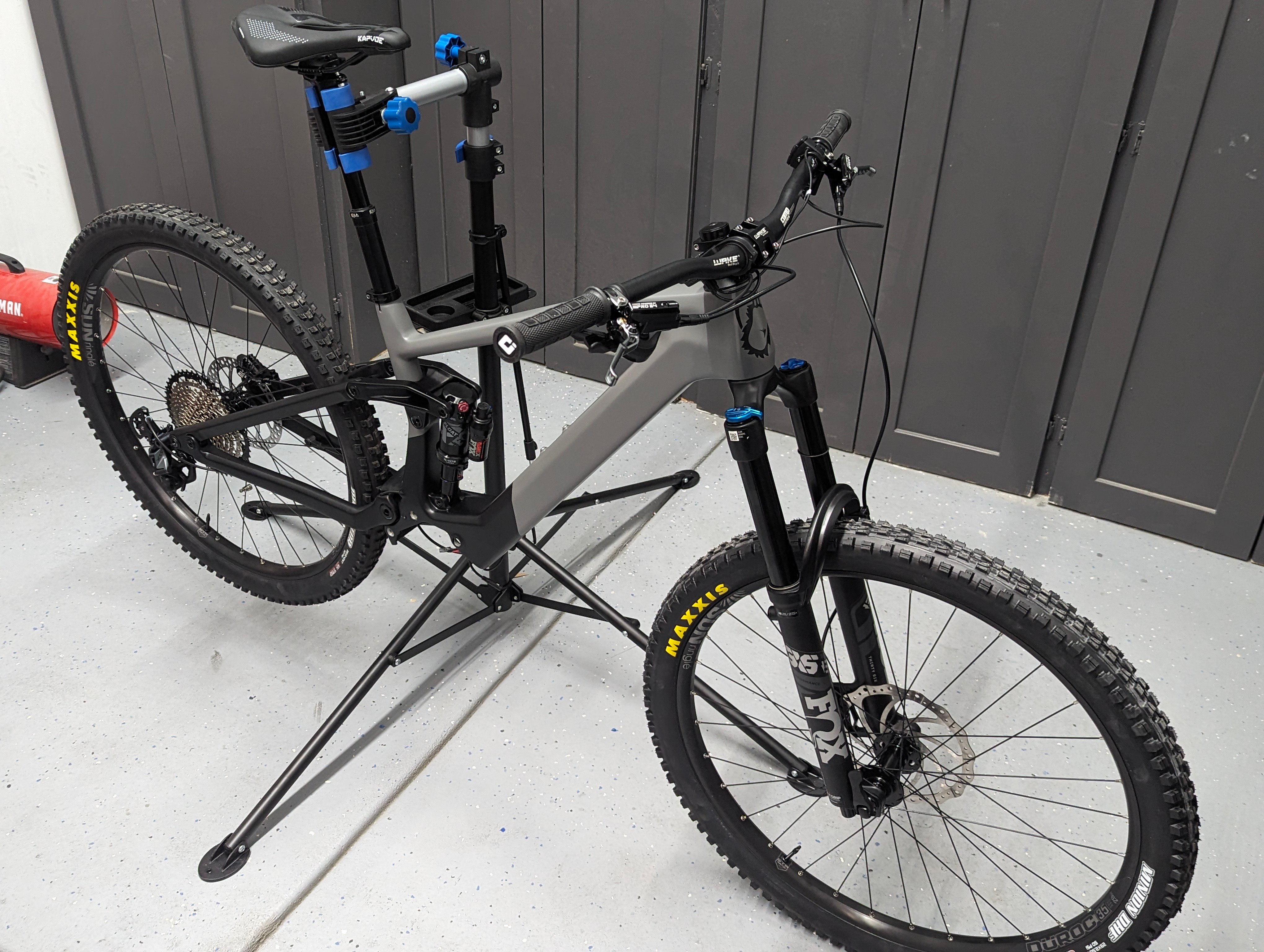

DV8 Build part II, Assembly.
Overall the assembly of the bike went well. I will be creating a video covering the specifics soon. For now checkout the build video! Also, feel free to ask questions and I'll do my best to respond with useful answers.

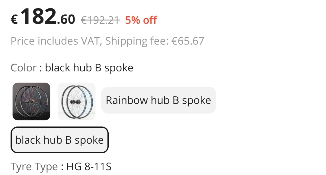

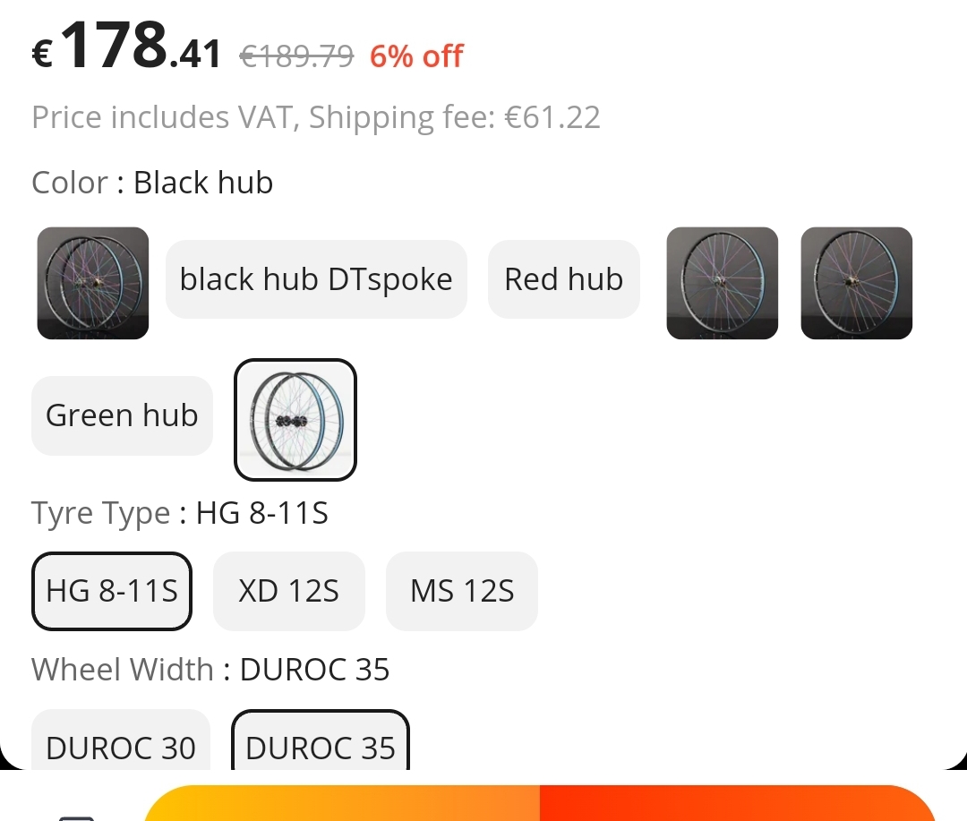

Oh that's interesting quite a big difference to me. Seen in the photos. However if I go to the same shops listing about the same wheel but boosted option and there you can choose black hub with black spokes for the same price 😅
Black hub R spokes
DTSpokes
And same shop boosted listing
link to boosted listing 126.72£ 5% OFF|Koozer Xm490 Pro Boost Hub Mountain Wheelset 27.5 29 Inch Sunringle Duroc 30 35 40 Tubeless Rim Custom Made Rainbow Mtb Wheel - Bicycle Wheel - AliExpress
