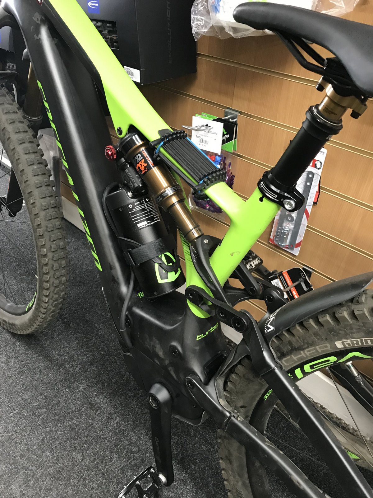

Yes, albeit a very small mod to cut a cable sized opening in the left hand side motor cover. It’s in the bit that gets covered by the battery so hardly noticeable. You also need a different bottle holder but this comes as part of the extender kit

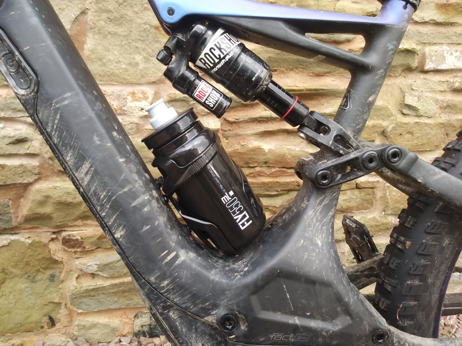

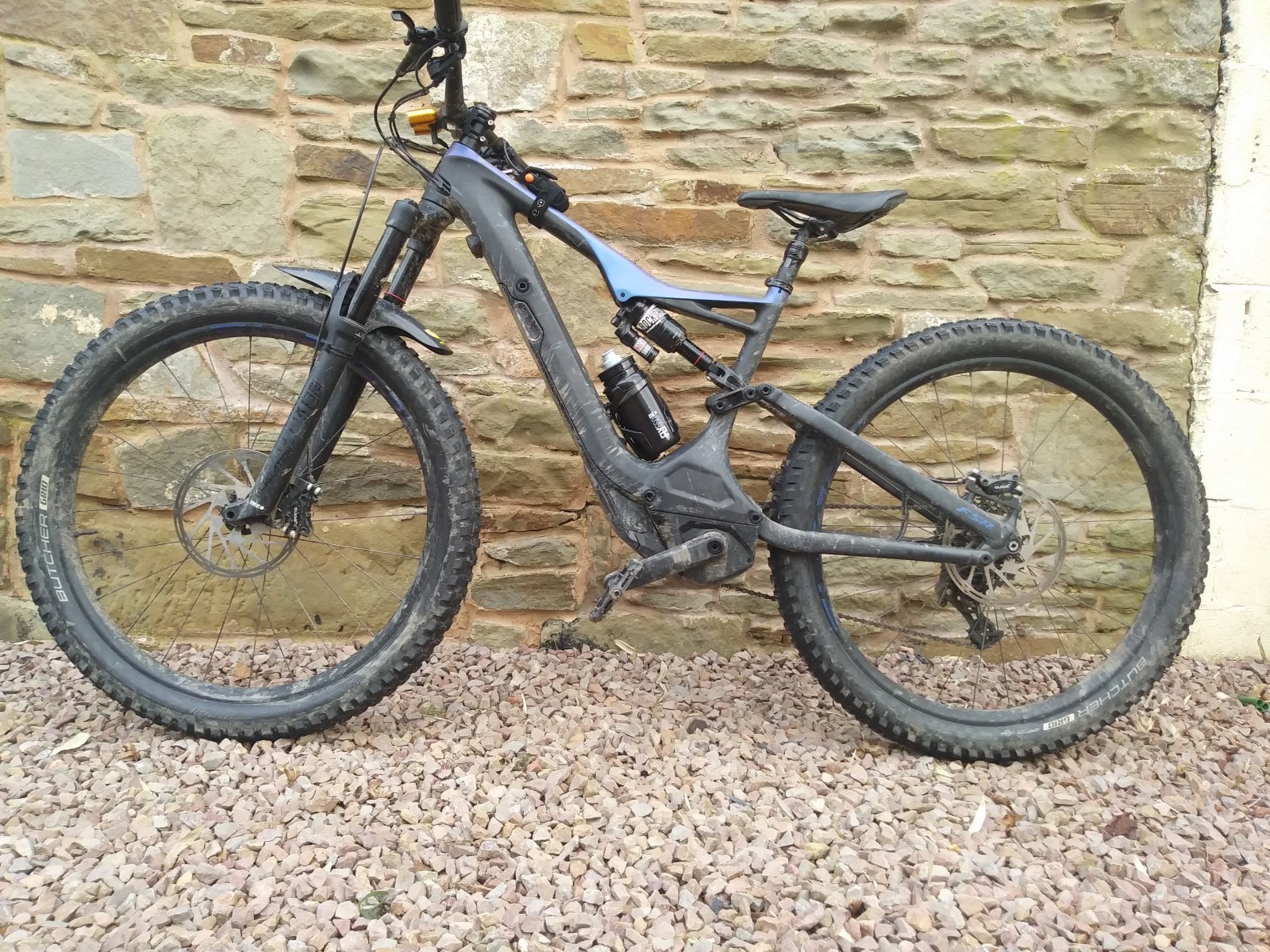

I found someone who will make a 180w extender in this waterbottle - Flyte 550ml
Includes BMS
I've been trying to get an extender that will work with my piggyback shock
I wasn't sure it would , so i bought an empty waterbottle to try out .
Will have to play with the cage to get it dialled
It currently sits about 8mm up from the frame at the bottom of my sized medium frame and clears the piggyback by 8mm also , which is pretty perfect.
Not quite as much wattage as id like but gives a combined of 684w. (504w +180w) - about 35 % more
Im really tempted . Currently discussing with fabricator
I'll keep forum posted

Yes thanks . Ive been in touch with Panos who was very helpful
I made a mock up to see what would work Definitely more options with an Ohlins shock . But im trying to avoid the expense of a new shock .
My Rockshox piggyback really limits what will work .
Even with the new flat top design from Danny it still wont fit .
I'll change the shock if i have to.
Exploring all options first though

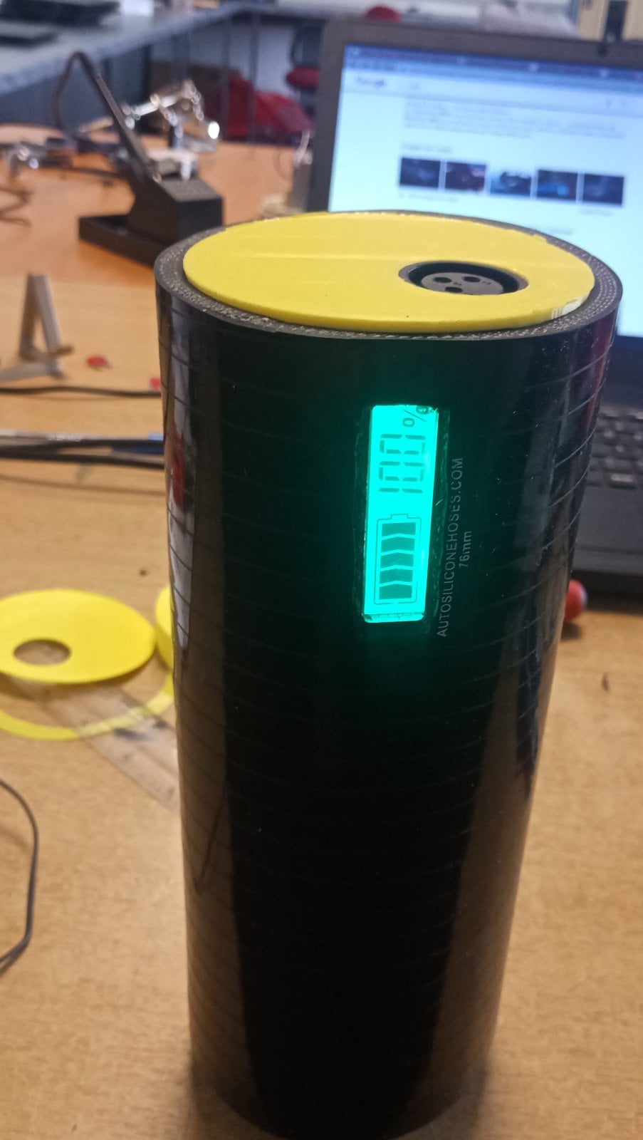

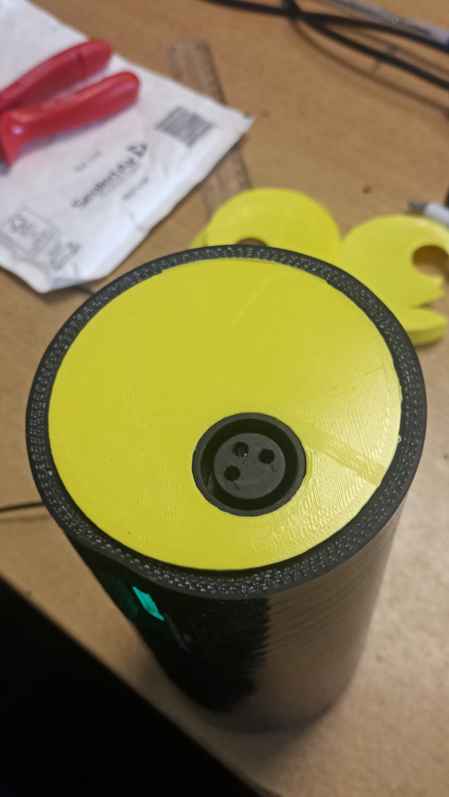

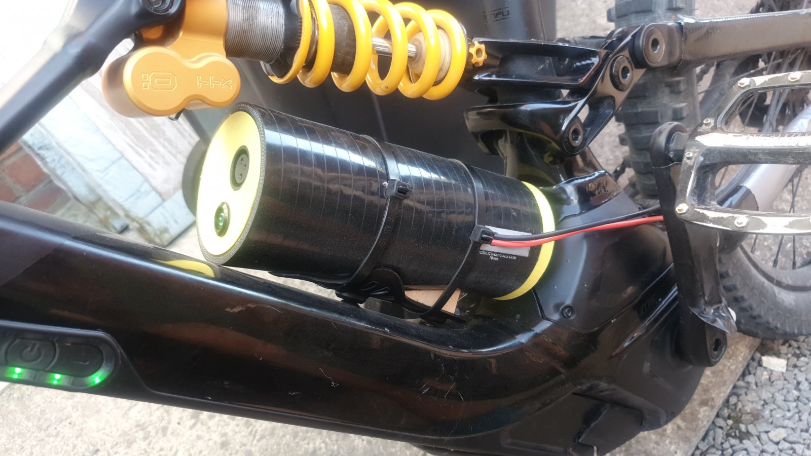

its been a while. Grown up duties taking all my spare time. However tonight I finally cable tied the range extender to my bike and took it for a whirl.. nothing caught ? or exploded so I'd call that a win . It needs a few little bits to finish it off but I'm pretty happy with it. ?
