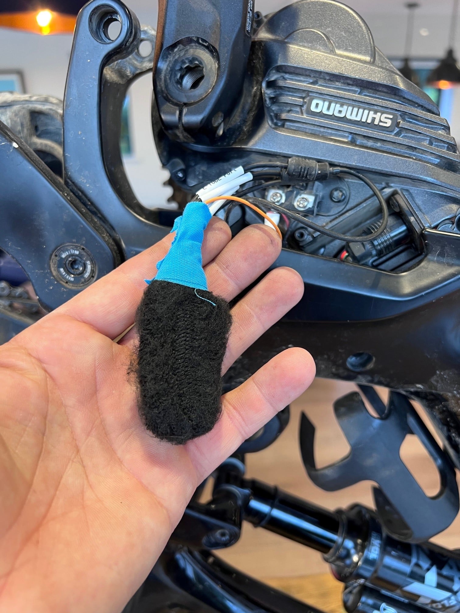

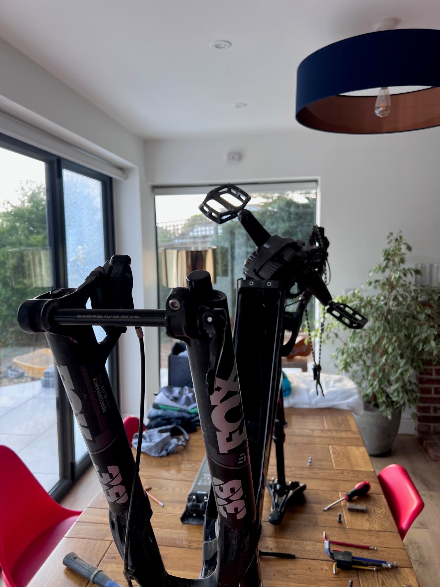

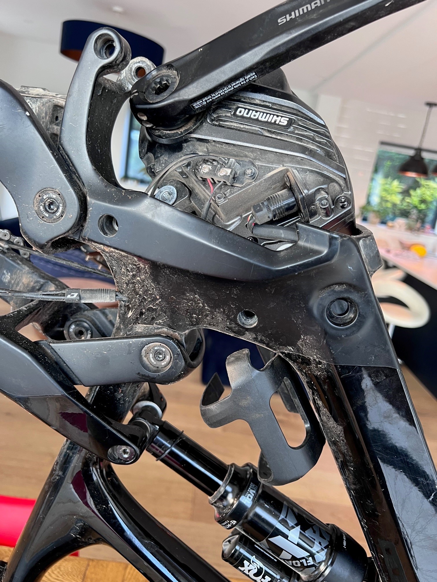

I just removed the motor and fitted an 'accessory'. Flowinh2o summarized it perfectly earlier in this thread:
1) mount it on a rack if you have one and take off both rims
2) remove chain from the front chainring
3) remove battery
4) in the battery compartment remove the one screw for the bracket that holds down the wires so you can get some slack on the cables. This will make removing the motor waaay easier
5) remove the chain guide so you can access one of the six motor bolts behind it
6) remove the four bolts holding on the bash guard underneath the motor
7) if you want to completely drop the motor just remove all 6 bolts. If you want it to sit nicely in the frame and not just fall out first remove the 4 on each side towards the front of the bike and then just loosen the two remaining ones at the lowest point near the rear. This will allow you to pivot the motor in the frame and get access to the wires without pulling the whole thing out. You can see below how it can just sit in the frame with just the back two bolts.
My only addition is not to bother with a stand, just flip the bike upside down, this way the motor can't fall out. Once loose you can rest the motor assembly (complete with cranks) on the frame at an angle and leave the main power cable connected.
Also, if the motor is too tight to remove, just tap it very lightly with a rubber mallet (in the correct direction) to break the dirt seal. After that it'll lift out easy.
It's always a good idea to take loads of pics so you can look back at where a cable was sitting before you pulled it all out.
Tip: to prevent any accessories from rattling against the frame, find an old (ideally waterproof) winter glove, cut the thumb off and turn it inside out, put your accessories inside and tape shut. You can then drop that into the bottom of the seat post (because the bike is upside down).
Total time spent fitting my accessory was 30 mins.
