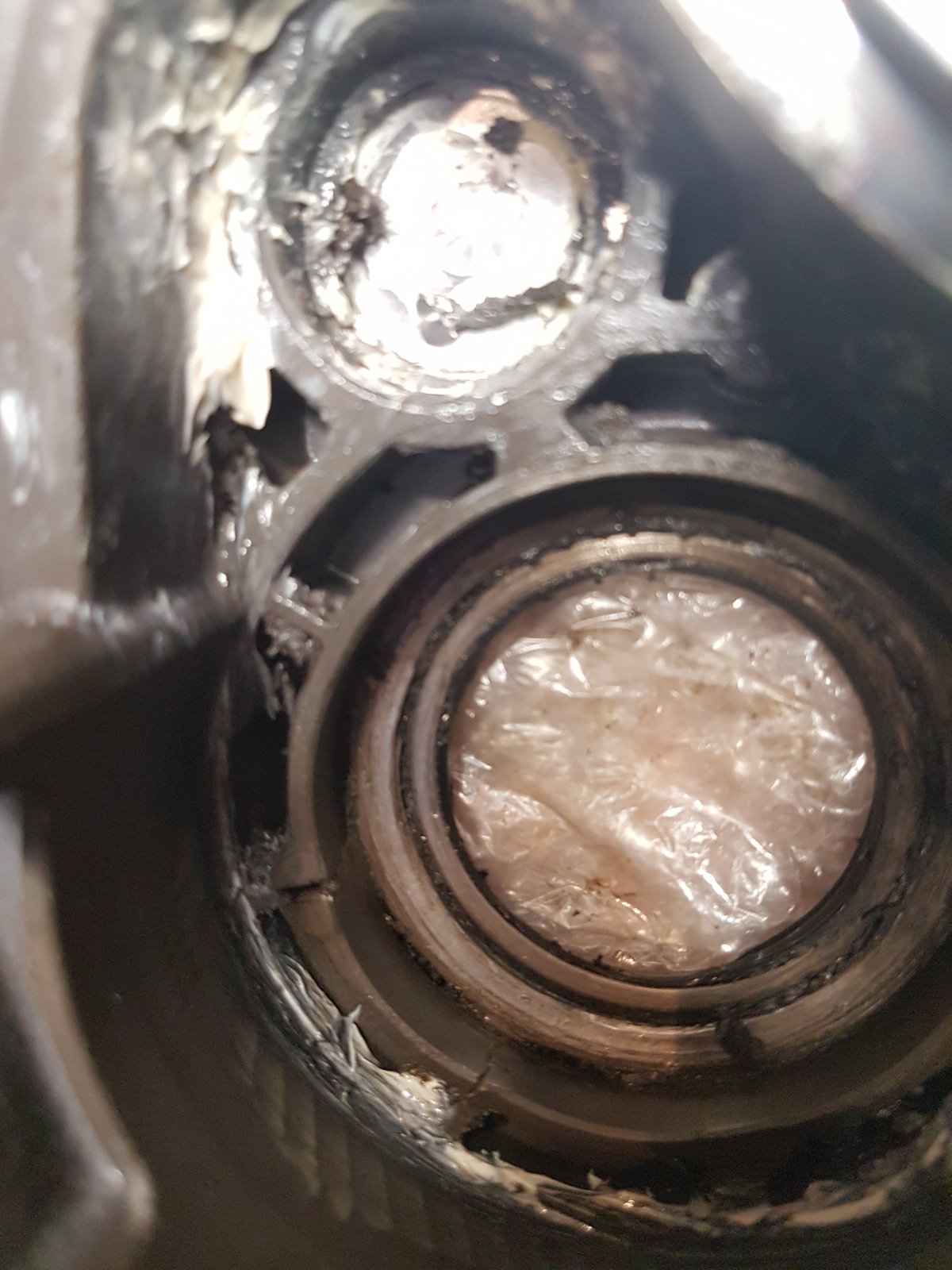

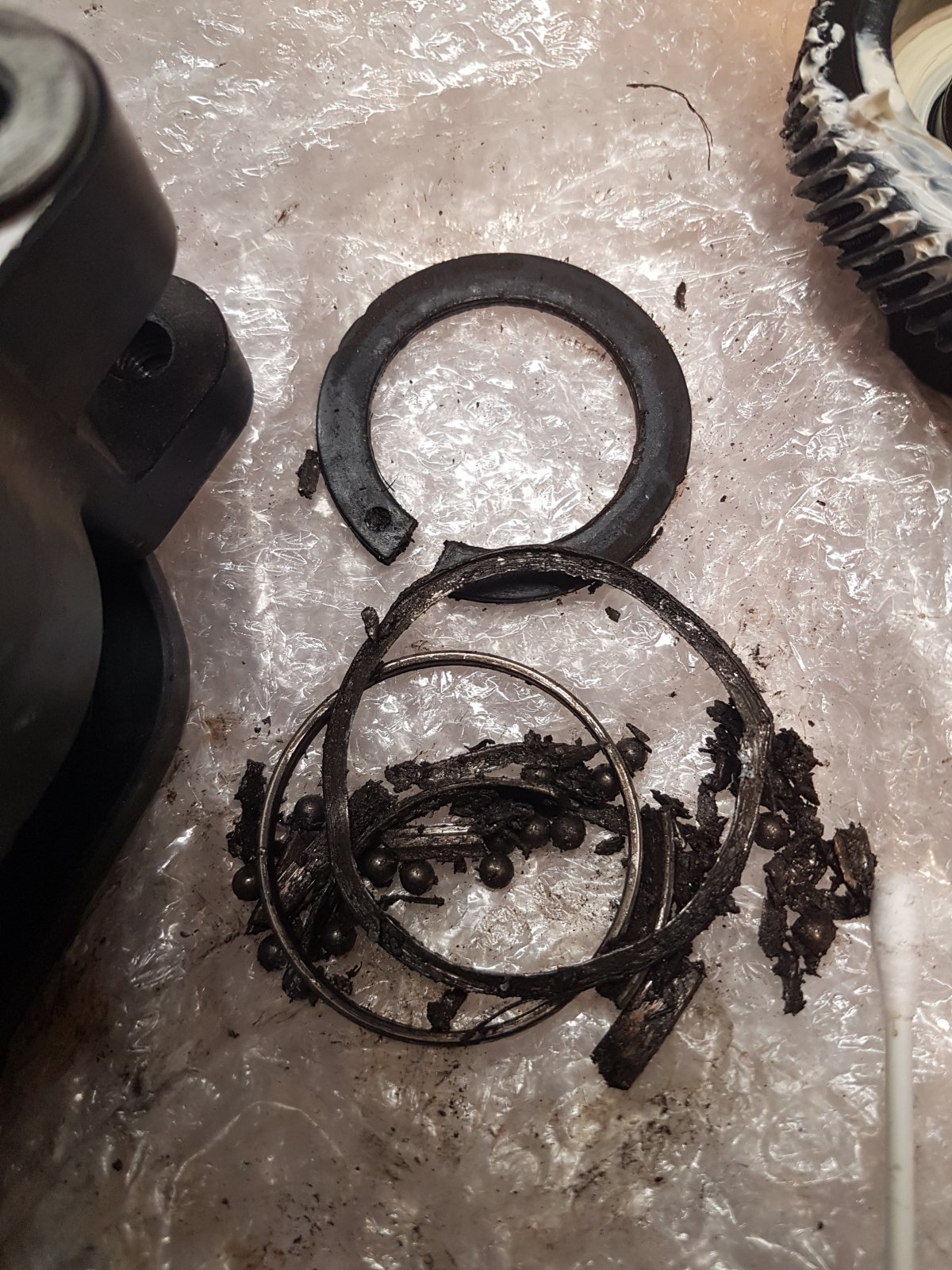

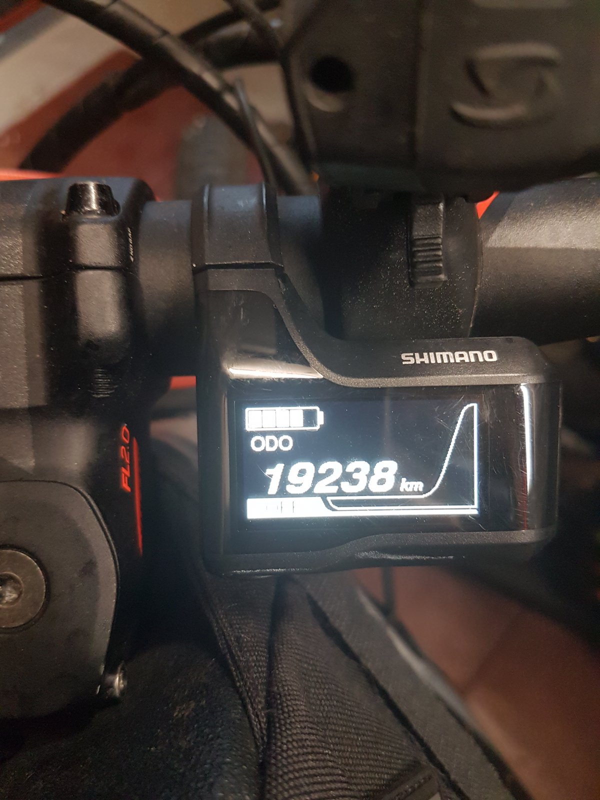

19k bearing broken
Spiff
Feb 27, 2019
414
240
Earth
Can you fix it by replacing the broken bearing?
There is another thread with tons if info about replacing the bearings

I think the inner bearing support broke.
Quite the distance you got there, but jeez what a mess inside!
It looks very dirty, or are those all shavings from an annihilated bearing race?

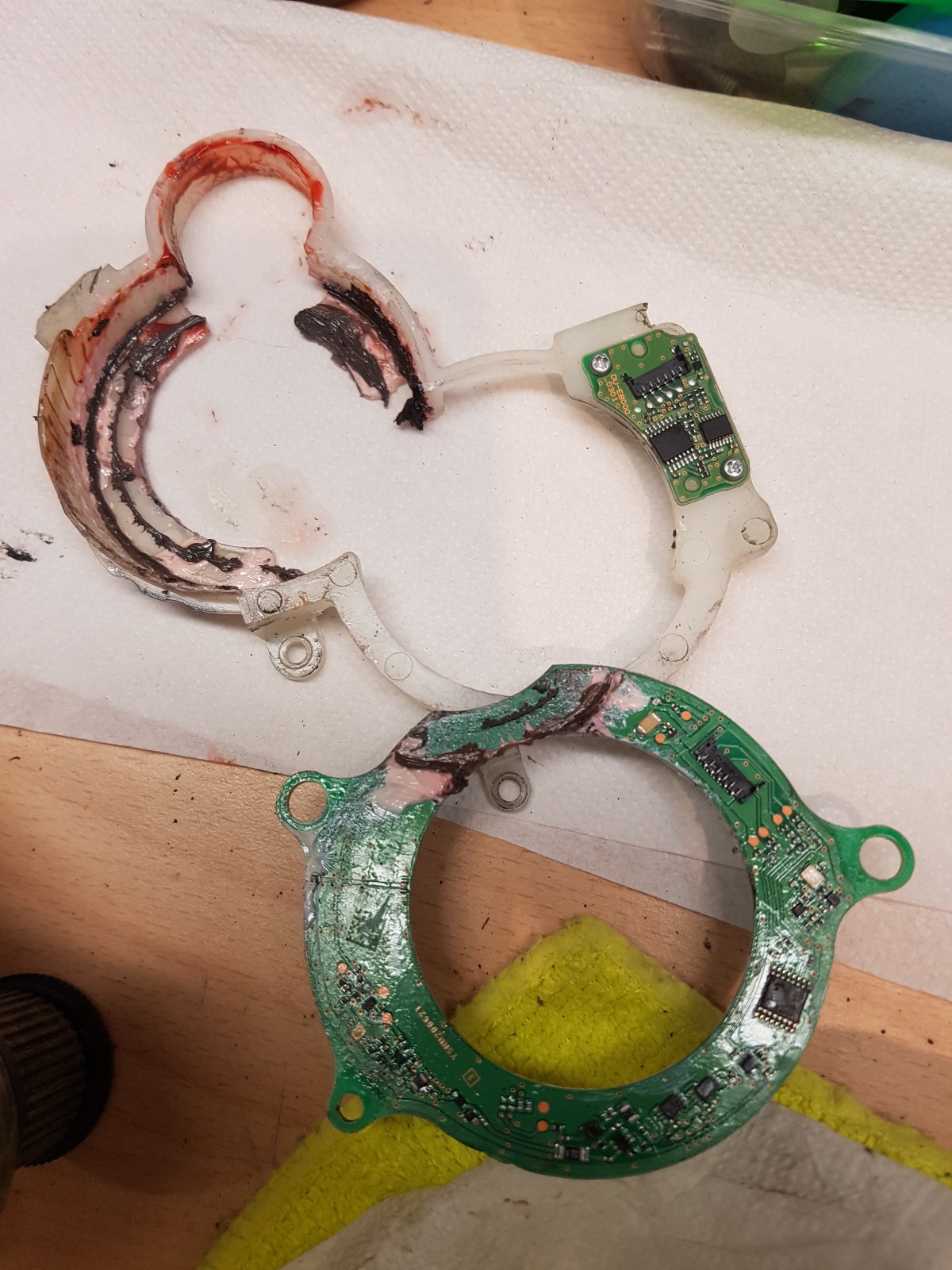

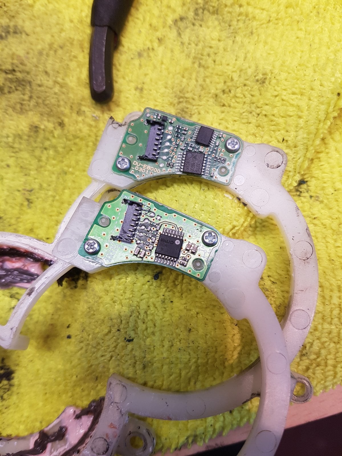

All components were moved from the new engine, only the electronics was left over from the old one I made 19k km
Hi, let me summarize what I believe you did and please, correct me if I am wrong. We know very little about the errors in these motors and these repairs help to improve the understanding.
  1. You had a E8000-1 where bearings exploded and damaged the gears, but electronics were fine
  2. You bought a second motor E8000-2 and after 300Km you had errors E010 and W013.
  3. Then you moved all the bearings and gears from E8000-2 to E8000-1 and now you ave a refurbished motor E8000-3 with new gears and bearings and old electronics.
As you did not invoque Shimano warranty for the second motor, I assume you bought it from 4mybike.de store or ebay, or another similar store. Can you please confirm where you bought it and if it had warranty.
So according this, the conclusion is that errors E010 and W013 in motor E8000-2 were caused by faulty electronics.
Can you please confirm which motor components you kept in E8000-3 (See image below):
  • From old E8000-1:
    • Motor housing
    • Electric Motor
    • Axle Electronics
    • Main Board Electronics
    • Torque Electronics
  • From new E8000-2:
    • Gear 1
    • Gear 2
    • Axle and Gears, which I believe includes the torque sensor that is glued to the axle
I am sorry for the many questions, but as Shimano does not provide any help, then we have to understand by ourselves how to fix the motor in case of failure.

johnynl
Jul 24, 2021
Netherland
Did you check the main large bearings in the axle, were they OK?
  • From old E8000-1:
    • Motor housing
    • Electric Motor
    • Axle Electronics
  • From new E8000-2:
    • Gear 1
    • Gear 2
So yes, the first motor damaged the bearing and the motor housing, everything else was good except for one thin washer that broke.
I put on a second engine that I bought a year earlier without a guarantee, but it had a mileage of 0km and was new.
Practically from the first kilometers, something was wrong with the engine because it happened that he started accelerating himself without a strong touch on the pedals and immediately showed the error e010, then everything was ok for a while, but after a week again, after driving 20km, the error e010 suddenly appeared at a standstill and nothing no battery reset helped, so in one of the videos on yt where the e8000 system was changed to ep8, the boys said that the shimano service claims that the e010 is a pressure sensor error, so I opened a new motor and replaced all electronic components from the old motor
