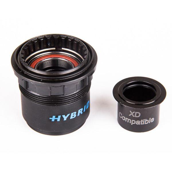

I'm going to take this opportunity to upgrade the groupset and brakes. I'm undecided between the SRAM Maven Silvers, and the Hope Tech 4 E/V4 but those don't seem to be too difficult to work out what to buy in terms of parts.
I'm going to buy SRAM's GX Eagle Transmission groupset including the cranks, but this is where my lack of knowledge starts to shine. I think the CFR's DT Swiss 350 rear hub is incompatible with the T-Type, but I have no idea what to buy. I've looked at DT Swiss' website and can only find DT350 hubs for the front wheel.

Canyon CFR has Shimano Microspline, so you'll need a new freewheel body from DTSwiss (Sram XD). You can buy it at some online store
(Ex: Conversion Kit SRAM XD Pawl Drive System Freehub Body)
[PERSONALLY, I would slap a DEORE cassete - full steel, and carry on].

Thanks very much for the link, super helpful!
It's tempting from a cost perspective to replace the cassette and carry on, but I've had to fiddle with the gears almost every time I've gone riding. I don't get the opportunity to ride often, so it's frustrating to waste time.

@RJUK apologies for the tag, but I think you installed the SRAM Transmission too? Do you perhaps have a link to the part you used to make the rear wheel compatible?

I believe this is the one I got. Annoyingly it won't let me just click through from my order, but this has the exact same description and looks the same.

Thanks so much! The 12x142 description threw me off since the wheels are 12x148, but I guess it’s compatible because it says “or BOOST” too.
