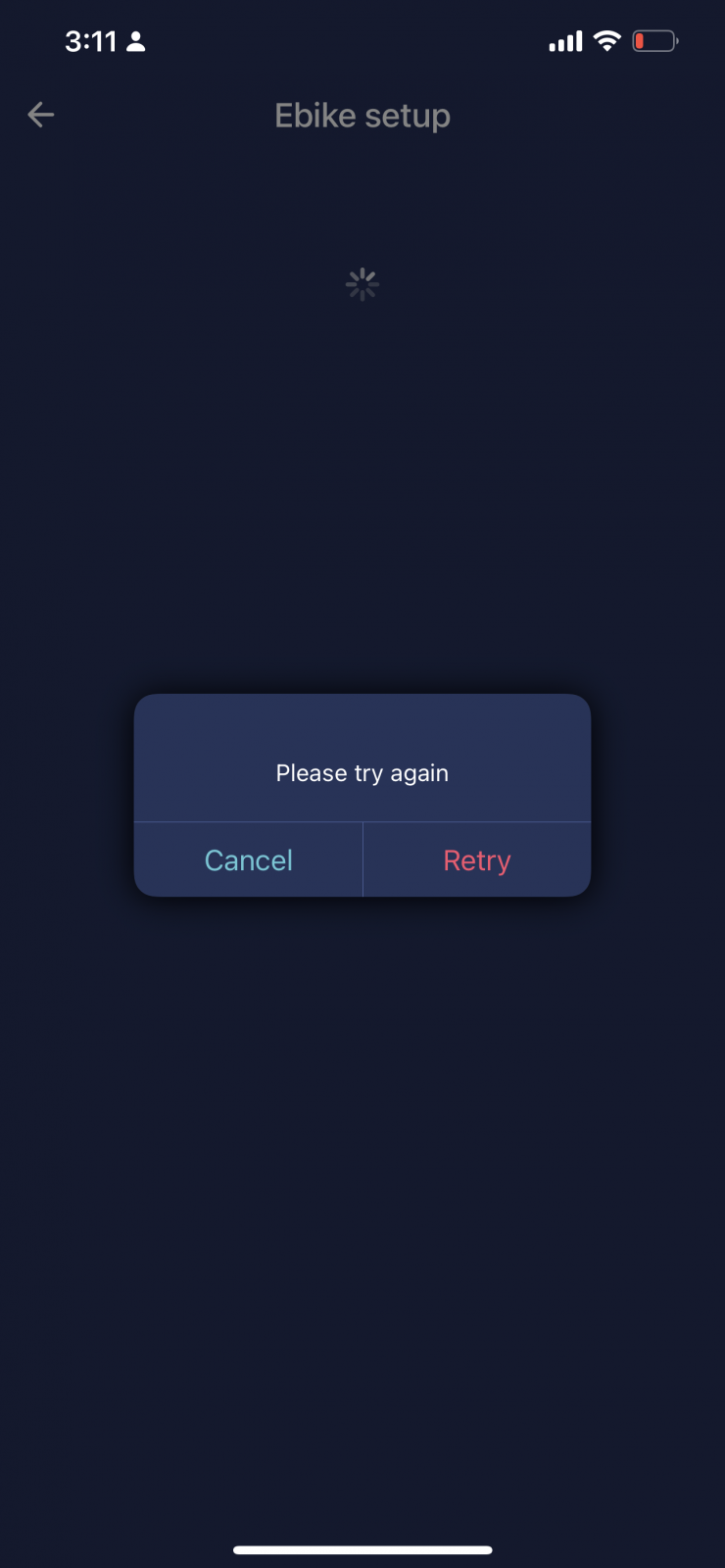

Hi, ever since I purchased my bike I've never been able to access ebike settings within app. My bike is synced otherwise. I've got the latest update. I've tried removing battery, reinstalling app and I continue to get the 'Please Try Again' notice on that setting. I have this expensive bike and I can't even adjust the motor settings. Anyone else run into this issue and know how to resolve it? Love the bike otherwise! Cheers.

Hi, ever since I purchased my bike I've never been able to access ebike settings within app. My bike is synced otherwise. I've got the latest update. I've tried removing battery, reinstalling app and I continue to get the 'Please Try Again' notice on that setting. I have this expensive bike and I can't even adjust the motor settings. Anyone else run into this issue and know how to resolve it? Love the bike otherwise! Cheers. View attachment 80158
When I got my Trance in 2019 the old app had just been released, and the button needed to get to the motor adjustment section was greyed -out.
I took it back to the bike shop and they contacted Giant and were told to connect the bike to their computer and run their diagnostic programme.
This re-set the app and everything worked in the motor adjustment / diagnostic section but the ride recording section of the apps have never worked properly, so most people use a Garmin instead and just use the Giant app for updating and adjusting the motor settings.

I had lots of connection issues when I have an Android phone. With an Iphone it seems to work ok. So could this be a phone issue rather than the bike ? Worth a try on another phone.
Is there any Fix for this?

You seem to have iPhone, are you running version 1.18.0 (latest)?
I am at 1.17.2, and all previous versions since 1.15 have been without issues on iPhone, Reign E+2. Sorry to hear you have problems, seems like a visit to LBS…

I am on the latets version 1.18.0. Is there a way to get an older version on the iPhone?

Not from the apple app Store you can't, don't know if LBS have a way to do this? What bike do you have?
