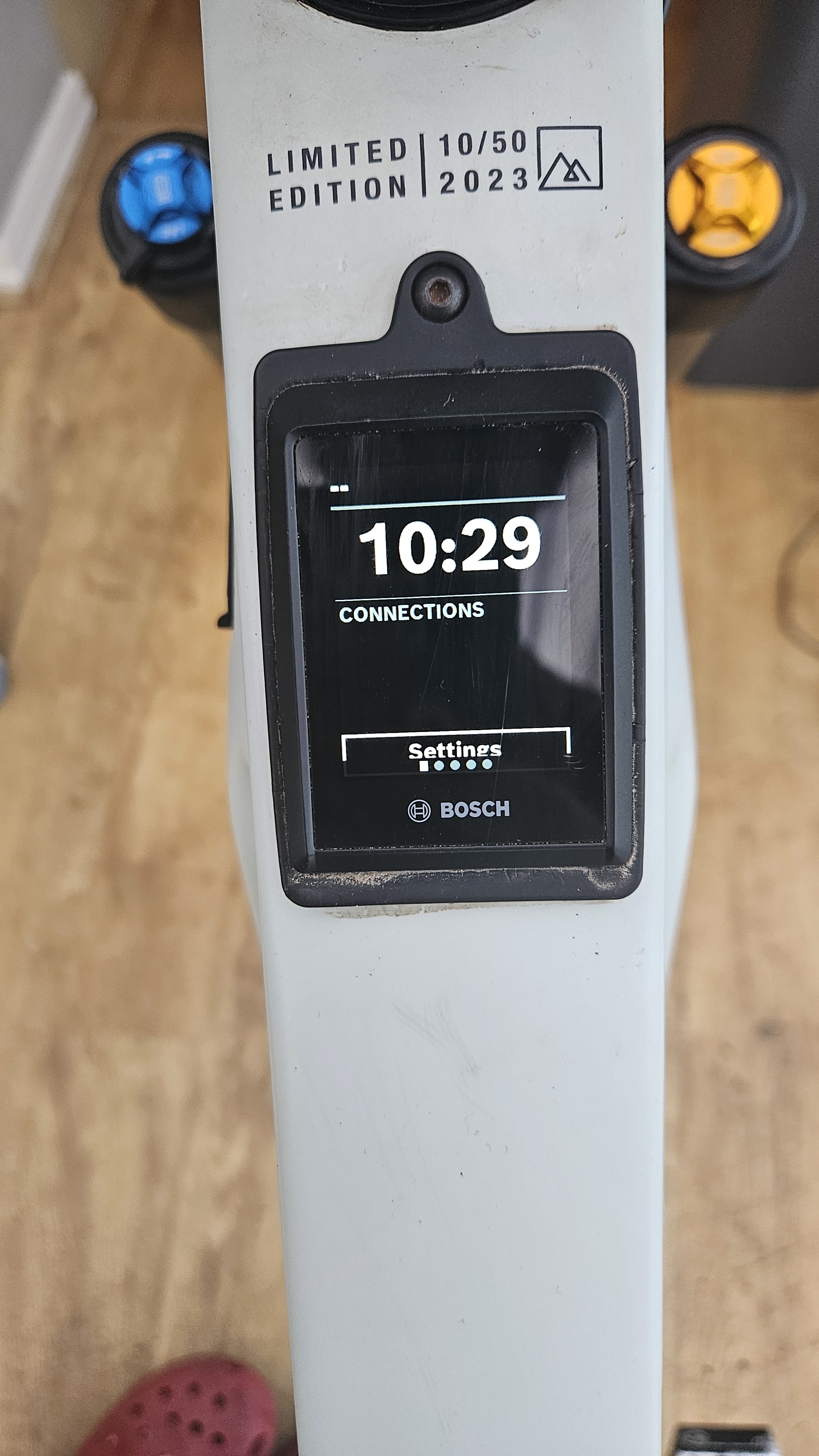

After my last charge I went to power up and the Kiosk 300 display flashes then comes up to this screen and powers off.
I checked all connections and disc/connect the battery.
Any recommendations?
Thanks

That's a crestline isn't it. Mine did that you will have water ingress behind the kiox and on your terminals mate.
This ended up being the issue. Some micro corrosion on battery plug.
I cleaned up connections and it started normally.
I let everything air out then resealed the kiox and cable entries.
Has been good for several rides now.
