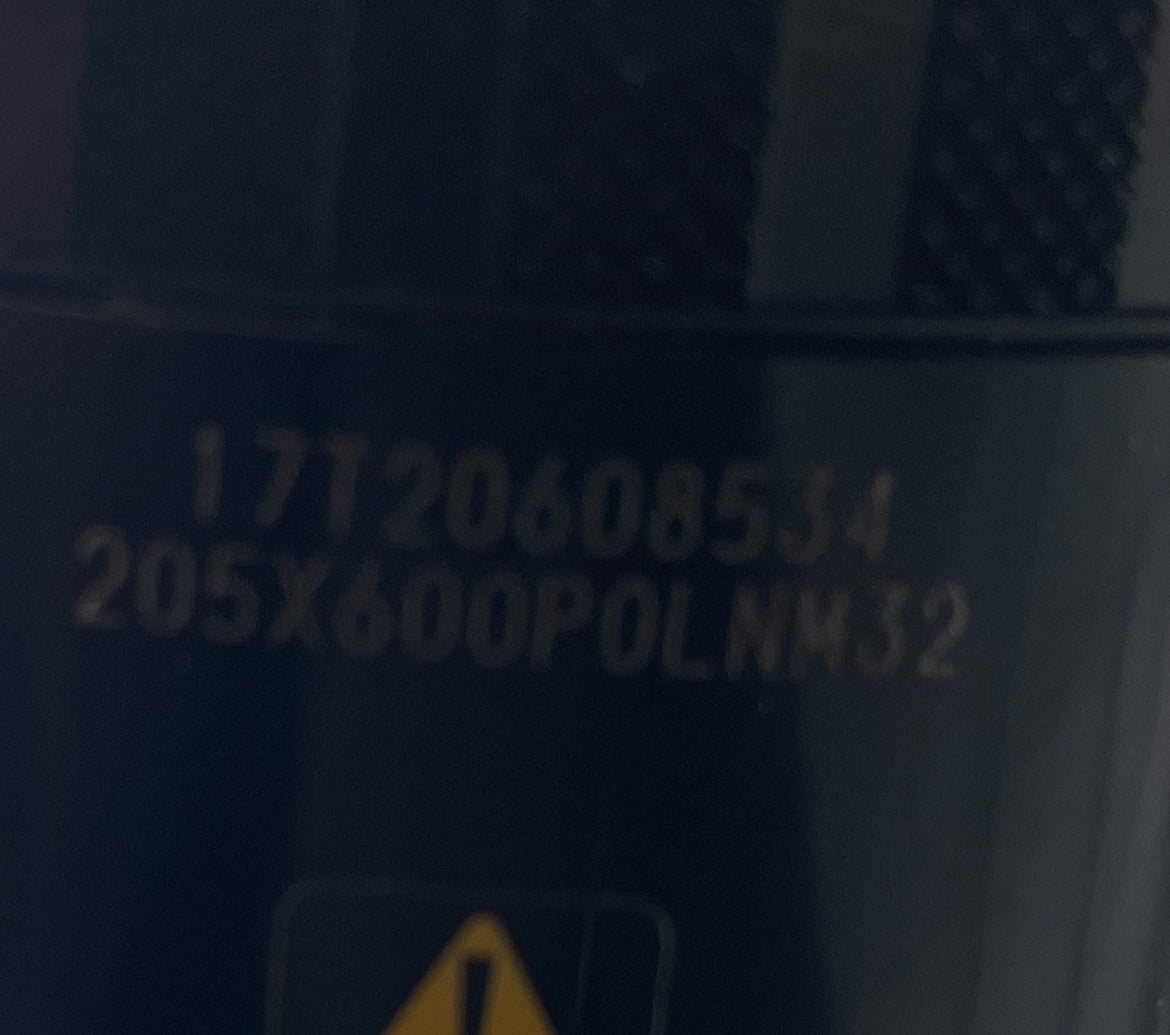

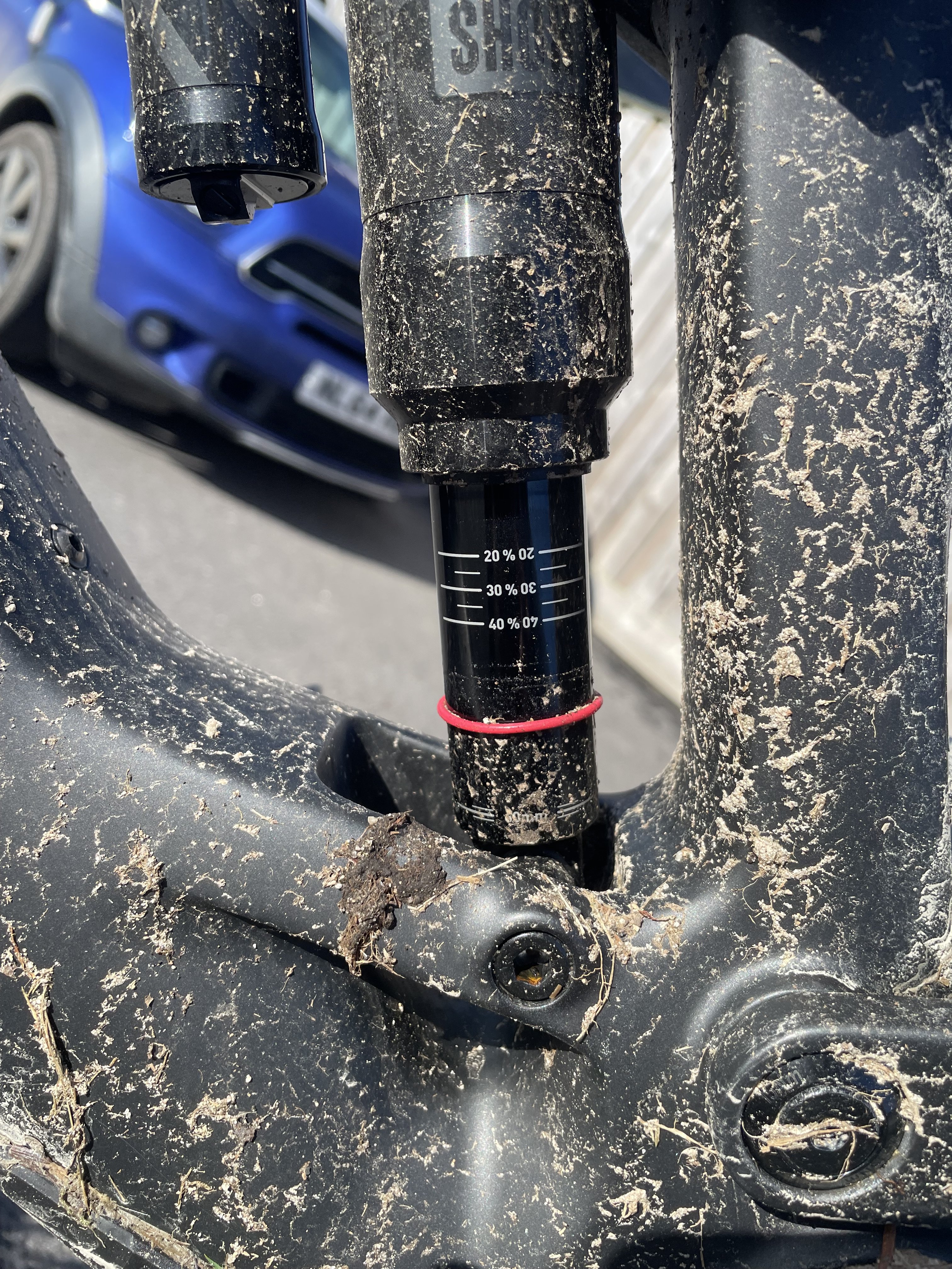

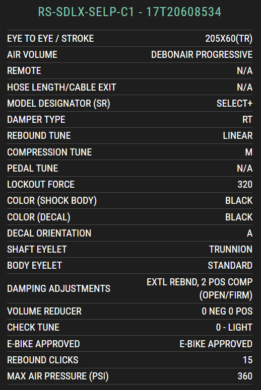

This is as far as it will compress with no air in it. And also the tune code. It has no tokens in it.

The bike feels great, even over really rough chunky stuff (think Peak District long loose boulder ridden trails). I feel as though I should be using full travel on the trails I ride. Maybe I’m just a none sendy light weight 😂

@Dave_B thats not too bad but I would guess you have some excess fluid in the air can that’s preventing that last bit of travel. If you’re inclined I would look into removing the travel spacer to see if you can get 62.5 or 65mm stroke. You’ll want to make sure the reservoir doesn’t hit the Downtube at full compression (check with no air)

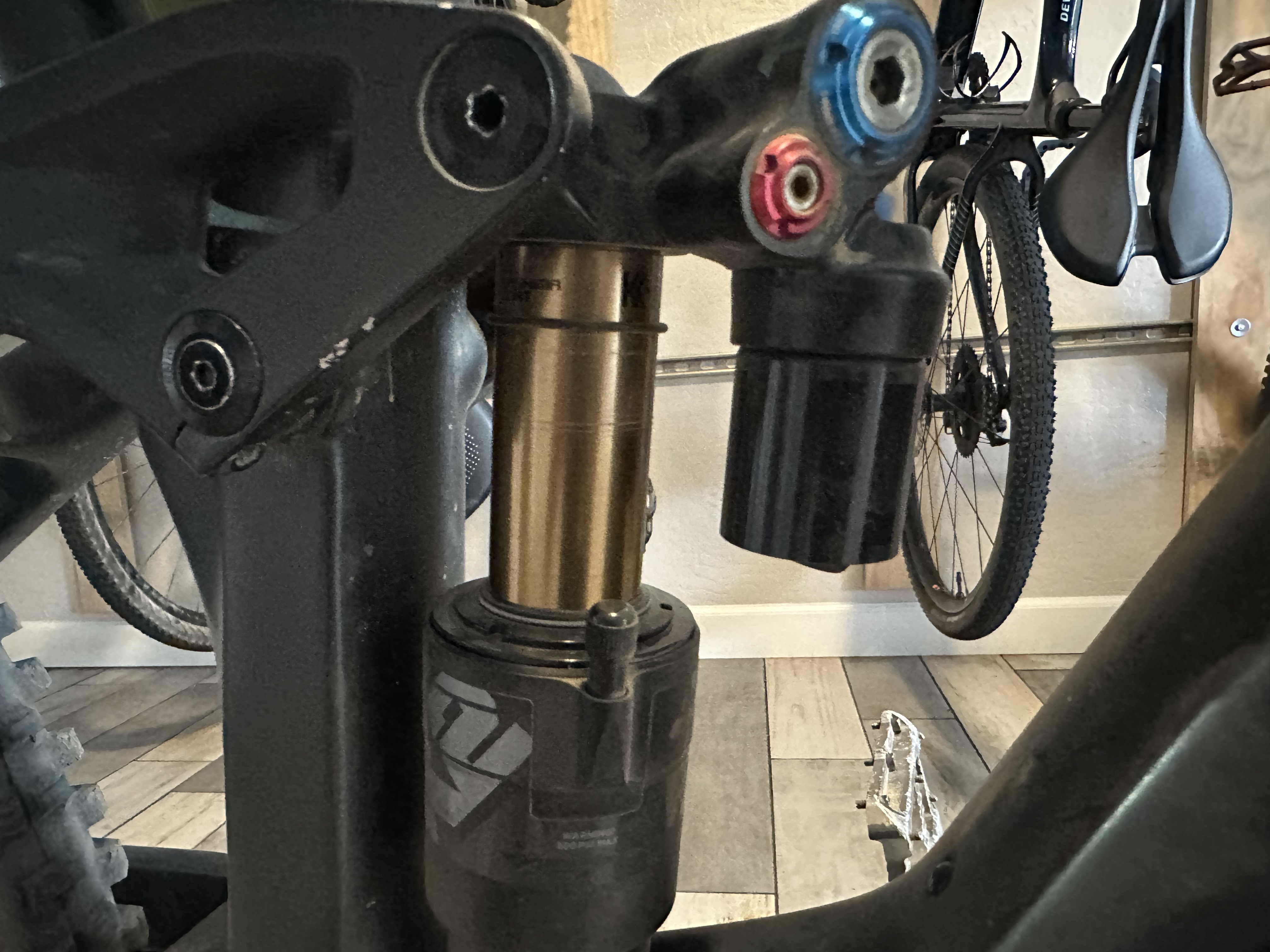

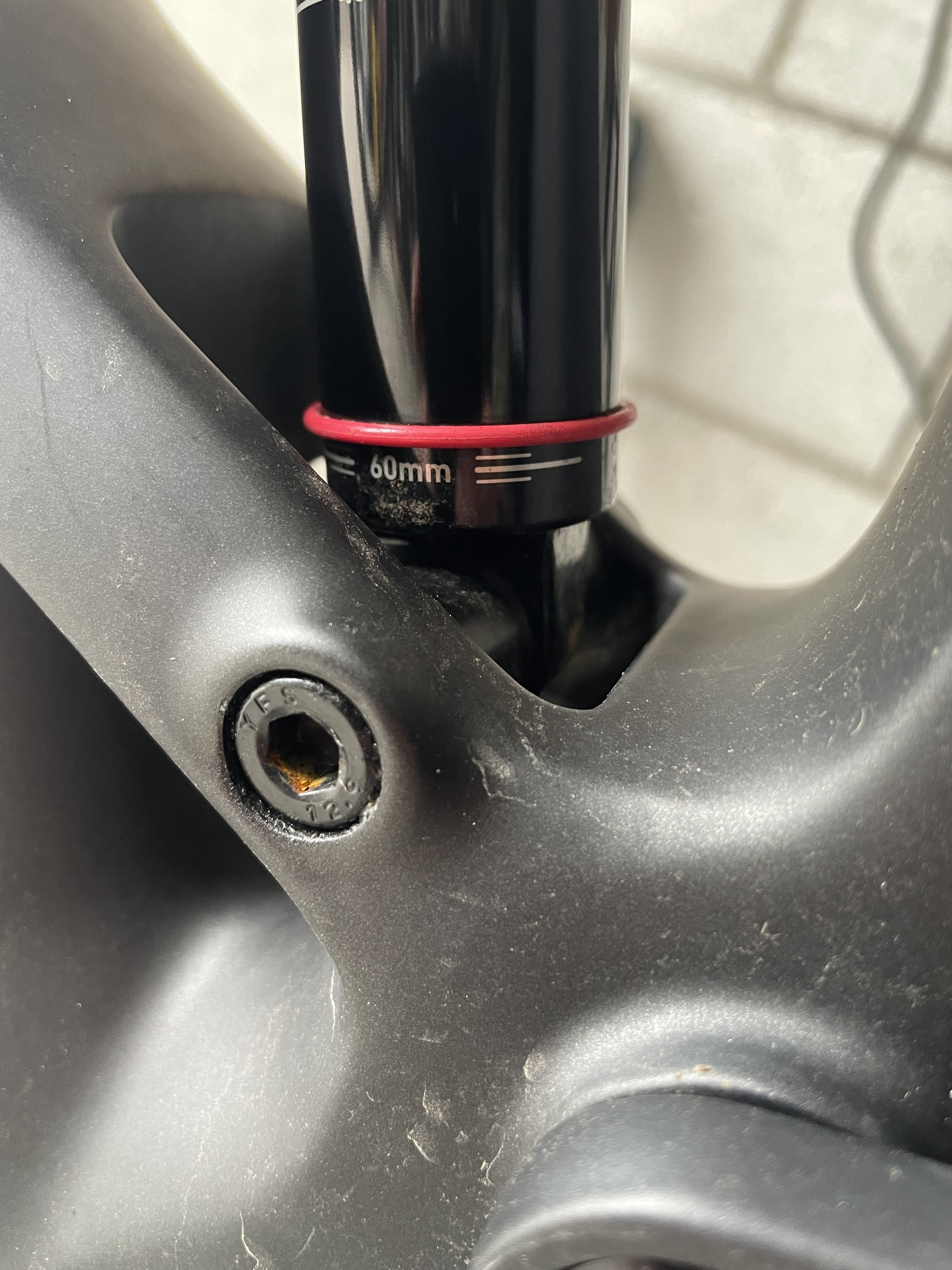

Looking for some advice on my X2. I am not going through all of my travel per the photo below. Based on the photo, should I remove a volume spacer or leave it alone? Any other recommendations? The shock is feeling good otherwise, but I would like to use all of the available travel. I appreciate any advice.

If it’s a 60 mm stroke shock, like the OEM shock, that’s very close to full travel. Mine is a 62.5 mm stroke and the rubber ring is just below the word Kashima on the gold shock tube at full bottom out. Plus, you’ll never get the advertised 60 mm of stroke anyway. If the shock feels good and you’re sag is set at 30%, I wouldn’t worry about that last couple of millimeters of travel.
