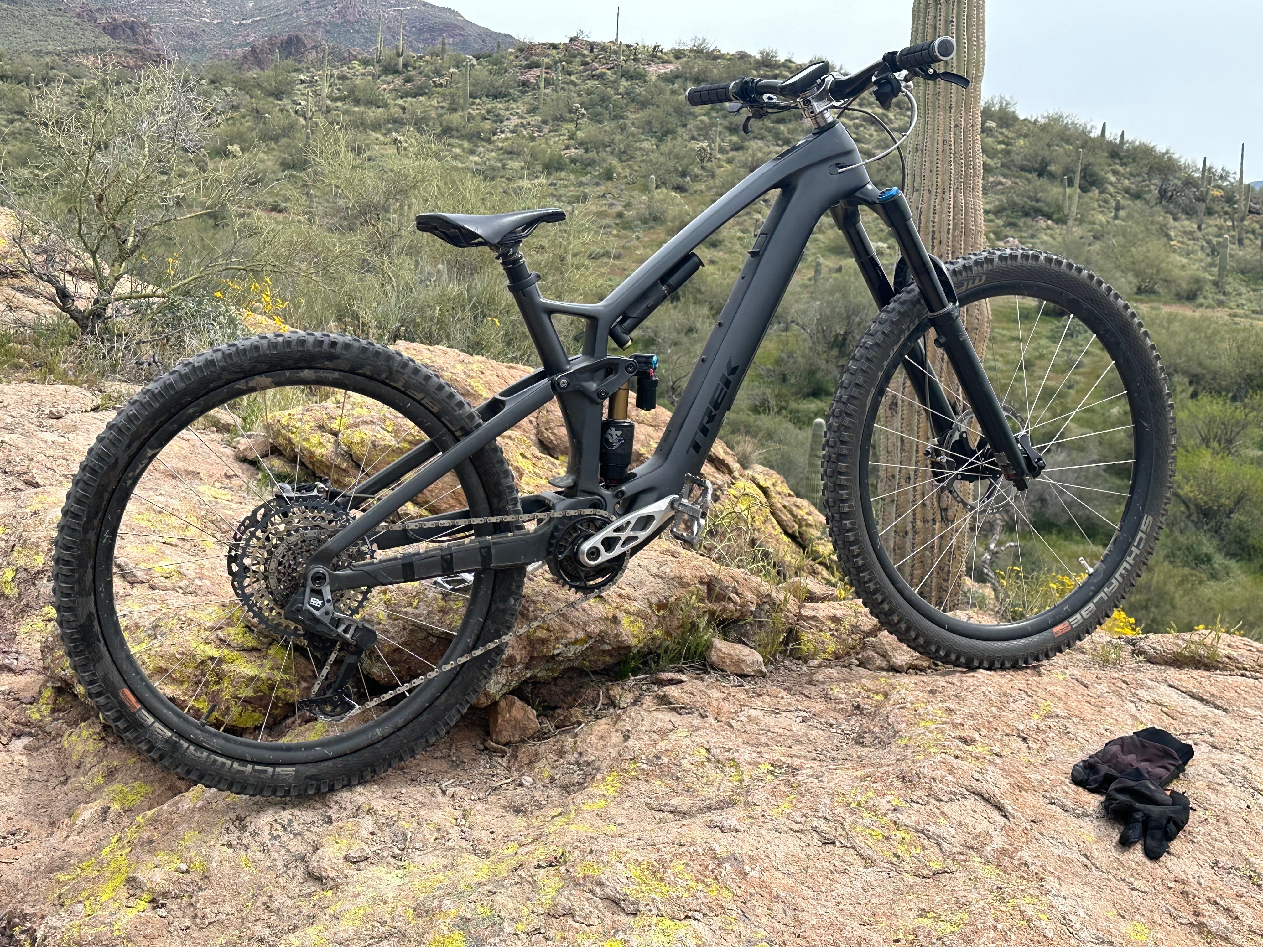

Curious to see how many miles and how reliable your EXe has been. Mine just turned 2,000 miles. I haven’t had any issues whatsoever on the bike. The motor is still as quiet as my first ride. Hopefully the next 2K miles are just as flawless.

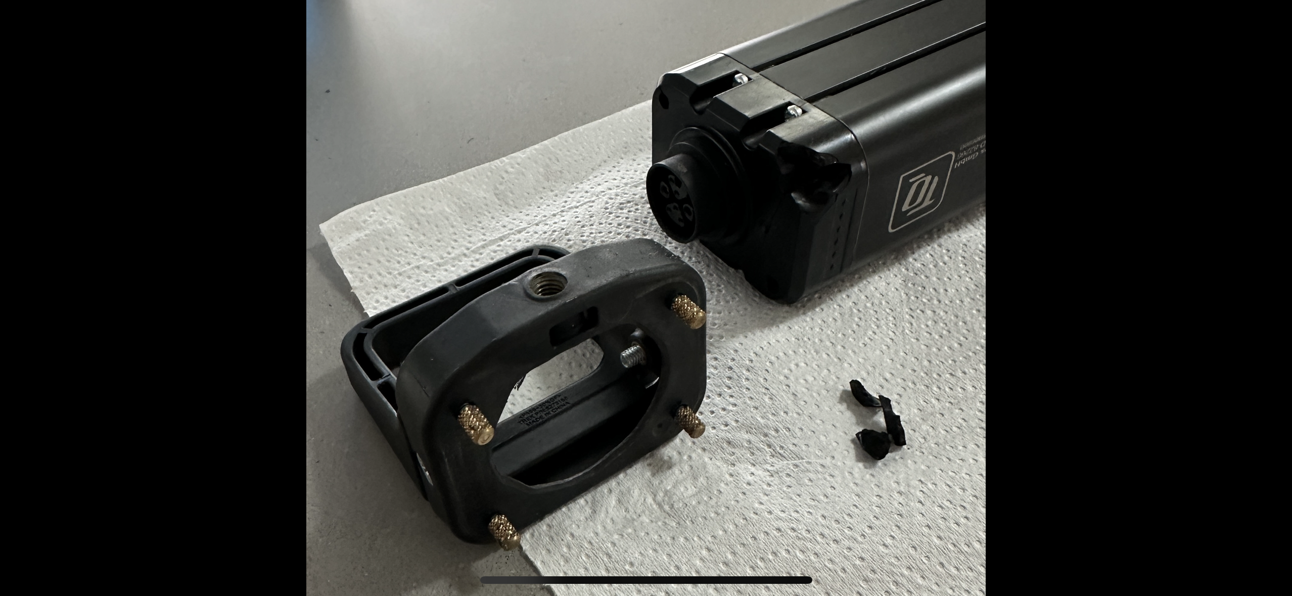

New battery (handle screw grommets detached from battery body, on inspection all places where there are grommets have hairline cracks, suggest you inspect yours)
