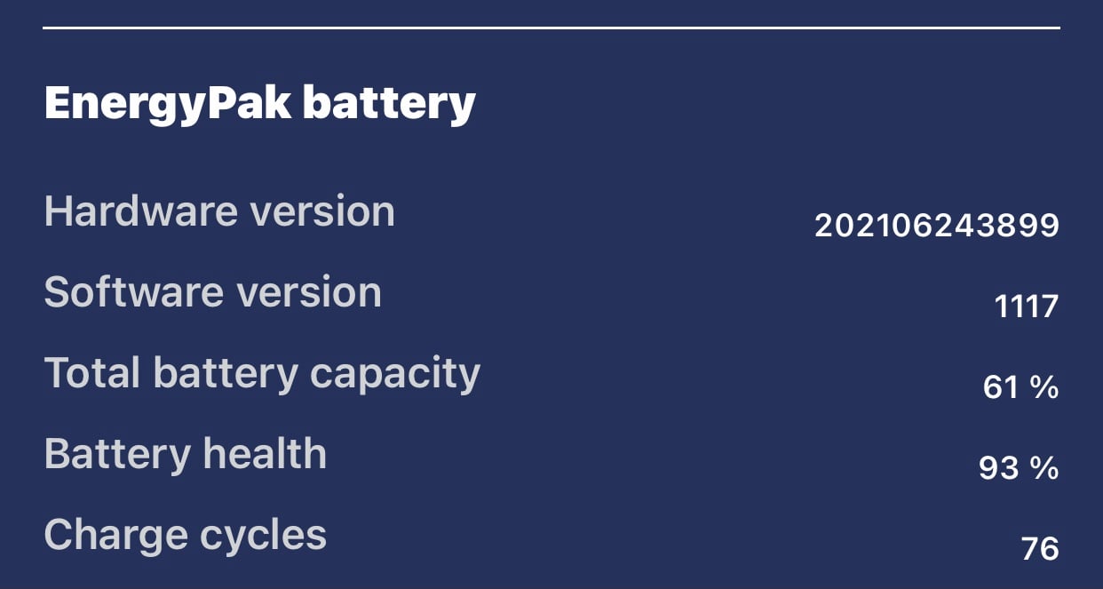

I have a 2022 Reign with the 625Ah Battery Since new the Battery Health has been gradually falling it's now at 93% after 76 charge cycles.
I Only Charge to 60% after a ride fully charging before next ride I ride a couple of times a week and Discharge Fully every month or 2 as recommended but the battery does seem to be loosing health fairly consistently and much faster than i was led to believe it should.
What sort of Health number is everyone else getting ?

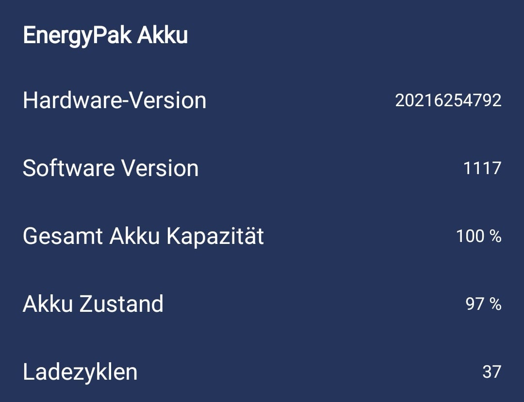

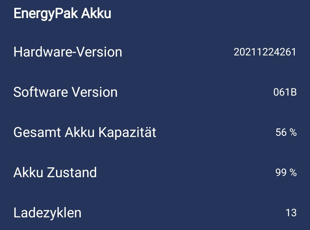

I don't worry to much about it. The health is a "best-guess-effort" of the App reading the Data from the BMA.
If you want full details, ask your dealer for a service report. It includes the full details like remaining WH etc.
Only if the battery is not needed for more than six weeks, I charge up to only 60%.
View attachment 134440 View attachment 134441
Yours are what i would expect, i don't expect it to say 100% forever line an iPhone does LOL, I would expect it drops a little from new then stabilizes, mine seems to be quite constantly losing 1% for every 10/11 charges at that rate its going to hit 80% well before 1000 charges which is what giant say the basstre is supposed to do. Im thinking of getting an 800aH battery for the bike this year so that will help if i spread use between 2 batteries.
