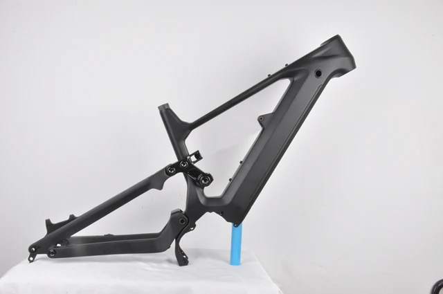

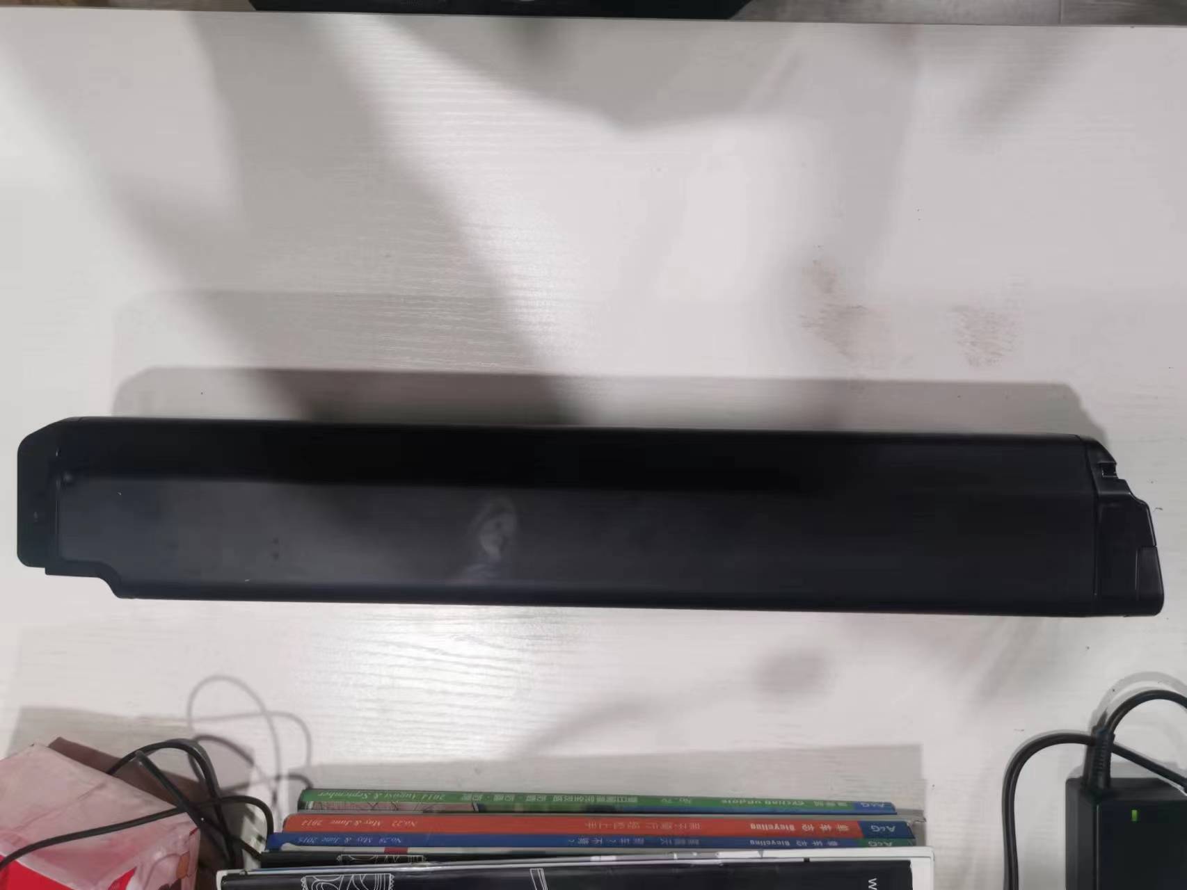

Thanks mate! It’s the same battery housing used for E10? Are they interchangeable?

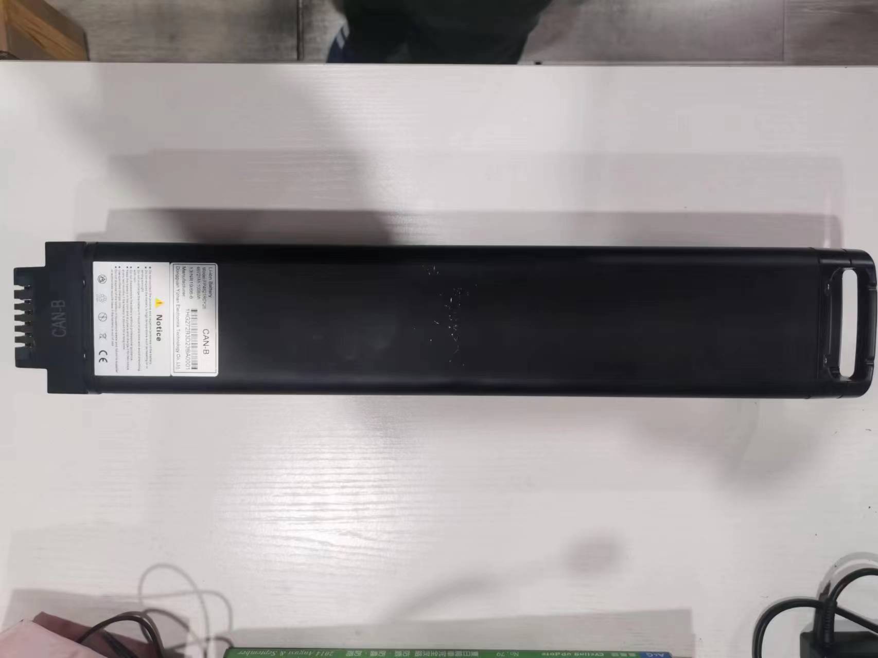

Hello Thaeber
What I see they did use same connector with 6 knife contacts. Some are used for CAN communication. So you wont put there old battery (has 4 contacts). And E82 battery is bigger.
So lets see if they come up with new battery connector. Extra CAN connector from battery would be also ok. Just I guess they want to leave it with simple battery removal.
I would also welcome if they remove that key lock mechanism and replace with one hex screw. And battery would hold there tight. No rattle and no water ingress over key mechanism if they put there a nice rubber cap.

Hello Thaeber
Personally I prefer keylock or other quick locking system because I commute to work on my bike as well and need to get the battery inside during work day. Temperatures go from -30°c in the winter and summer can get to +30°c. Battery would die during work day in the winter or the sun would fry it.

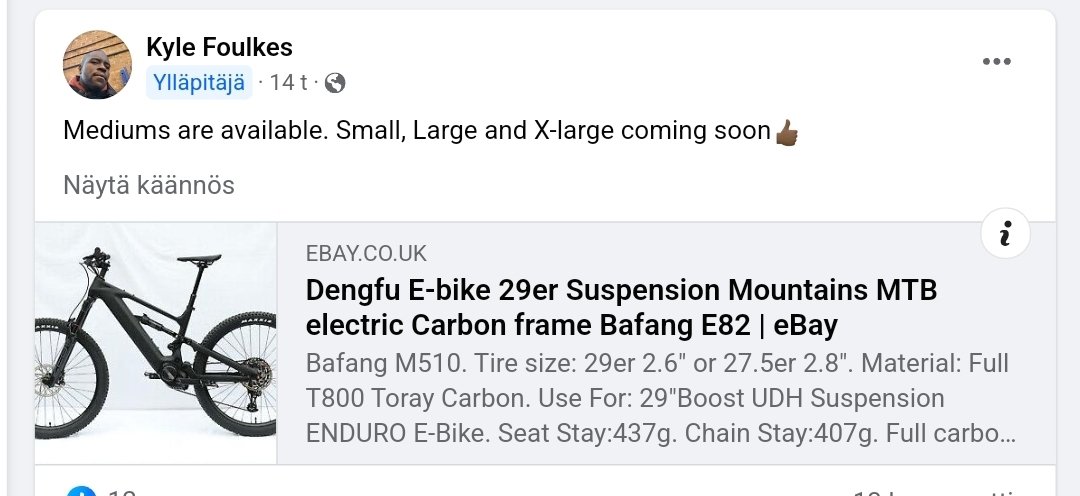

Looks like its on EBay under the Carboncycles site.
Yep, just like I said in my first post when I started this! 😁 Sadly they still don't have plans yet to make it in any other size that M 17".. :/

That does not make sense not to do L. I think L is most selling size.
Well. Clearly not since they and as well many others start with M 17" size frame. That must the most sold size. L 19" should be the next most sold for sure tho.
It's odd that they have it listed with S/M/L/XL available tho.
Maybe they haven't had enough people message them about size L 19" yet. If you haven't make sure you do and let them know you are interested! 😁

Note the size of batteries ?

Yeah battery size from 600-1000wh.

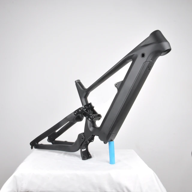

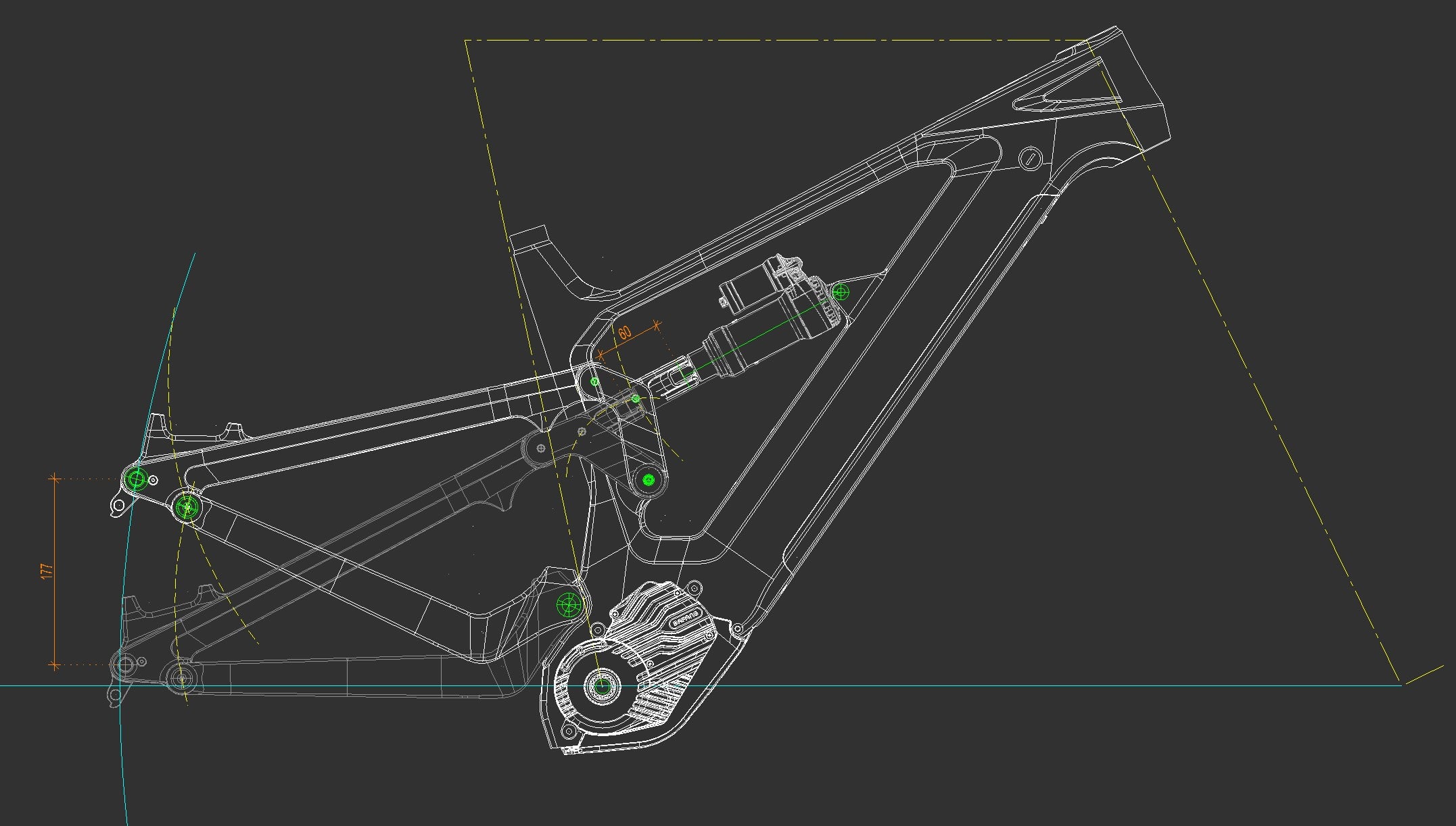

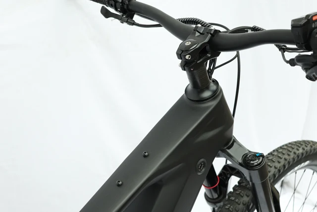

Good news! They are looking into making holes for the cables so you don't have to use the headset for the cables!
I got this image as an example.

Thats right, you will be missing that aluminium part for hoses.
It is pain with hoses running through headset. And in services they dont like it much. ;)

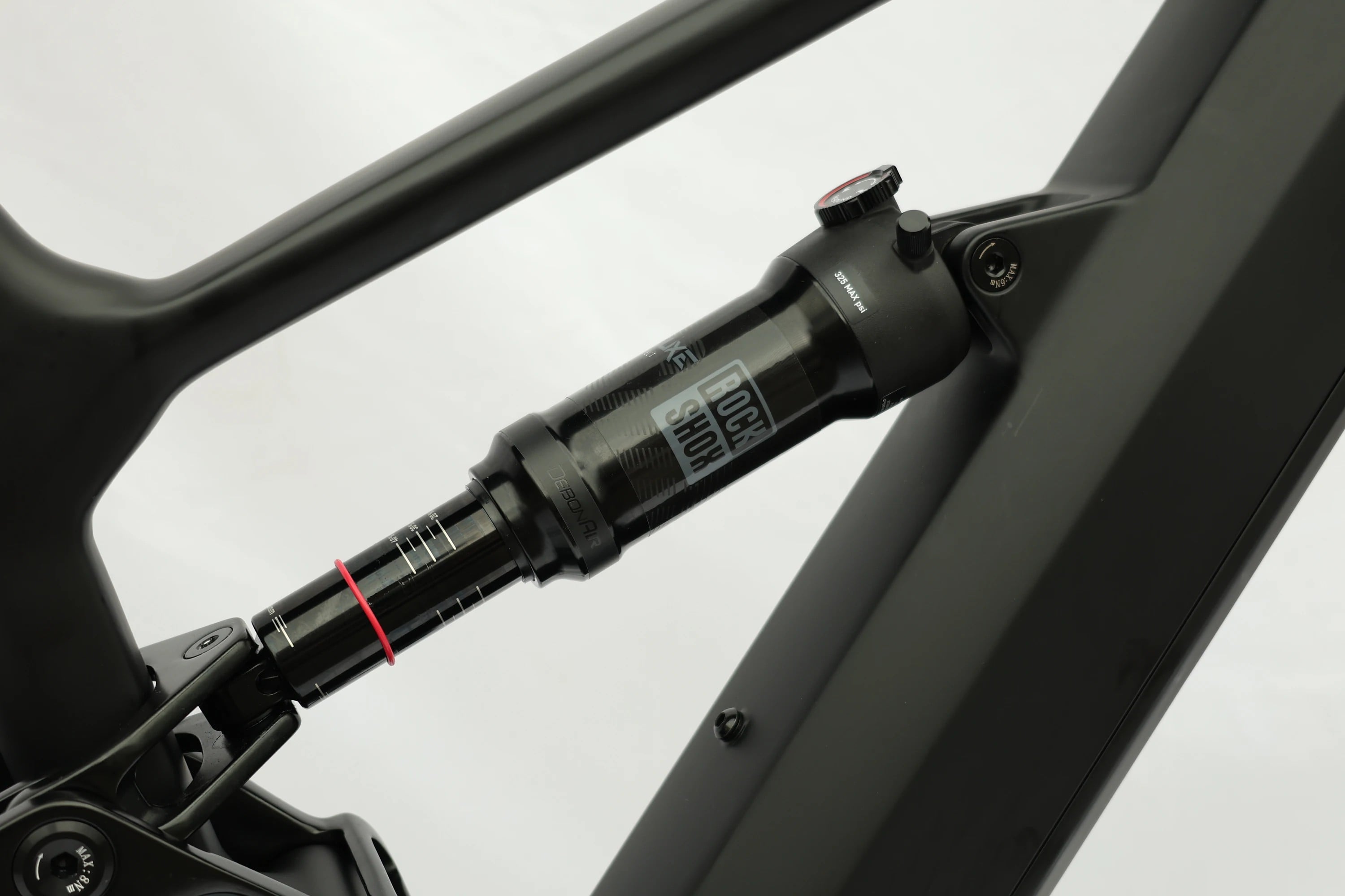

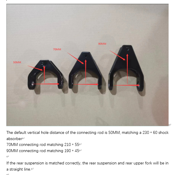

This is a very convenient solution. You can modify the 90mm rocker arm and install a shock absorber of any length. I just have a spring-loaded cane creek 216x63

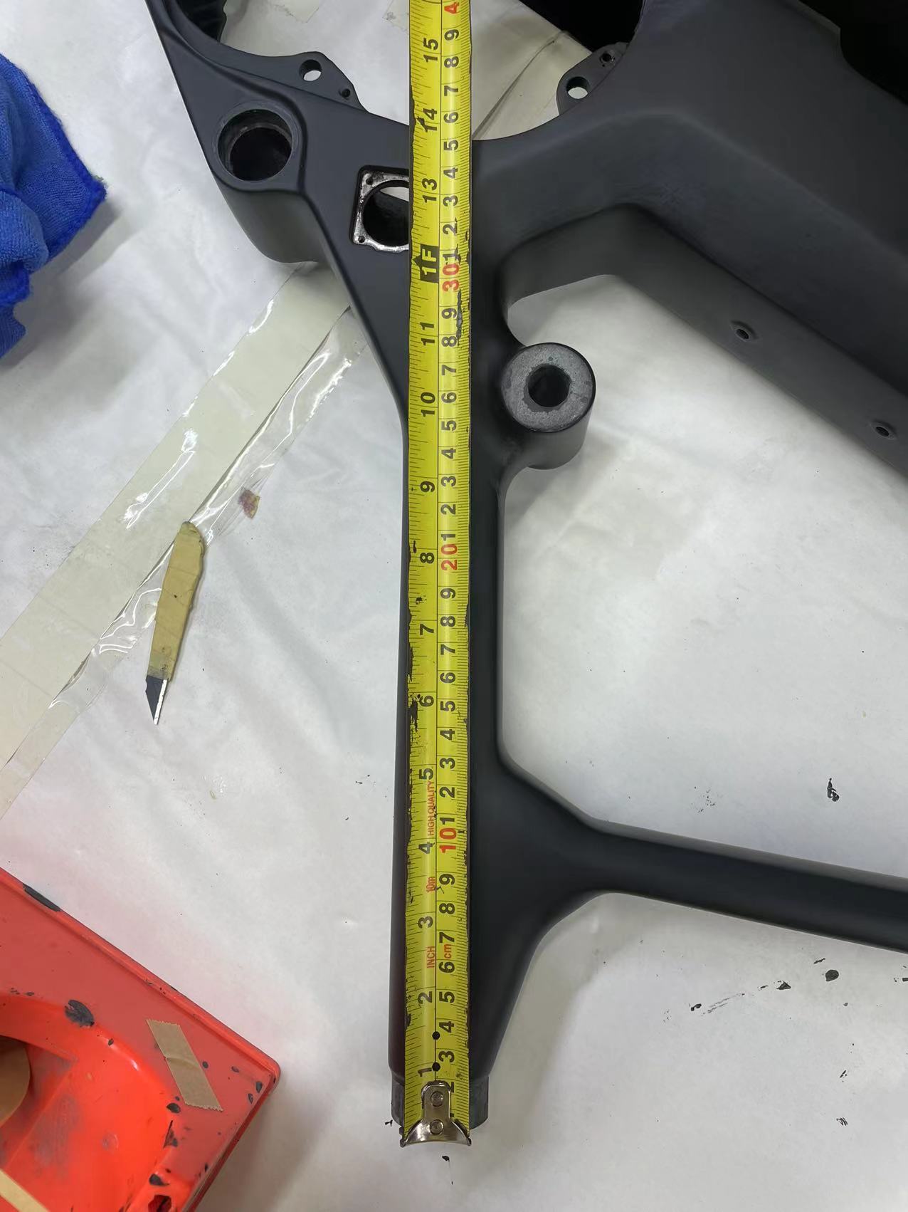

31,6mm. See my photo from previous post, I think it's about 230mm. I'll use OneUp V2.1 150mm
Thanks!
I also got this from Ben 😁
"The seat tube is 31.6mm, and the maximum length supported by the M size E82 is 280mm for the lifting seat tube. This length is calculated from the position of the seat tube clamp, which means that replacing it with a regular seat tube of 350mm is not a problem."
