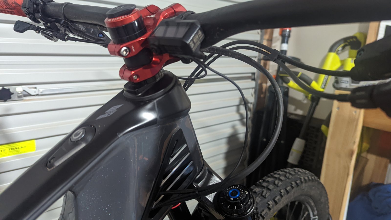

I ran my control unit cable out the right side of the bike and re-routed my rear brake through that side when I removed the standard slx's. Added an I9 Stem, One-up carbon bars and used epoxy resin to fill the stem hole. I think get the OEM Shimano cable holders for the switch wiring, doubled it back on itself and heatshrunk it and it sits under the bars.
My gx axs kit should be here soon too!

Thanks for that. Just what I was looking for.

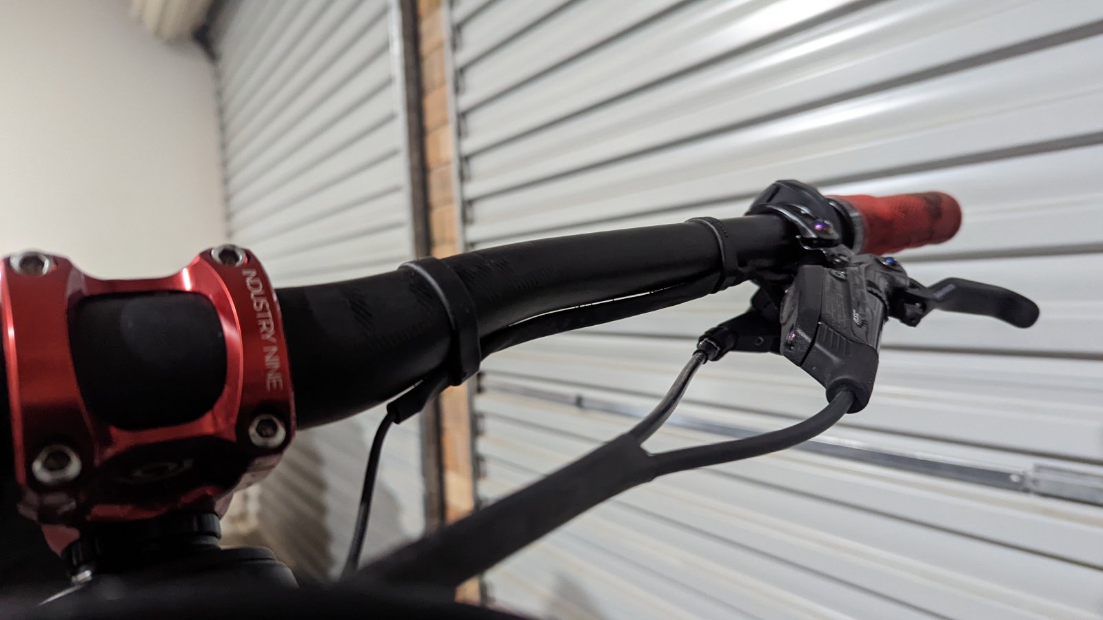

I recently changed to carbon handlebars without internal routing. Had to design a clip so the electric cable runs along the brake hose. Looks quite neat. Happy to share the STL if it helps.
