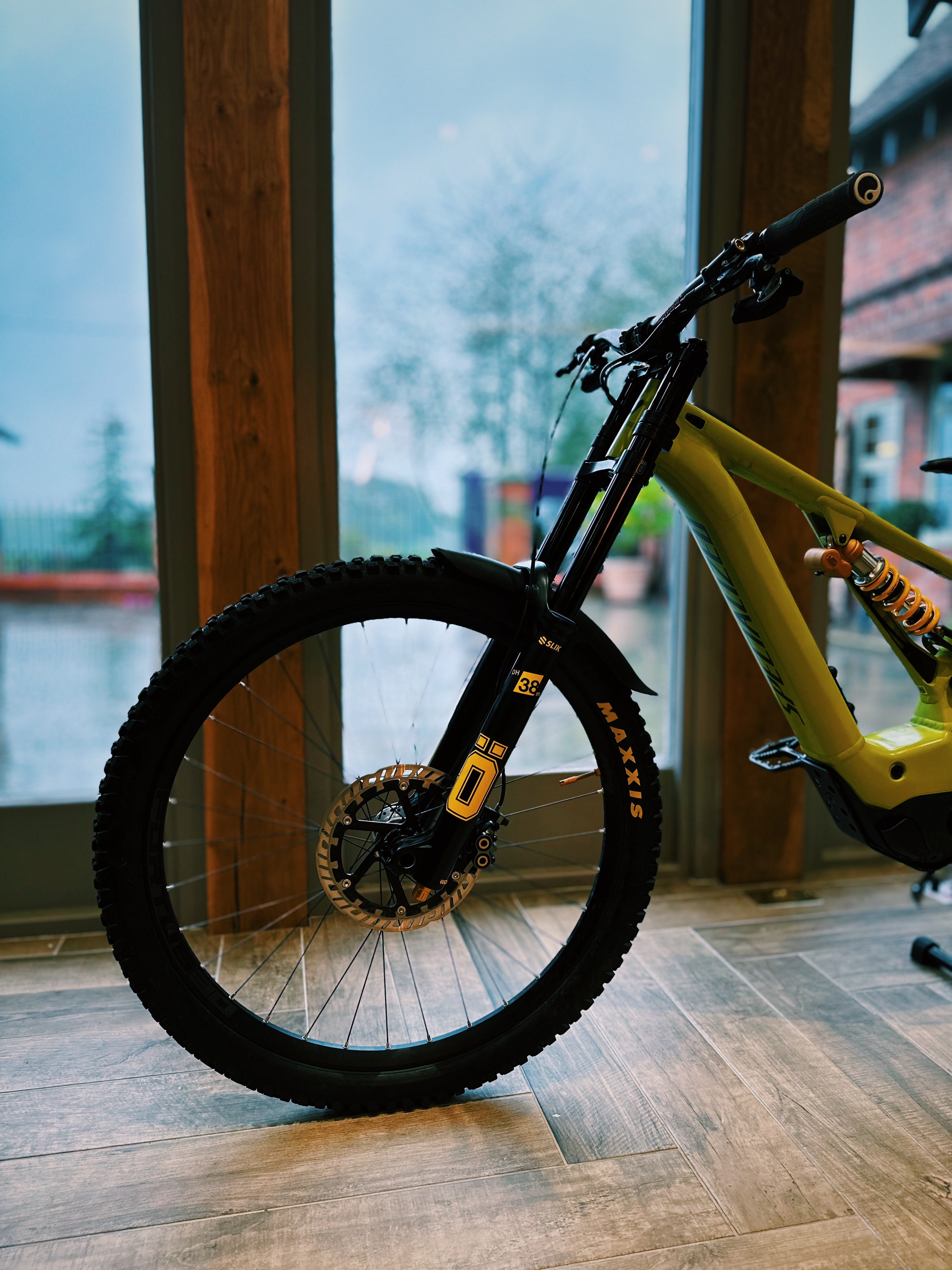

I haven’t posted much recently because I’ve been too busy shredding!
I have done some minor things though.

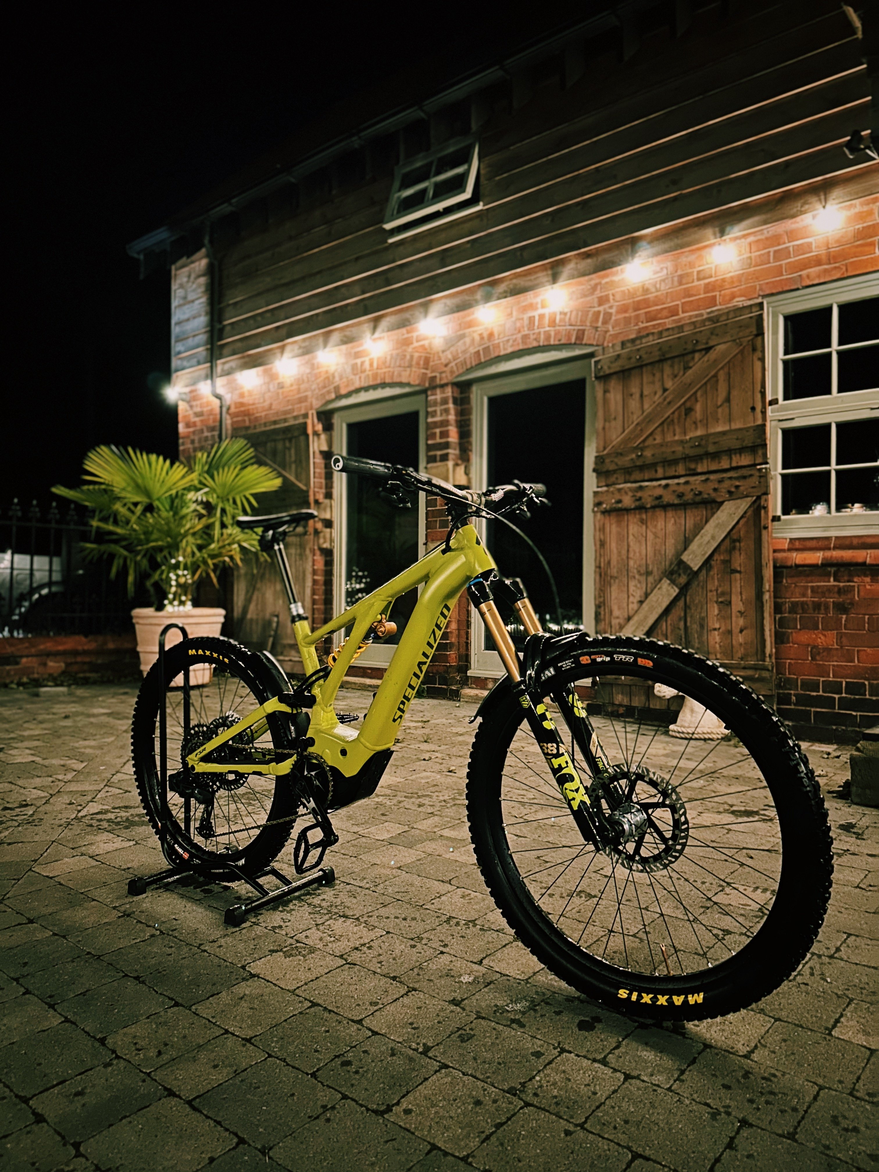

AirTag - installed so it provides a little safety net.
Sound deadening - there was a small amount of chatter from the cables in the downtube. So I wrapped them with Velcro straps and filled the space with foam. It’s silent now!
Ergon GE1 Factory grips - upgraded from standard GE1s. Super sticky grip and stealth to go with the bars.
Other than that the Kenevo has taken an absolute pounding most days and is running sweet!
Ribinrobin
Apr 16, 2021
266
264
Berkshire, UK
Update
View attachment 125288 View attachment 125289 View attachment 125290 View attachment 125291 View attachment 125292
House and bike look nice!

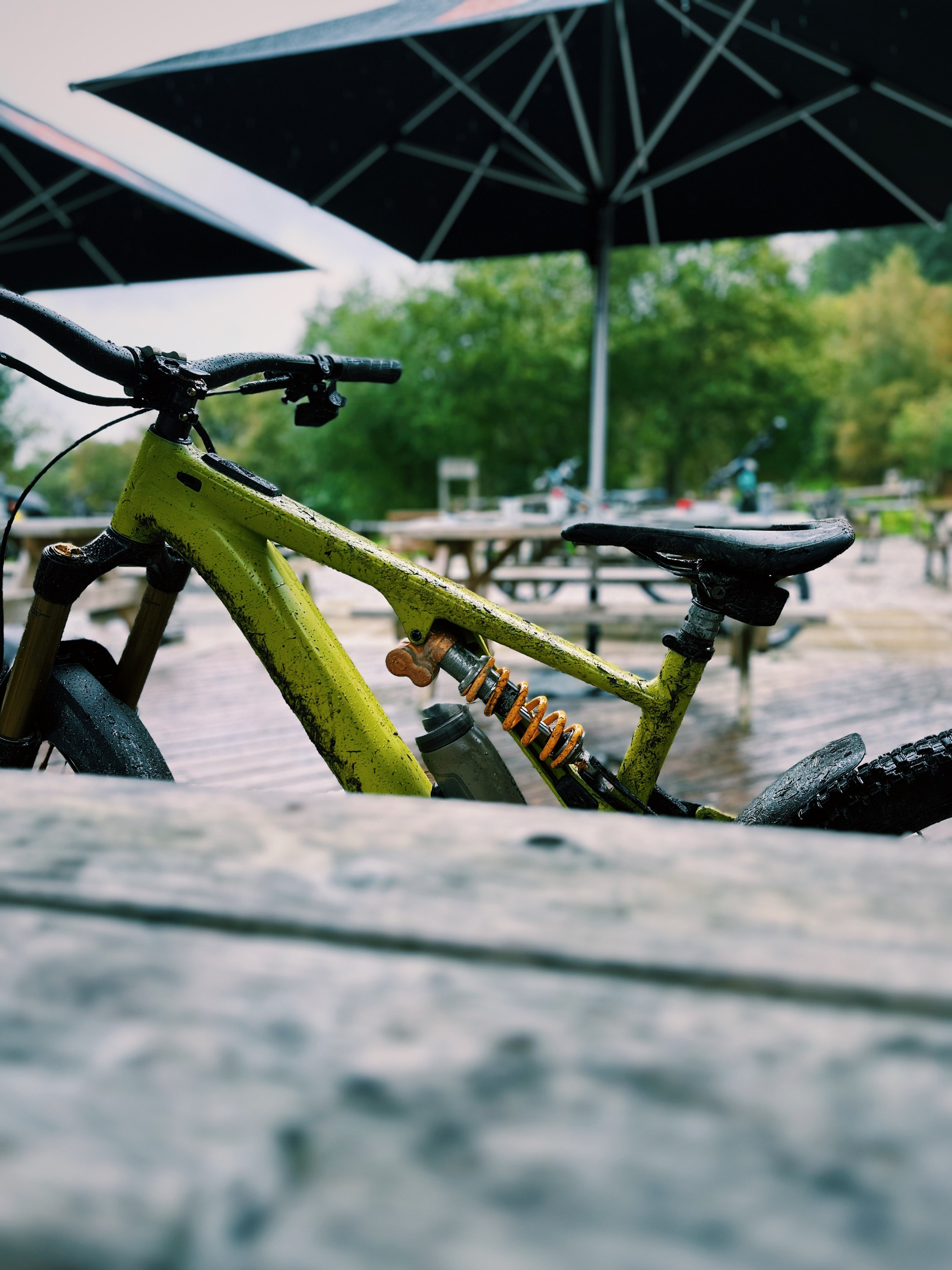

Autumn is here and it’s a lot wetter here in Wales. Doesn’t stop me getting out on this monster daily!

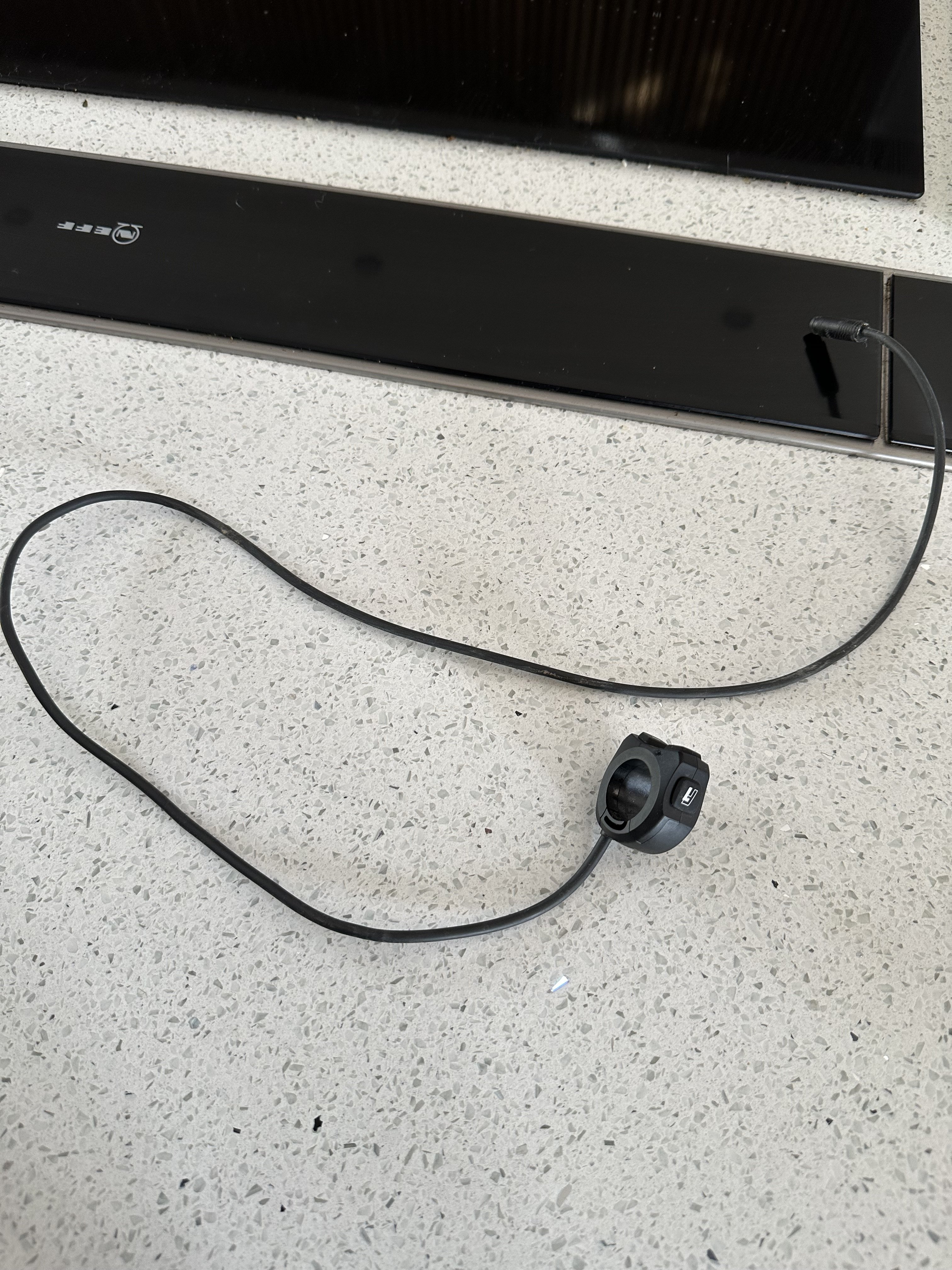

Update
Well the Kenevo is still running sweet and I’m really enjoying it. Enjoying it so much I’m entering an Enduro event in November (at night time).
There has been an issue though. The controller on the handlebar has become faulty. I cannot select modes anymore (+ / -). The top and bottom buttons still work though. I’ve reset / disconnected and reconnected with no joy. Let’s hope JeJames come true as they are my dealer. I will update.

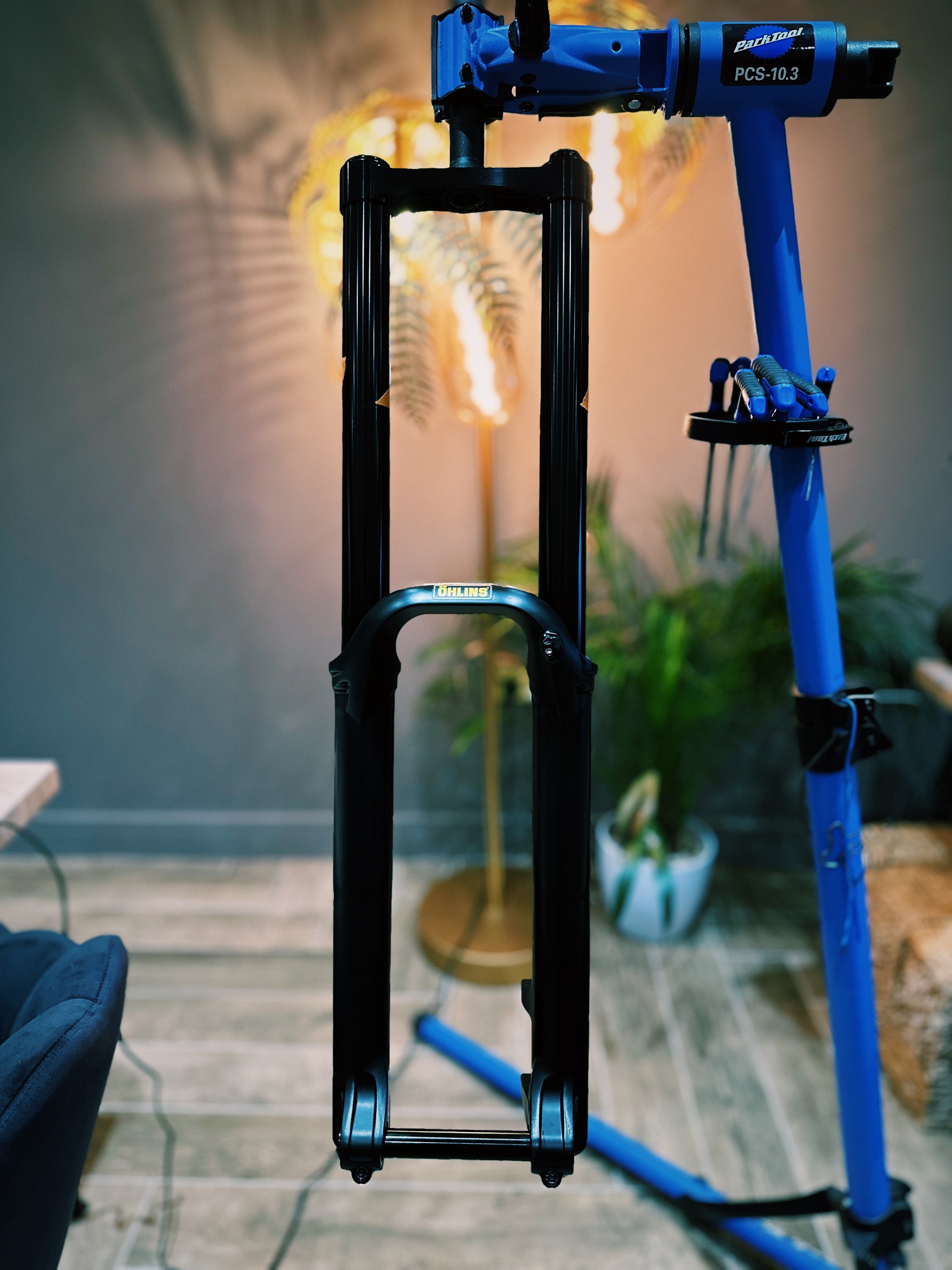

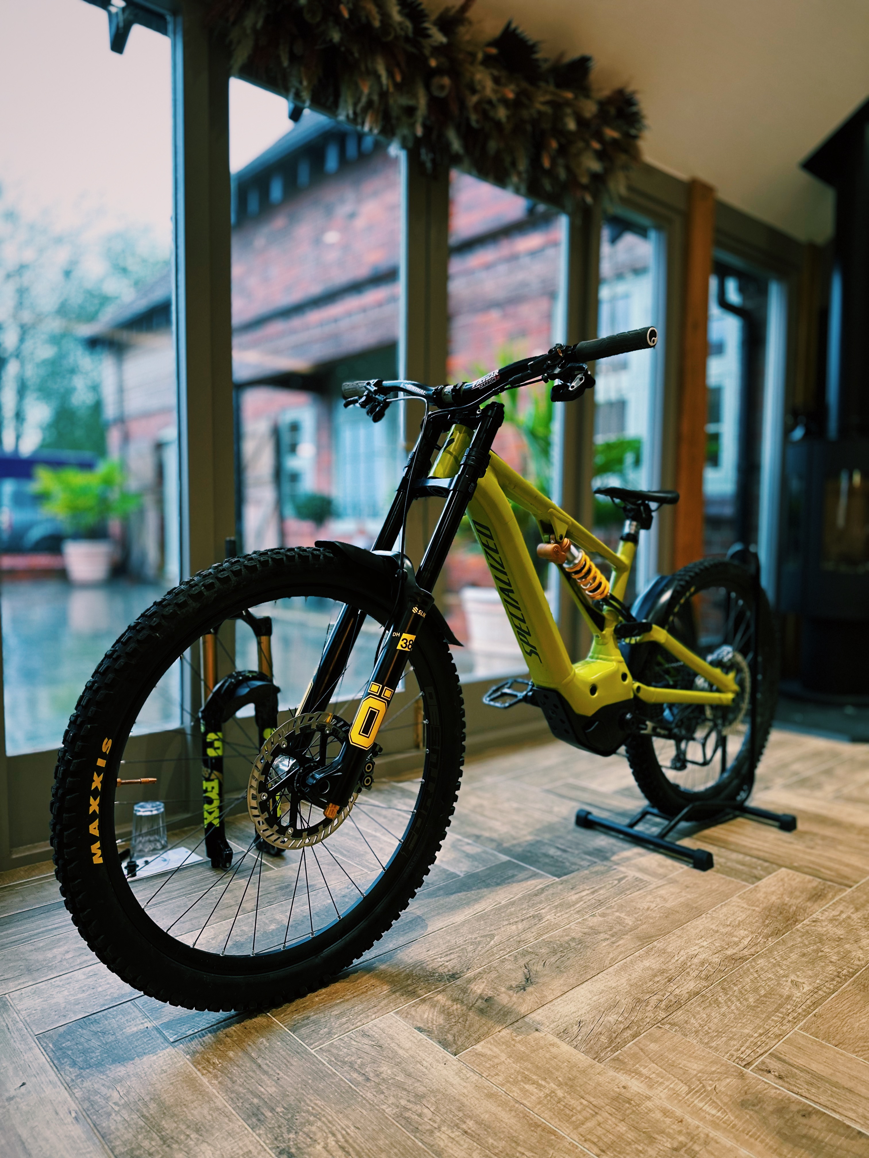

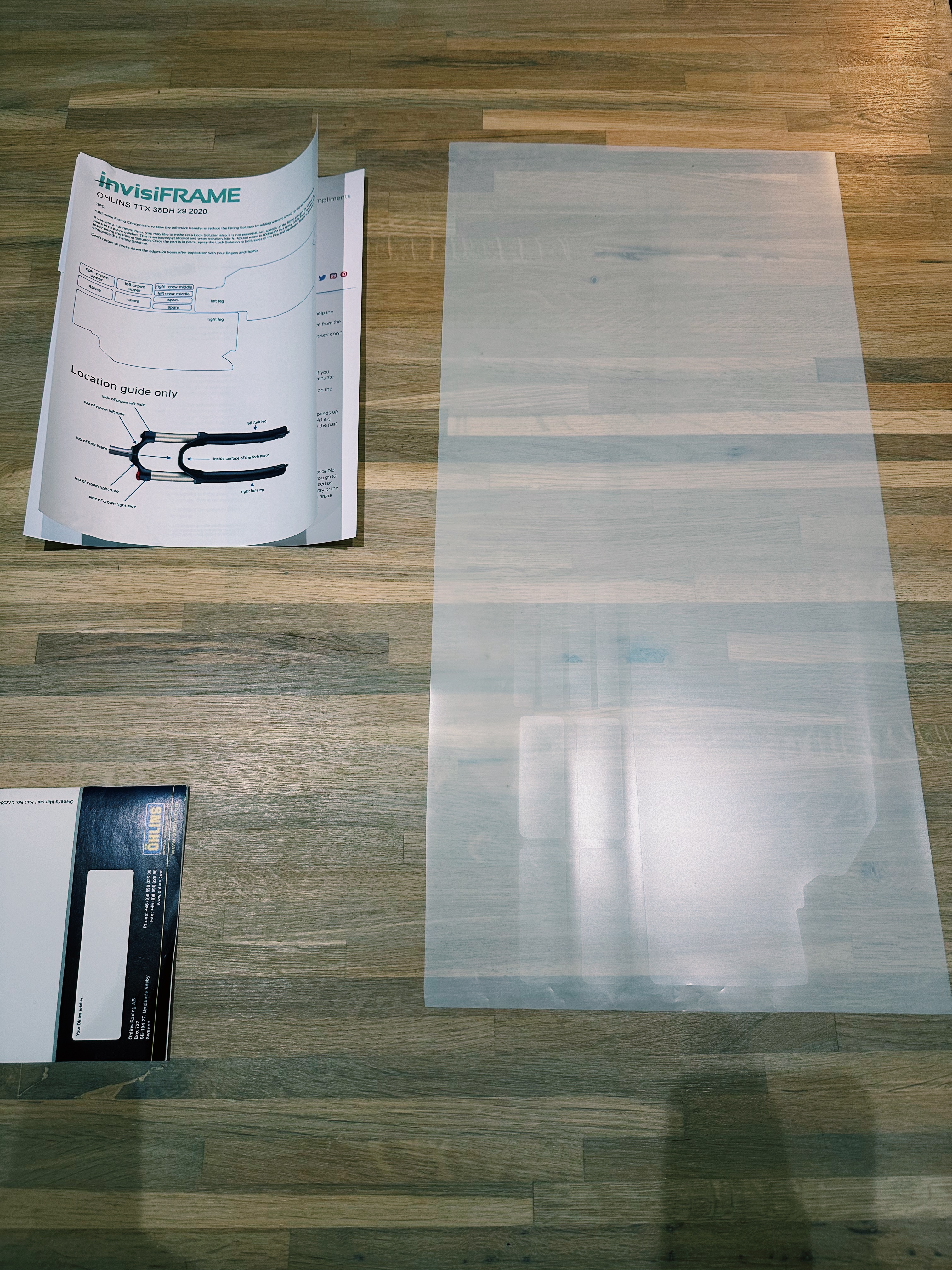

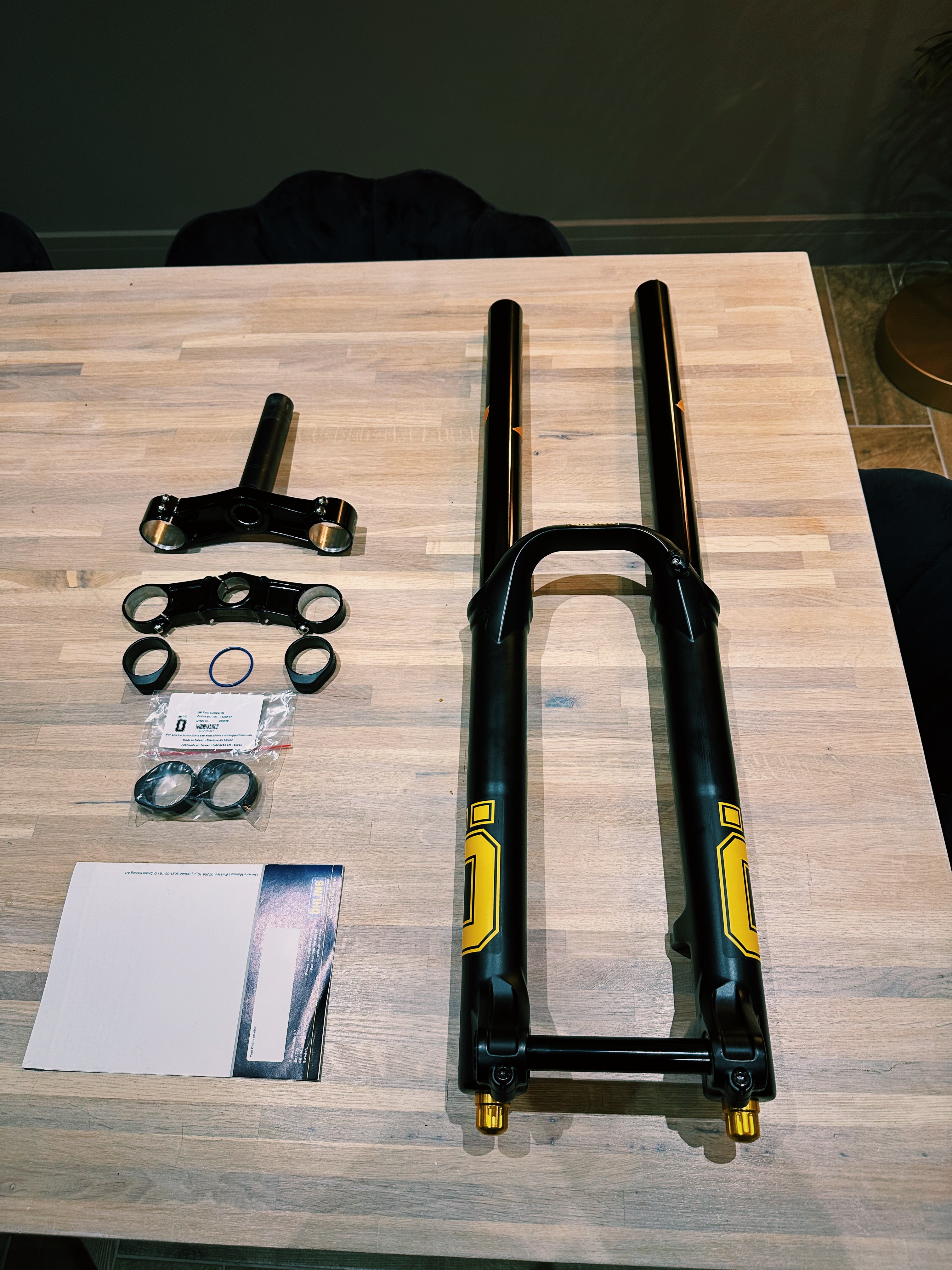

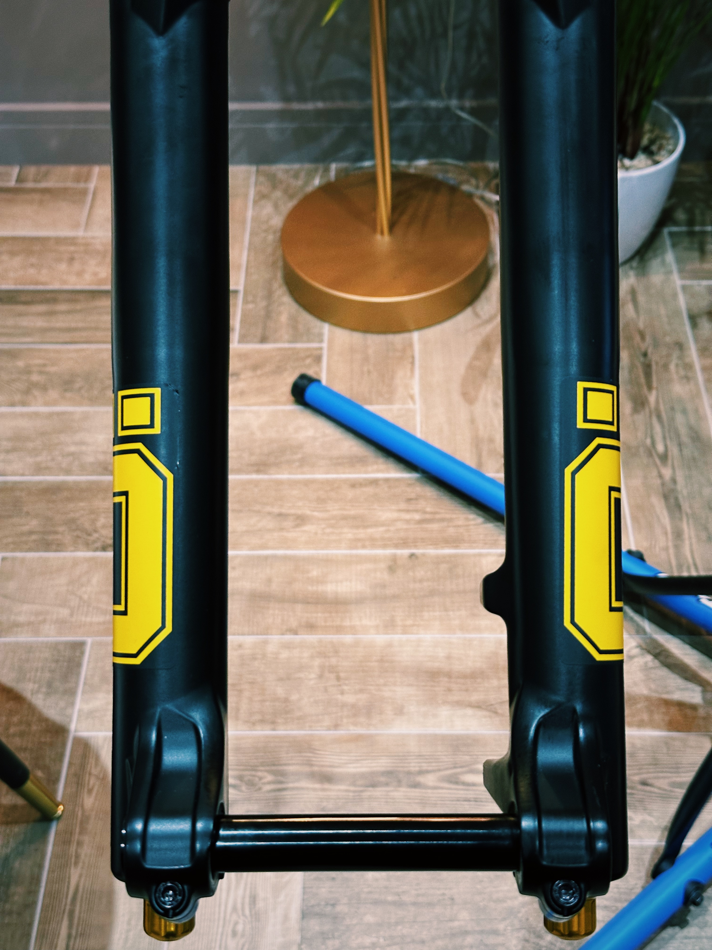

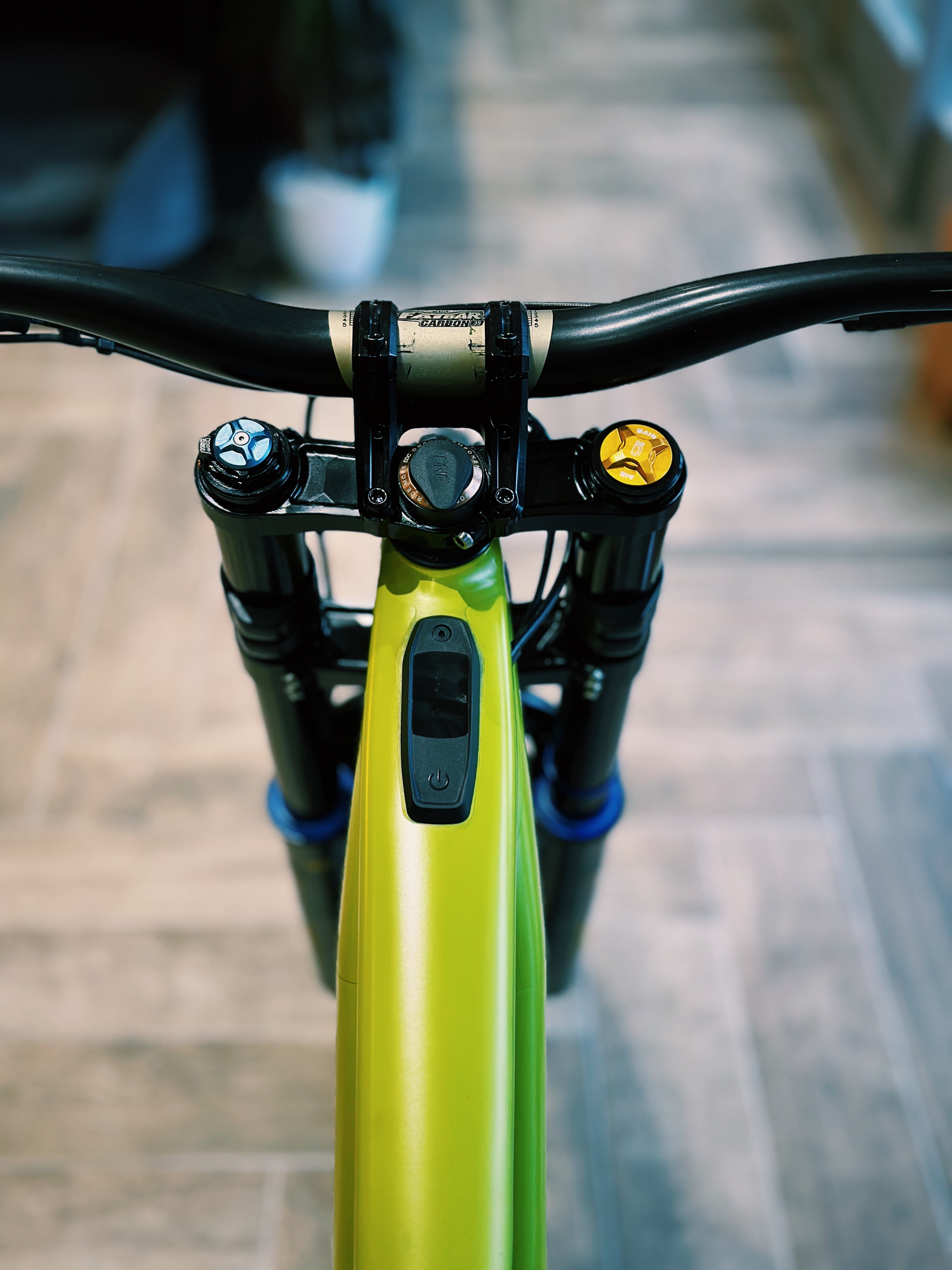

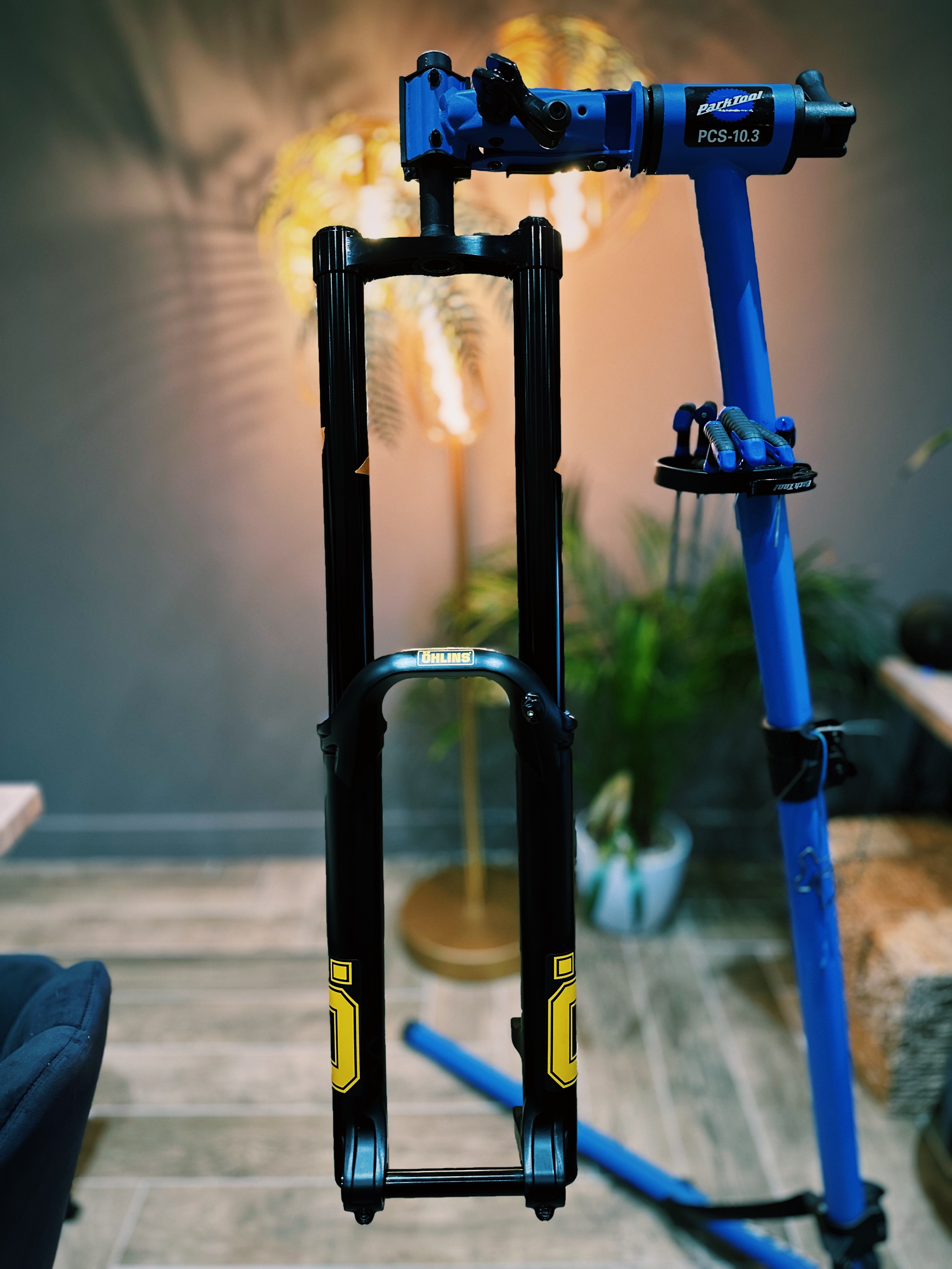

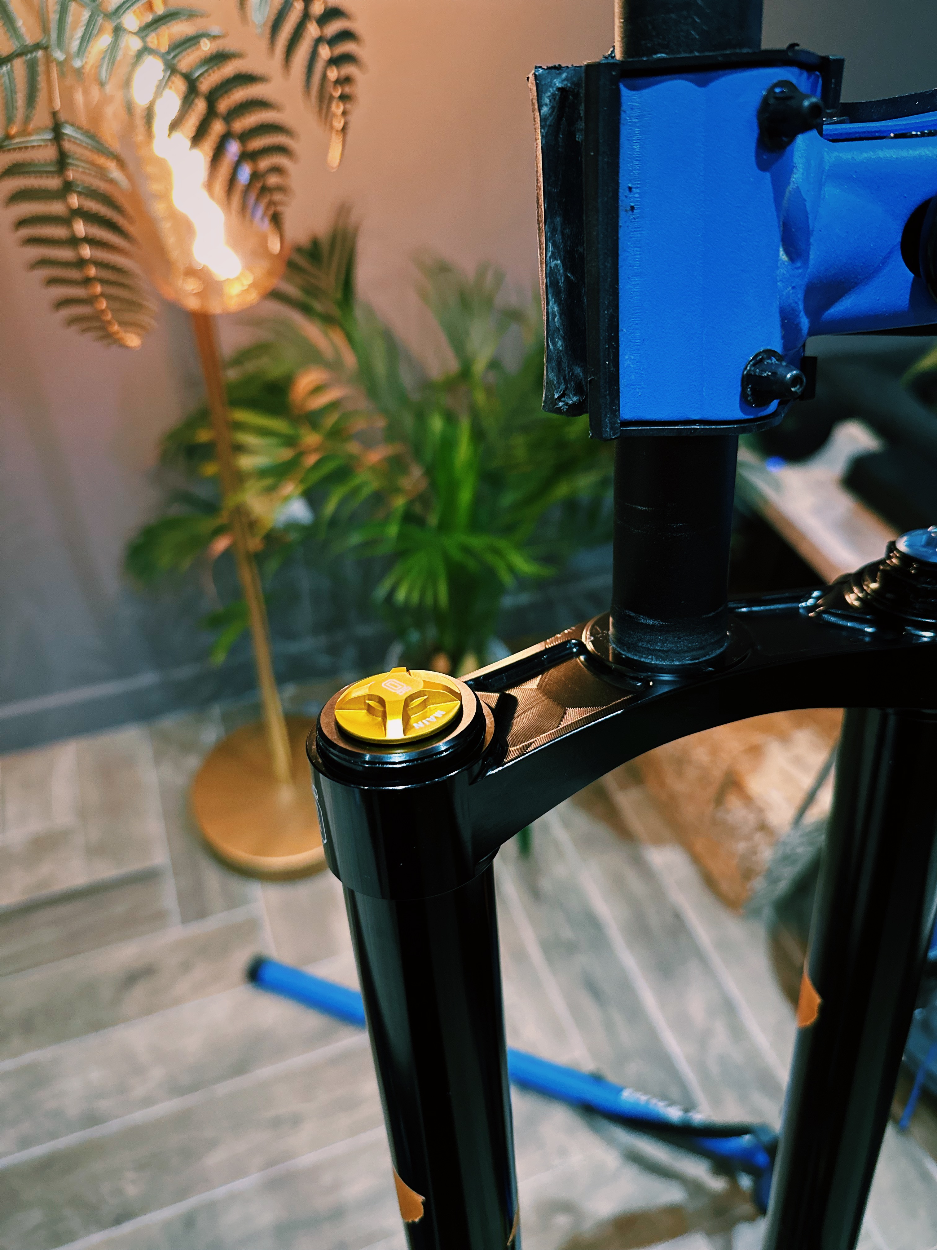

Update Öhlins DH38M.1 arrived
Little update. The new Öhlins gold has arrived. Unboxing was nice as ever revealing the quality you’d expect. I’m surprised at how light the setup is in hand.
Jobs ticked off tonight.

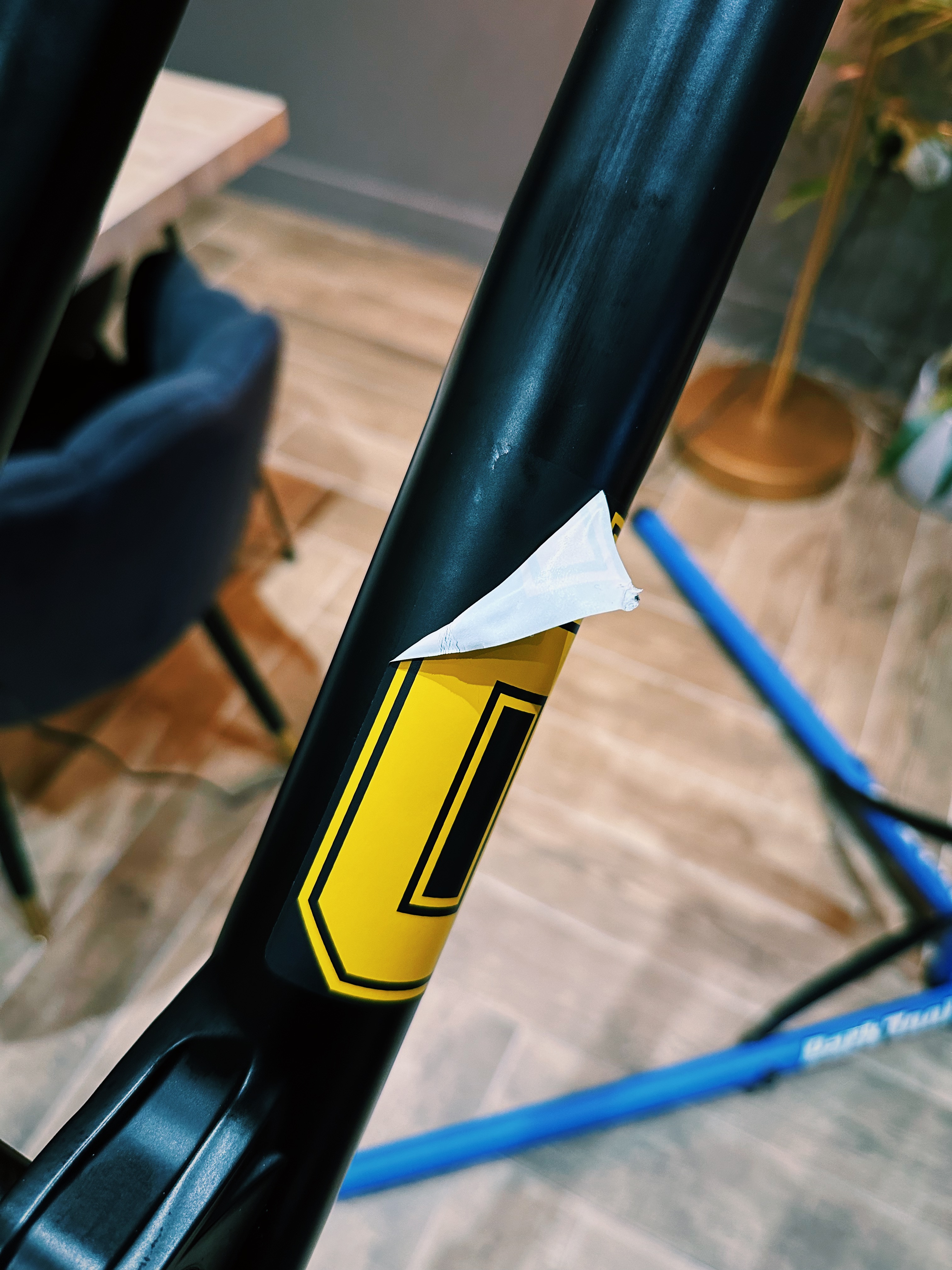

1. Steerer cut to 150mm
2. Decals removed (pains me to do this on a new fork!)
3. Prepped for Invisiframe
The eagle eyed will spy that I have 2 sets of rubber bumpers to protect the frame from damage.
Christurbo
Jul 11, 2023
380
714
North Wales

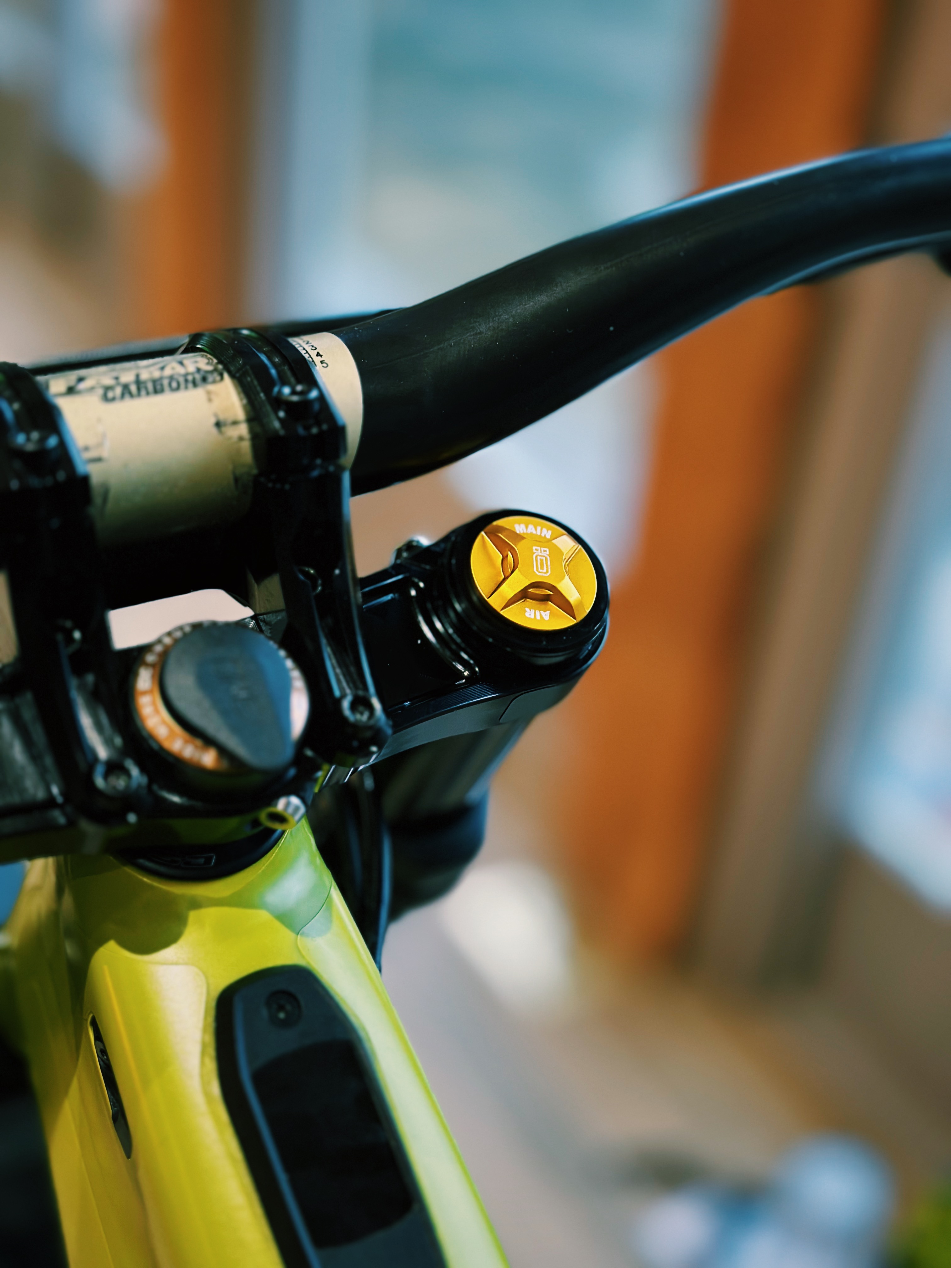

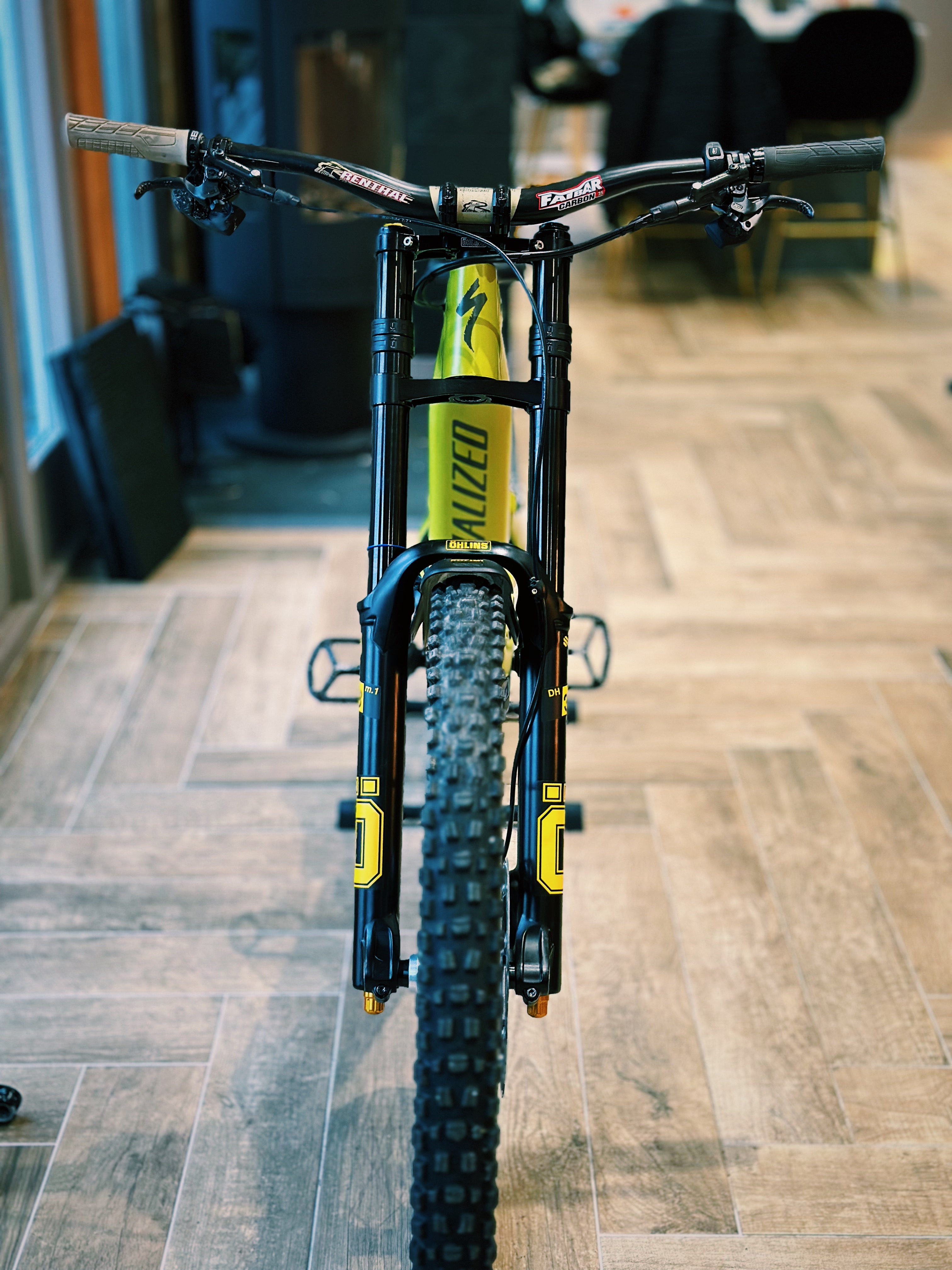

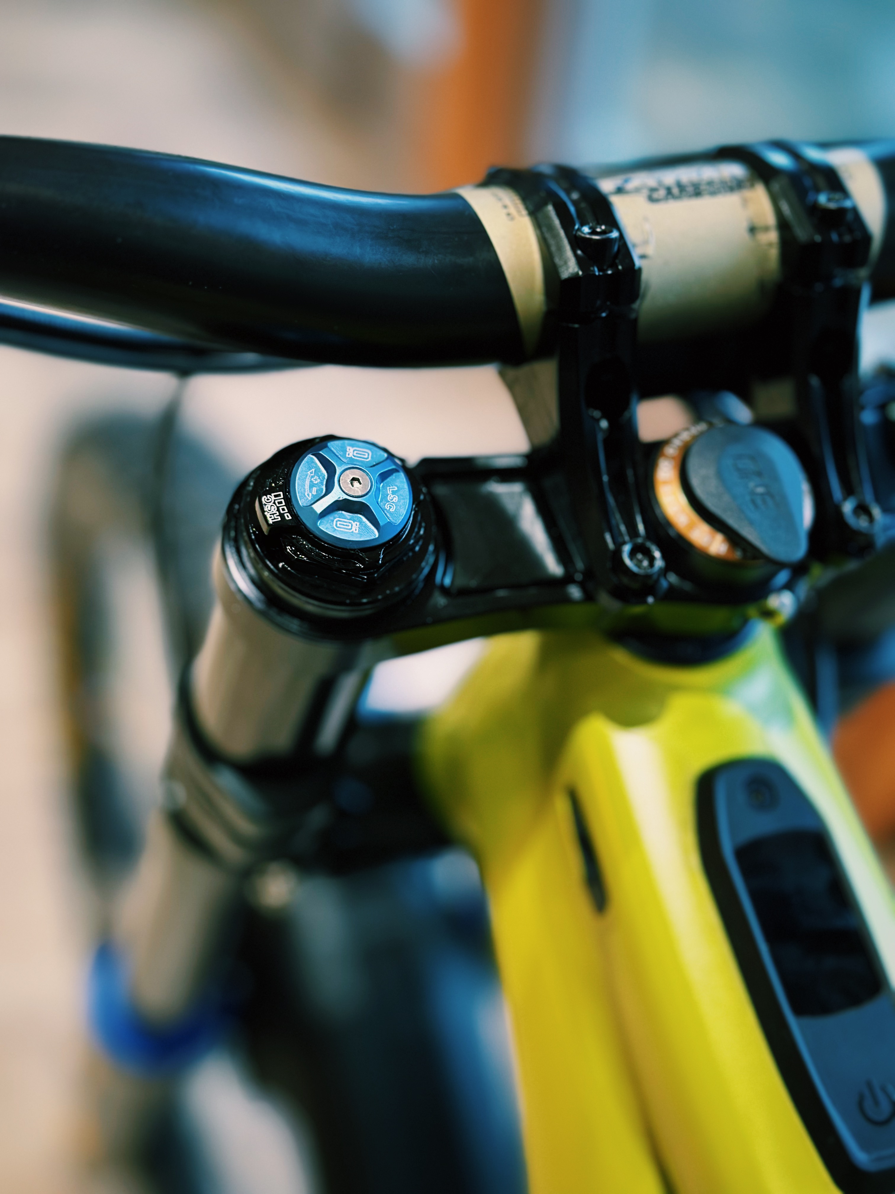

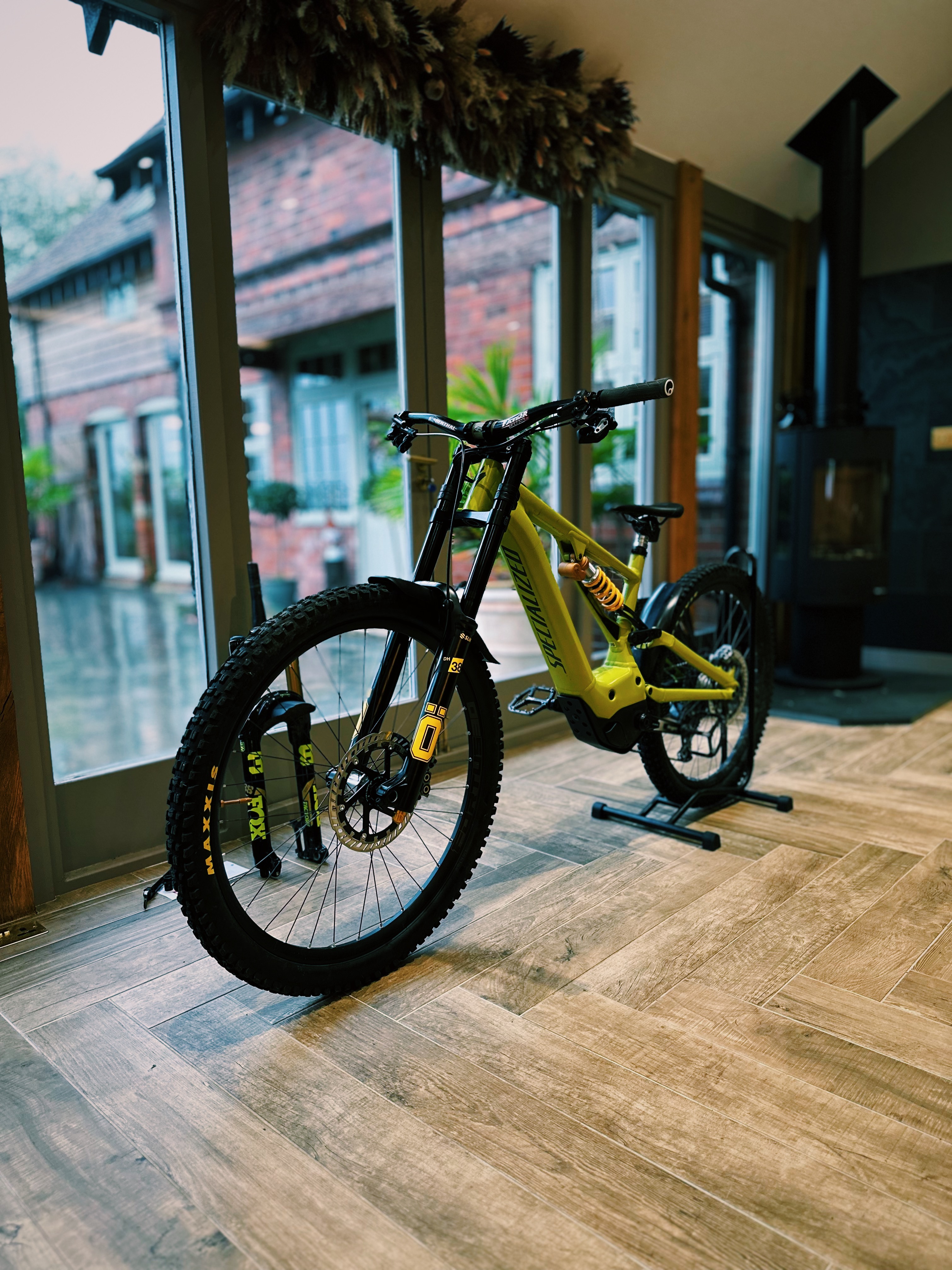

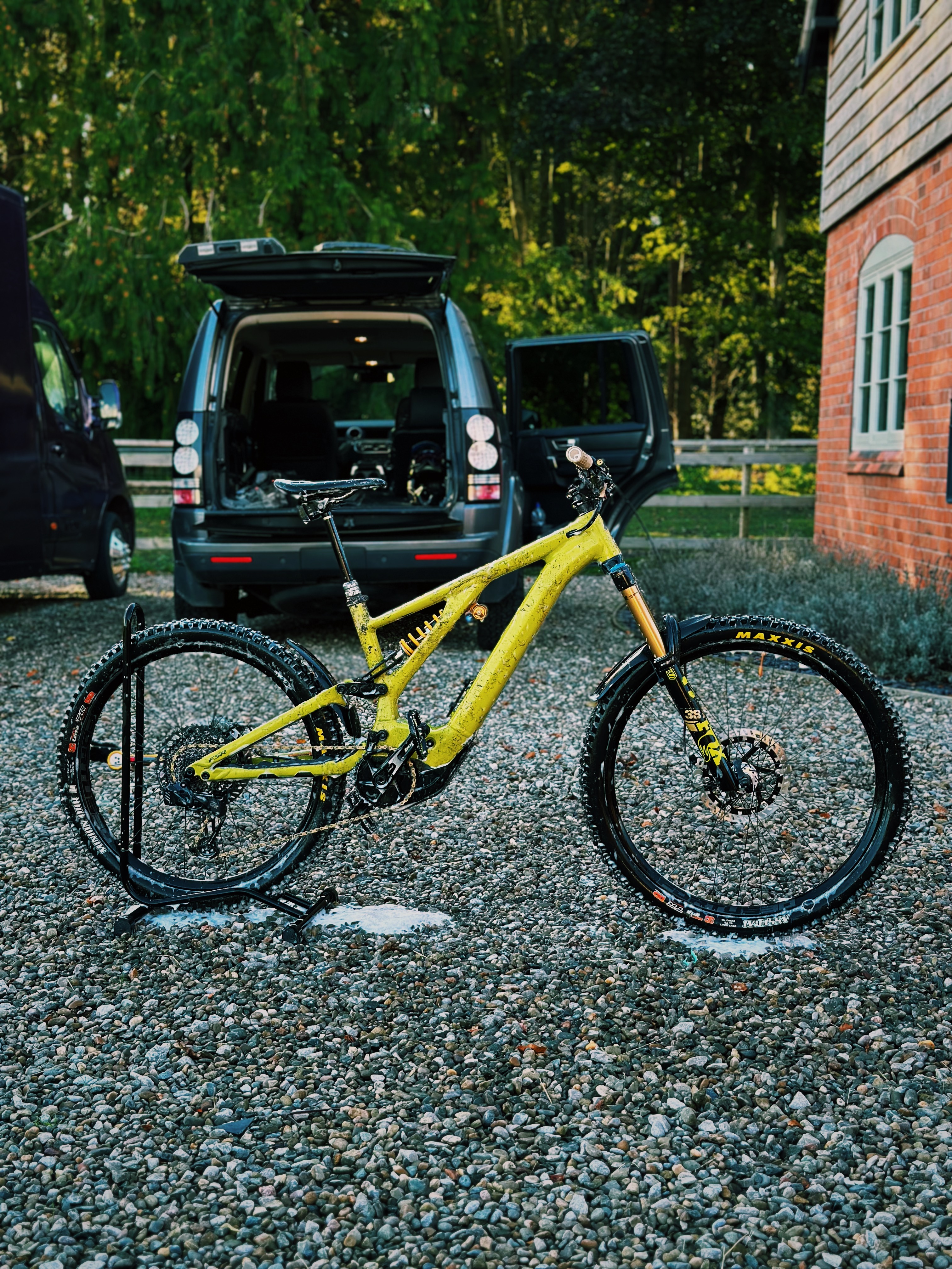

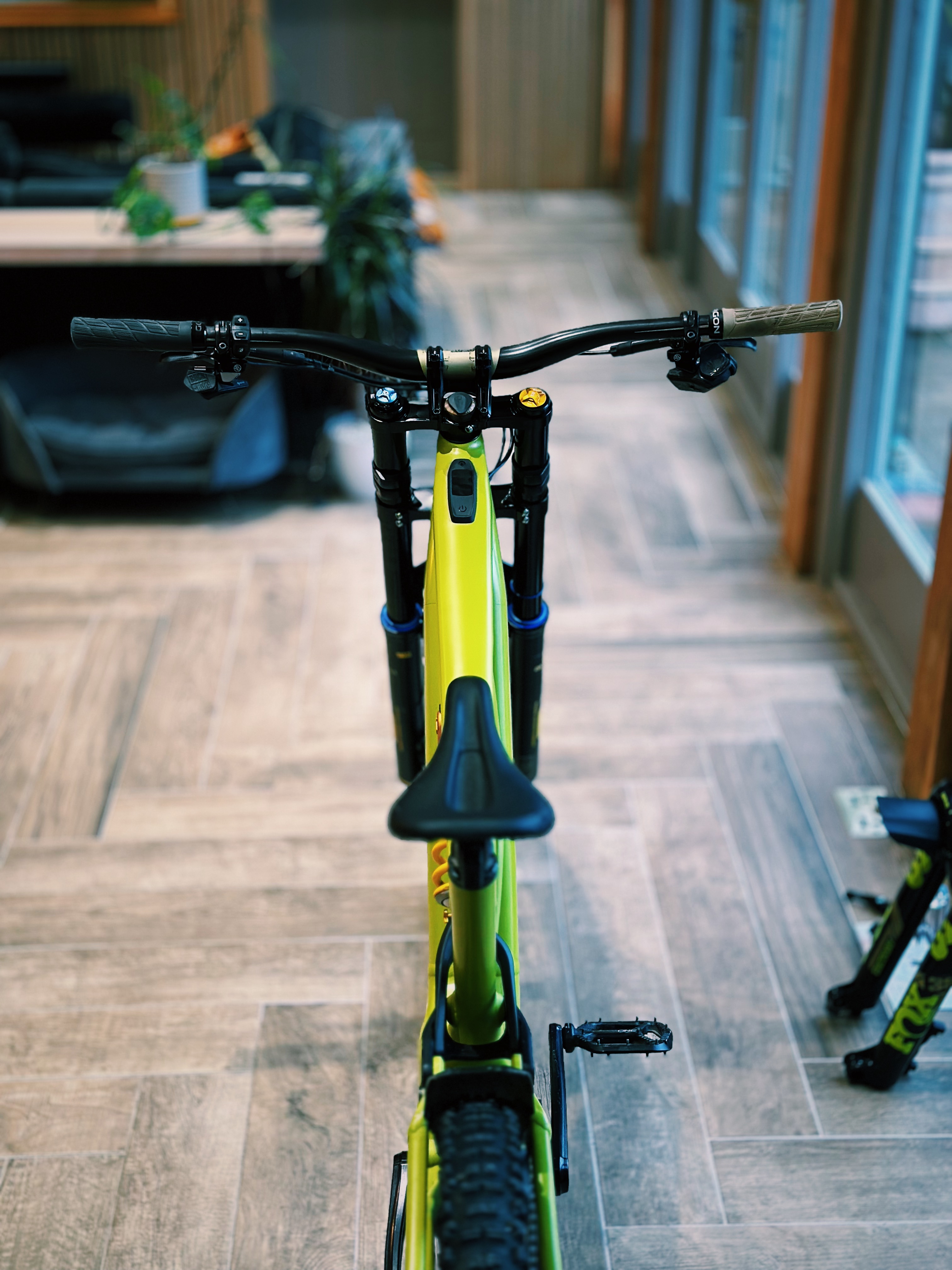

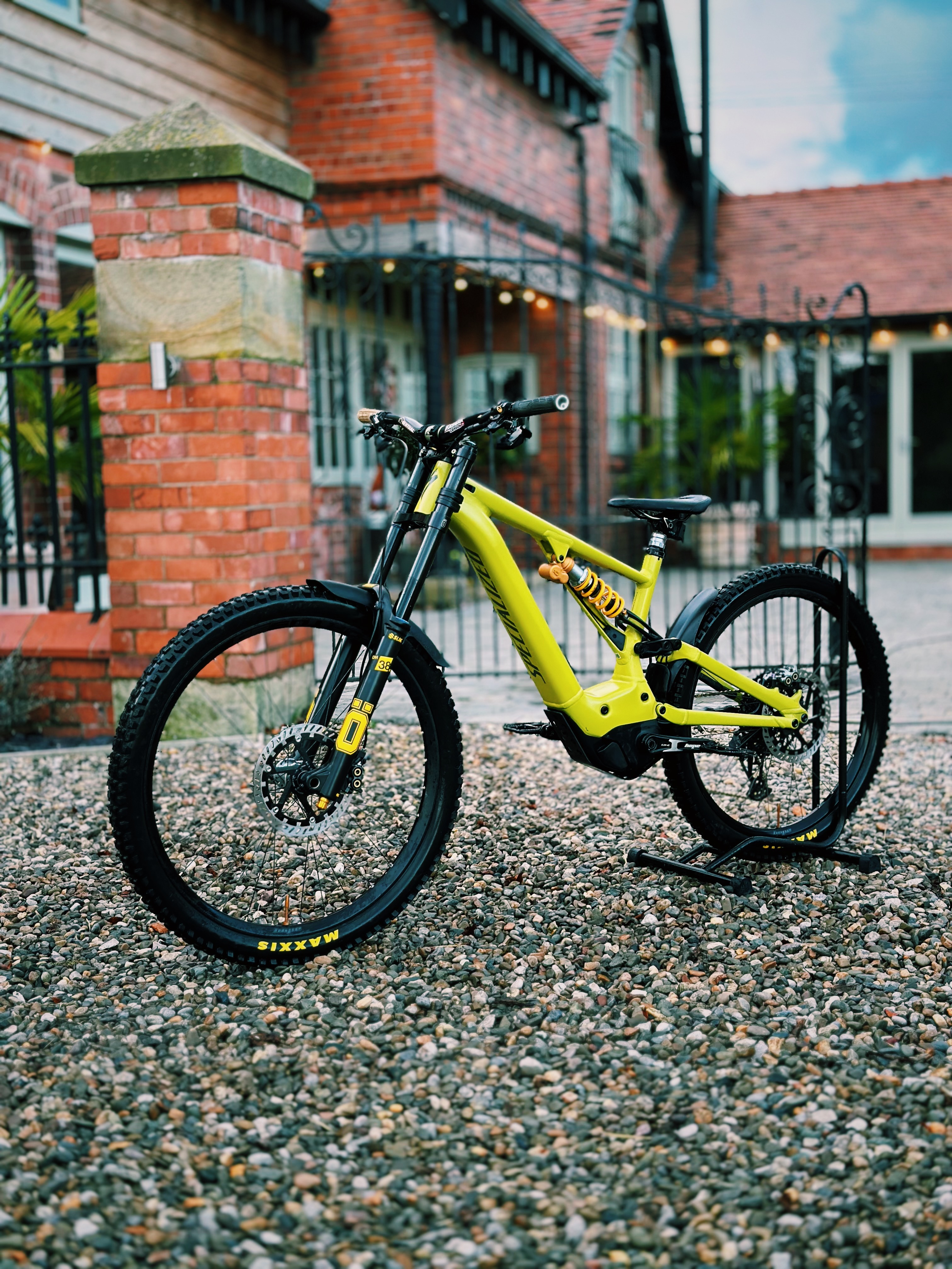

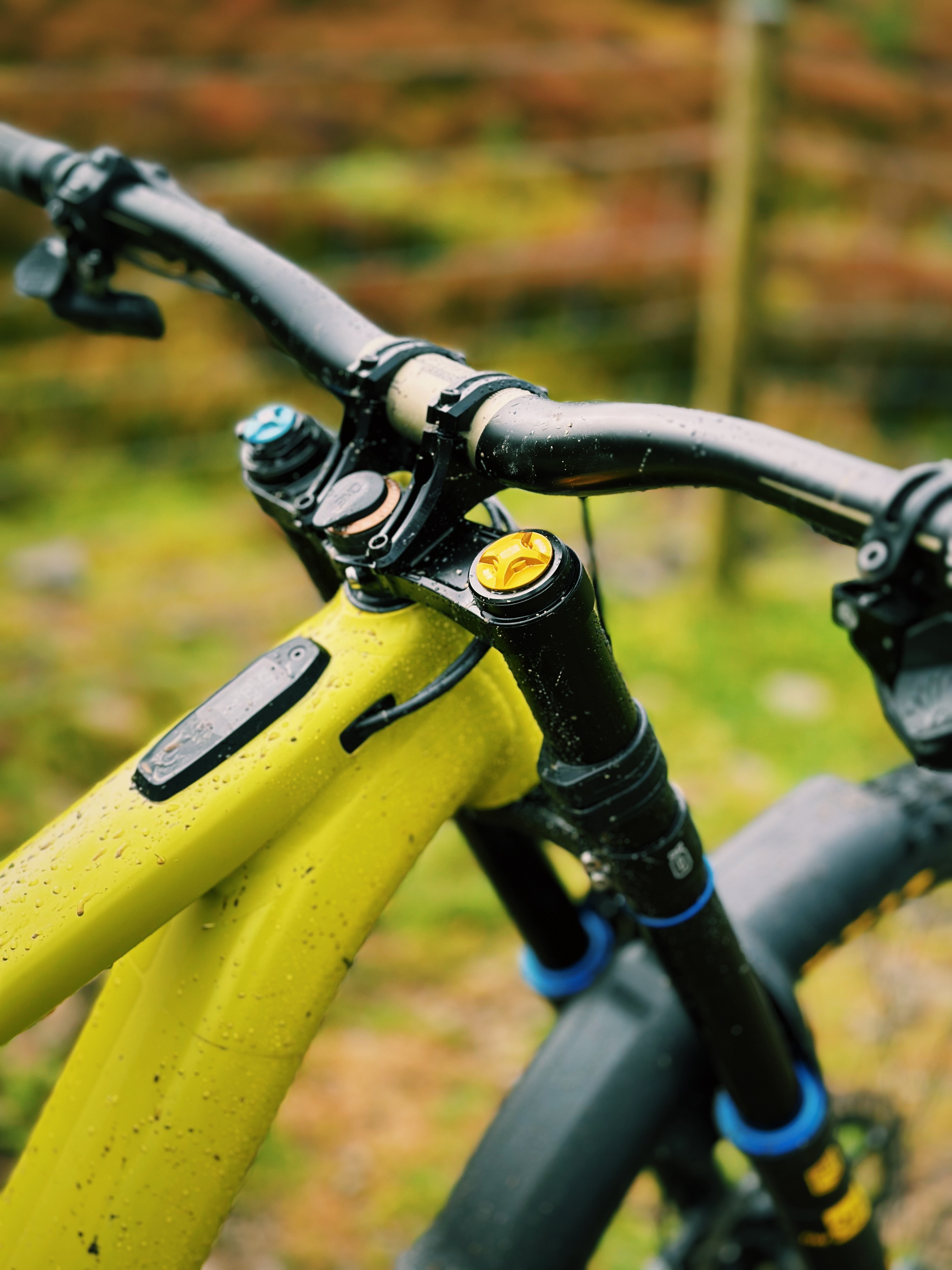

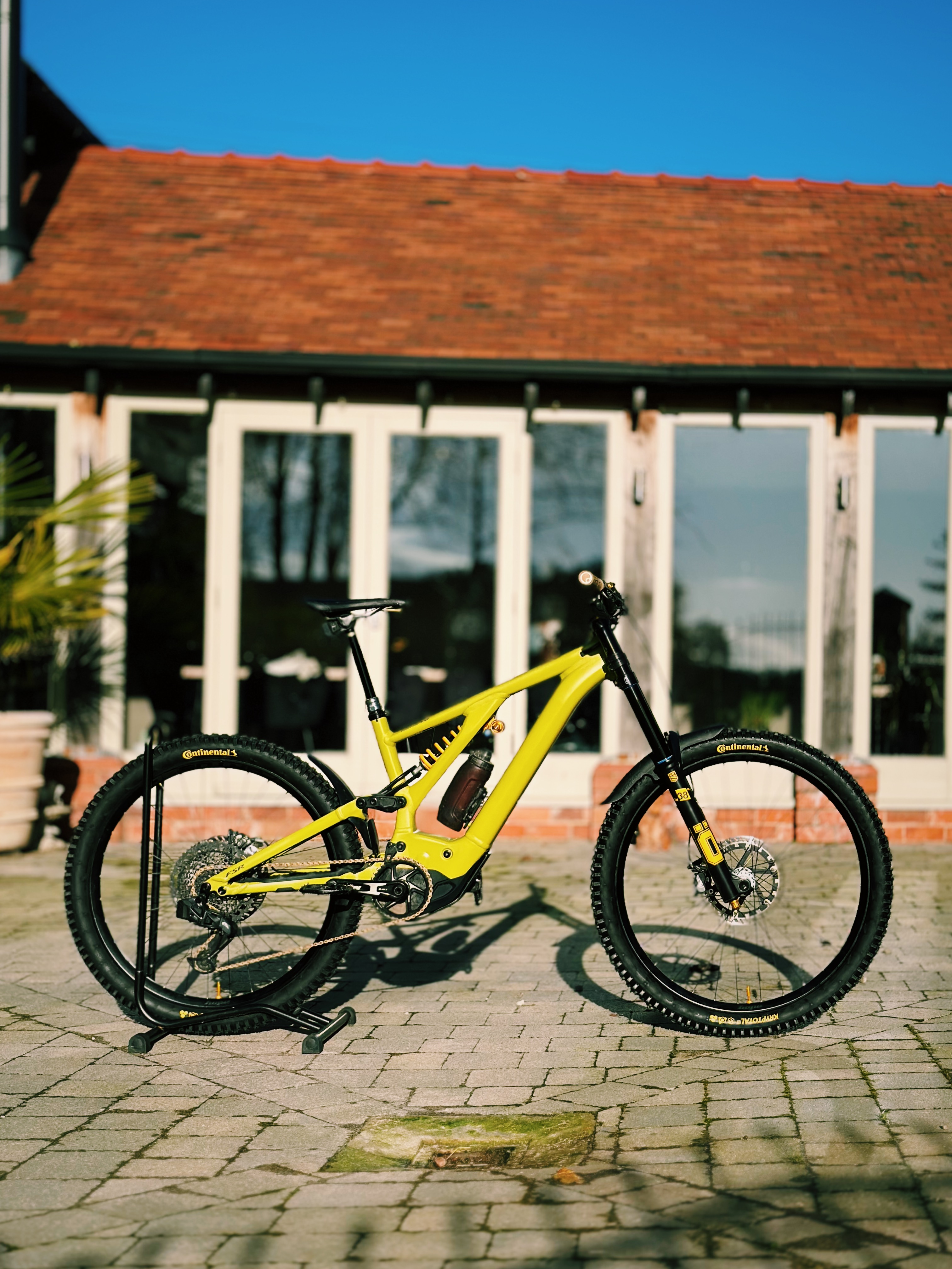

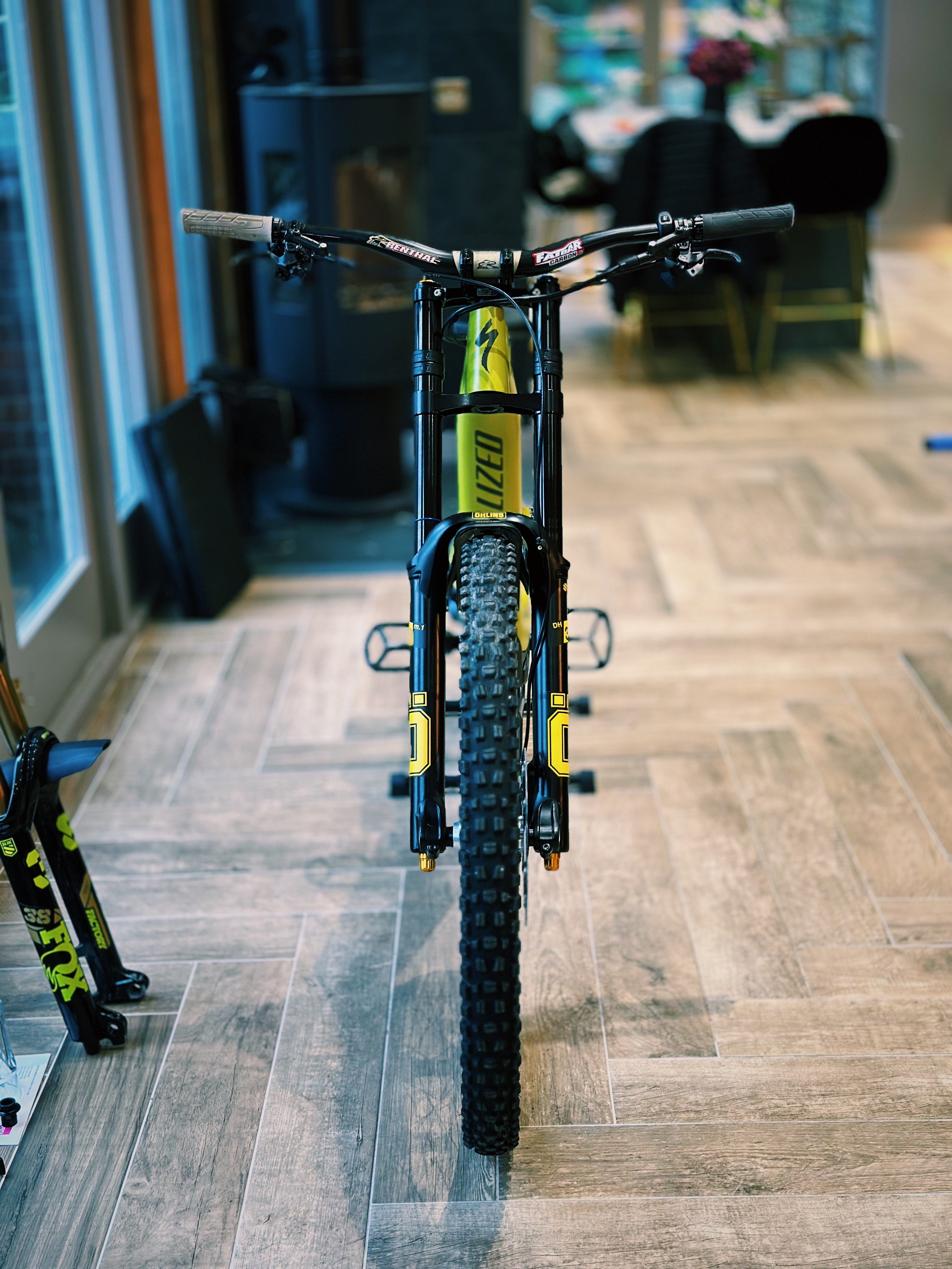

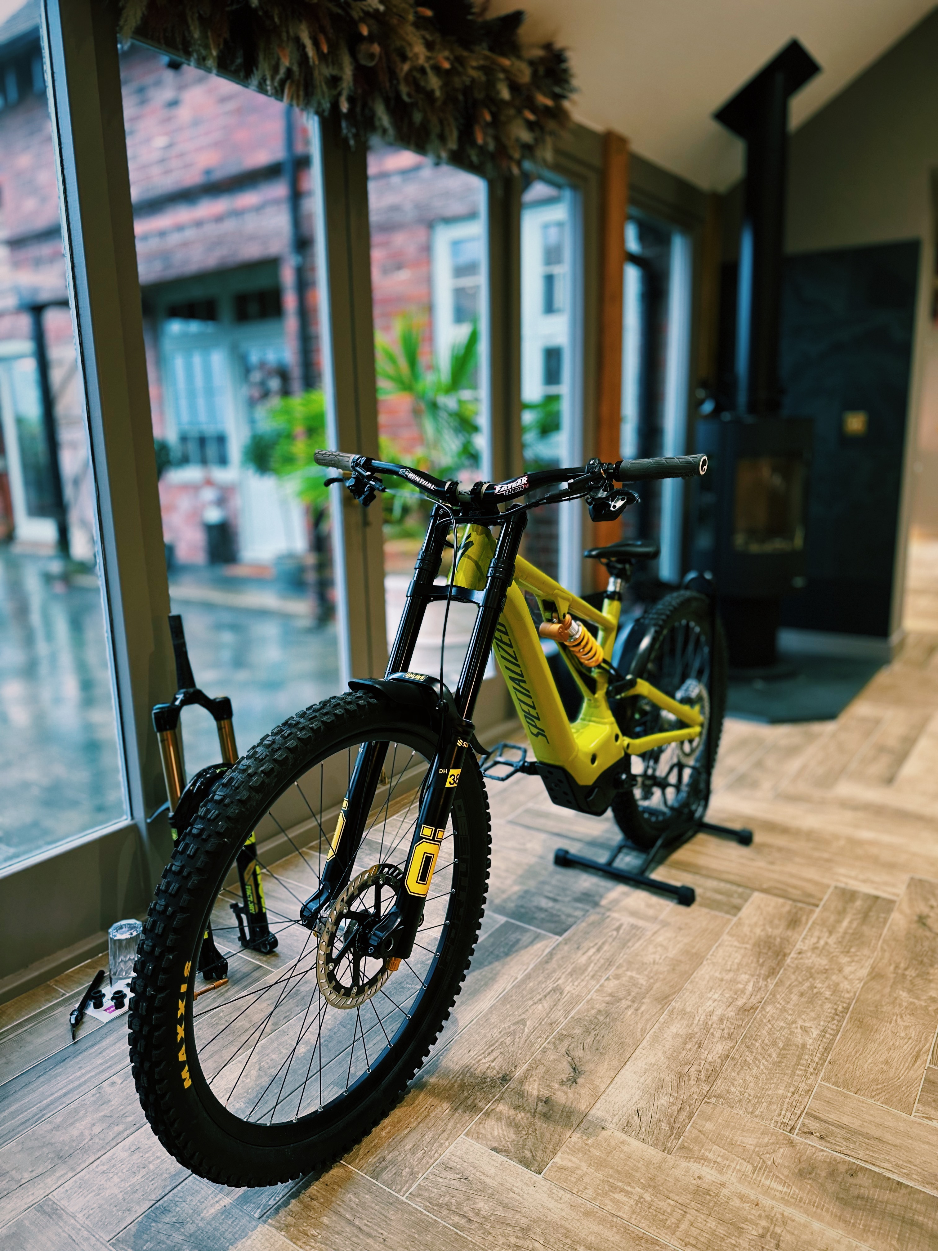

Update Finished Fork Install
All parts finally arrived to finish the DH38M.1 install.
Extremely pleased! It’s like a mini moto X bike.
Parts I needed to install:-
-DH38M.1 Forks
-50mm Offset Crown
-Hope HUB494 Pro 5 hub conversion to 20mm axle
-Deity stealth direct mount stem
-Crown race
-Invisiframe protection
-Slik Graphics Decals
-Extra Öhlins fork bumpers (so 2 each side)
-RRP ProGuard bolt on mud guard
Head angle (using my phone) is around 62.5 degrees. Axle to top tube (headset) is the same height as before. Albeit, the bars are 10mm higher. So might see how I go once it’s been shaken down.

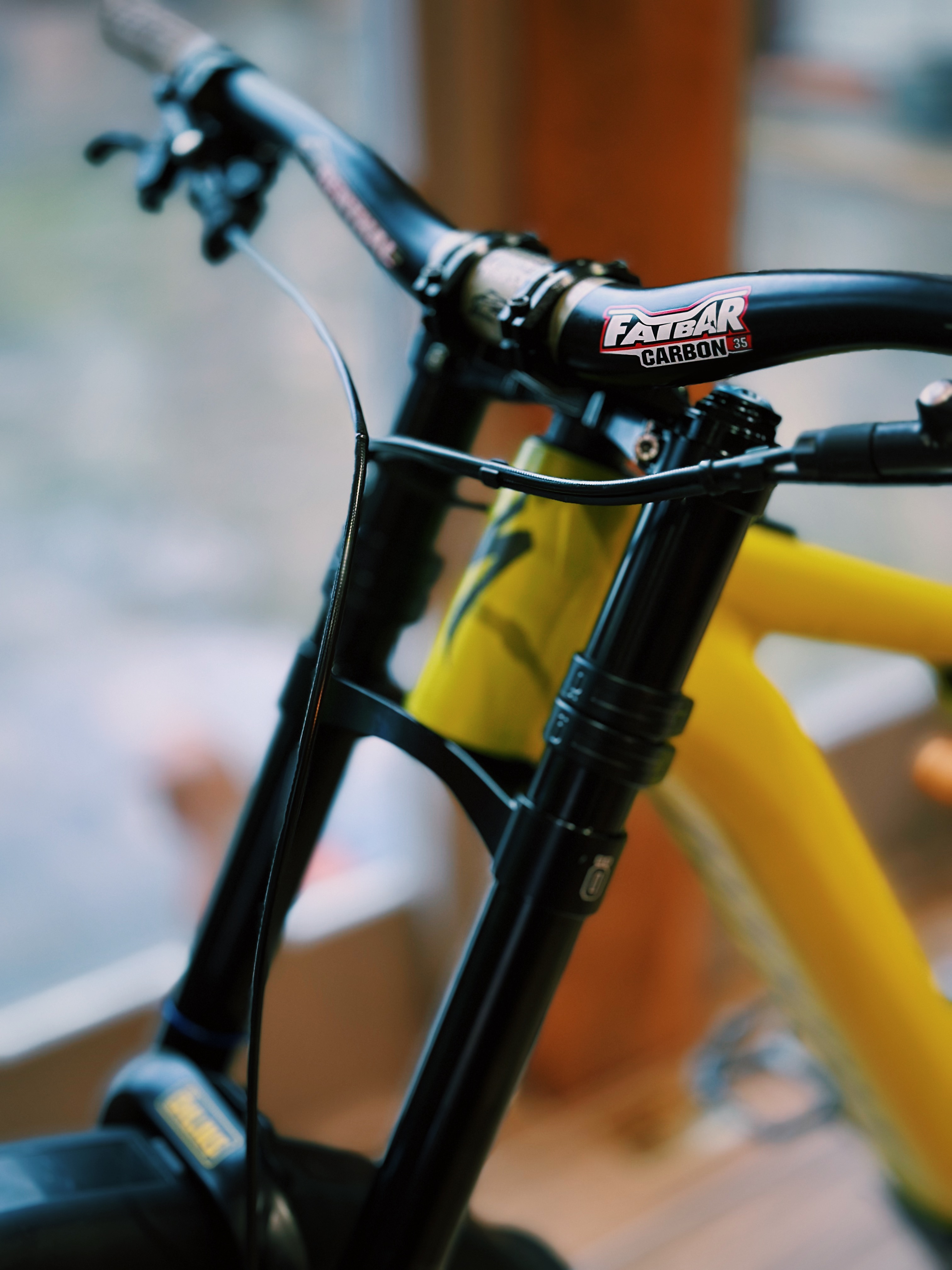

cozzy
Aug 11, 2019
810
876
Hampshire UK

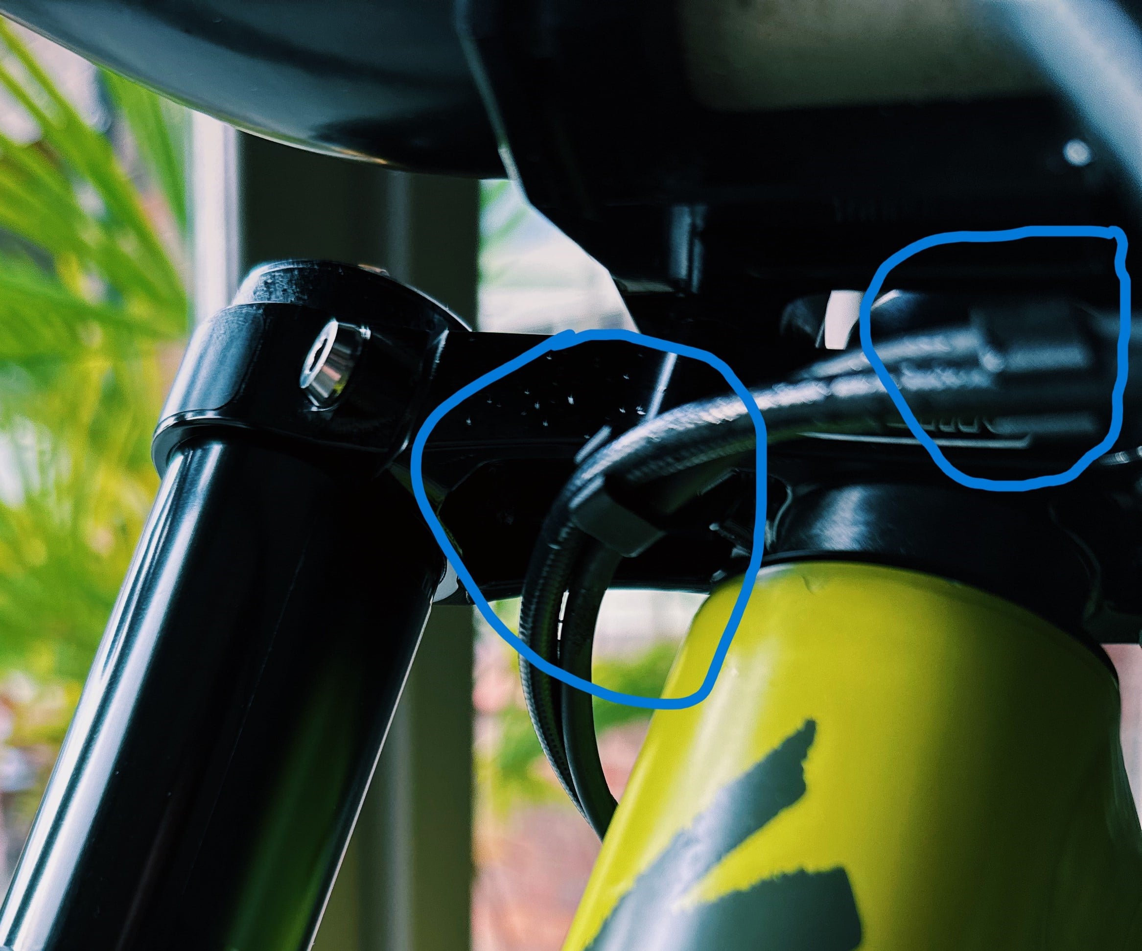

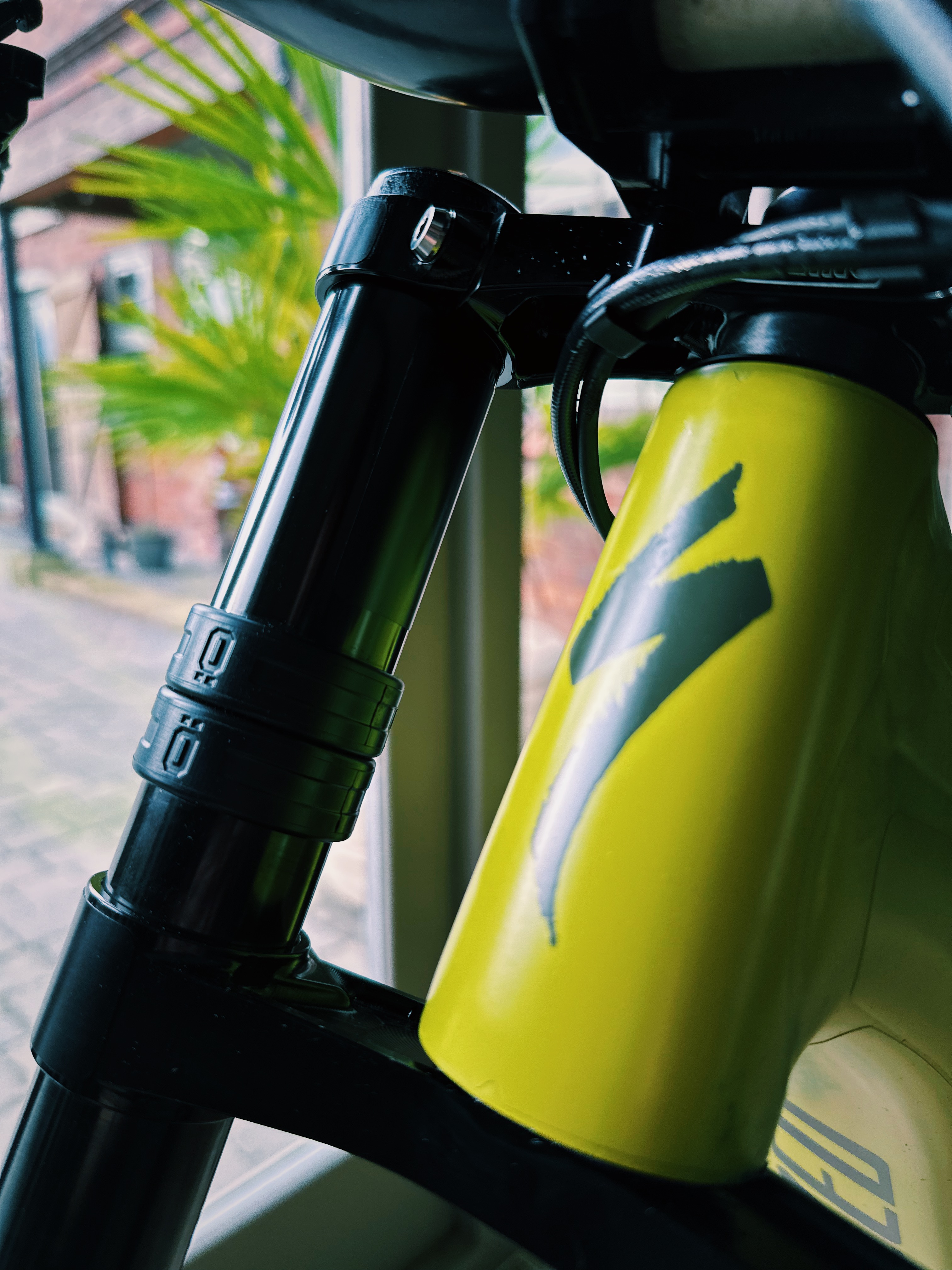

Make sure the brake hose doesn't rub off the anodising on the right stanchion. It looks like it's touching.
I routed my rear brake through the left port in the frame as no need for over long cables when the dual crown stops the bars spinning too far.
Christurbo
Jul 11, 2023
380
714
North Wales
Great shout - I need to replace the controller (Spesh have a new one being sent) so will do that at the same time 👍🏼

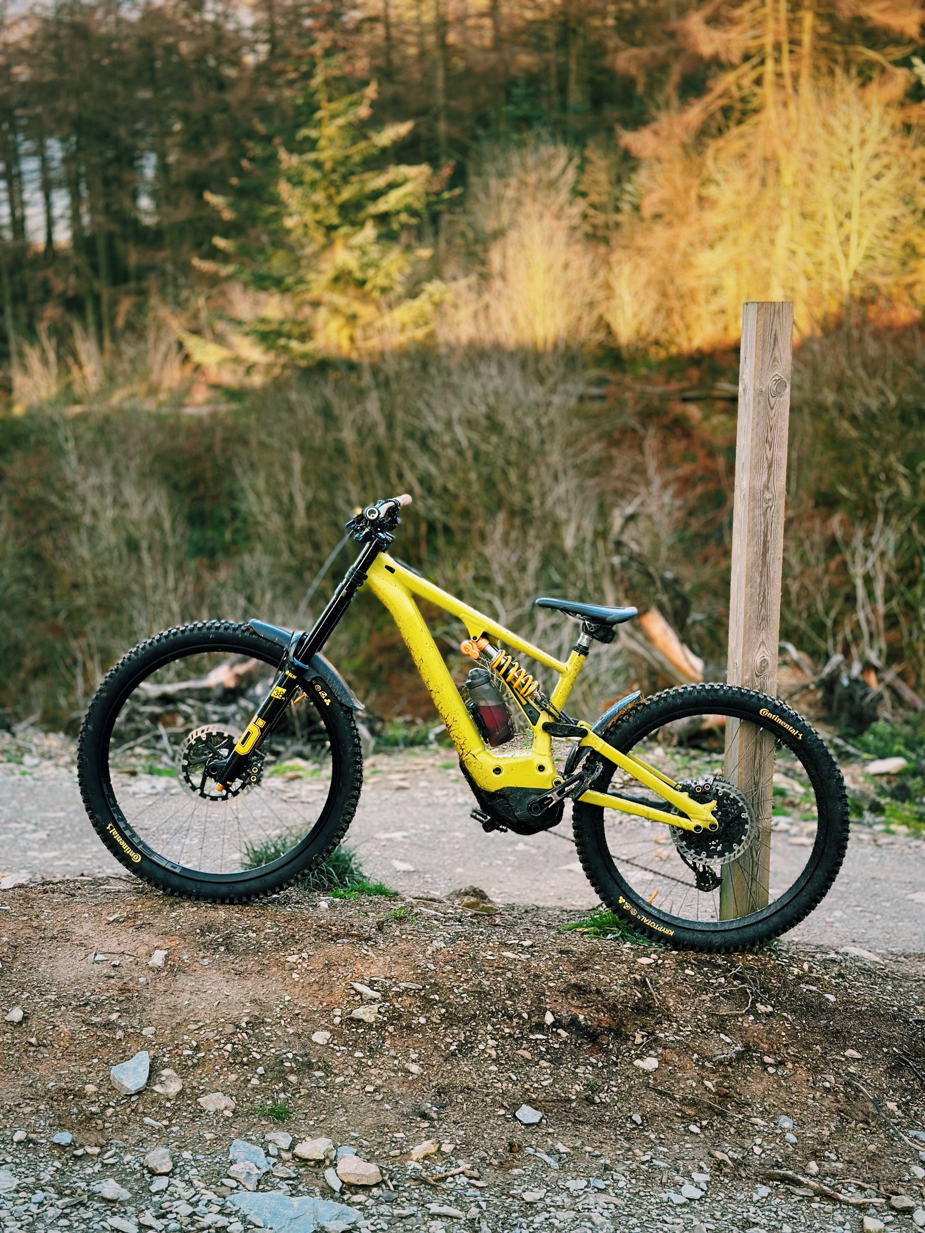

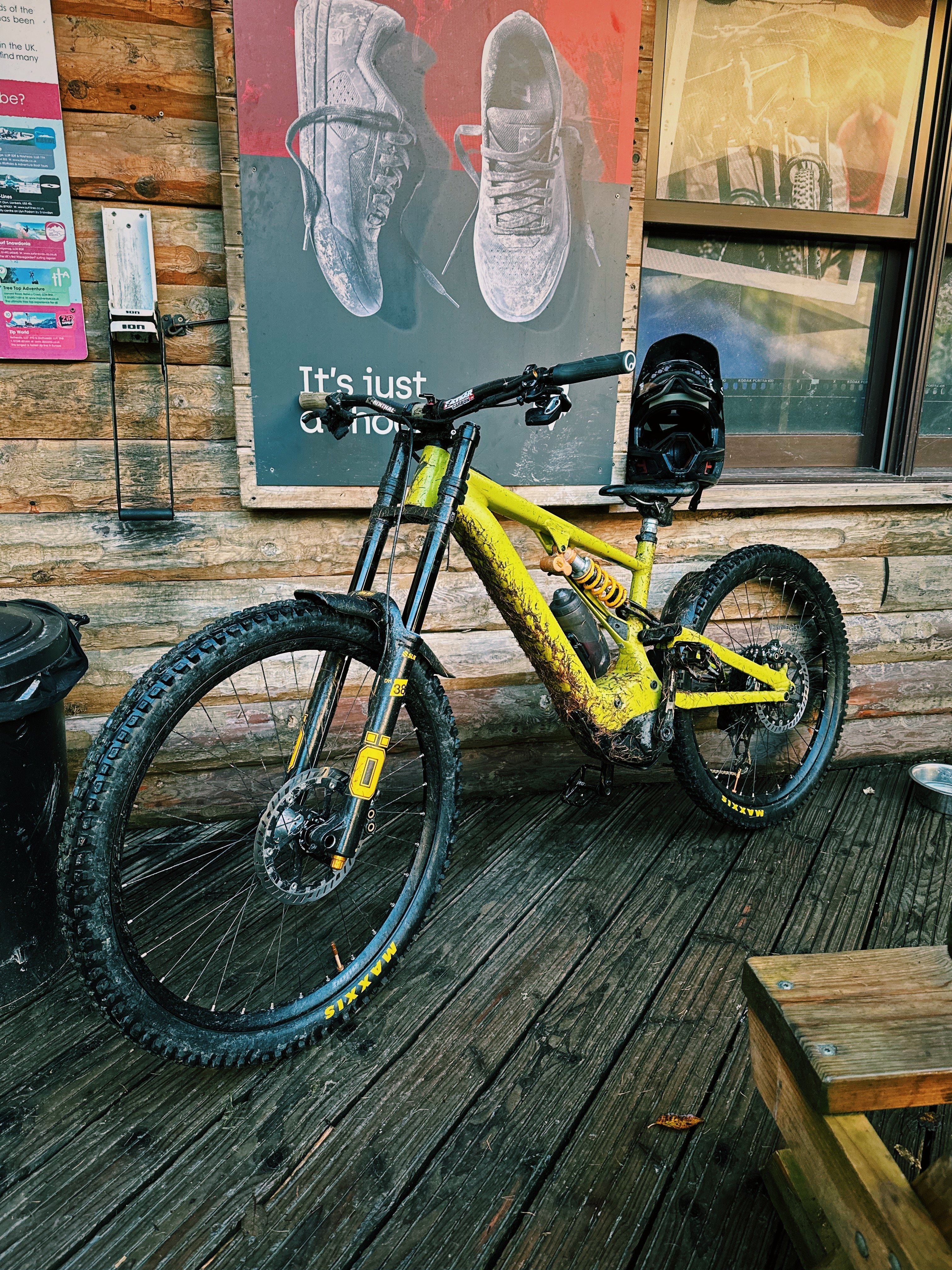

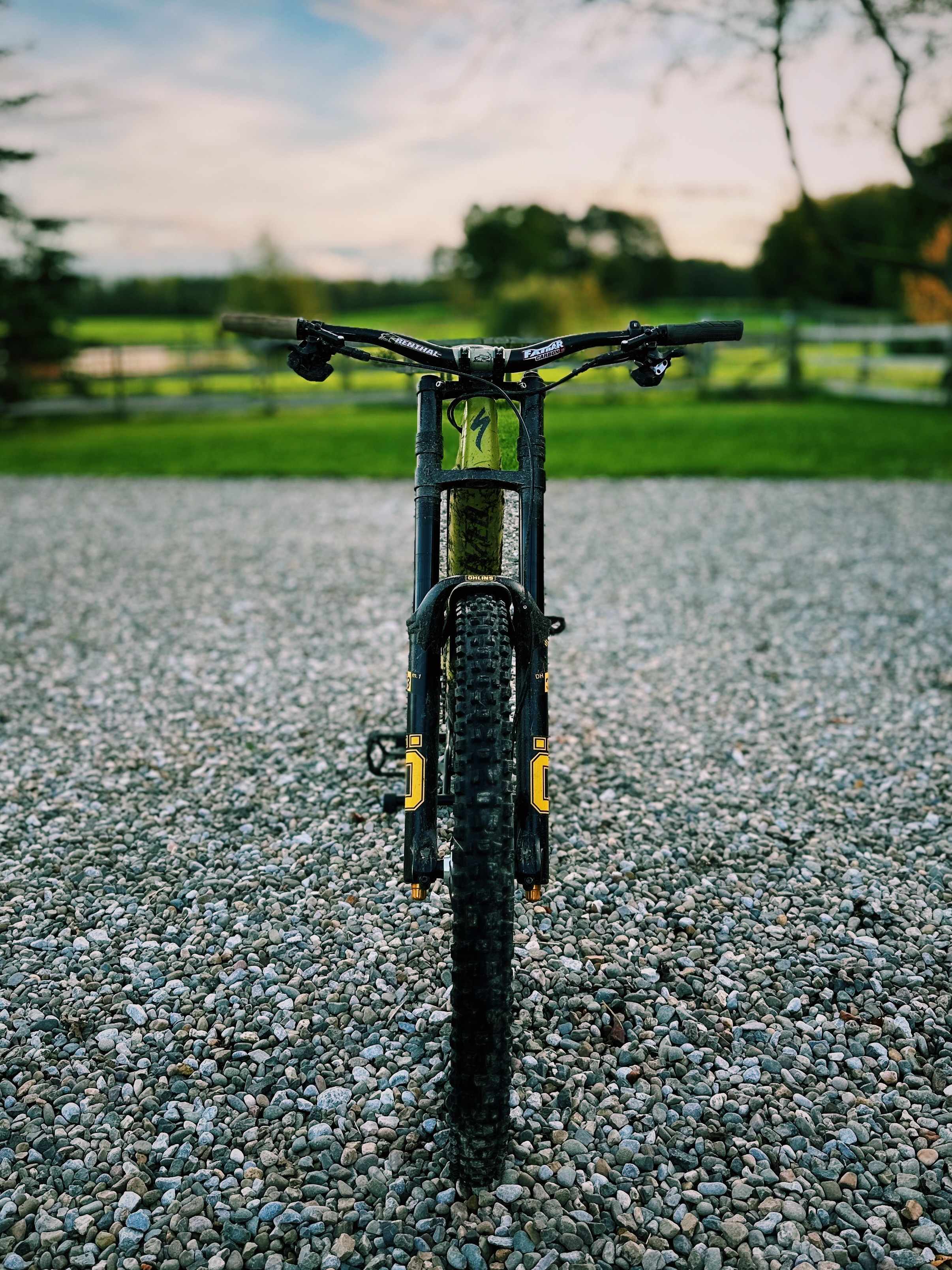

Shake Down - Downduro build
I took the rig out to the Welsh trails today to test out the new setup.
I decided on Öhlins recommended settings from their calculator.
Ramp up - 215 PSI
Main chamber - 110 PSI
I then landed on
HSC - 1
LSC - 4
Rebound 7 (then adjusted to 8 on trail)
The setup out of the box was pretty much on point. I only bottomed out once and that was a hard square landing so acceptable really.
I felt a little nose heavy to start with on take offs, but I added some rebound and it was perfect!
What a difference it made to single crown. The steering is so direct with no flex, so stiff in corners and the rough stuff.
There was no compromise either. Slightly heavier but minimal considering overall weight, but benefits from an ultra stiff and higher quality shock (in my opinion).
There were no issues with switchbacks which surprised me (didn’t hit the bumpers once).
Also (as you can imagine) the setup is so plush, it ploughs through rock gardens like they are not there.
I love that Öhlins have recognised the benefits of dual crown for all types of riding. Hell, they do air cartridges for the DH38M.1 from 120mm all the way up to 200mm! 180mm is the sweet spot though….. Downduro!
Wish I did this from the start!

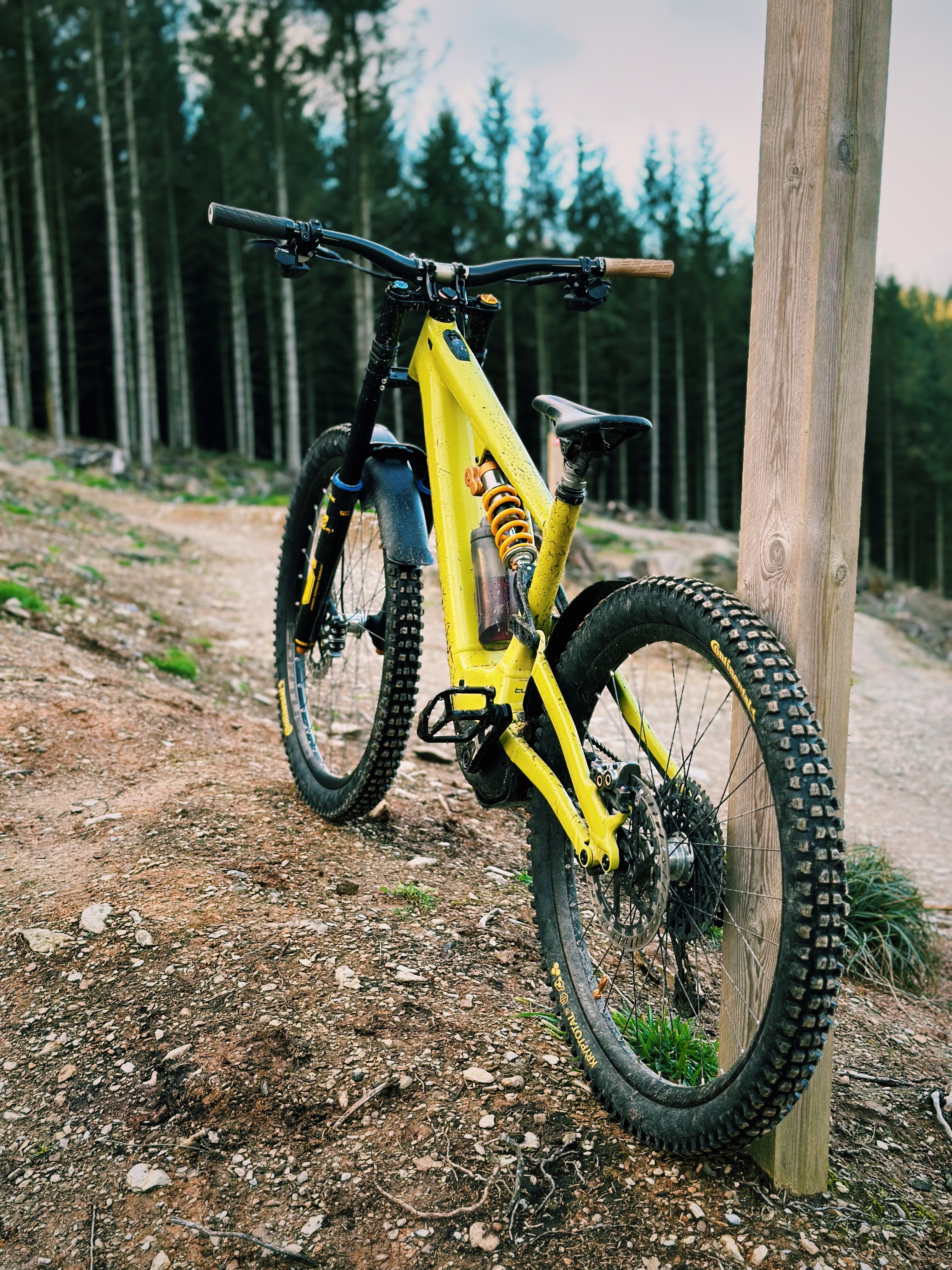

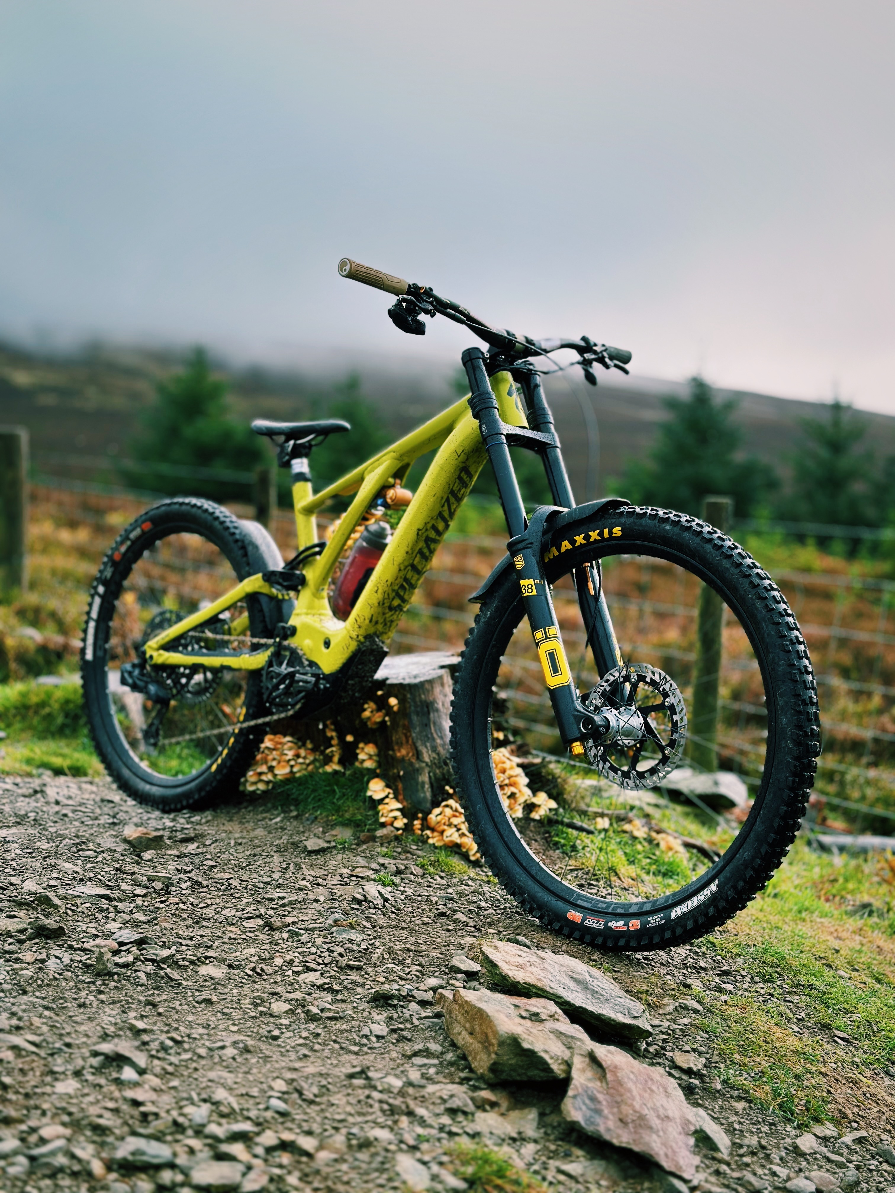

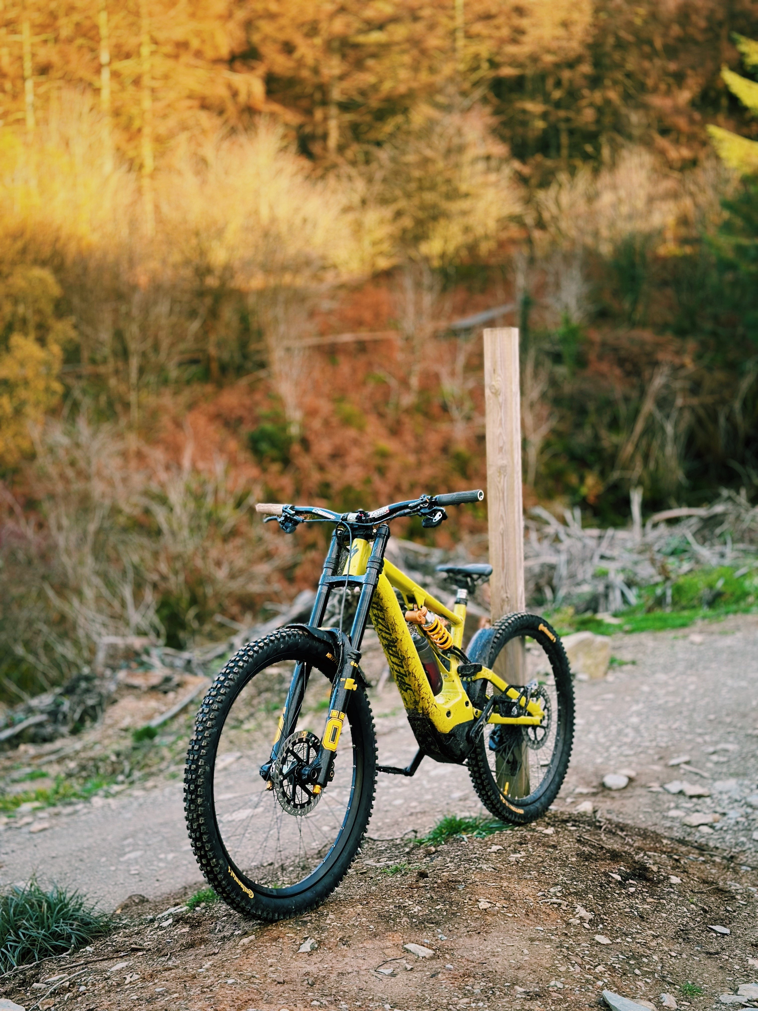

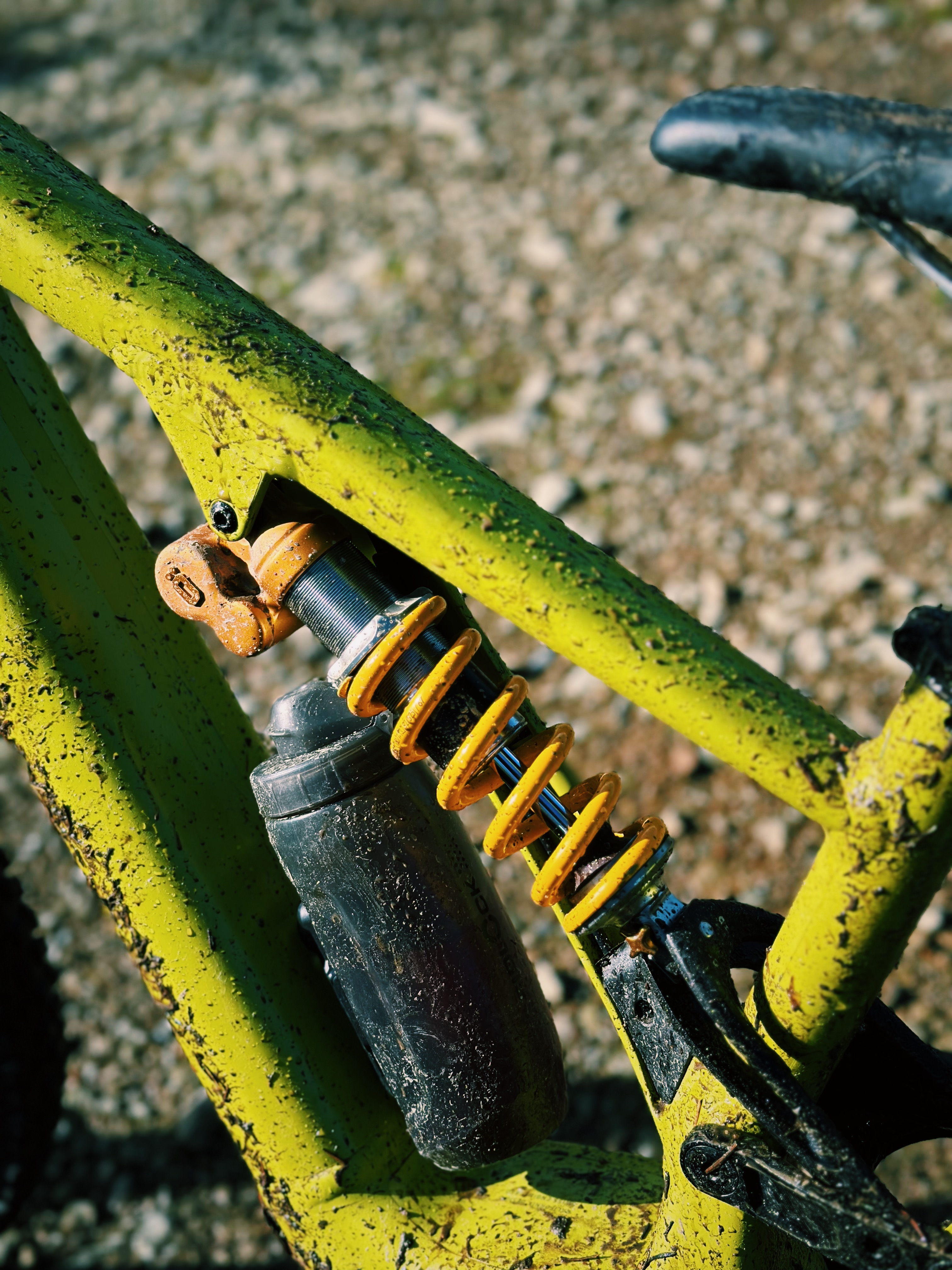

Update.
Well I’ve still been shredding the Kenevo even though it’s been so wet here in Wales.
I’ve had a few KOMs and trophies on Strava so it proves the setup has been working well for me.
I’ve made some small mods on the downtube to eradicate the rattles - it’s now silent!
Oh and I’ve decided to move away from
Cuschore Assegai / DHRII setup to a Kryptotal DH casing with no insert.
Race next weekend, so will see how they fair.
290C77CD-1C32-46E5-9B3C-A1B513255A2E.jpeg 09BE4AC6-708C-4CC7-AB45-12AB40383EA0.jpeg

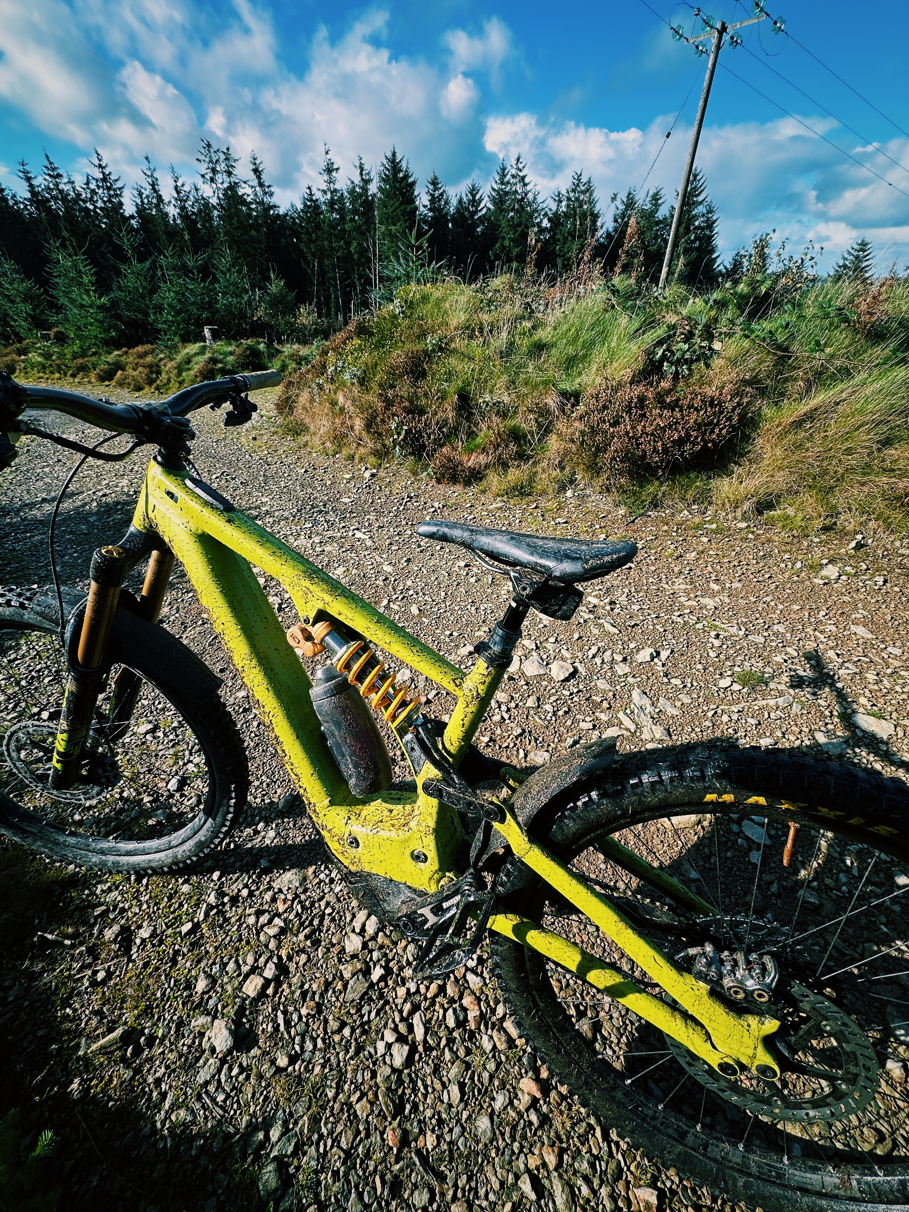

Update
So I moved from Maxxis Assegai / DHR II DD with Cushcore and have been running Kryptotal in DH spec F & R with no Cushcore for over a week.
The setup is c. 500g lighter.
Im not sure if it’s a placebo effect but it feels like it spins easier/quicker but the most noticeable feeling was the turn in. Much more responsive and felt like it can lean in easier than before. Really enjoying it and no punctures / rim dings on the rocks.

Ps. Not sure if I mentioned on an earlier post but the handlebar remote failed recently. Spesh replaced it and all is good again with the world. They don’t mess about and seem to love their customers.
