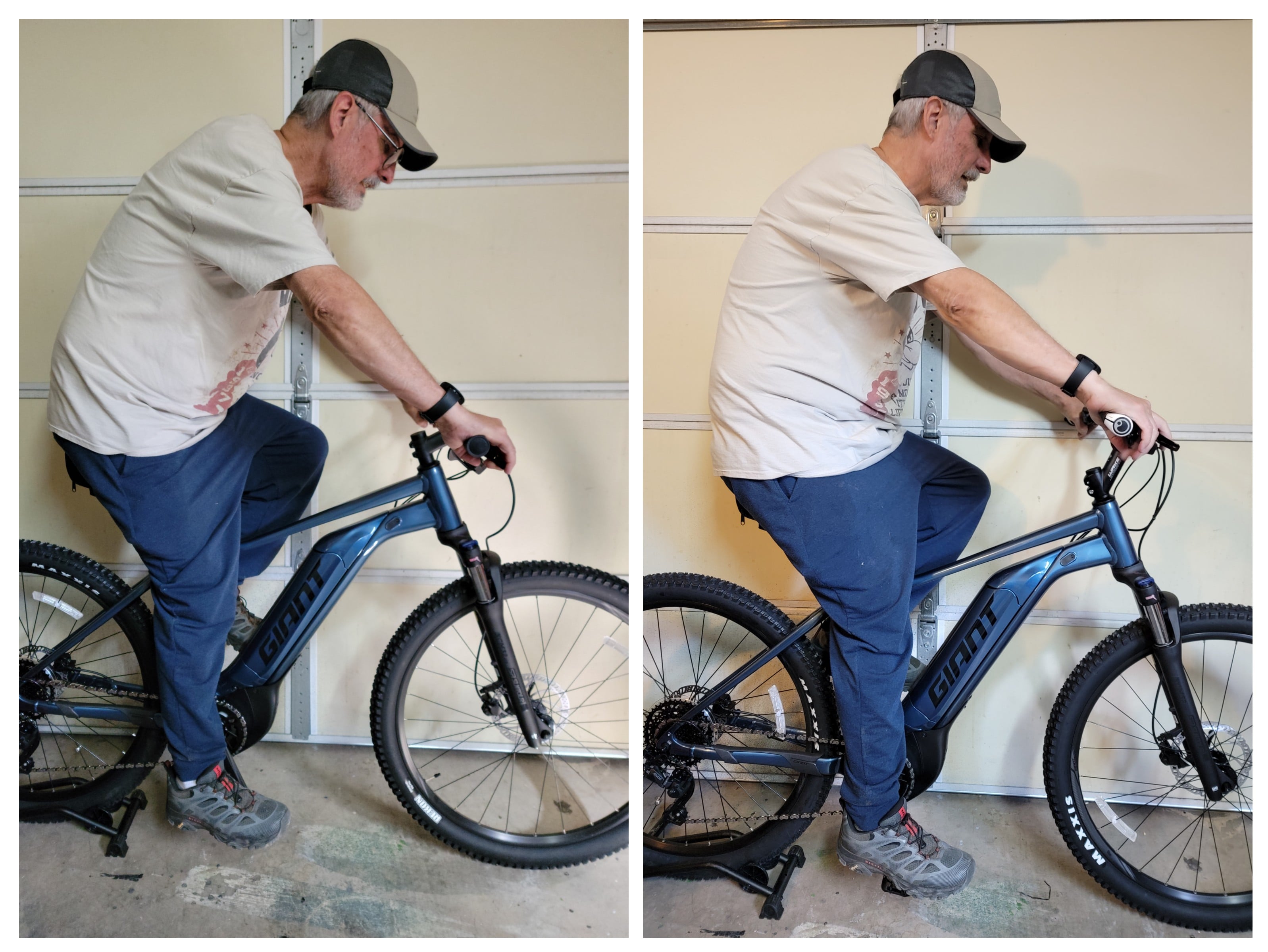

I've fractured my back a few times and my right thumb twice from bike crashes (among other bones). The last time I fractured my back (2 years ago) I wasn't able to ride. I put on both a riser stem and handlebar and went on a 10 mile ride with no pain in either... Here's what I bought:
• Corki Cycles Topo Mid Rise Mountain Bike Riser Handlebar 31.8mm Diameter 50mm Rise 720mm Width (Aluminum Alloy, Black) - Amazon $25.95
• Ergon – GP1 Ergonomic Lock-on Bicycle Handlebar Grips – large - Amazon $36.68
• Alomejor 31.8mm Bike Stem Alunimium Alloy - Amazon $16.74
The only issue I'm having is getting the grips at just the right angle.
