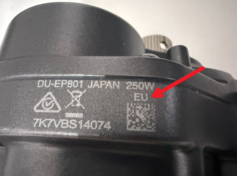

What software can I use to safely derestrict this shimano motor, I only want to change the speed assist limit from UK to US regional settings.
Also if I was to run into troubles and changed it back to UK to be sent off would this still void the warranty, TIA.
