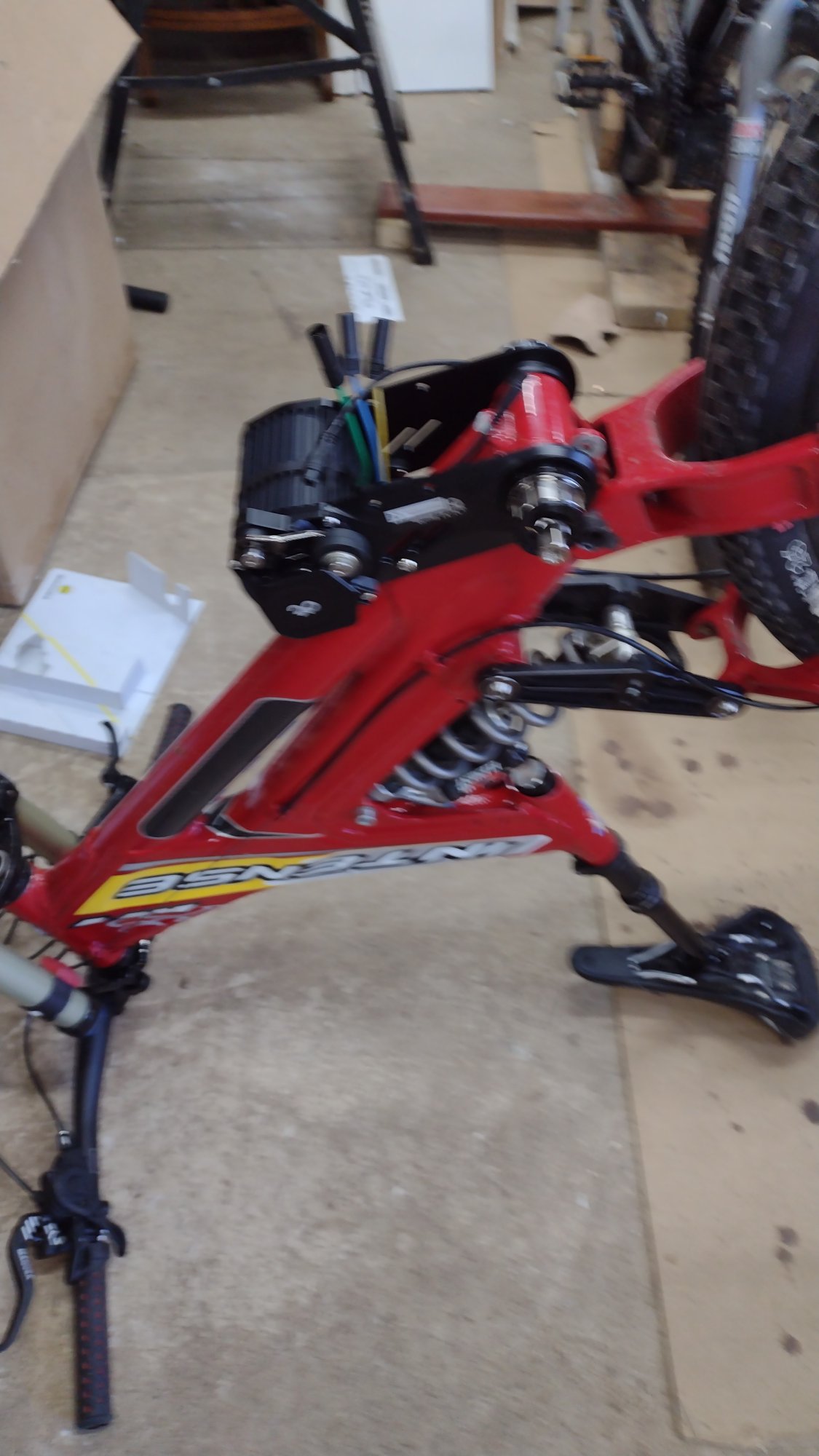

View at your own risk :sneaky: So I've been just itching to ride in general since I have no working bike so ended up buying a really cheap set of cranks so I can at least tweak other components, embed the brakes in so I'm excited for that. Then take them off once the motor comes in ?

Marjorie, you'll probably get yours first. Mine's on backorder I found out so it may not be for another month or so. Which is honestly not an issue as I slapped on a cheap crankset and am still able to ride my bike as normal. I could use some exercise while I wait :ROFLMAO:

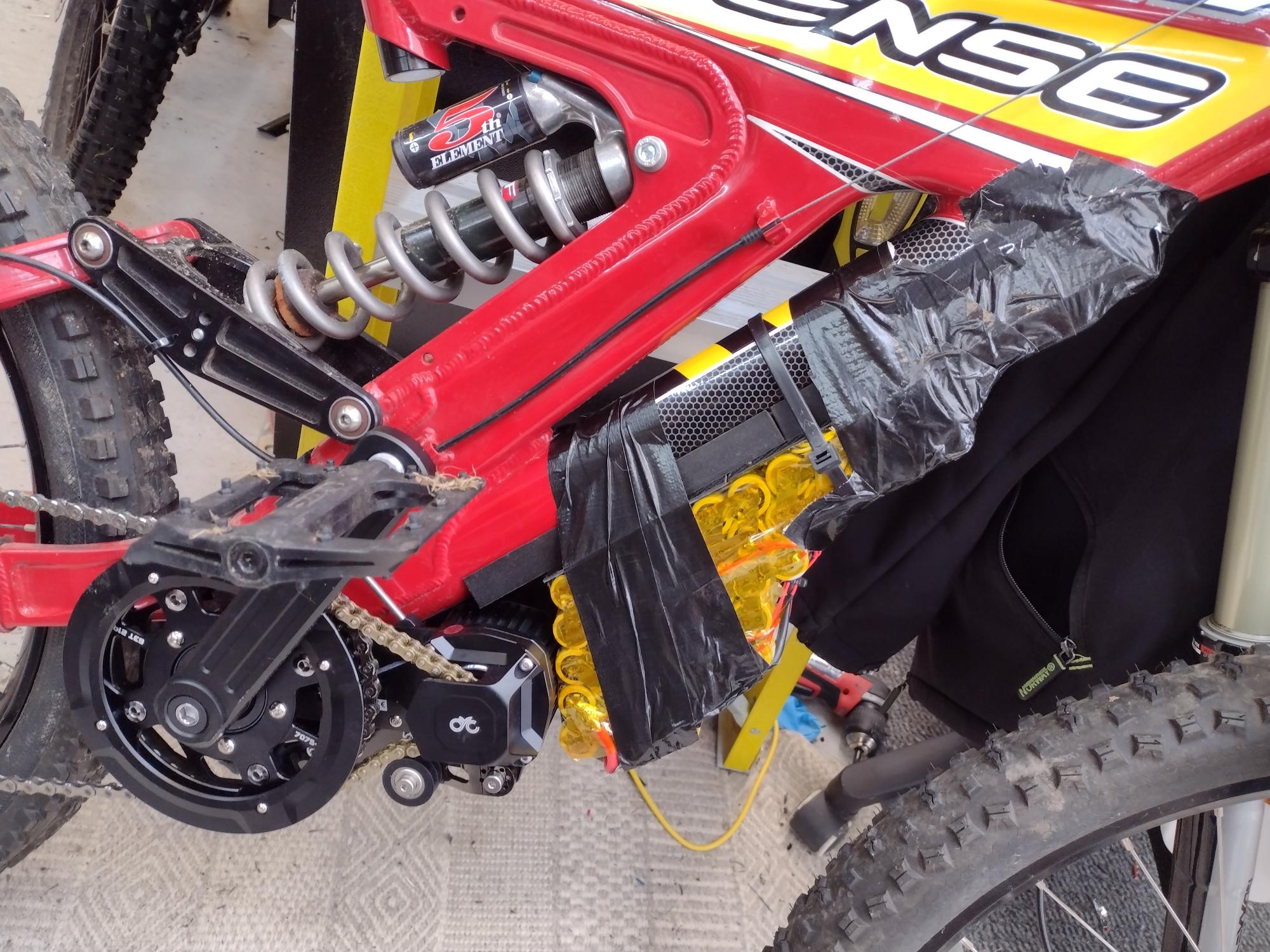

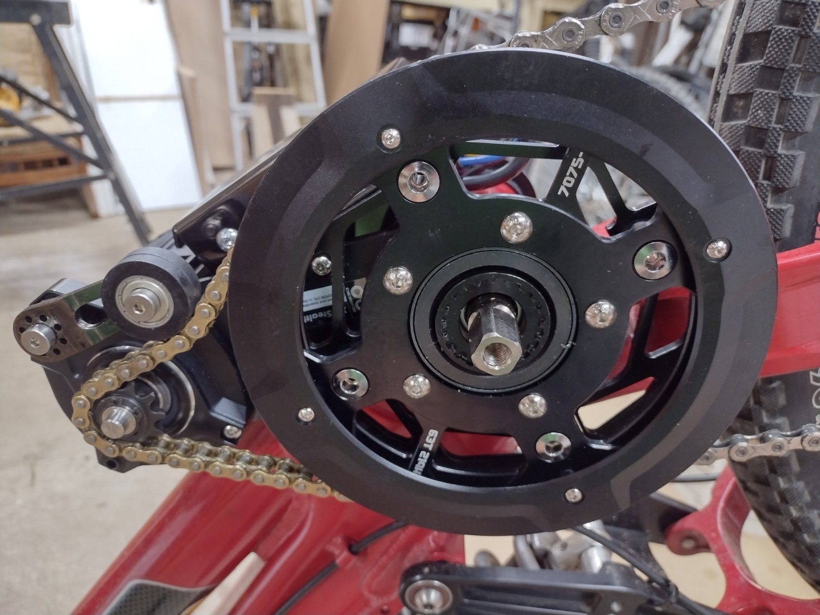

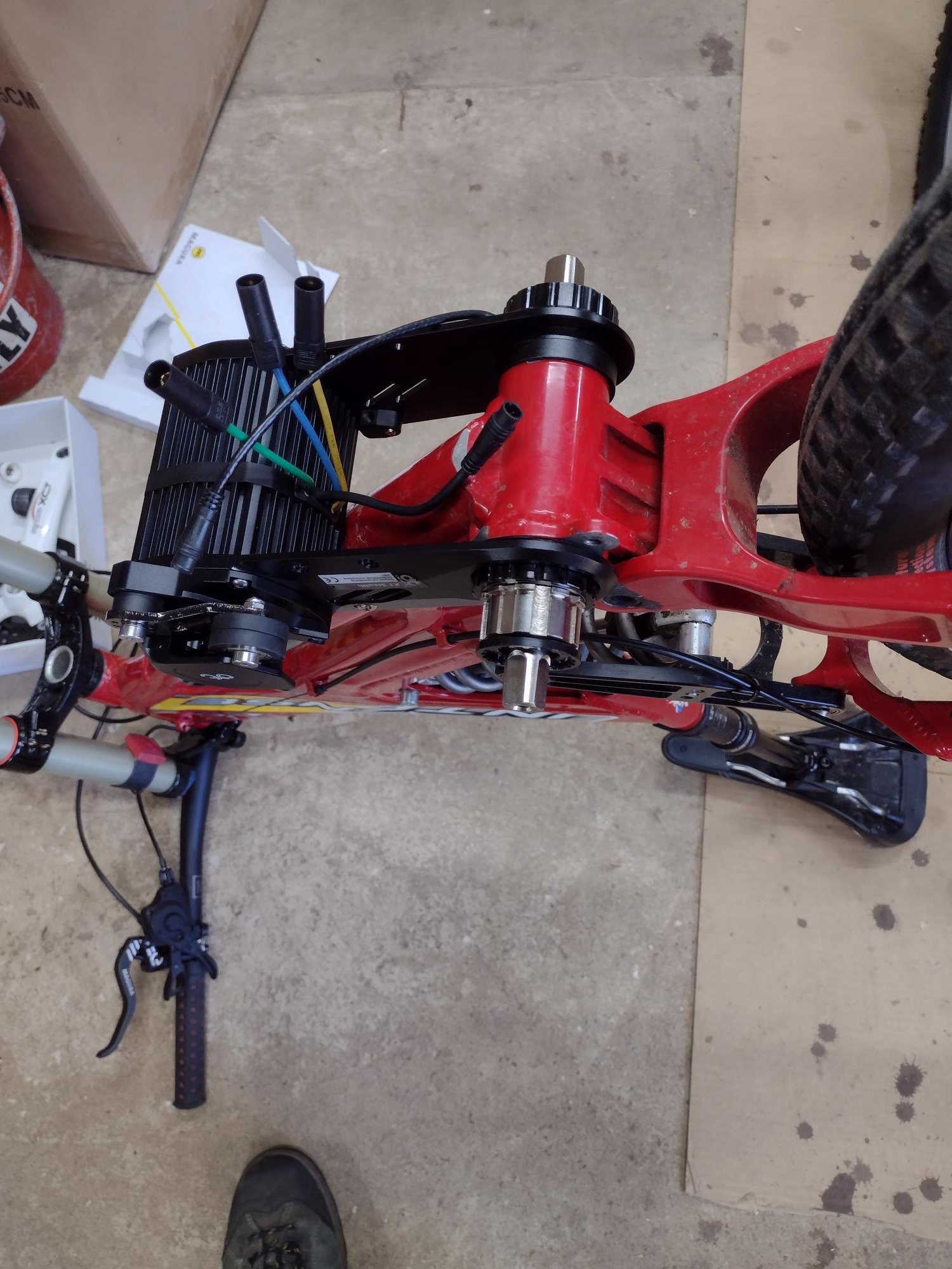

Little update...

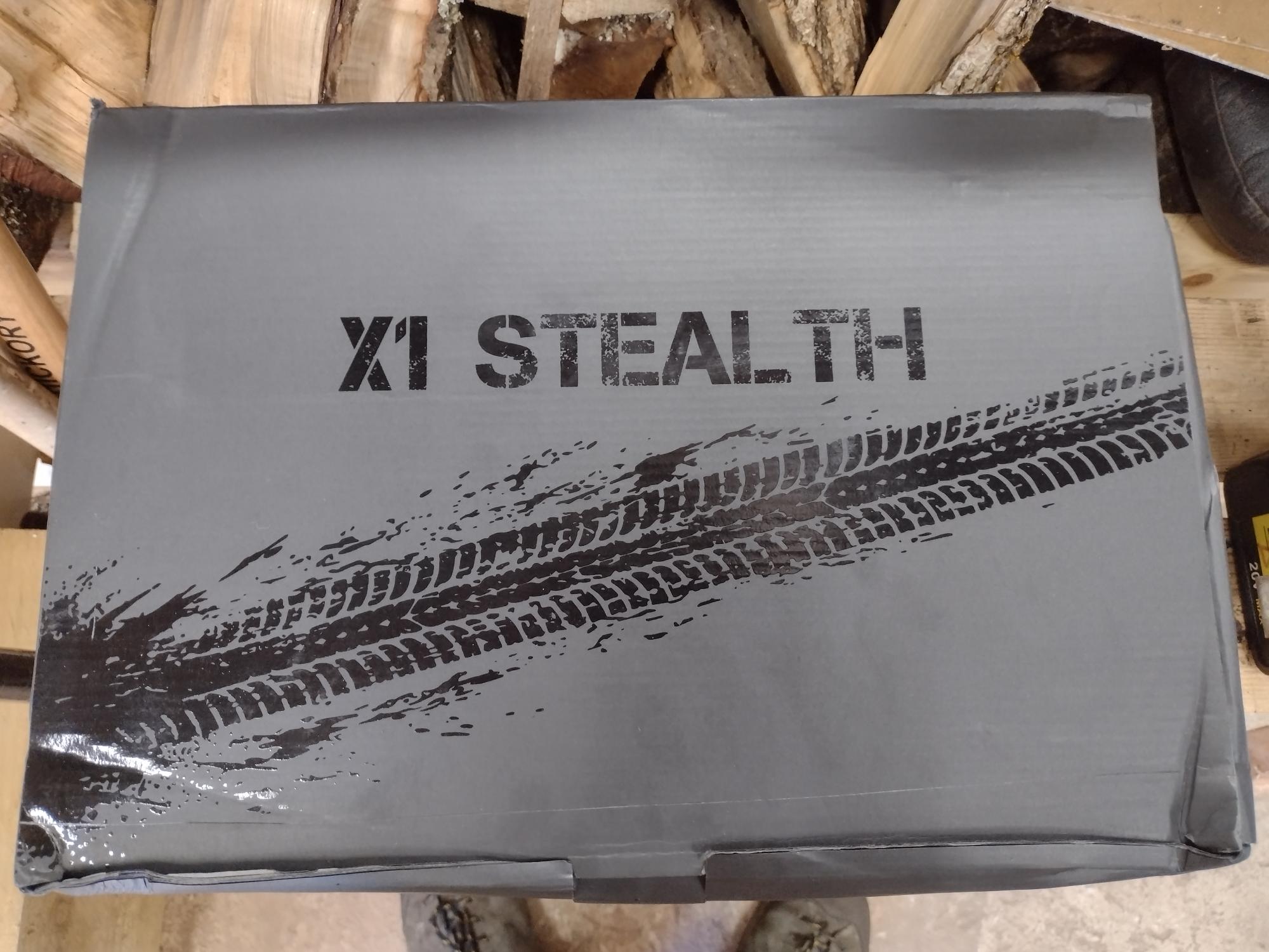

We've had the first unit through yesterday, and is really very nice!
Brother decided to put it on his GT Fury, 2016 vintage I think. It's a duct tape install at the moment.
Initial impressions are really positive.
It's quieter than the YouTube videos sound, assume that's down to frequencies in the recordings or something clever.
Fairly simple to install. Secured the motor on the bikes chain guide mounts.
Really nice display.
He made the 52v battery to fit the frame. All up weight of bike with motor and battery is 25kg (Fury is a DH bike, size L, 27.5 wearing Magic Mary's) and you wouldn't know it. It rides beautifully. Loads of pick up and an easy 30mph on the flat with more available.
We haven't played with the settings yet and the ride feels really nice.
Will get some more feedback and photos when the weather's better.
So far, would recommend it:)

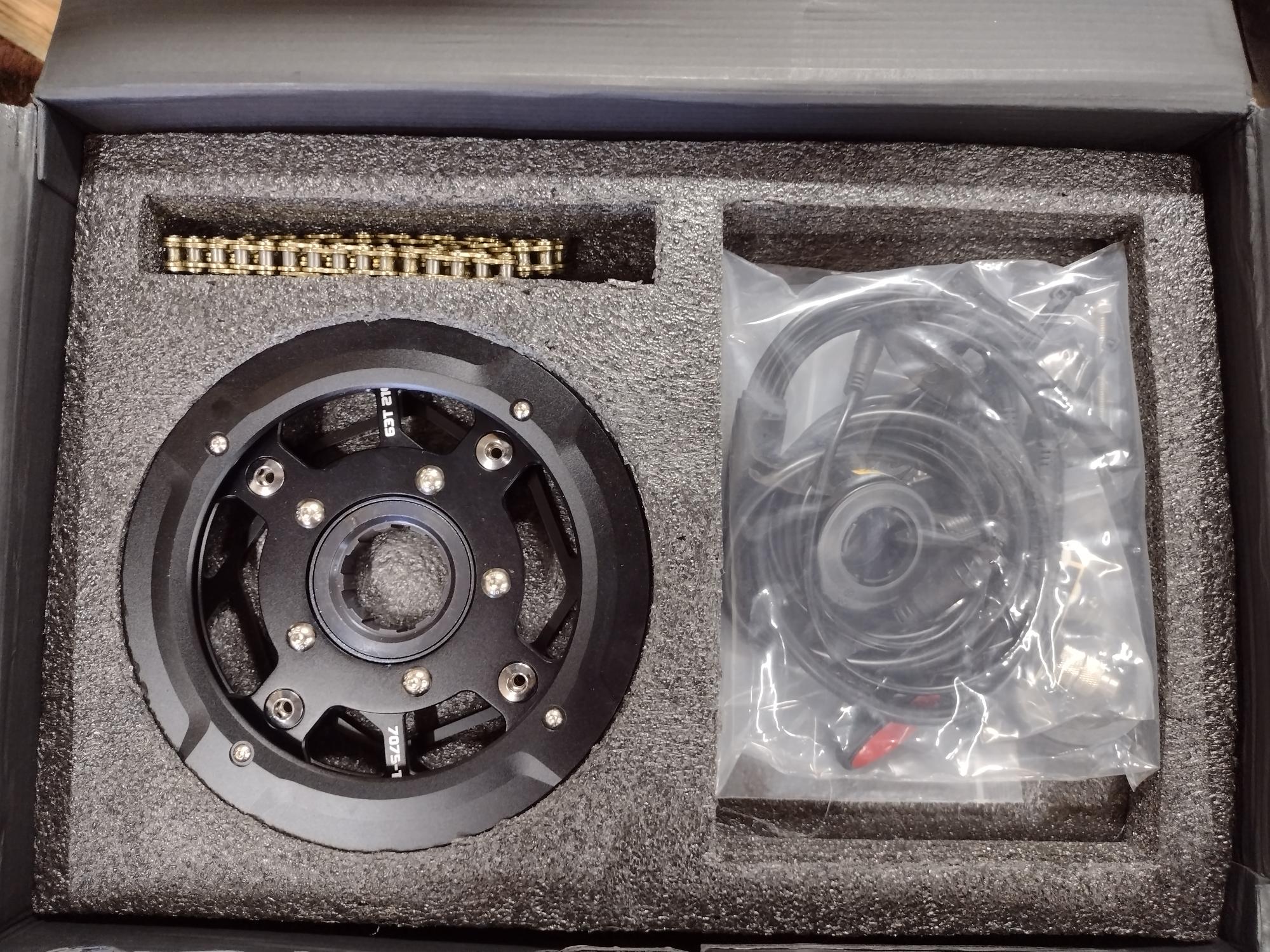

full
full
Marjoriefinnegan
Jun 12, 2021
74
65
Uk
full
Ghetto battery installation for testing, hopefully on the road tomorrow weather permitting.
21700 batteries in a 14s3p configuration with BMS.
3d printed carbon nylon adaptors to make bottom of downtube flat.
All up weight of 24.74kgs with 2.5 knobblies.

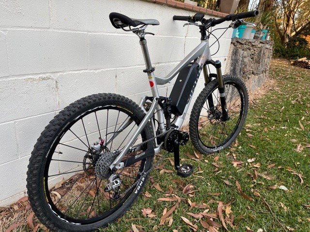

Hi,
I just built an older 2009 Giant Reign 0 with the Stealth motor. Took it out and did 20kms of singletrack on weekend. Was fantastic, played with assist levels and between street and race modes. In race mode on level 1 it had more than enough power to blast through the trails. I run a 52v 9.8 ah battery and came back with 90% left. I know it's an older bike but was top spec in its day and weighs 19.5 kg as pictured. The bike owed me nothing and now I have a pretty capable ebike for a lot less $$. I can keep up to my wife now who rides a Focus Thron 2 6.9 ebike!!! My inspiration for this came from viewing Rob Rides EMTB build of his Stealth.

I’m in Australia and contacted a local distributor and he had 1 in stock, deal done. Battery was part of the package. Took 4 days from ordering to delivery. I guess it’s where you are. So far really happy with it and yes it’s not as noisy as on videos. Plus I used a Muc off ceramic lube on chains which helps with the noise. When you are in race mode under full power and shifting through the gears it sounds like a formula 1 race car, well that’s my take on it. May do a video on single track when I can
