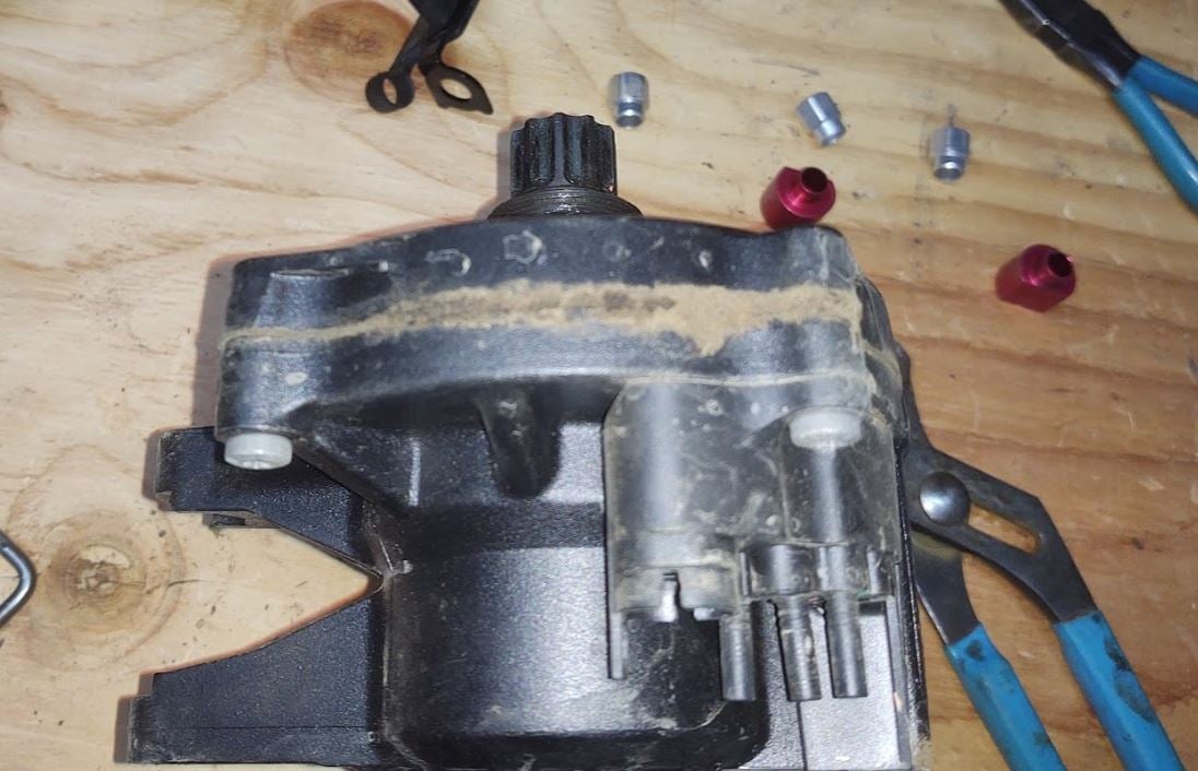

Has anyone ever seen this before? You can only see it if you take the motor out of the bike.
There was a slight gap near the gasket. The two screws in the picture were loose and I was able to tighten them and see the gap close. Specialized claimed there was nothing inside to leak but after finding the kit I am pretty sure it was Vaseline.

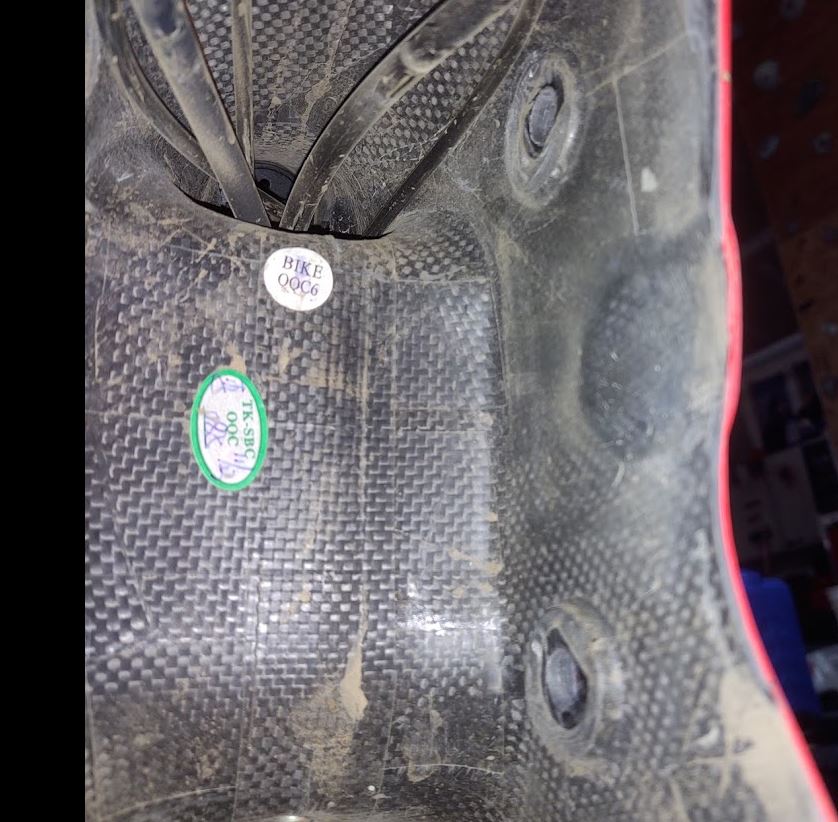

Specialized assured me it was the seat post or water. I offered to send them the picture but they declined. I did let them know the pictures were on this forum so hopefully they see it and respond.
Here is a picture looking up the frame at the bottom of the seat post, pretty sure its not leaking here.
Wow! For a start I am way too cheap!! I include fitting it for that price. The belts are lubricated with Vaseline but once this has been done the Vaseline does not leak through the gasket, it generally stays put within the motor. Also if the Vaseline ever did make it through the gasket, it would coat the outside of the motor and anything it touched, so it's not Vaseline.
The screws used to hold this motor together are made from a very light alloy and must be very carefully tightened, they must be torqued and then stretched by turning a further set number of degrees. If the torx screws are just done up tight, if you return to them a few seconds later they are all loose again.
I have seen the S and T motor where water is coming through the gasket. This is a paper gasket and why the cases rot so badly under the gasket.
This issue is more noticeable if mud and dirt has collected around the motor inside the motor covers. This dirt stays wet and the motor then sits in a very wet environment for days on end, allowing water to soak into it.
In the case of Skyhighs bike, this looks to be just a case of loose screws. If the bike is outside of warranty, I would effeminately get it looked at to see how much water (if any) has entered the motor?

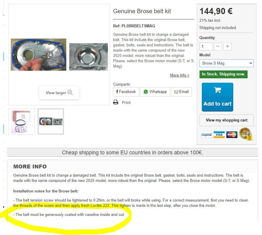

This article talks about "belt dressing" .. intended for use on "rubber" belts (which isn't what you're using here) :
Everything I've read suggests you shouldn't use vaseline on epdm belts as it could dissolve them. Though the Gates belt is a mix of all sorts so could also be resistant to this. I would have thought silicone grease would be more appropriate ????
Bearing Man
Ebike Motor Centre
Sep 29, 2018
875
2,079
Definitely no rubber in these belts, but it may also be used to stop or submit harmless contamination of other moving parts? Again, all I know is that it works for about 5,000 miles, then starts getting a bit dry. Slightly dodgy as the belt should be changed after 10,000 miles but if they don't strip or snap they seem to make it.

@Bearing Man So vaseline it is.. Thanks bearing man , great info. Is there different kinds of vaseline, do not want to make a mistake .The vaseline thing is new to me. Just took apart my first s mag motor. Motor had no assist ,
belt was shredded, checked the bearings and “BOOM”!! Sprag bearing was broke. All the other bearings look good, would like to upgrade sprag bearings and extra seals and a belt. Can they be bought separately without the other bearings.
Yes, it's called "Technical Vaseline" You can find out more here: www.ebikemotorcentre.com/product/technical vaseline
