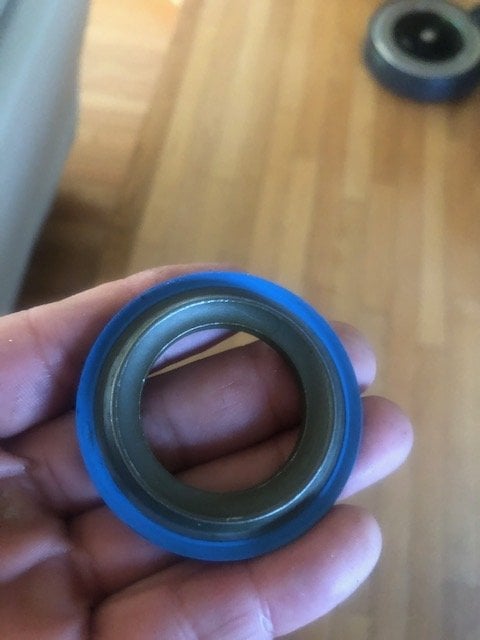

So, I bought an angleset to slacken my bike. It came with a crown race reducer for 1 1/8 steerer tubes. Yours if you want it (Happy New Year!).
