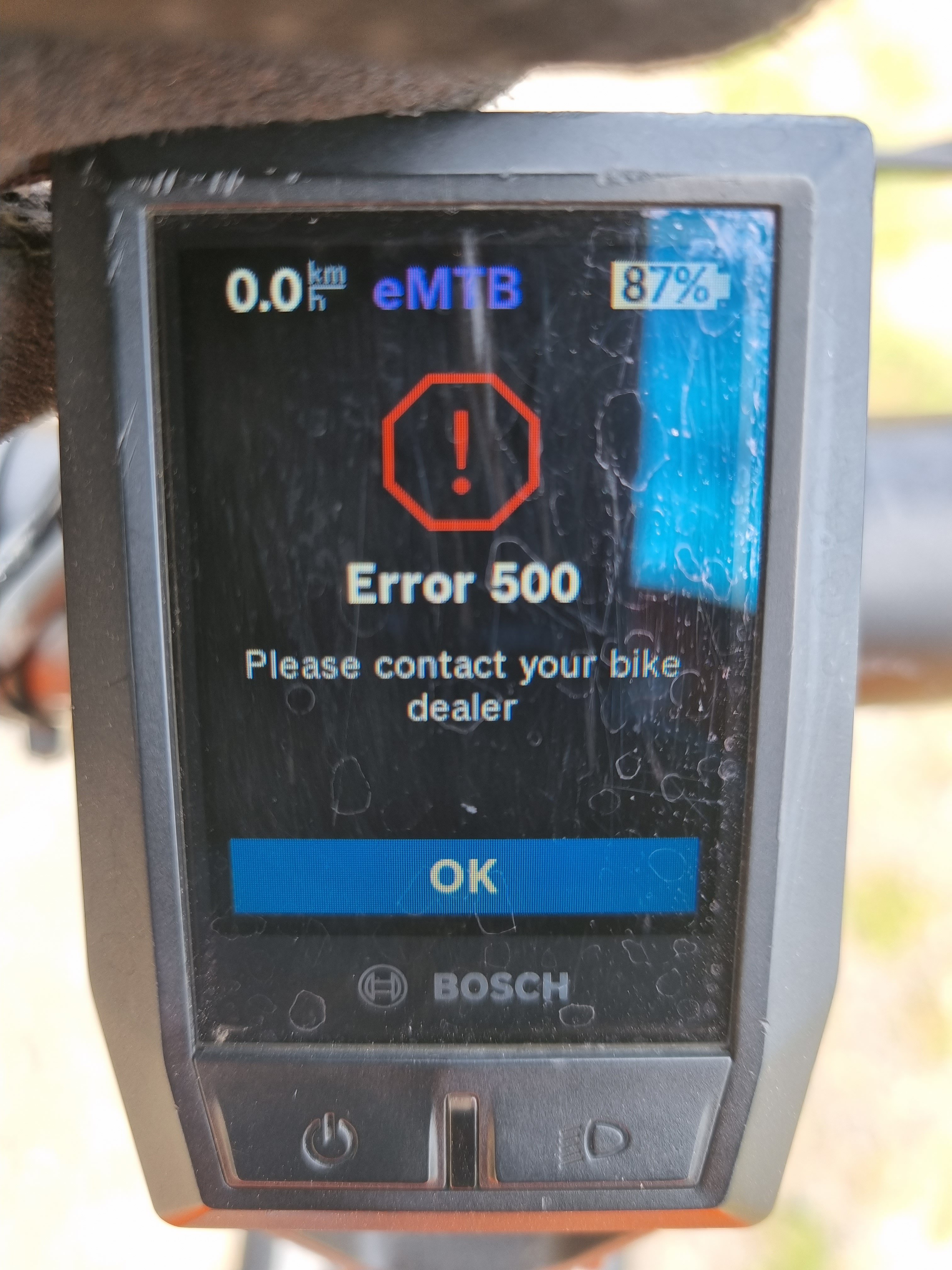

Anyone else had the 500 fail code on their Bosch Gen4? Mine shut down 3 times on a ride today and it shows 500 in the display. I have tried to restart and all, but still error. Is it for sure needed a new motor unit for this error, or could it be other reasons for this? The bike has 176km from it started running just before Christmas, on a Focus Sam2

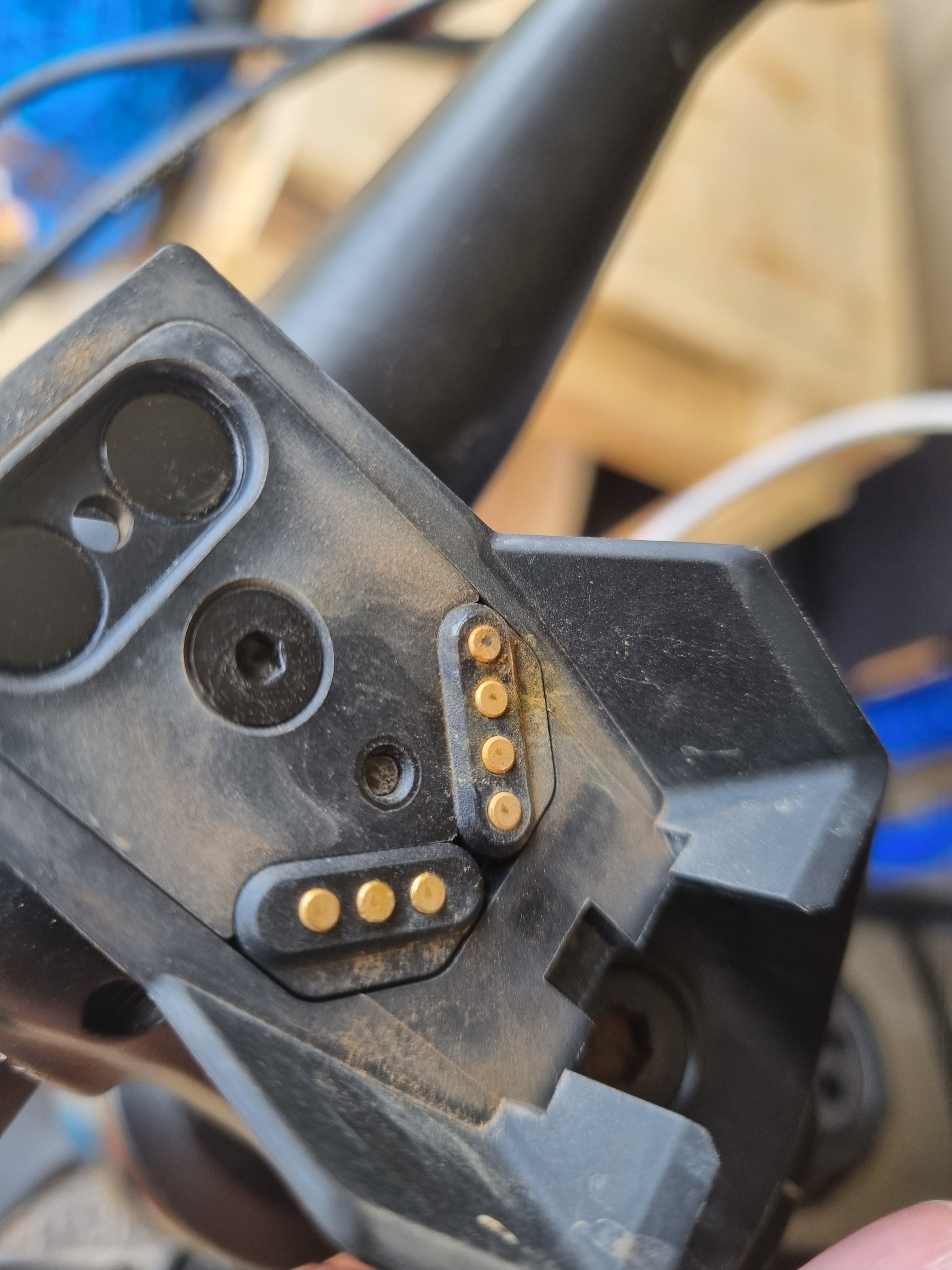

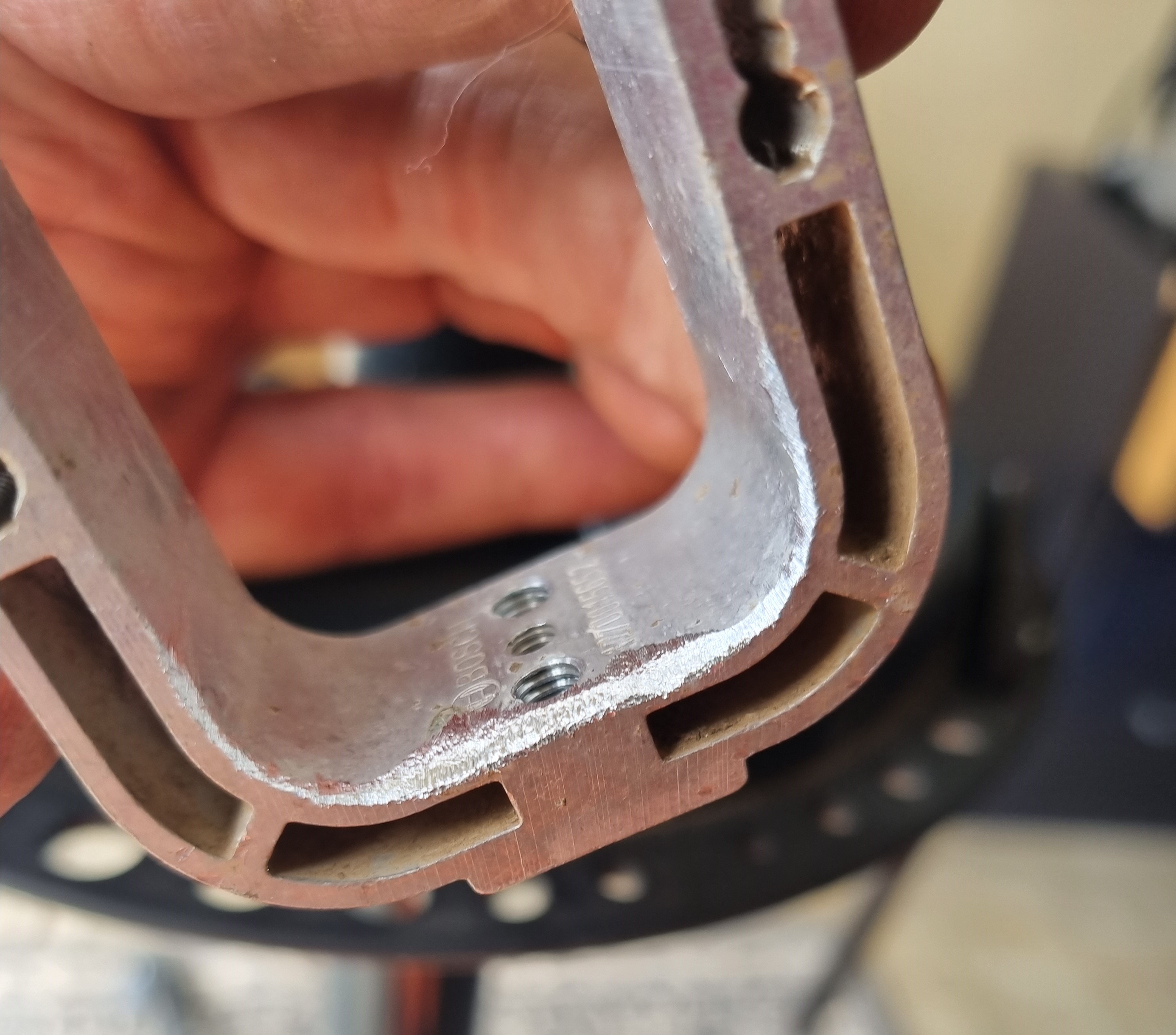

Had an error 500 come up on my 2021 Jam2 6.8 9 KIOX display today. Googled it, with many varied results. I Rang WillRide who doesn't bother much with BOSCH these days...... Uggh!
So I took the bike home, removed the left motor cover, blew out all the dust, and cleaned all electrical terminals along with the battery connection and charge port. Reassembled.

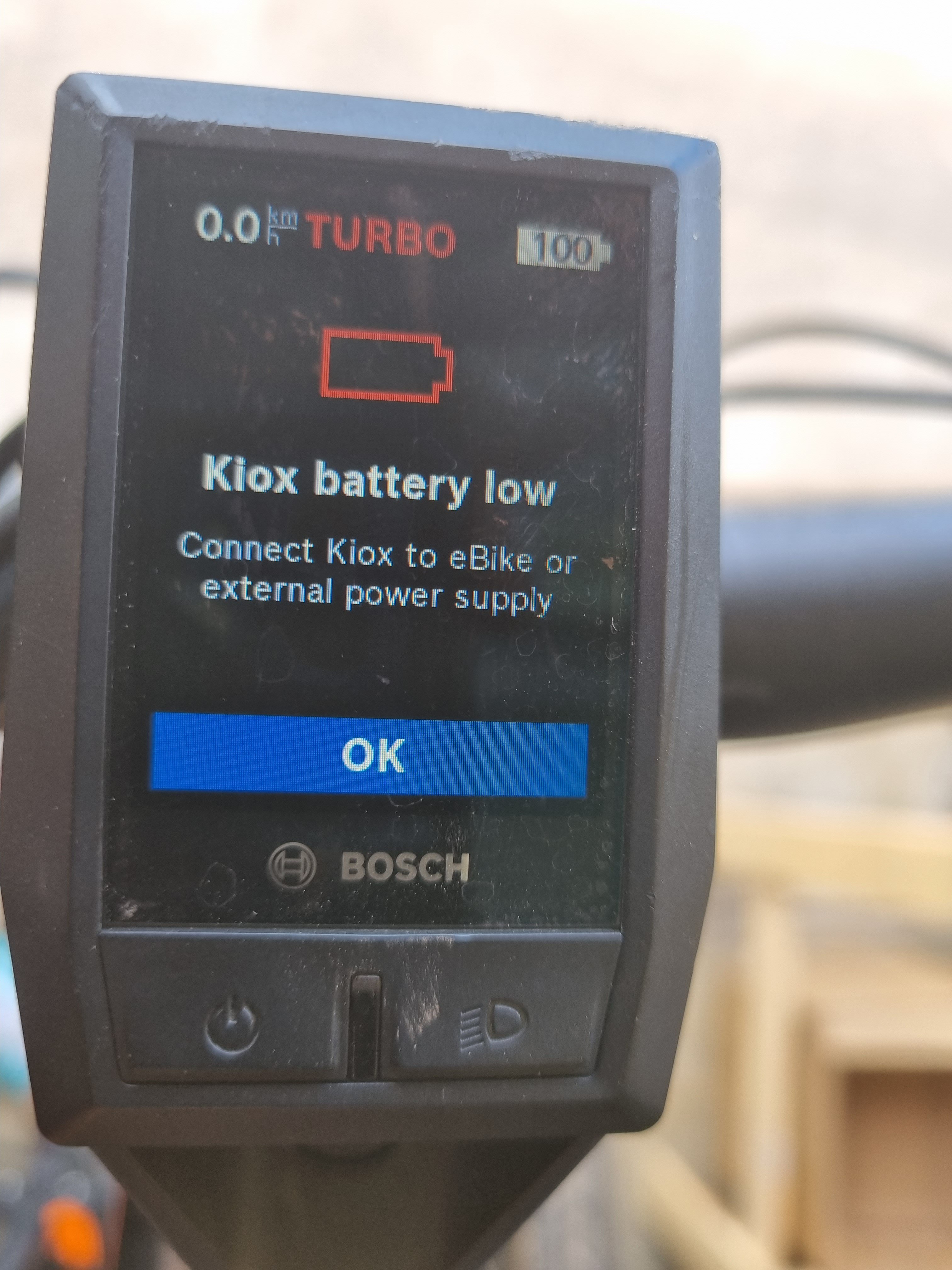

Then the error was showing 'KIOX battery low'. I actually saw that out on the ride but took it as my main battery power level wasn't registering...Too much of a panic to read it properly I guess.

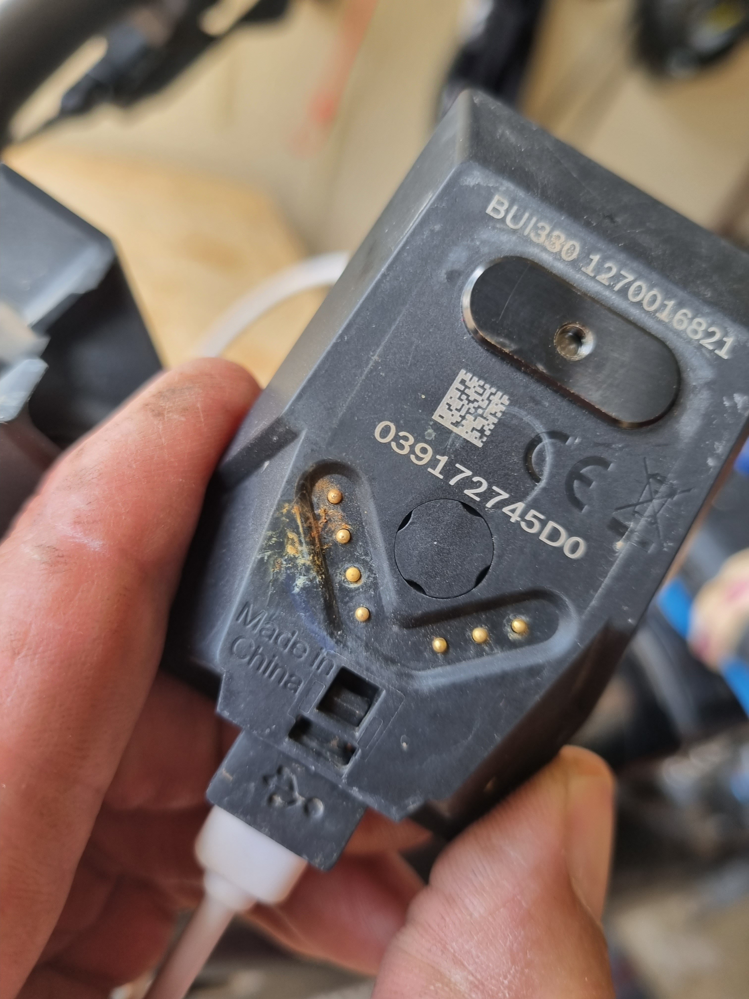

Anyway, I've always had my KIOX screwed into the mount so it couldn't get bumped off down an embankment and get lost. Anyway, it's been 8300km + since I've had to remove it. But today I did, and this was the cause of my 500 error. Corrosion of the KIOX electrical contacts.
I've taken the bike out for a ride since cleaning all of the electrical terminals now, and it's sorted! So it seems like it was just corrosion on the KIOX electrical contacts after all that.

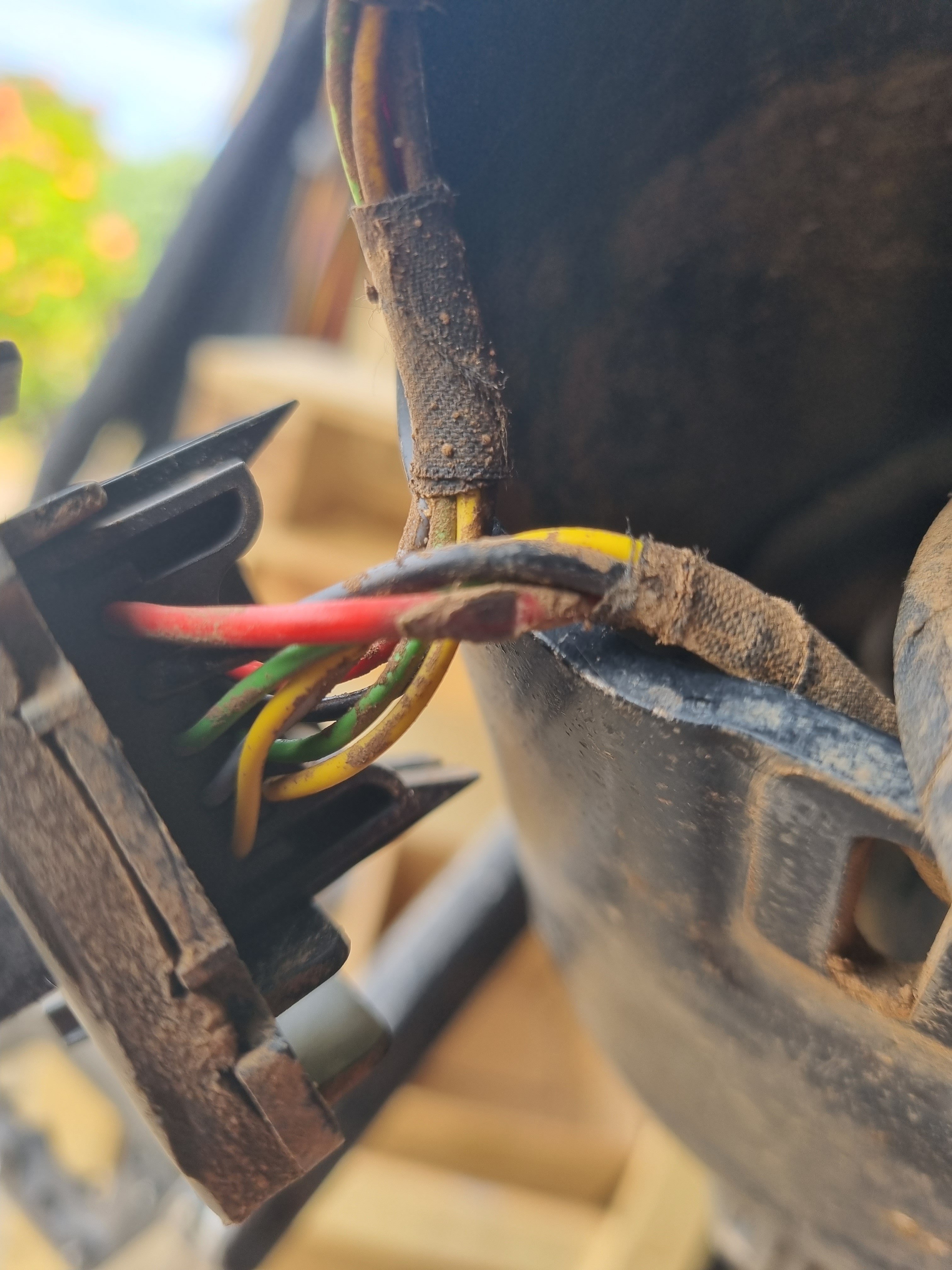

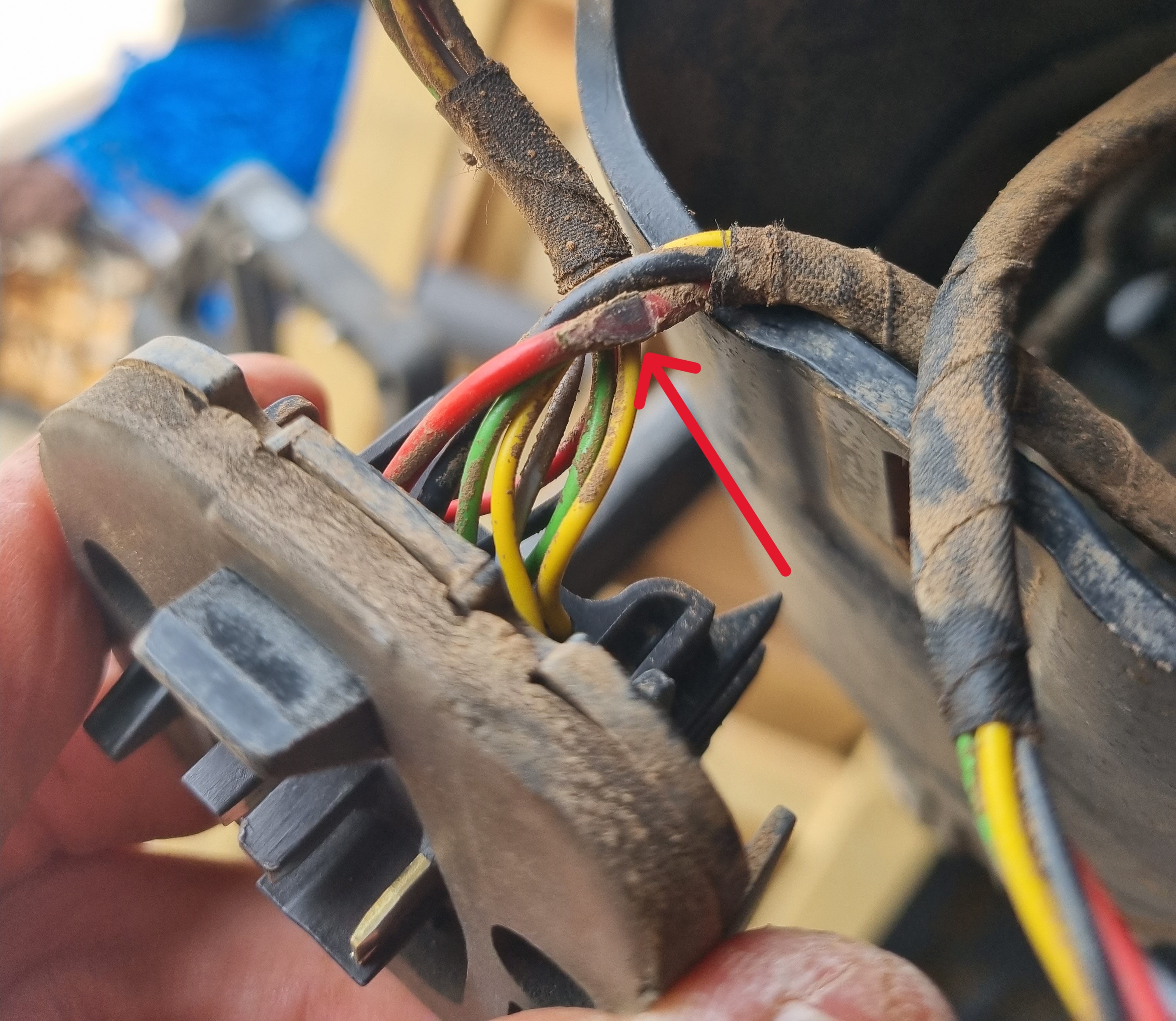

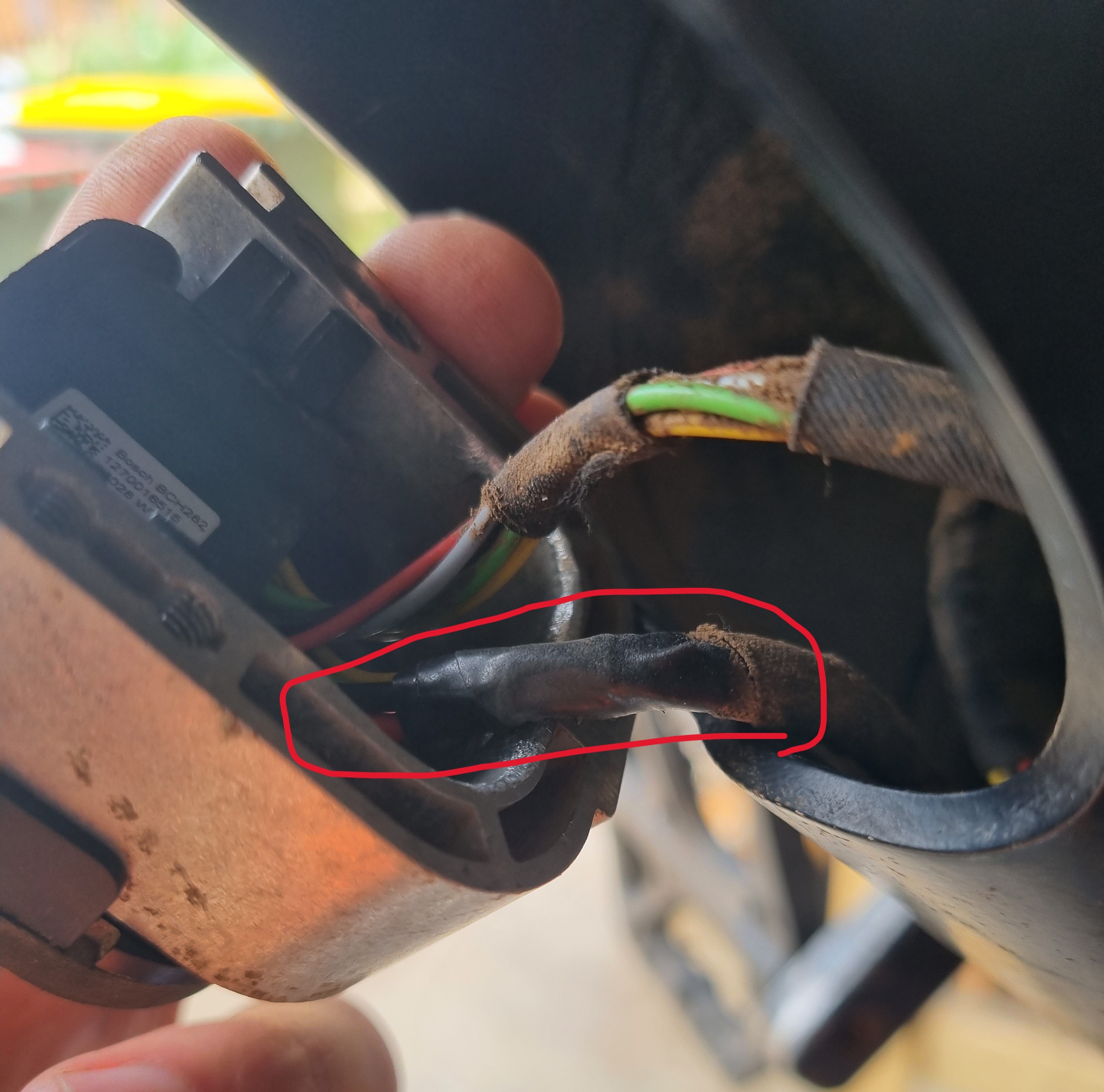

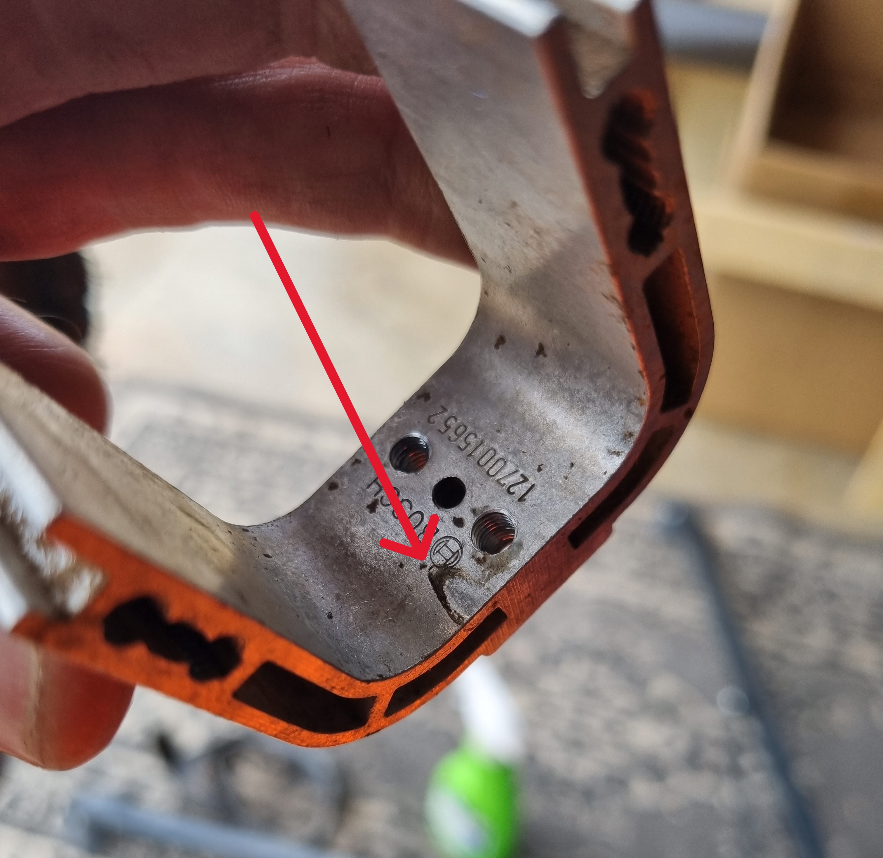

Just as well I went over the whole system though, as I found a power wire was about to short out on the alloy bracket holding the battery connector. I filed off the sharp edge and taped the wires a bit more. Bit of an oversight on Focus Bikes assembly line for that to happen I reckon. Keep an eye out for it!
