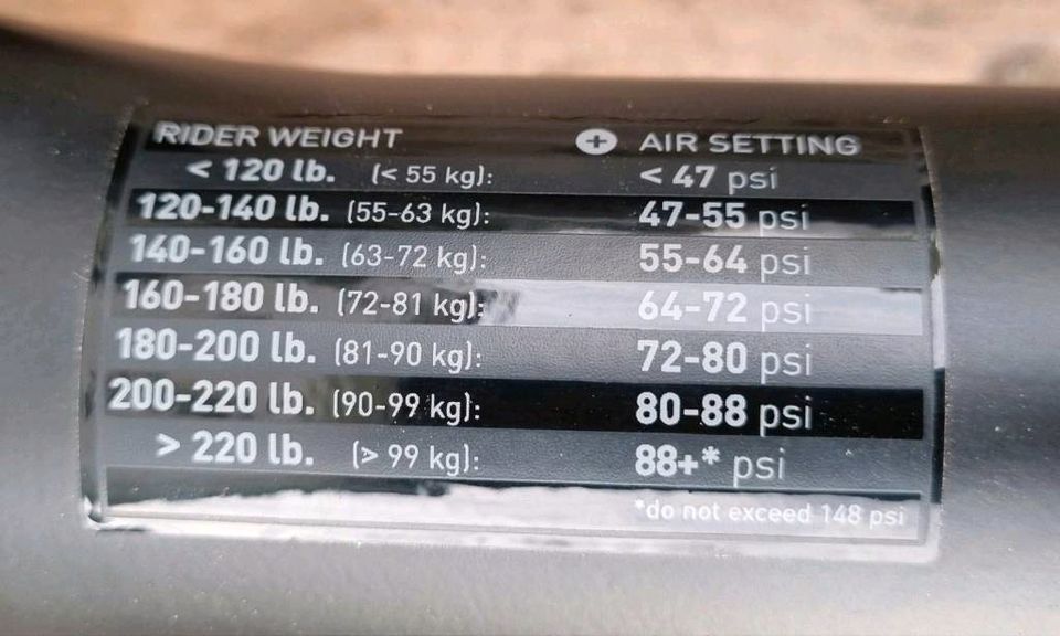

YOu'll be a needing a shock pump if you don't have one BTW, your shocks need enough PSI for your weight
I think all rockshox have the same sticker
Max PSI 148 probably covers most peoples weight that would try riding a bike though.
