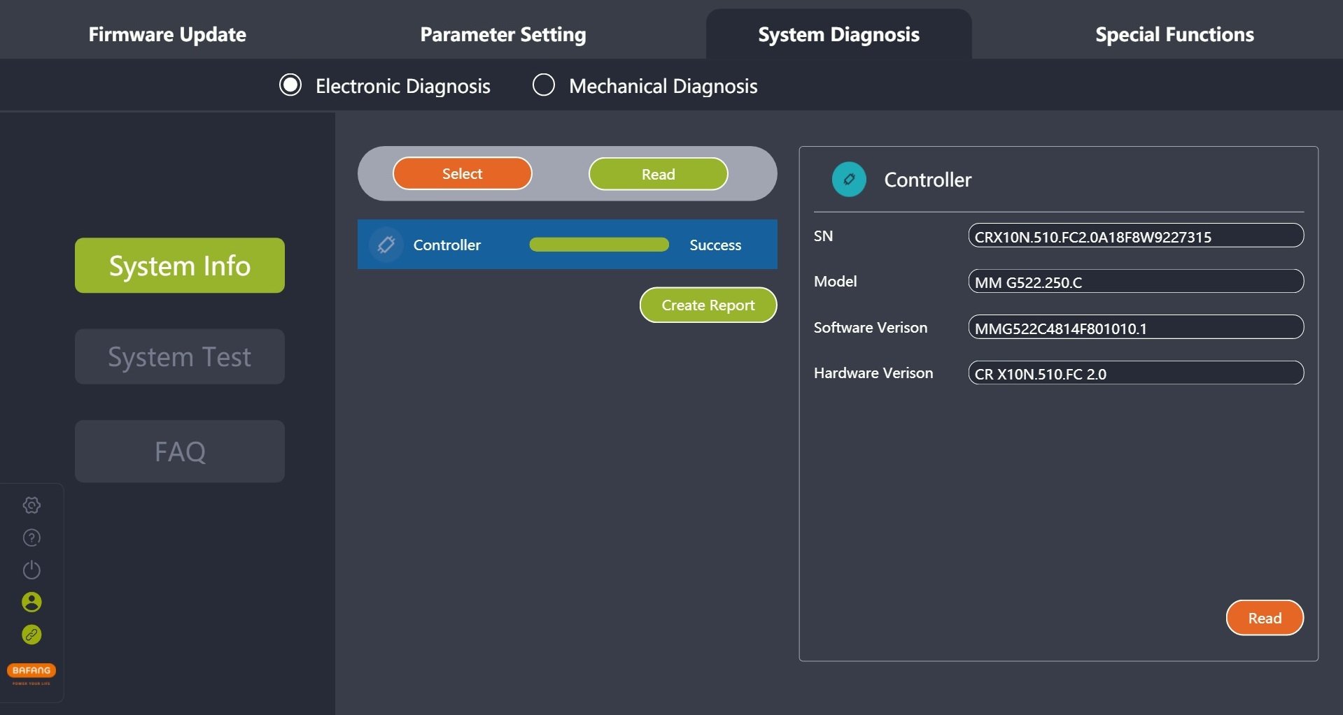

I have new version of M510, it's call FC.2 version. Connect with Besst Tool Pro and it can edit Cycling parameters. And i can feel the different when i changed each parameters. Just for bafang to release Android app for tuning like Shimano EP8.

which nb hardware and software have the controller ?

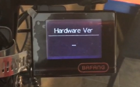

Hello everybody from Quebec city
I have a ebike with Bafang M600
I have the BESST cable interface, the BafangPro software for Mac, Python is install with the script LoginBypass-pro.py
When I try to read, I receive a Failed.....
When I check my setting in the Display C240, the Torque Info Flash... see the pic.
Do I have a problem with the torque sensor ? A Cable not full connected ?? Your diagnose will be appreciate

looks weird, never happened with all bafang motor i had. Try using old besst
Pinkabou
Feb 15, 2023
Québec City
What did you mean by "using old besst" ??
Tomorrow, il will open the motor to see if the the torque sensor is attach to the controller. I saw video about remove, install, and change the controller. The cable for the torque sensor is short..., maybe
Any other idea ?

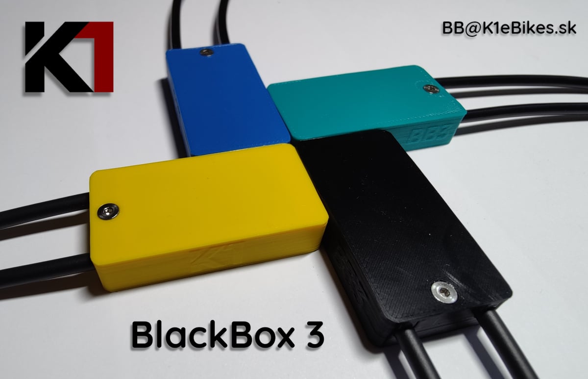

Hello Bafang Ebikers.
New BB3 device if anybody interested. Can set all the parameters of latest M510 FC2.0. All other CAN Bafang motors support still Circumference, Wheel size and Speed limits - you can switch easily by holding PLUS button. Motor Calibration (useful when u change controller), set/reset ODO (only new Bafang DPC254 and later), Info Screen.
Check this interactive Google form, there are useful tips, videos, pictures, initial/default BB3 setup and how to order
