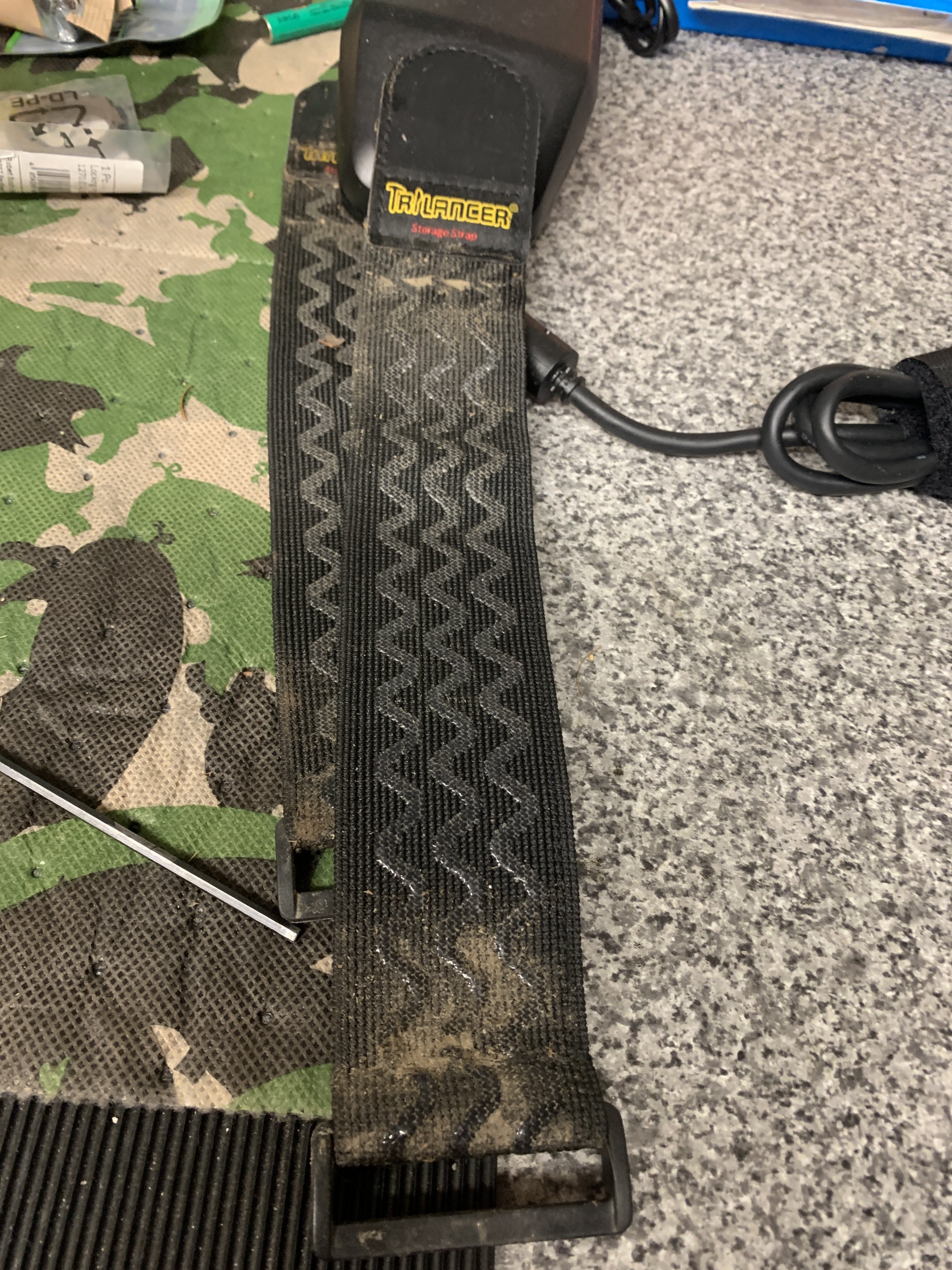

These are what I use, they have no stretch so hold everything very securely, I use a small piece of rubber under the buckle to stop it scratching the frame
I have the 50mm X 400mm

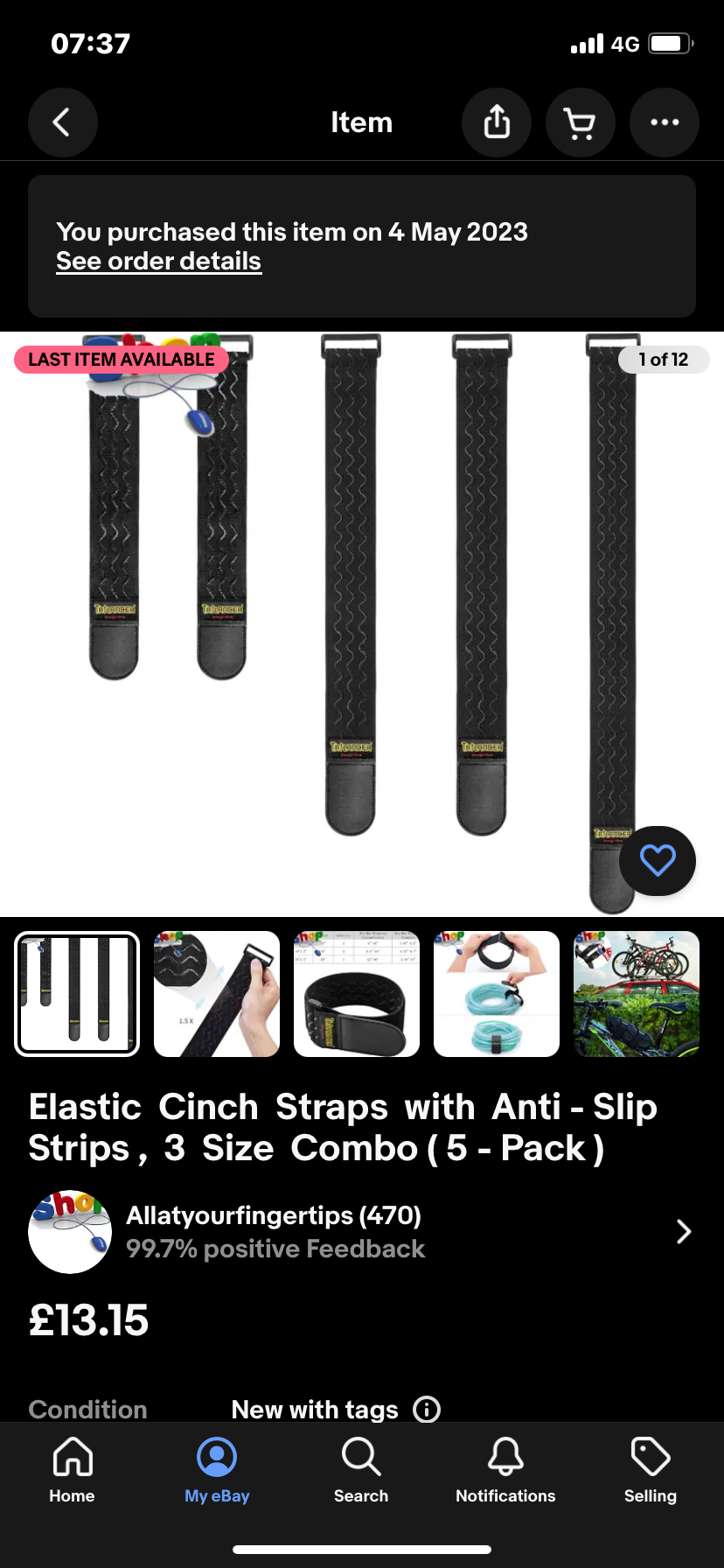

Just for completeness.... i ended up ordering these Trilancer Straps They arrived today and seem to be a perfect fit for my Cube. I just need to test them ASAP. I can think of a few other uses for them as well including helping with additional security in attaching bike to towball bike rack (Buzz Rack E-Hornet 2).
