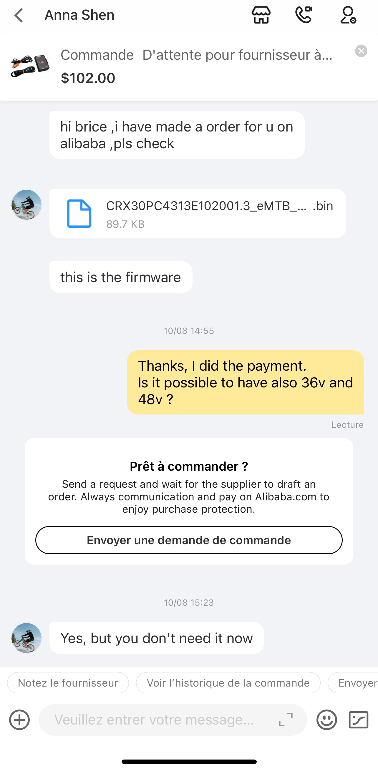

Bafang M820 Firmware thread
brbr
Dec 28, 2022
467
250
France
If some of you need a « proof » 😀
