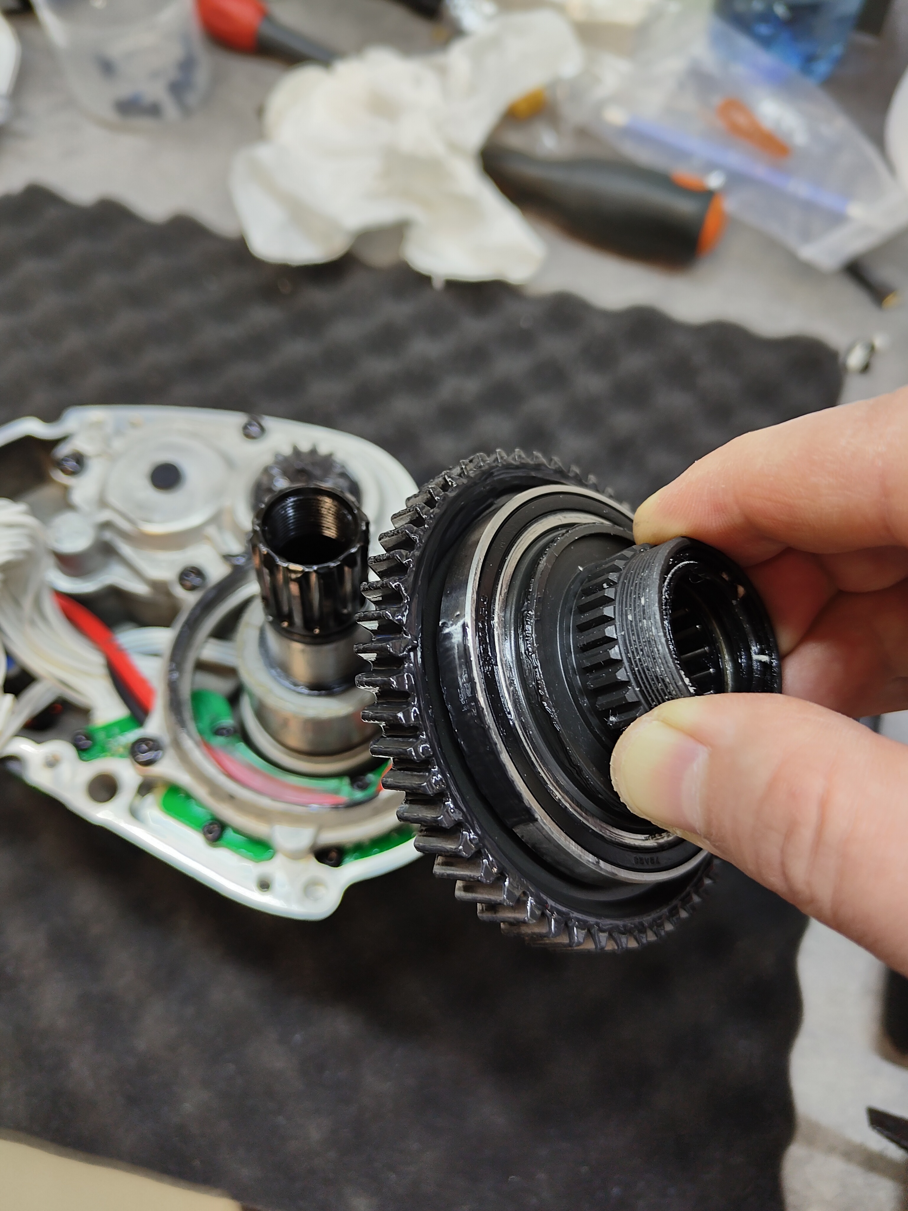

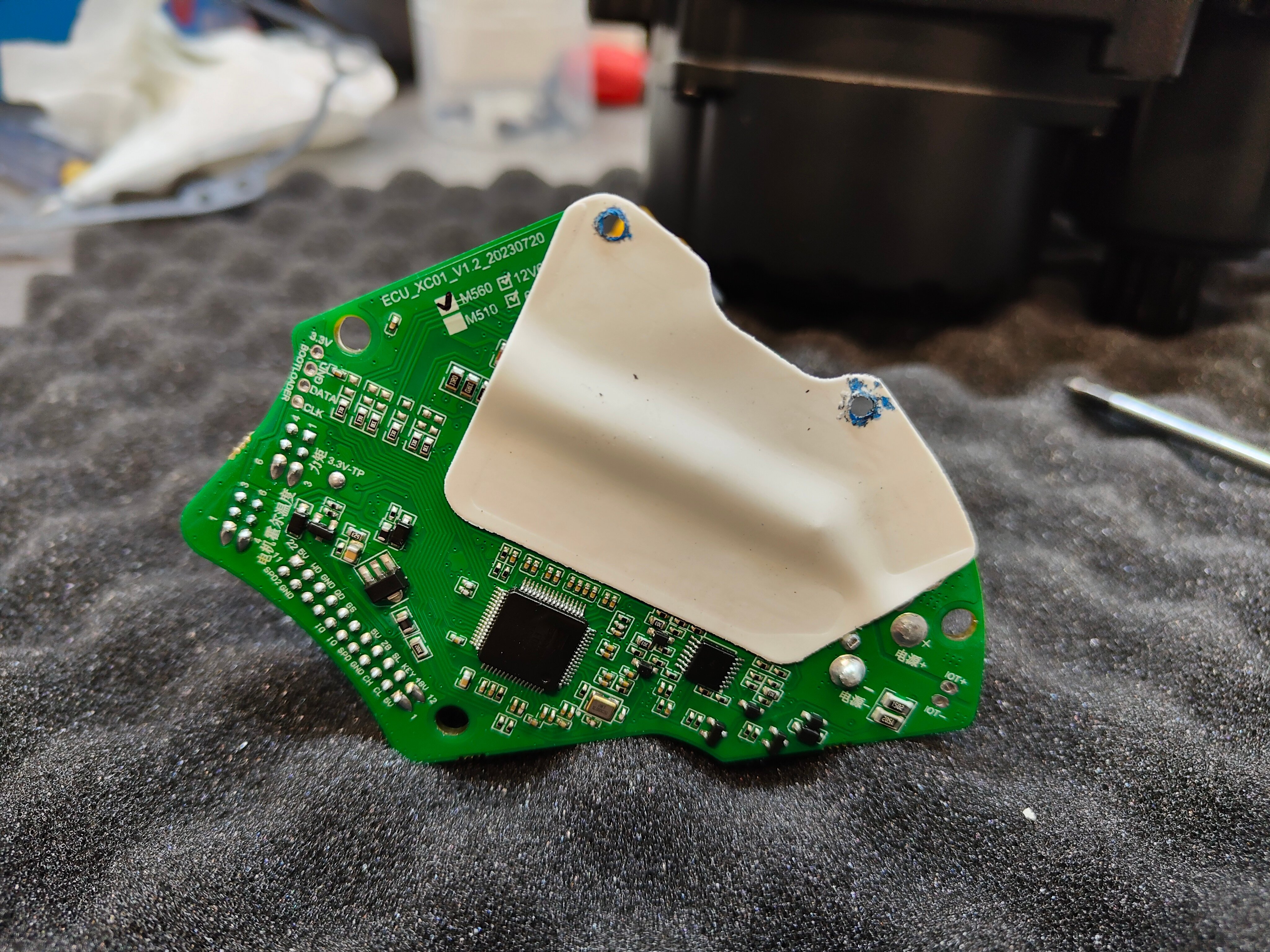

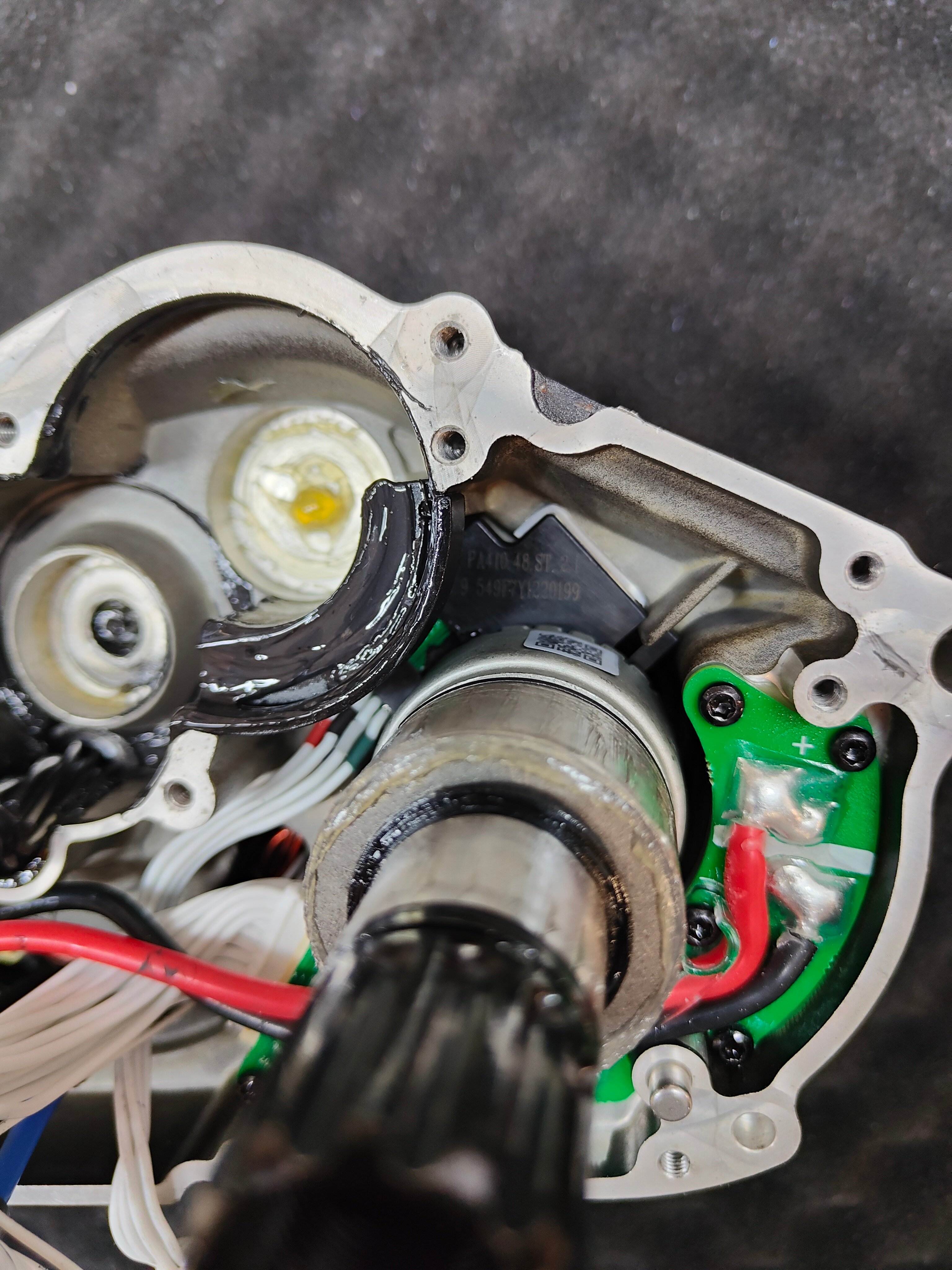

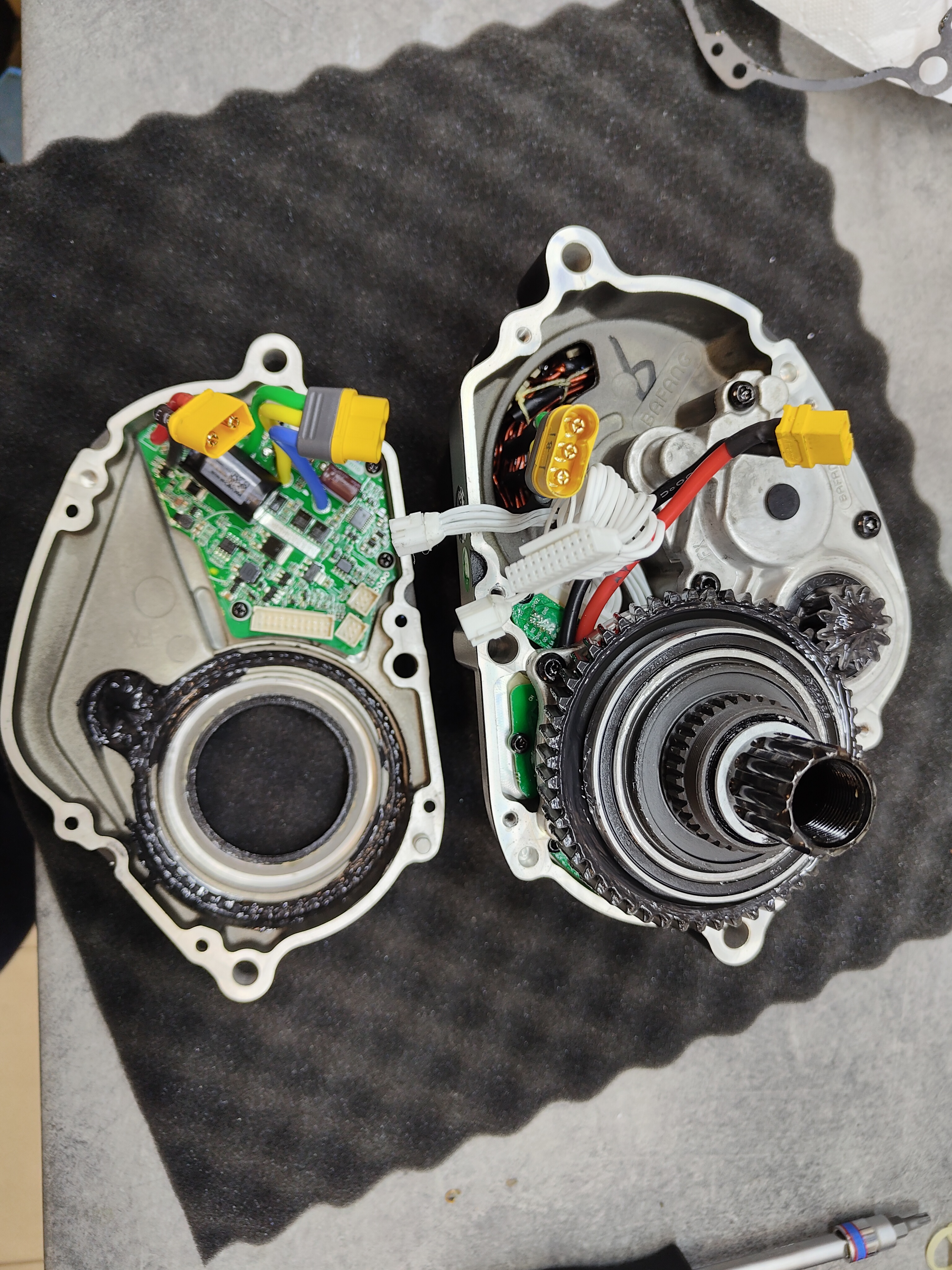

Looks pretty much identical to the previous M510/M560 controllers. Mostlikely only firmware and maybe some internal changes of the gearing.
Who are these images from, if you do not make them?
This controller photo is taken by me. The controller is from my m560 engine, updated version from early 2024. Now another version has come out and I posted a photo of the sticker sent by a seller from China.

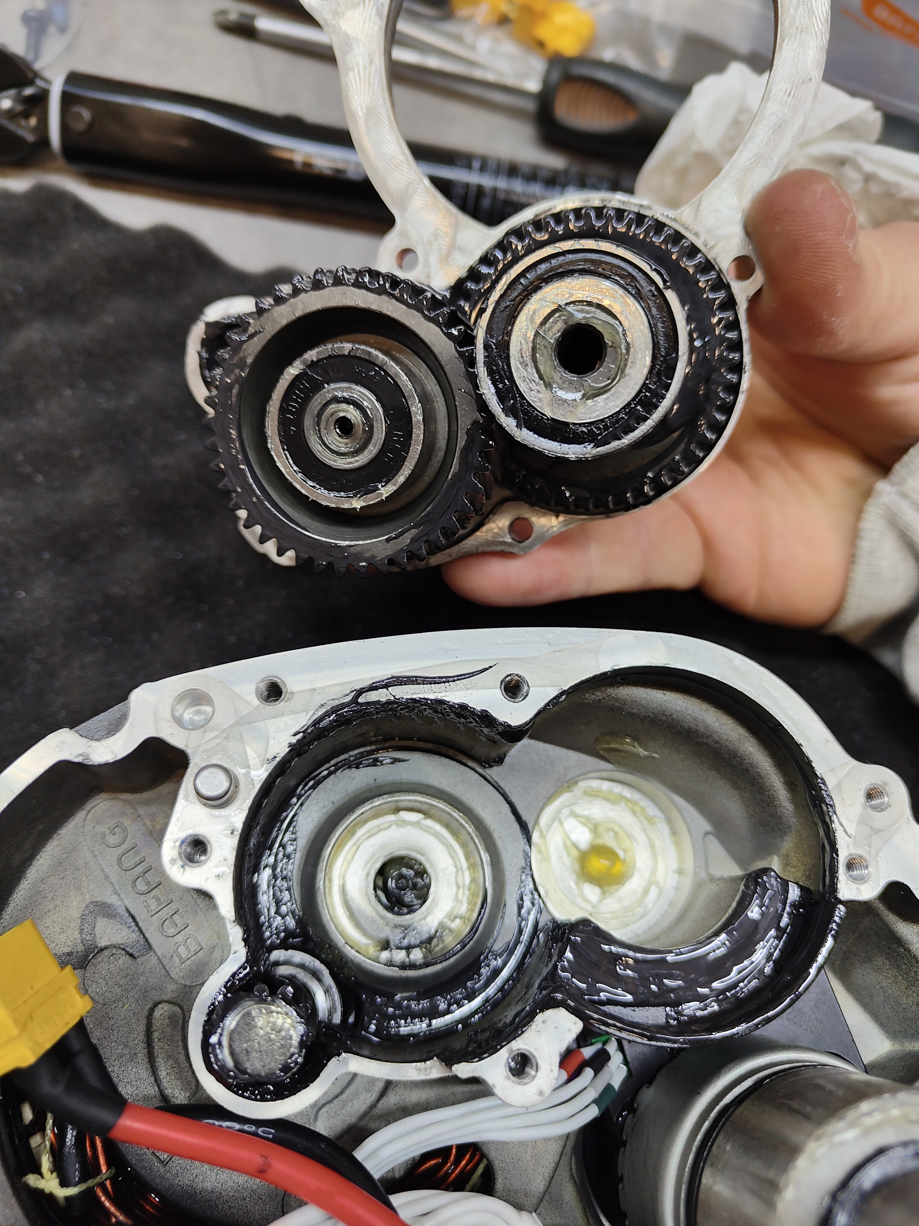

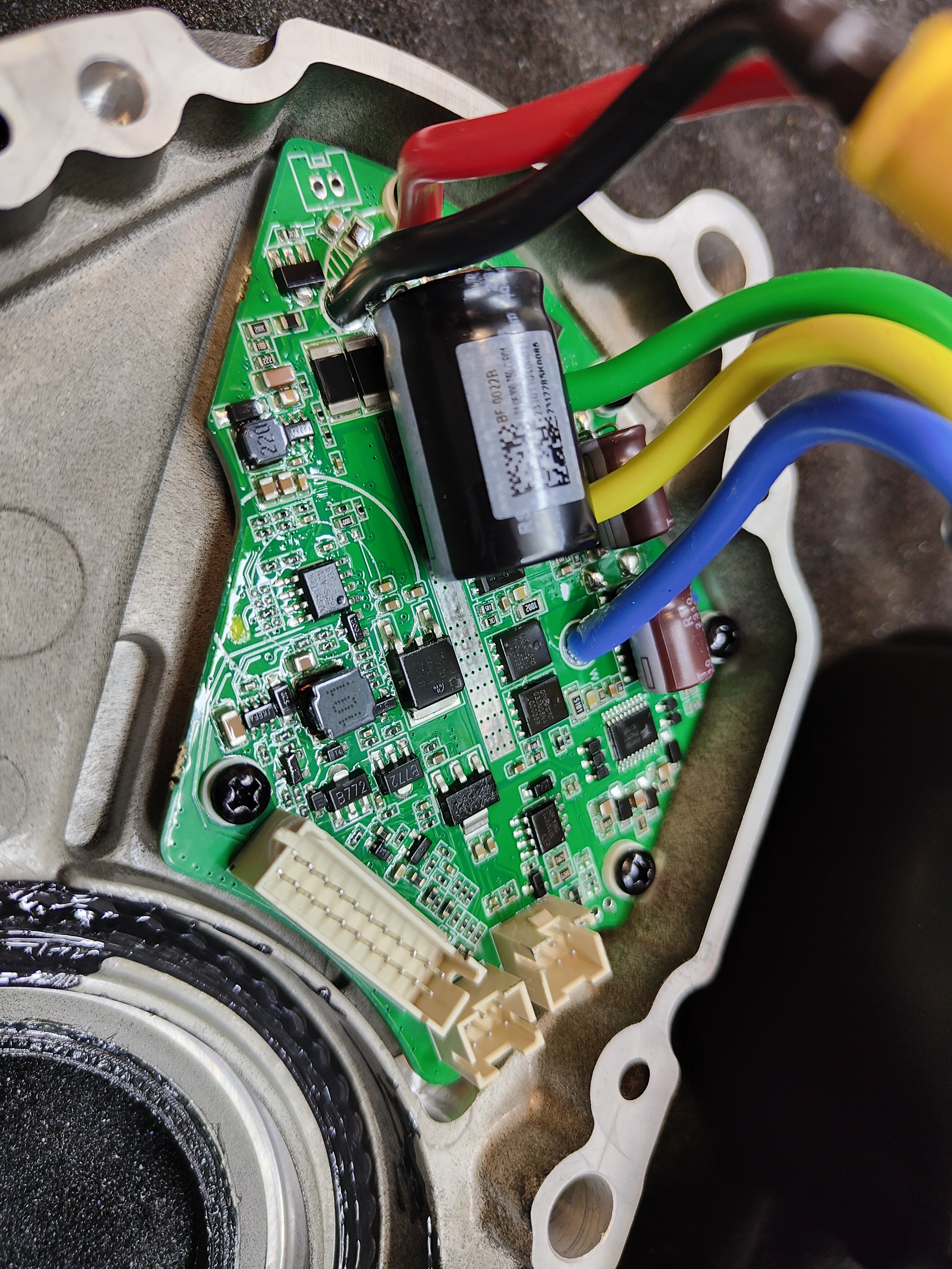

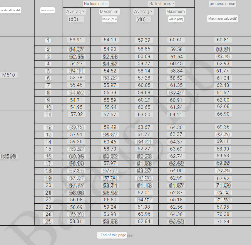

Hello everyone. I received my m560 engine, 750W version. The first quick test on the table and it turns out that it is not that loud at all. Of course, it is not as quiet as the m600 and will not be due to the use of a steel gear. After disassembling it, it turns out that there is a controller with the new marking M560. As for the grease, it is also good - the grease is well distributed everywhere and there is the right amount of it, unlike in the case of my m620 where there was very little grease. The engine will be mounted in a Dengu E82 frame with a 48V 1008Wh battery. Unfortunately, I'm still waiting for the frame and battery.
Controller info:
Hardware version: MM G5300.750.C 1.0
Software version: MMG5300C4825F801001.4
Link to video:
m560 test
Test from 10 cm distance:
Test from 50 cm distance:
Test from 100 cm distance:

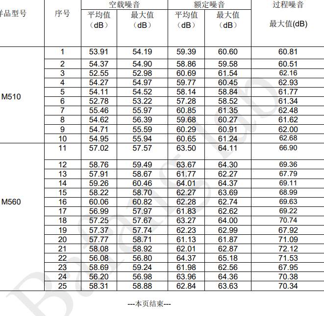

Hi, I was wondering if the nylon gear for the M600 fits on the M560 for noise reduction. The motor is really noisy under load and at high rpm speed: https://www.google.com/search?q=BAFANG+M500+M510+M600+Motor+Nylon+Gear&oq=BAFANG+M500+M510+M600+Motor+Nylon+Gear&gs_lcrp=EgZjaHJvbWUyBggAEEUYOTIKCAEQABiABBiiBDIKCAIQABiABBiiBDIKCAMQABiABBiiBDIKCAQQABiABBiiBDIKCAUQABiABBiiBDIGCAYQRRg9MgYIBxBFGD3SAQczMjJqMGo0qAIAsAIB&sourceid=chrome&ie=UTF-8

Ok thank you! So i temporarily switch from M560 to M600 until nylon gear will be available. The loud noise of M560 is really terrible.
The noise is annoying when driving on a flat road. On a rocky road, the noise is no longer very audible

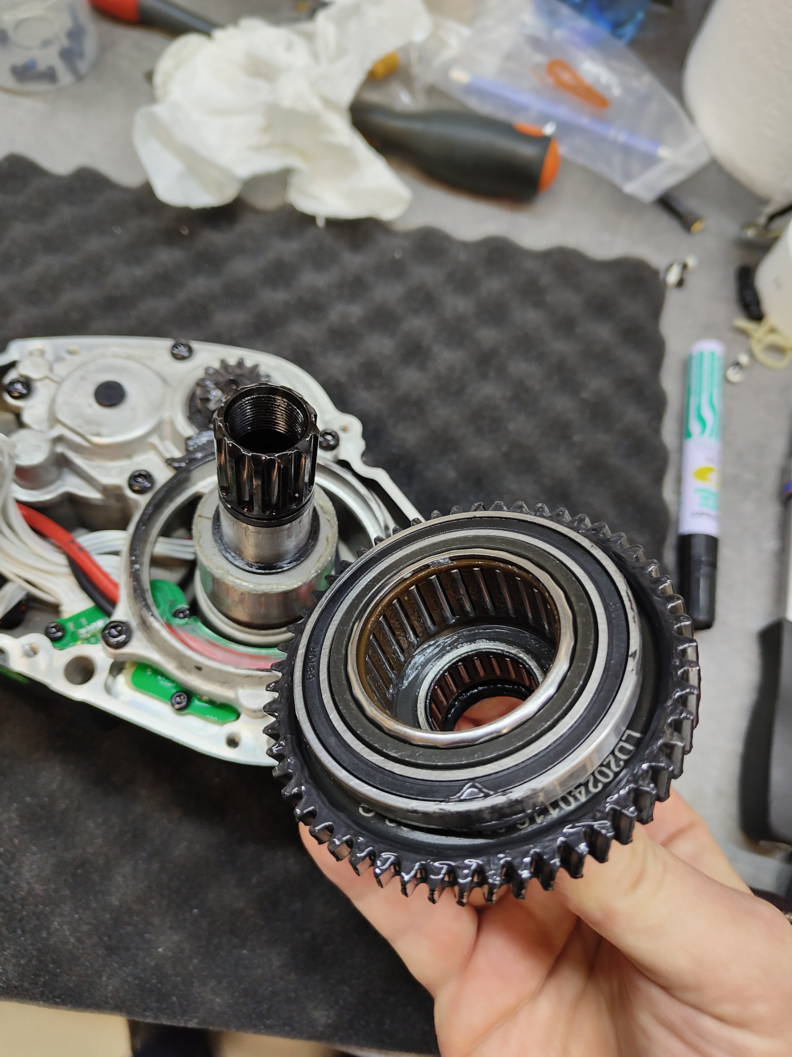

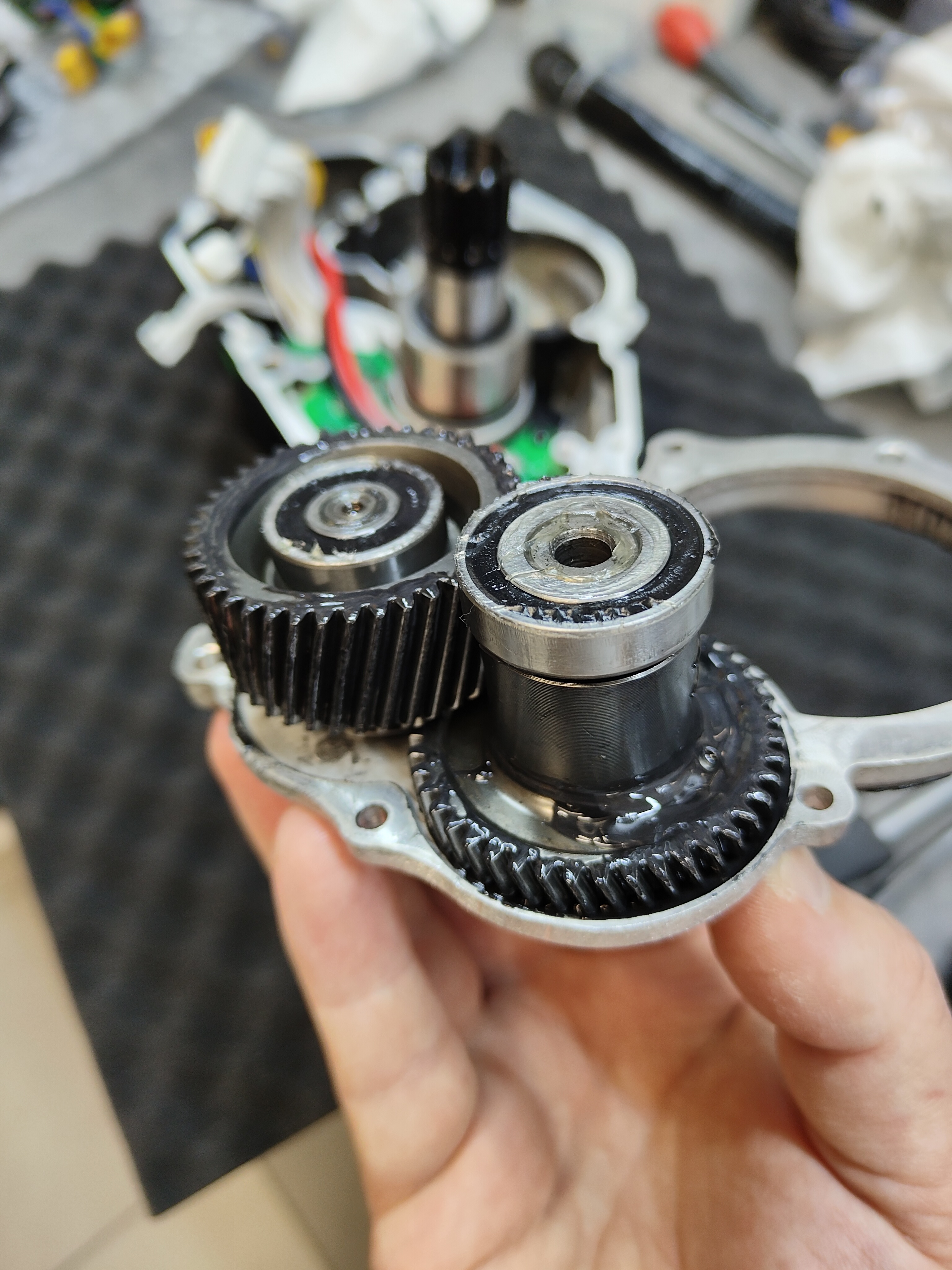

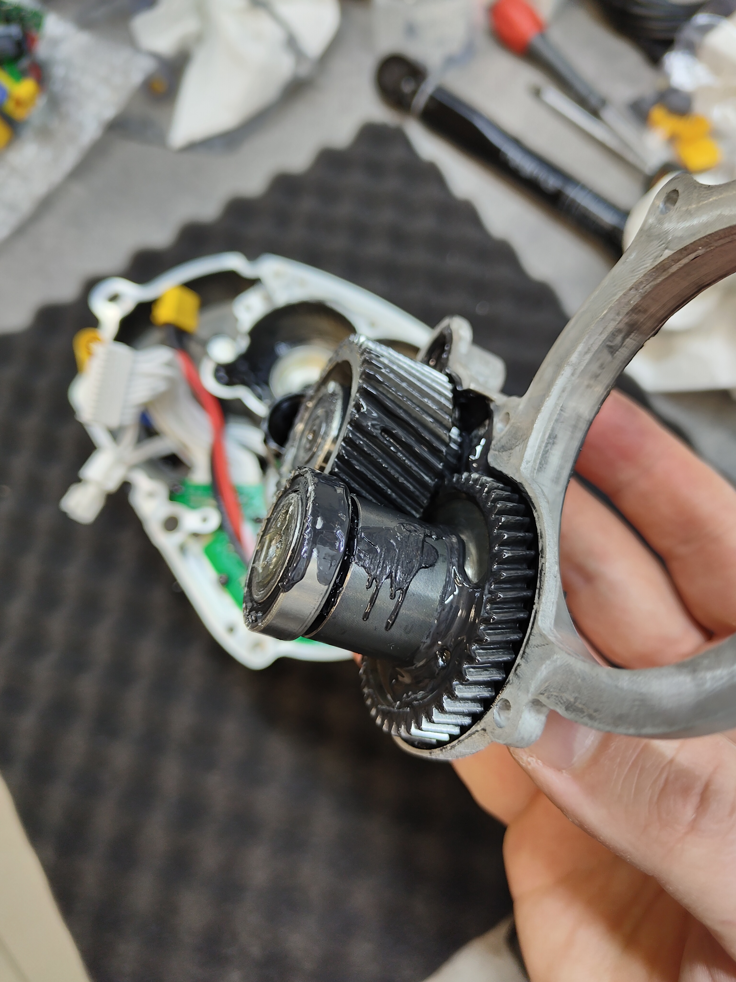

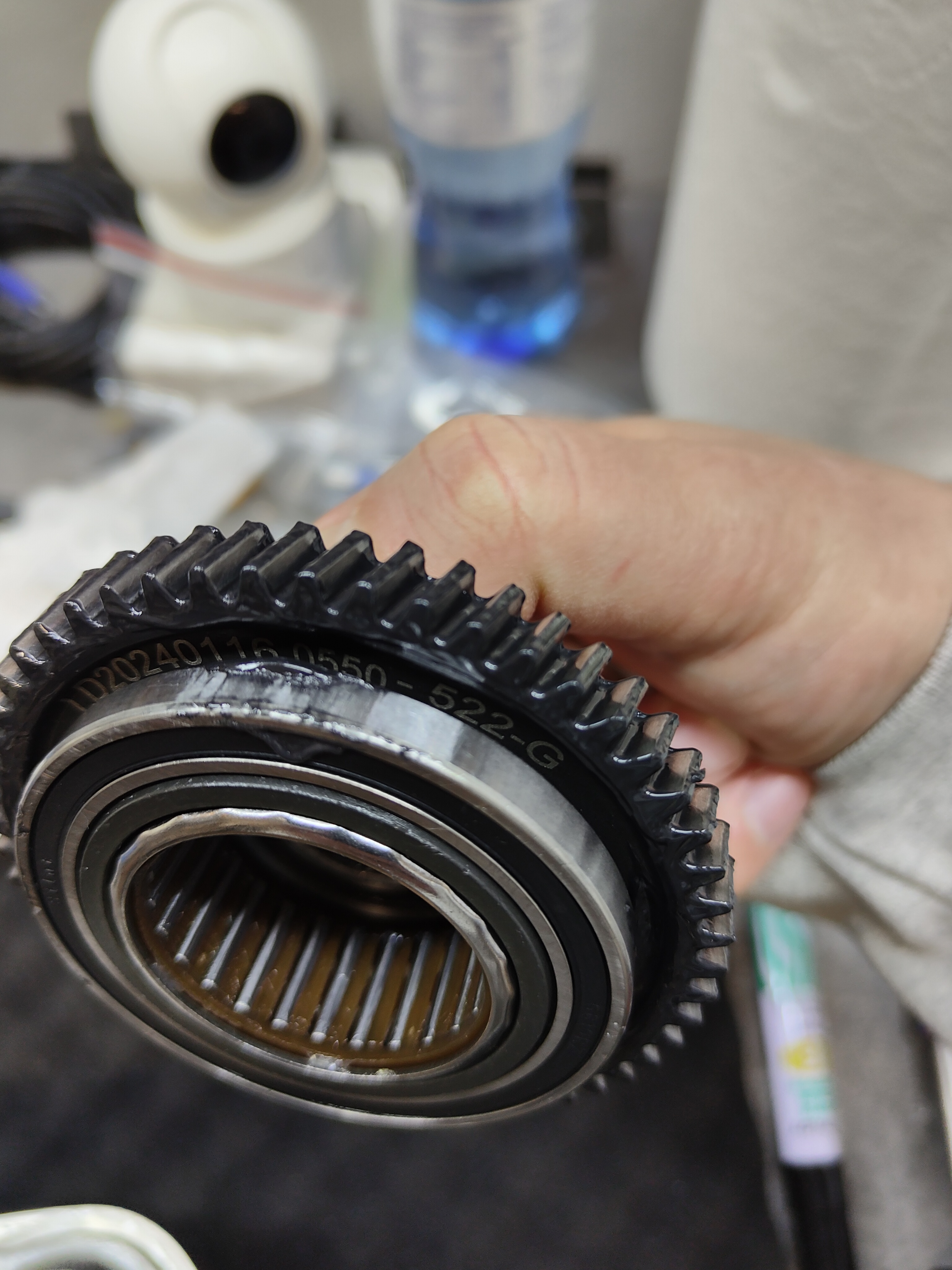

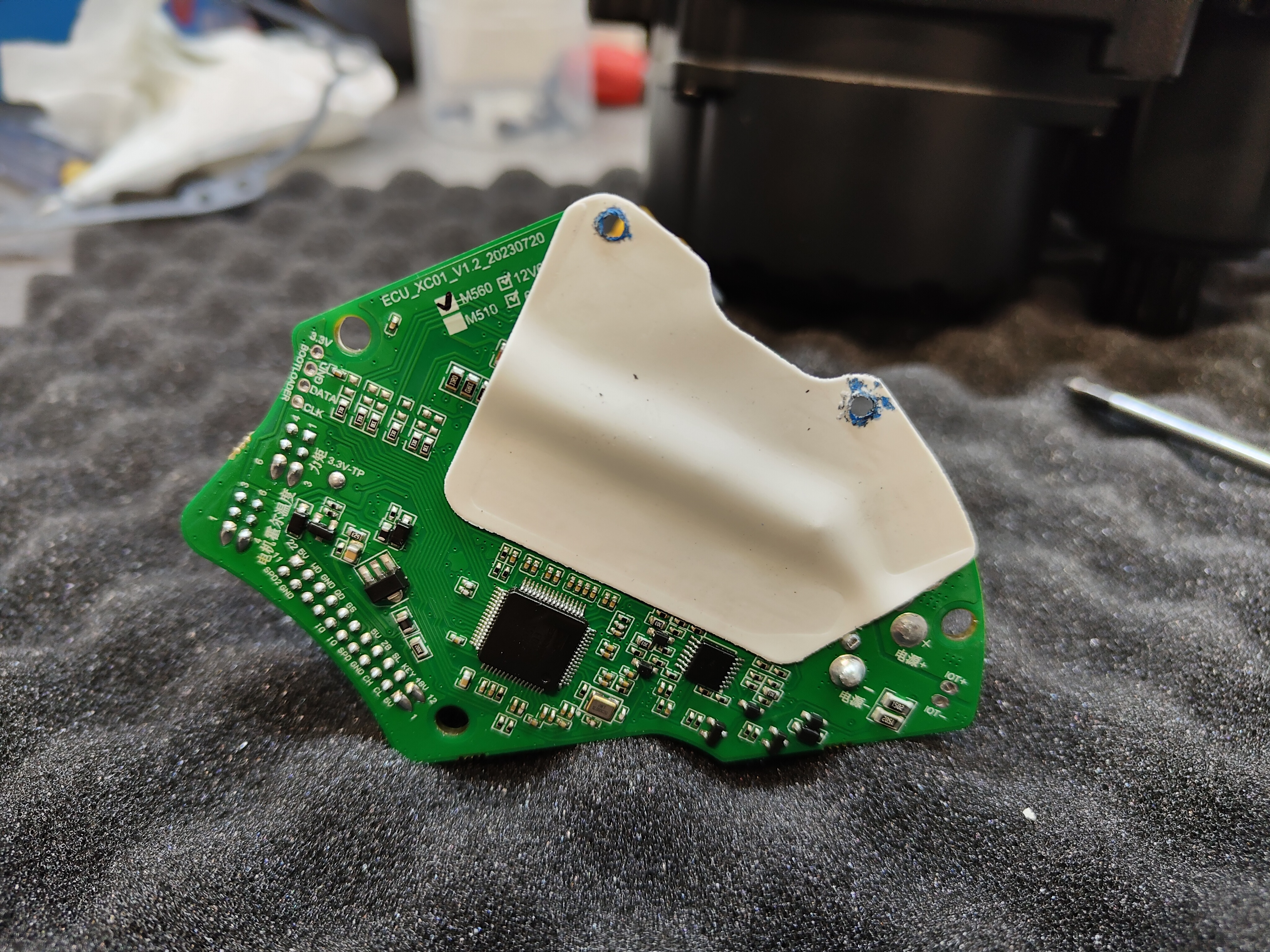

From what I can tell so far: Looks pretty much the same. Can you send images from the downside of the controller? Be carefull to not rip the cooling paste-pad appart. There is something like ECU_M560_BAFANG_.....
Also you need to count the gears. I did that on mine and placed it in my Mxxx sheet.
