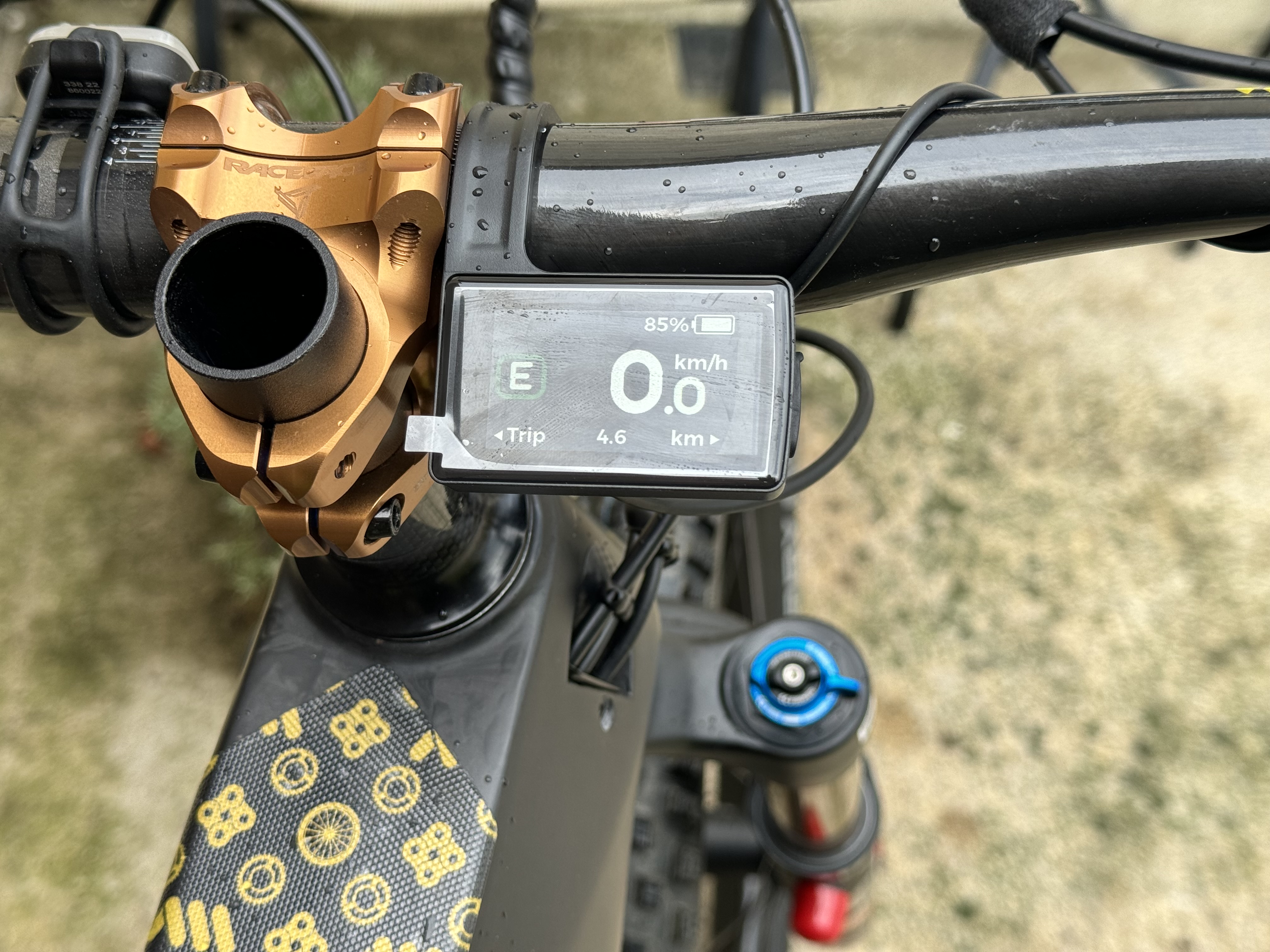

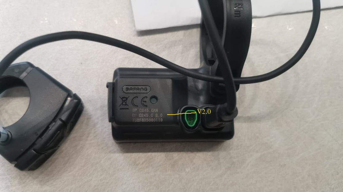

Could you post a photo of the back of the display I want to compare to LAnton's photo

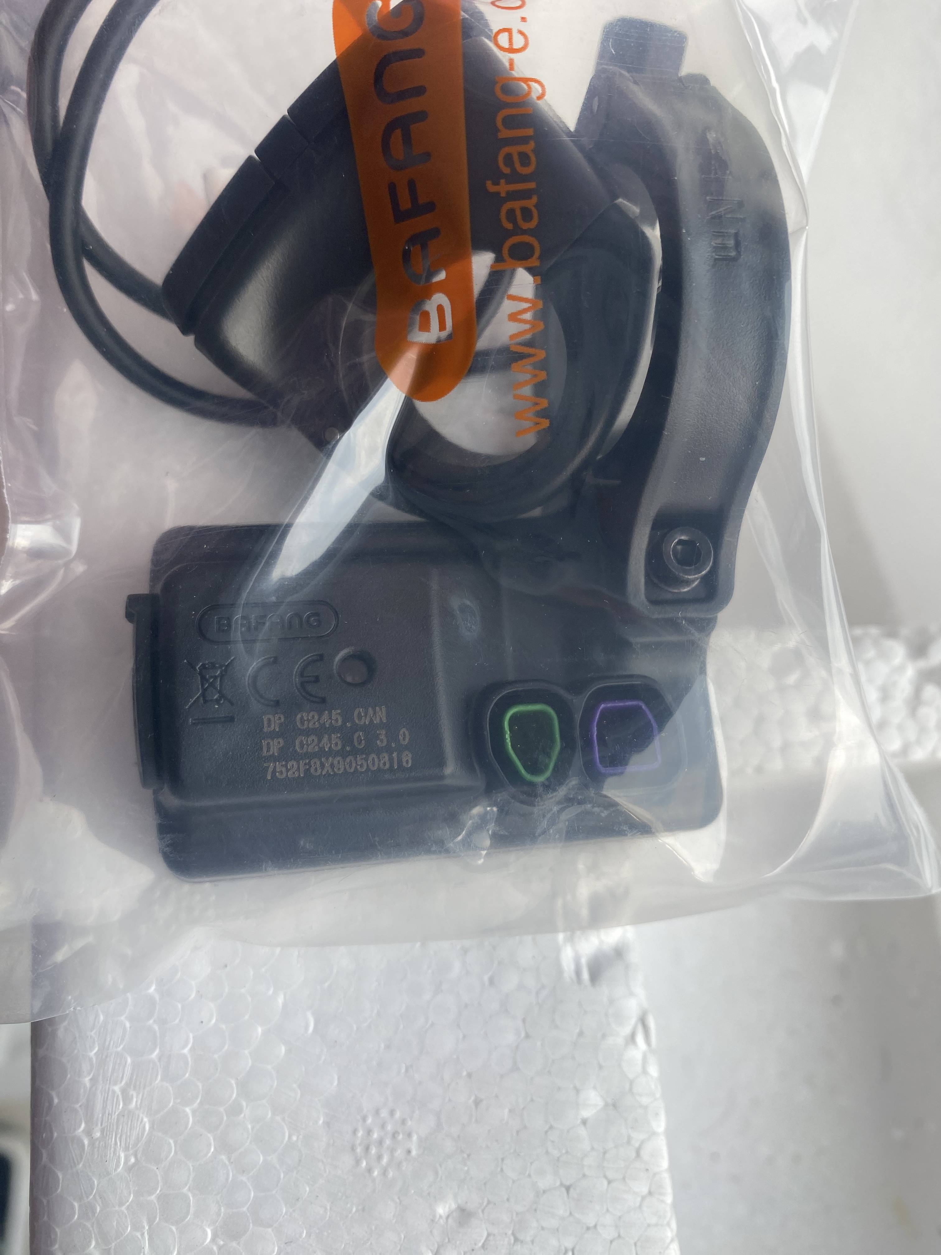

Dear Mike,
Yes, DPC245 is 2.0 version, it only fit go, can not fit go+, version 3.0 is better. We keep asking bafang to offer the 3.0 version, but bafang do not start mass production for 3.0 version, and in the marker, there just only some version 3.0 samples, we can get version around Aug, thank you very much.

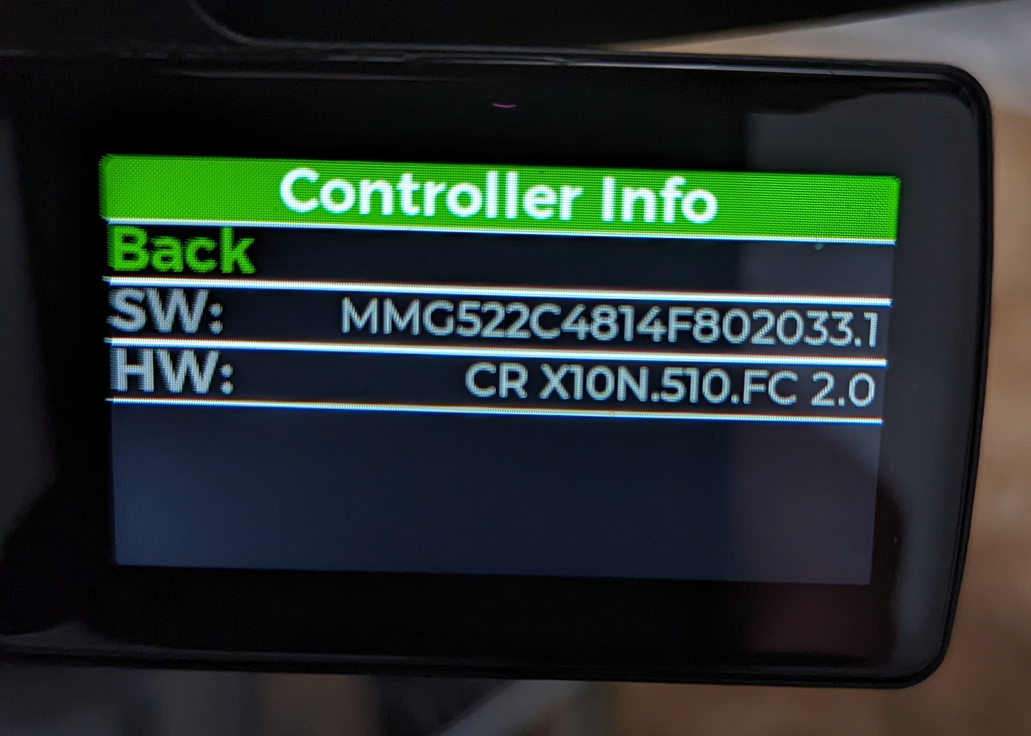

Bafang M510 FC 2.0 with DP C245 Display. I am able to access the Options:

on off issue is common problem for FC 1.0 controller version, so the solution is change the controller to FC 2.0.

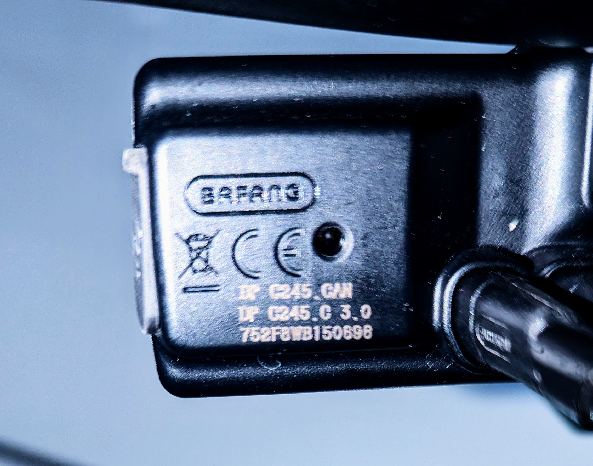

Only DP C245 3.0 bluetooth 5.1 can connect to Go+ App

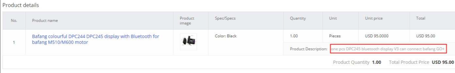

Have you found anyone selling the DP C245 Ver 3? The Aliexpress ads for the C245 which mention Go+ in their ad are not Ver 3 and hence do not support Go+. How do i know this? I bought one.
