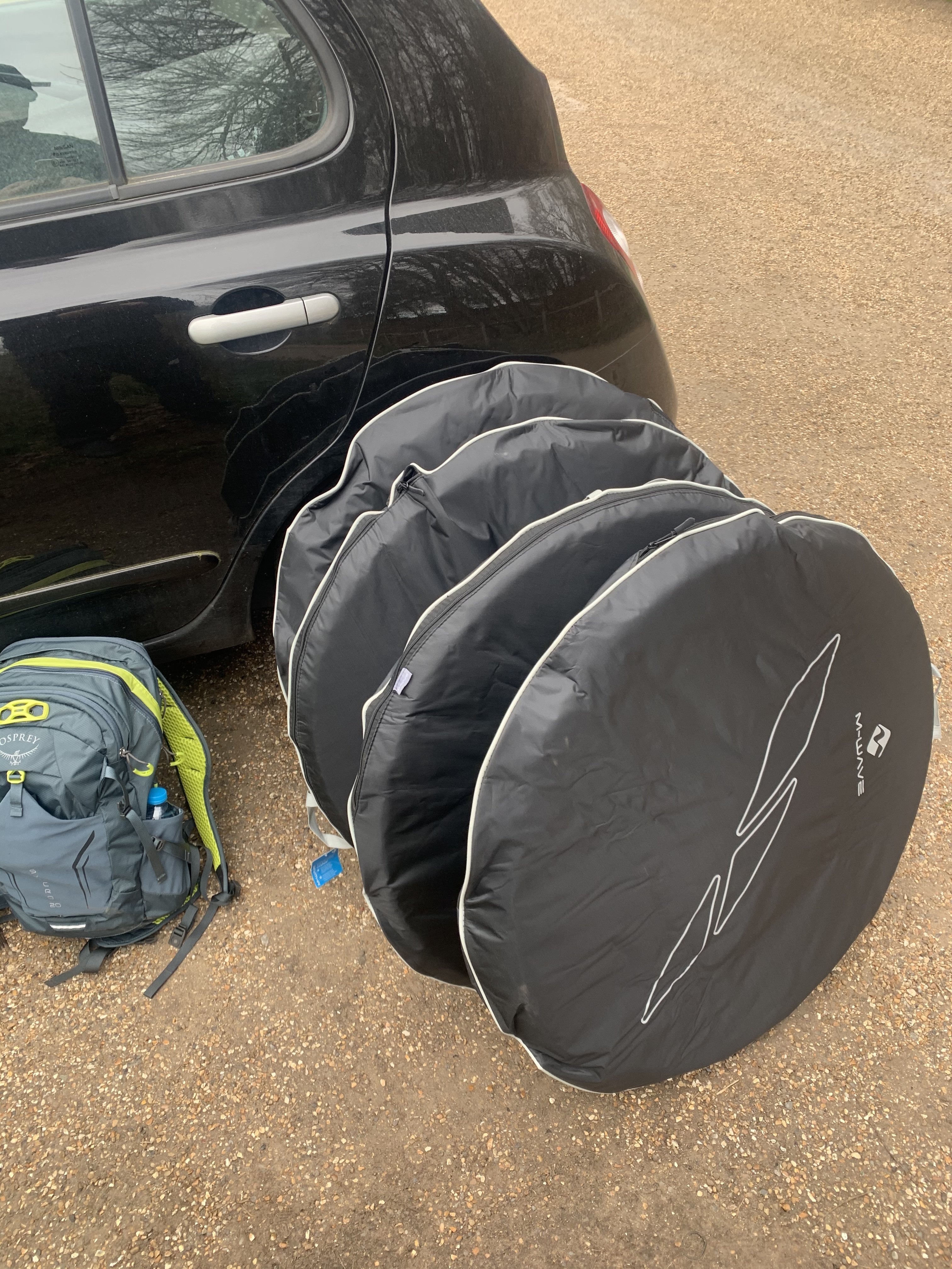

This came up last winter when we were about to drive home from Lakes with bikes on back of car (Thule tow-ball rack).
Anyone who says the bikes don't get a soaking has never driven far in wet uk conditions.
Both bikes were clean prior to setting off , but filthy and covered in muck at the end of 6 hour journey.
Lakeland Bike shop said to me before departing, you need to protect the bikes ( especially the motor and battery and internal cable routing points) from rain which could cause damage.
So, we wrapped around those parts with cling film and taped over, but it just unwraps within an hour or so of motorway speed driving .....
So, when we got back, I did some online resarch. Found a Latvian firm that make MTB (& road bike) bike covers - water resistant, not waterproof. But they should stop rain being driven into "sealed" bearings etc and also keep road muck off bikes, derailleurs, chains etc. Covers are washable and not too expensive.
Amazon even offer them now
I have no connection with Velosock whatsoever.
Wonder how many people who have had motor bearing problems take care to protect their bikes?
Riding at 20kph, even through deep water, is not the same as having heavy spray hitting bike at 70 mph.

Look at, www.velosock.com
I've seen those. Seems like it would put a truly enormous load on both the bike and carrier? It's effectively a couple of 2m^2 sails hung on the back of the car. Do you have any concerns about the bikes being ripped off the rack? I had a massive gust of wind rip a correctly mounted roof rack off years ago, and that was just a single bike mounted transversely, no cover. The rail clamps went through the paint to the metal and dented the edge of the roof.
What does it do to your fuel economy? What's the max cruise speed?
