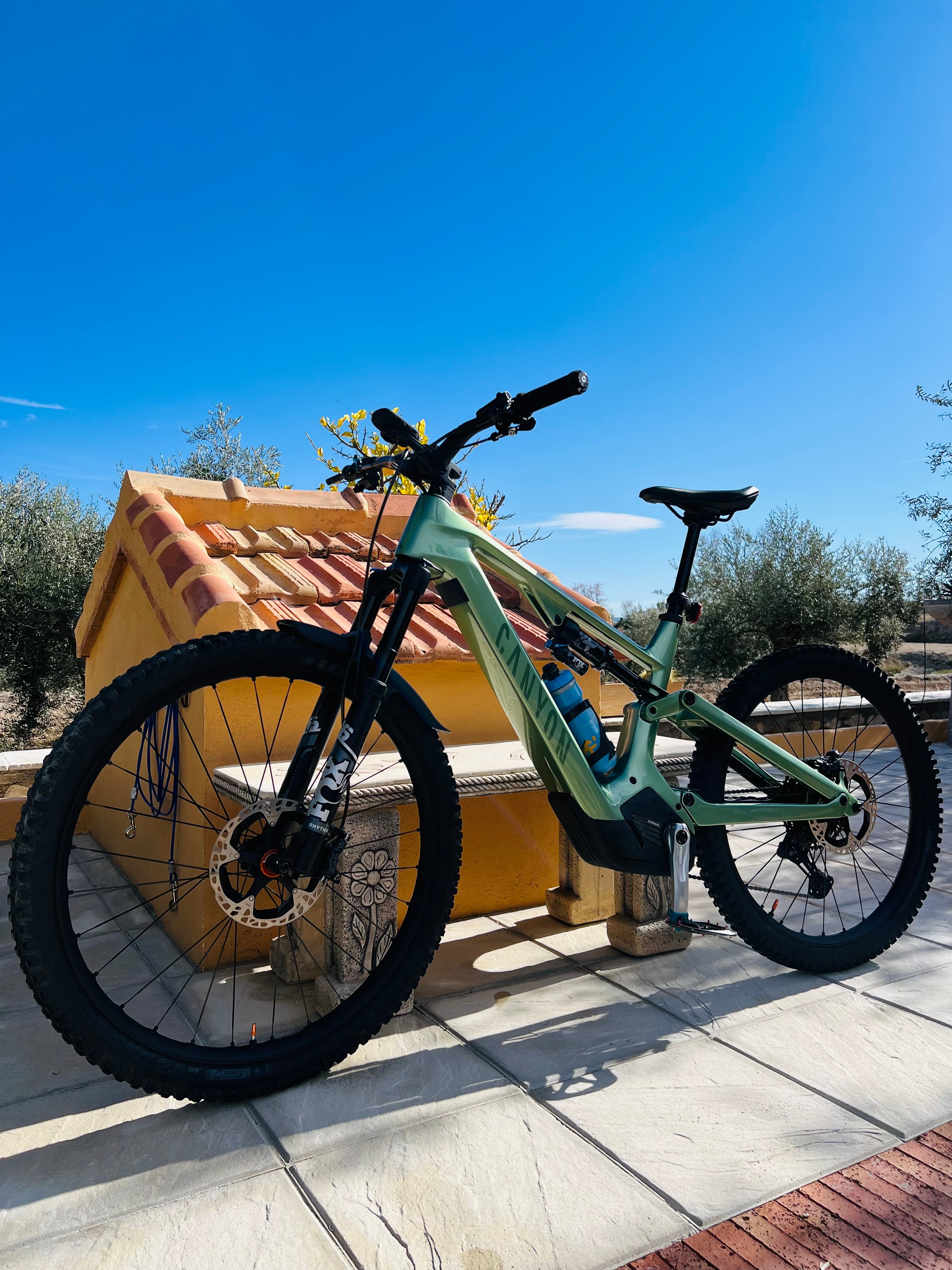

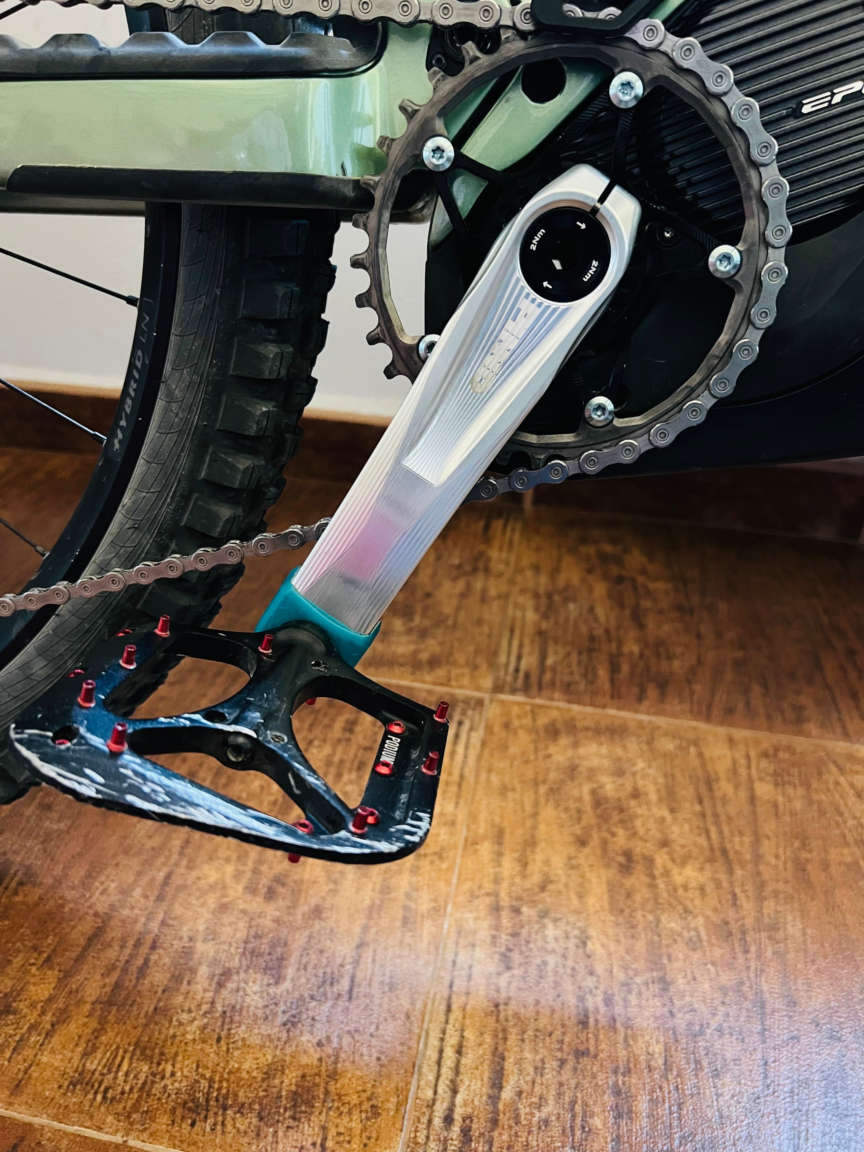

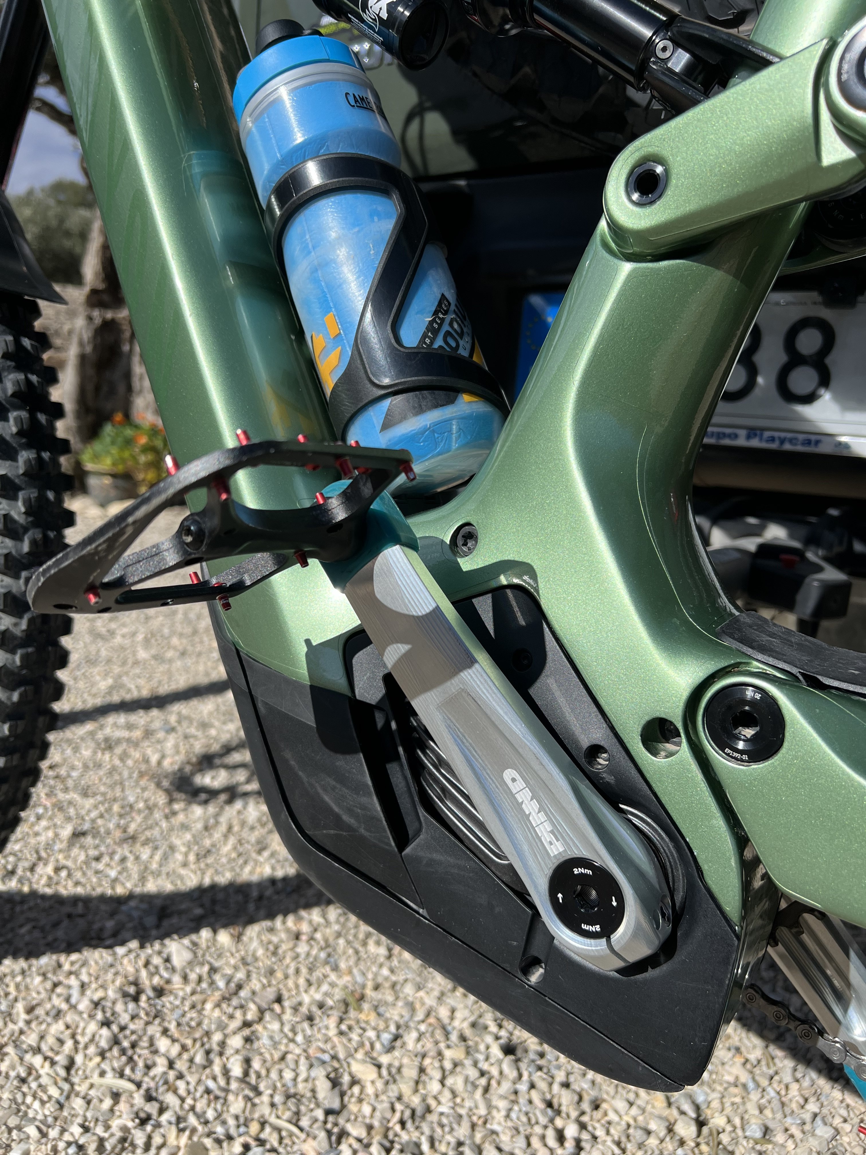

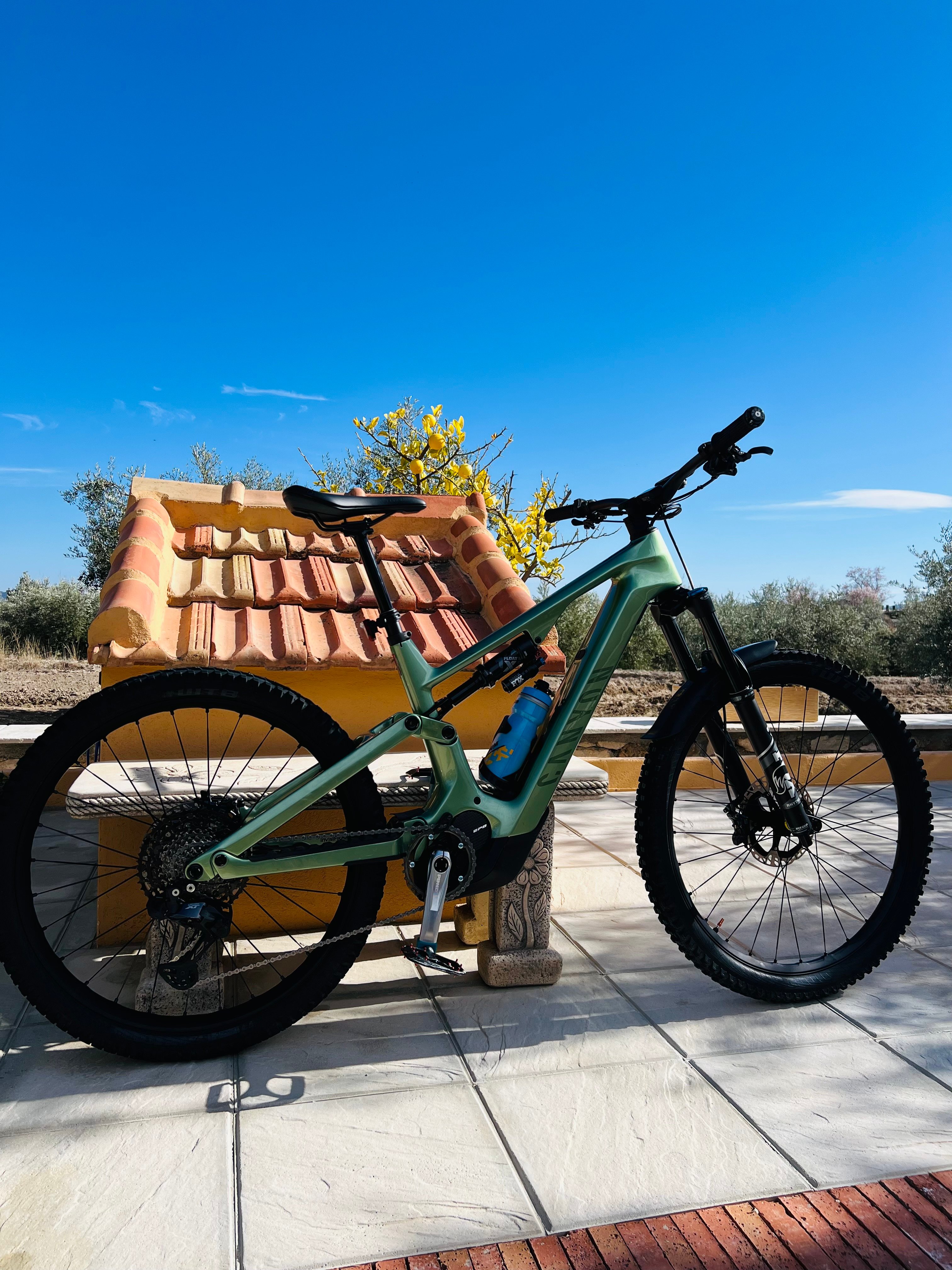

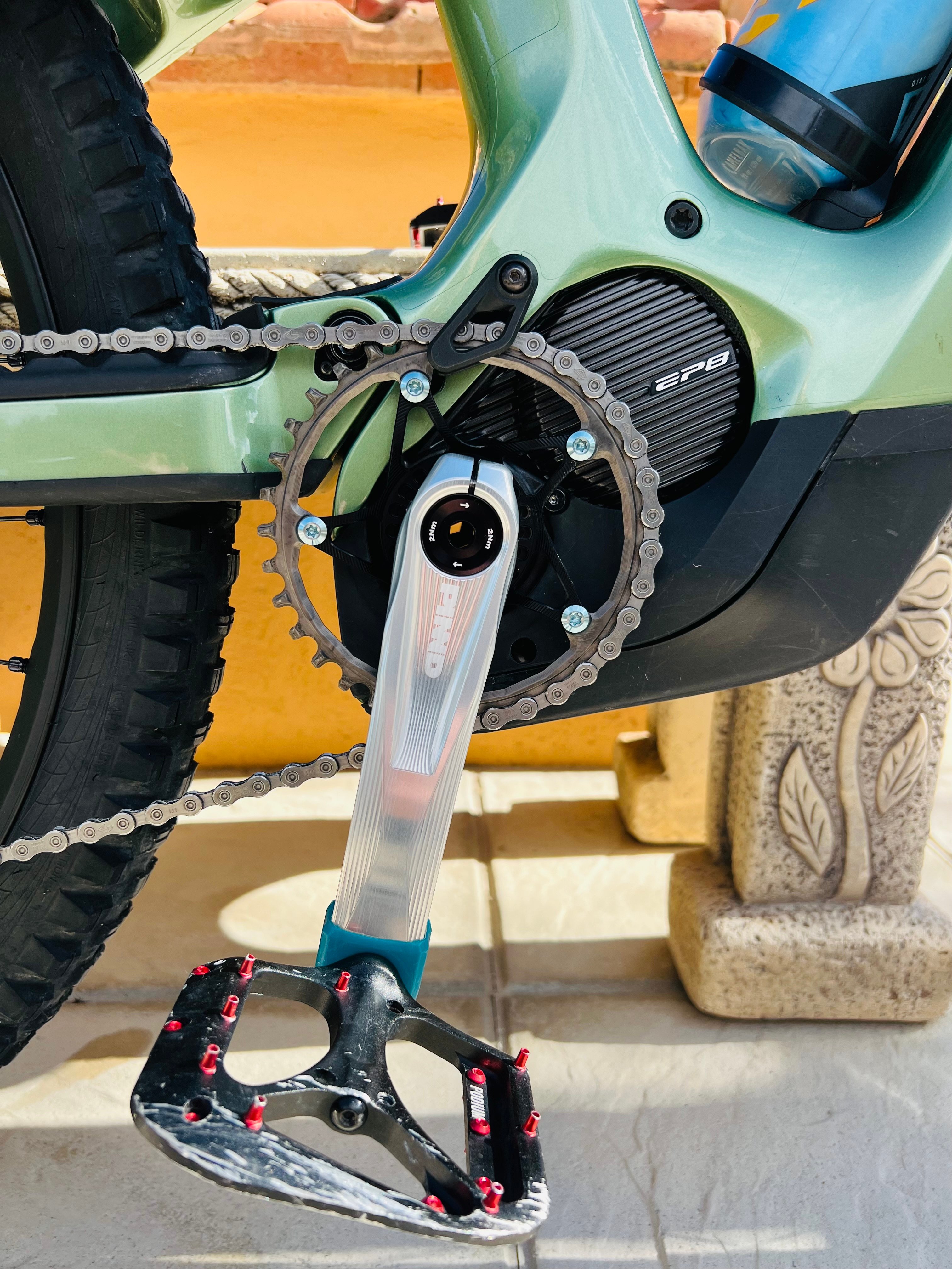

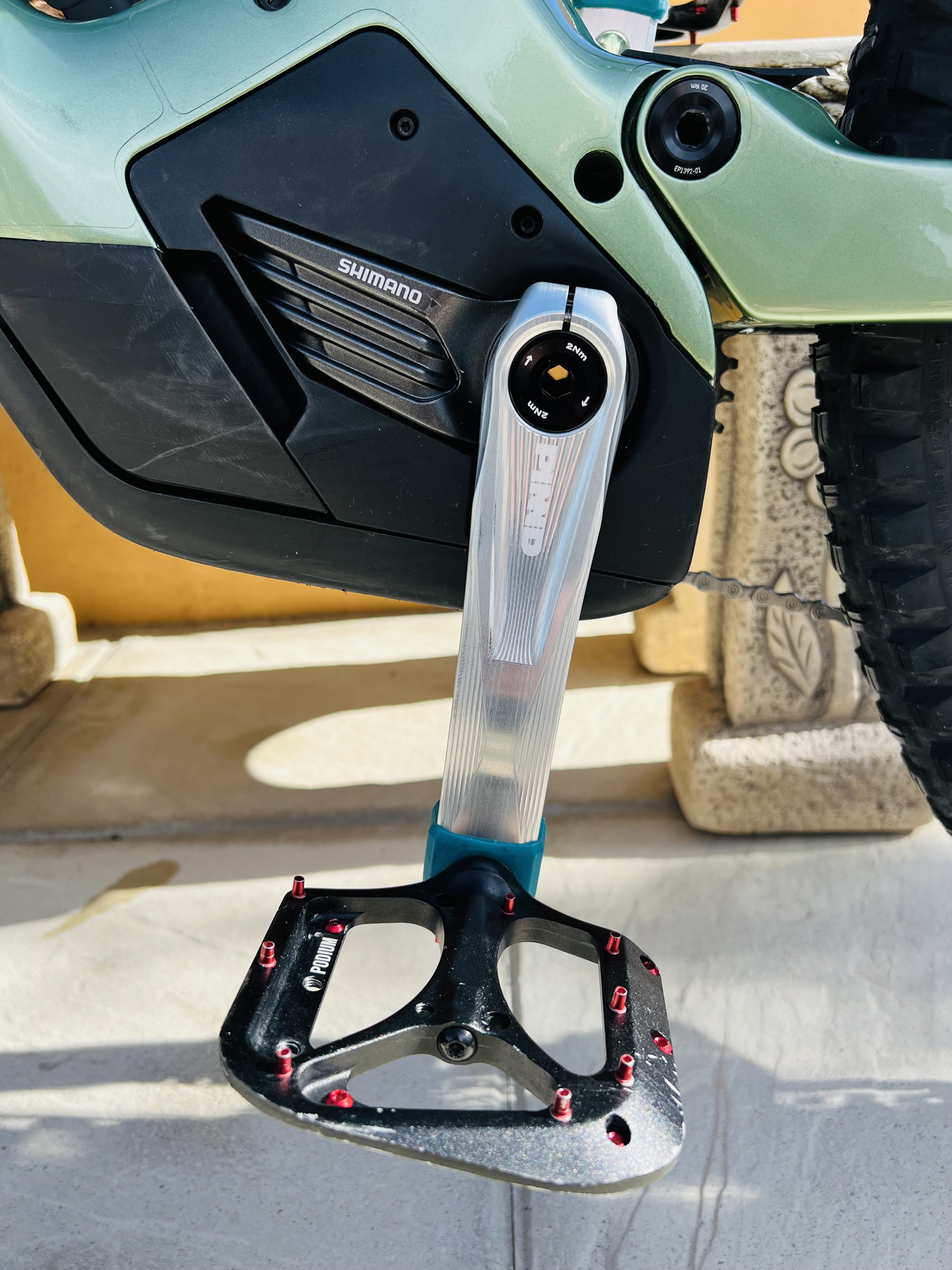

Nice! Was thinking of going for these for Heckler - is that what you have? Do you have any more pics of the silver cranks with the avacado green heckler?
It’s not a Heckler bud. It’s a Canyon Spectrol:On but here you go 😎
Virtually eliminated pedal strikes since fitting. 155mm
