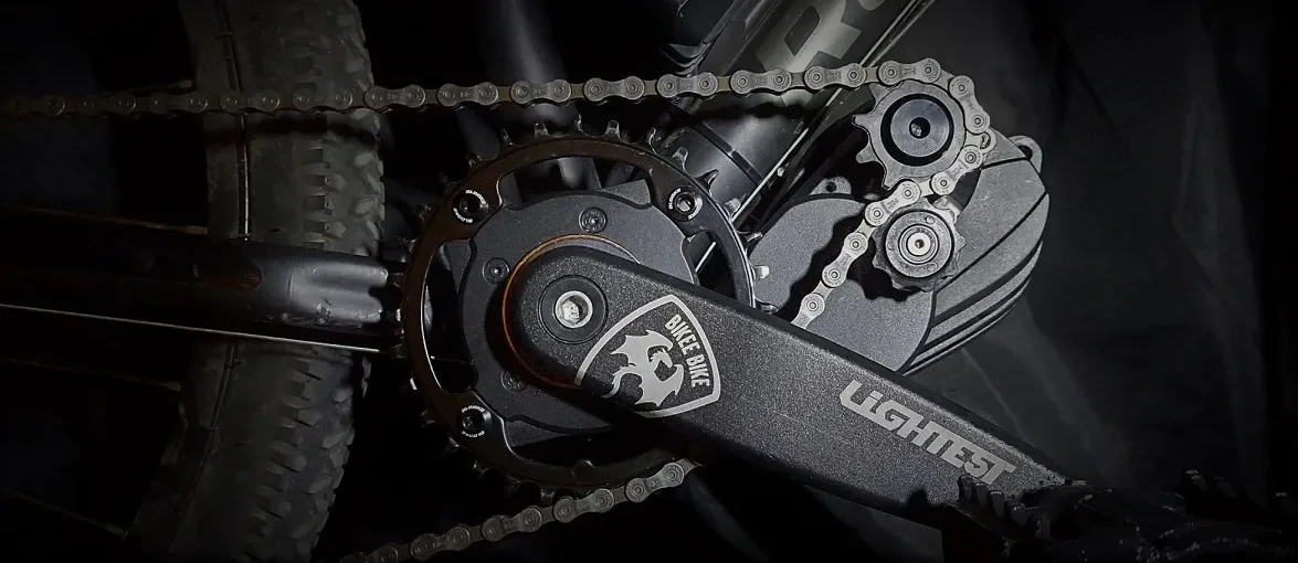

Polini EP3 also uses shimano mount, but not available.
The guy behind this popped up on the forum under Matteo Bikee Bike username with pictures of the motor in a shimano frame:
Scroll down here
No idea of the status.
I'm not sure how well the adapter plates would work either. It's a very stressed part of the frame with all of your body weight going through those bolts over jumps/drops etc..
Remember you will also need to change the battery and wiring too. Or possibly replace the BMS on the battery with a suitable one.
