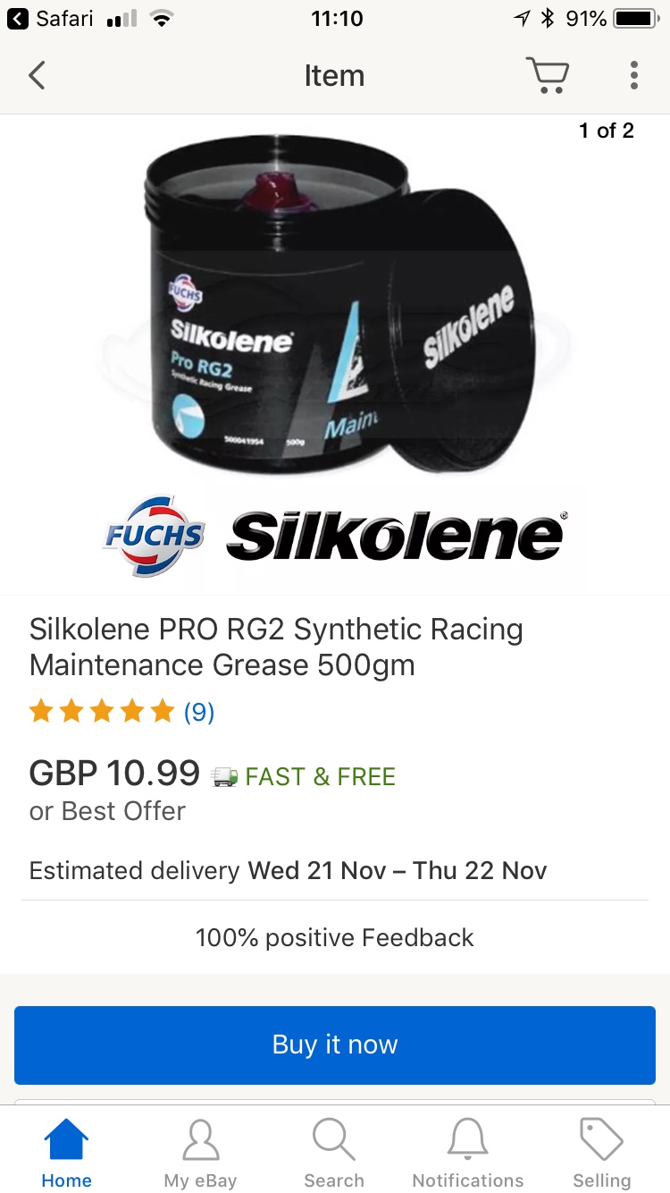

[Googles] Most greases have good water resistance, some are better than others. A few are bad (like calcium, sodium and silica based greases) but you just don't see those being sold as bike grease.
The 'cheap' bike greases tend to be lithium based which has 'good' water resistance. You're looking at £5 for 100g. Teflon/synthetic, with excellent water resistance, is more like £9 for 100g. After that, there's fancy expensive 'ceramic' or 'proprietary formula' grease, but they're variations on standard grease with additional ingredients added, for a quid or two more per 100g.
Not much in it really. As with all things, buy the one in the middle if you can afford it: It's better than the cheap one, and the most expensive is probably offering diminishing returns.

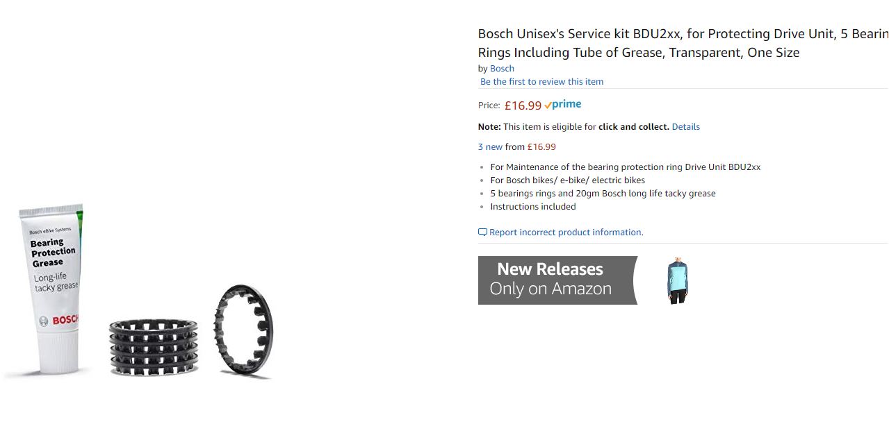

This grease with replacement seals has been available for a while from various EU on line shops and is on Amazon UK as well;
